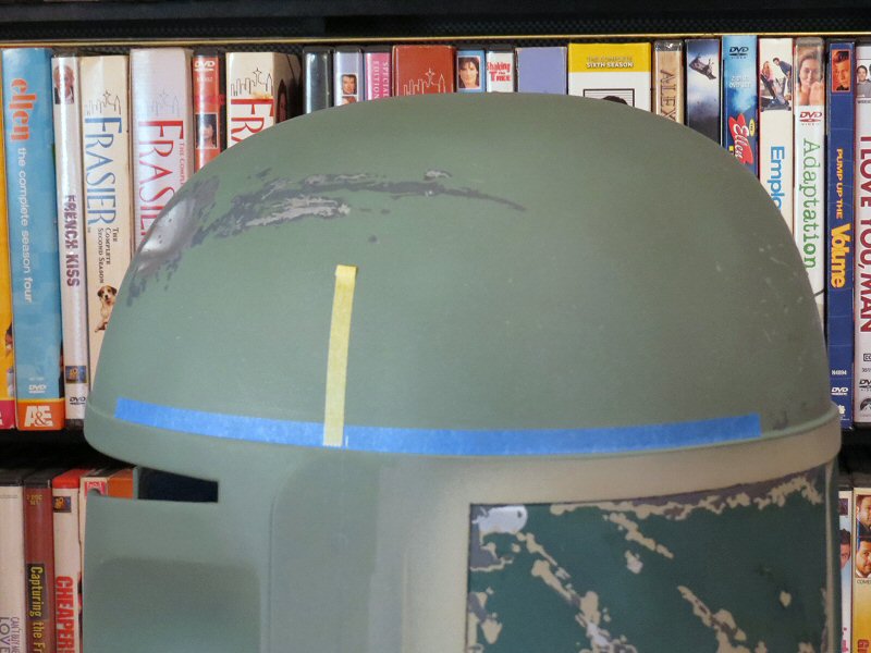

I mark a piece of blue painters tape and slice it with an X-acto knife so I have a strip that's 7 mm wide.
Then I lay it onto the helmet.

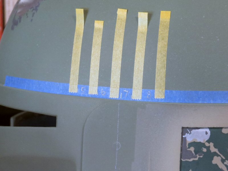

This pic shows that the #7 stripe's front edge is just forward of the centerline of the ear. So that's where I
begin marking off the stripes. I draw a pencil line on the ear platform, and extend the line up onto the blue tape.
On this make of helmet, I came up with measurements of 8 mm X 25 mm for the killstripes themselves, with a
spacing of 6 mm between each stripe. Tamiya makes an excellent yellow masking tape in various widths, and
one happens to be 6 mm, perfect for this application! I place a piece of the 6 mm Tamiya tape so that the back
edge is just forward of the pencil line. Remember, the tape marks the spaces between the stripes, so if the
back edge of the tape is forward of the ear centerline, the front edge of the killstripe will be forward of the centerline.

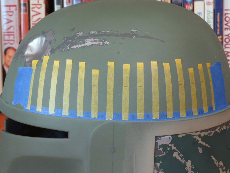

Now that I have the first space taped off, it's a fairly repetitive process to mark off the remainder of the killstripes.
I measure 8 mm from the front and back edges of that first piece of Tamiya tape, then add additional strips.
As you can see above, I write a small number on the blue tape below each stripe. This is just something I do
to help me keep track when I apply liquid mask (in a few more steps). I continue marking off the killstripes in
this manner until all 17 stripes are masked off. Aha! Caught you napping. . . there are 14 stripes of course.

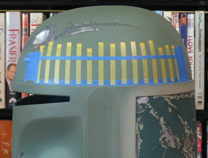

Now that the vertical spaces are defined, I need to mark off the top edge of the stripes. I place a mark on each
piece of Tamiya tape so that the stripes will be 25 mm high. It may not be necessary to mark every piece of tape.
But I do it so I'm sure I'm getting the curvature correct.
I cut another strip of blue painters tape and lay that down so it's on my pencil marks.

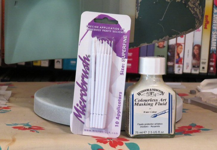

I use Winsor & Newton masking fluid for doing this type of work. There are plenty of other perfectly suitable
masking products out there, I just find that W & N suits my needs. It also goes a looooooooong way! I've been
using the same bottle for probably 4 or 5 years. To apply the fluid, I use a product called a Microbrush. They're
pretty inexpensive, disposable, and easy to use.

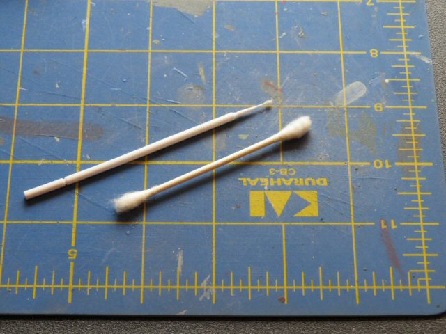

Microbrushes come in a couple of different sizes. I use the Superfine size for doing small work like this.
Here's a Superfine Microbrush next to a common cotton swab.
TIP: Just cut off the little tuft on the end of the Microbrush when you're done using it, and save the plastic
stick for things like mixing 2-part epoxy. Works great!
This is another area where clear reference pics, or great templates like those made by Rafalfett will really
come in handy. The patterns of chips in the killstripes are very specific, and they are one of the areas that
people will focus on when they look at your helmet, so getting them as accurate as you can is important.
Below, I've applied the masking fluid. The slightly darker, shiny spots are those chips that have been masked off.
By this point, I've done quite a bit of work to the helmet, and I don't want to risk messing up any of the detail
I've applied to the dome or back panels, so I mask off the entire helmet.
