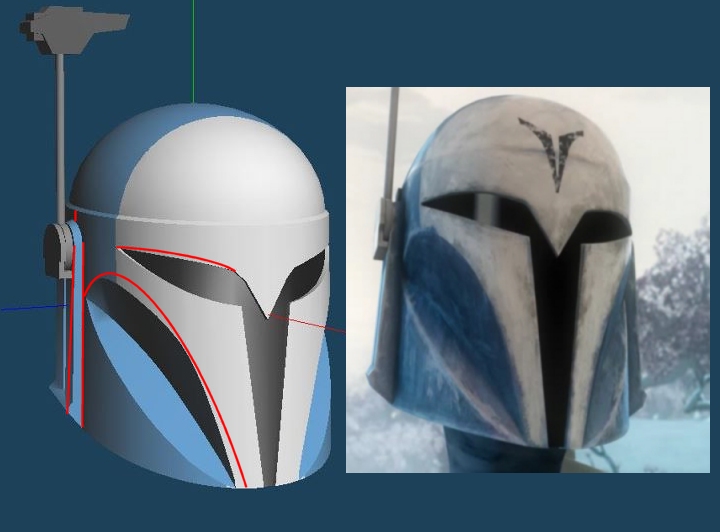

Hello everyone! I would like to show you that I'm working on right now. I'm from Venezuela and I specialize in creating Pepakura models. perhaps some of you have already seen my work in the clonetrooper.net forum.
Some people have asked me for this helmet, so I decided to do it. and what better place than this to receive your comments or criticisms about this helmet.
well, here's the model...
is still a bit raw, but I'll go update their progress in the coming days.

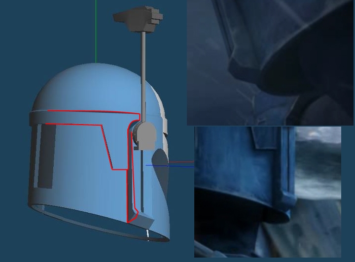

Here are some images with the parts you can change for accuracy:
417622_10150753207771038_727896037_12308865_717542376_n.jpg 427287_10150753212421038_727896037_12308875_766401974_n.jpg
Don't get me wrong, I like what you did so far (I wish I could do things like that).
Thanks, Rafalfett, for pointing out these details I had overlooked. I have made ​​corrections and I think that the model is ready now.
the helmet have a 90% or 95% of accuracy. maybe I have to make a few changes on rangefinder.
what do you think?

My only criticism is not making the bottom rim of the helmet a perfect oval. Make the bottom a little more egg shaped or even angular. It will make a HUGE difference when its in your hands. The oval bottom makes helmets wonky. Very nice file though.
m2
The only thing you need to clean up... on the browline, over the vertical bar of the visor, between the earcaps... the brow should not be a raised brow like Fett. The brow meets the dome and there is a slight ridge where the angle changes but, it is flush. The raised portions starts at the back of the earcaps and goes around the back. I hope that made sense?
If you look at my finished thread and Cruzers thread you can see what I mean. Look VERY closely at the stills and you can somewhat see it but, it's hard to ID but, it's there. I have some images that show it clearly but, I cannot share them as a promise to the source.
