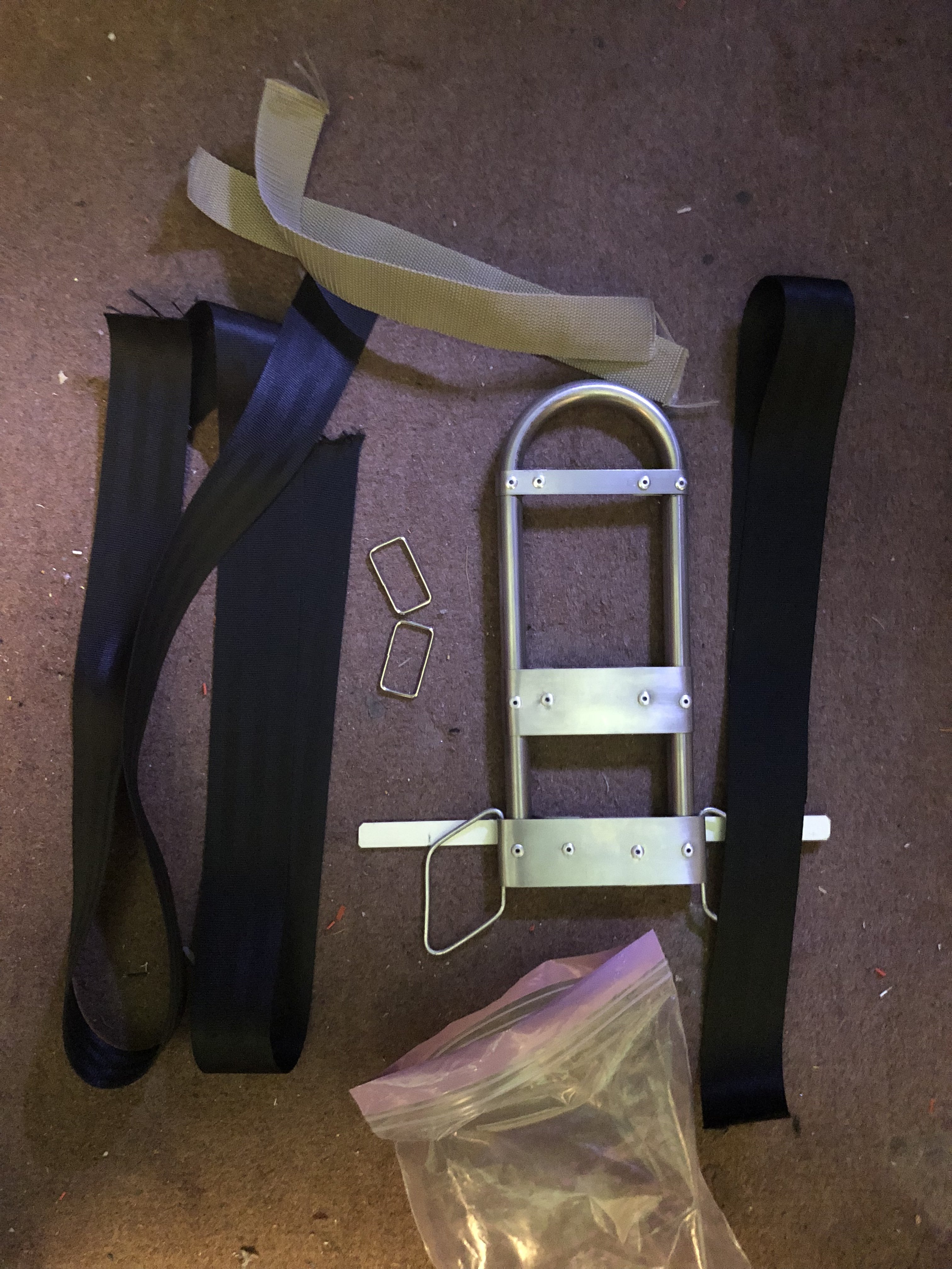

So following that guide these straps provided are not even remotely close to being the right size
Also I didn’t get any of the other metal buckles this is all I got ; ie no sliders and d rings
Is the above correct I appear to be missing a few bits
The sliders and rings are extras you'll have to pick up on your own. He doesn't include them. Hit up Full Metal Fett on here for a replica divers buckle.
