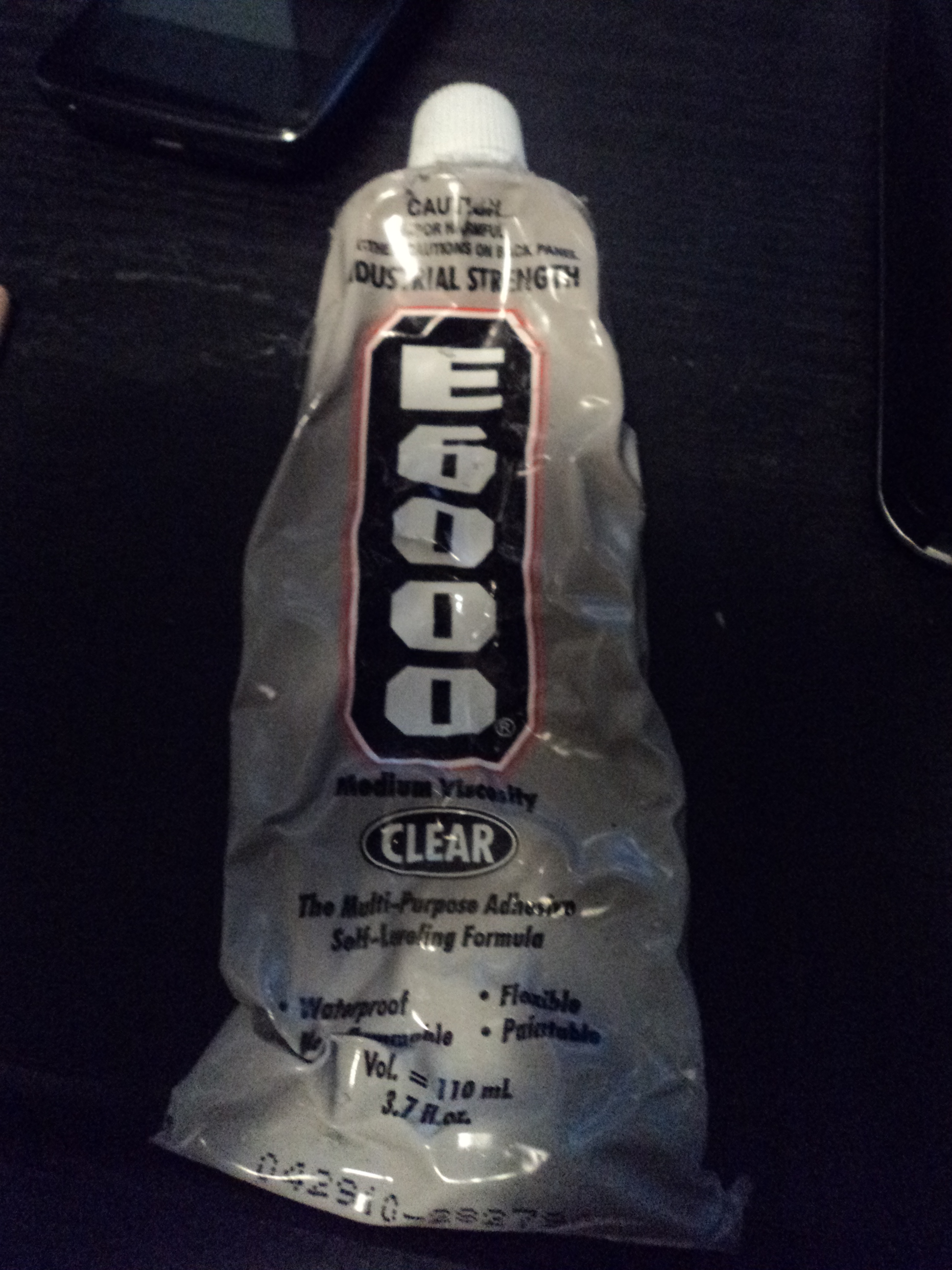

I use E600 Industrial strength glue. I used it to build my stormtrooper and have trooped in it a lot without incident

same company but not as strong..I tried the sample pack had little tubs of Goop, E6000 and some craft glue stuff,, Goop is good but E6000 is stronger and you can get it in black in a caulking tube at some hardware stores.
redkraytdragon
Yep if you're looking for something flexible, E6000 is definitely the way to go. Devcon is good stuff, and super strong, but rigid and solid... it will last quite a while as well. I did have a friend tell me once that his E6000 failed under high temps though, down at white sands in southern NM for a photo op, so if that's true that's something to consider if you live somewhere where it's hot all the time. The Devcon will withstand higher temps and also does well with cooler temps and moisture...but to each their own. I'm not pushing it (even though it sure sounds like I am lol). I've just had really good experience with it. Another option to consider is using the E6000 in combination with Devcon or some other adhesive of your choice...I've heard of good results from that as well. Good luck with whatever you decide (y)
