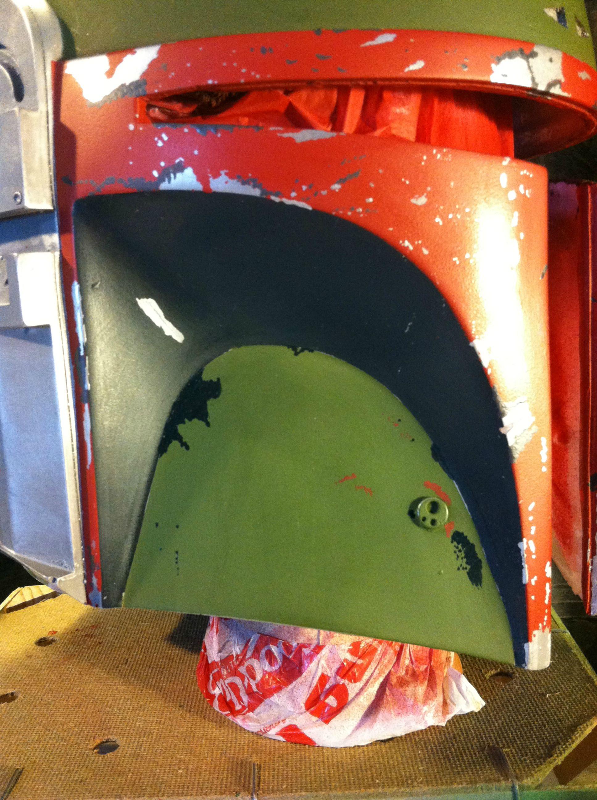

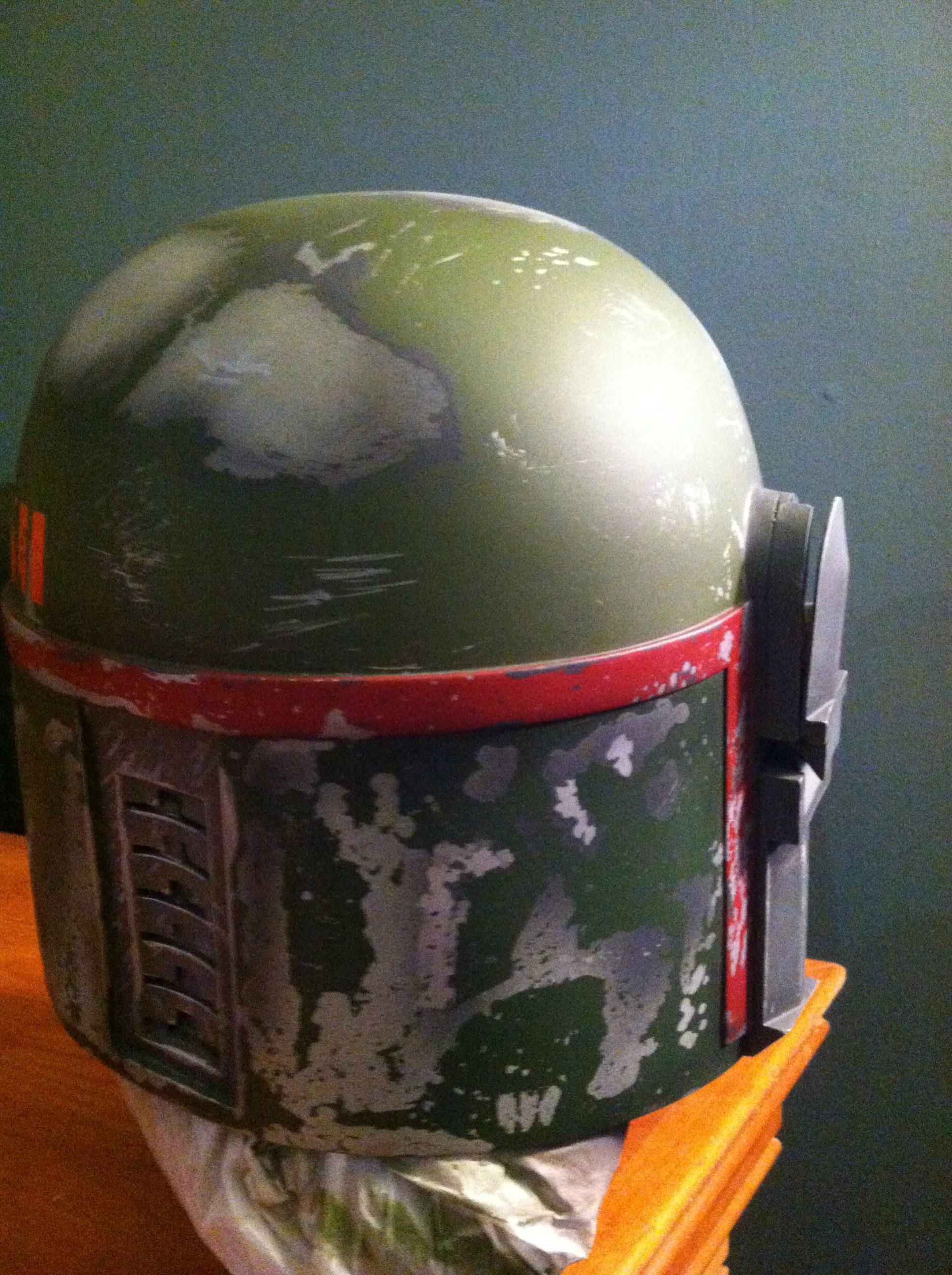

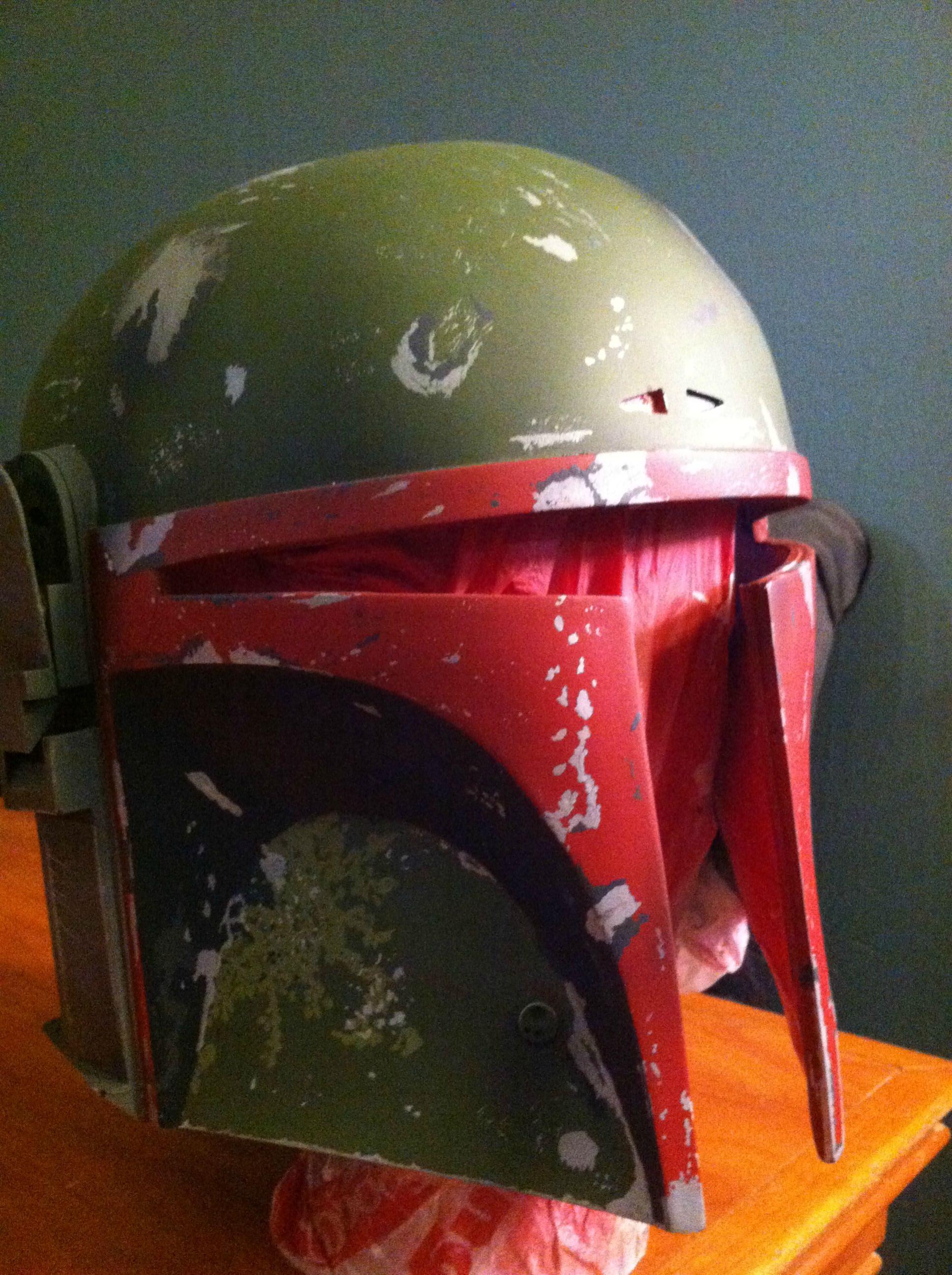

I painted and added some damage to the crimson trim.
I Also started some right cheek detail work.
This "Fern green" Can suck it. I just added some white to the original cheek/dome color to lighten it up. The next pictures will be final right cheek weathering and some left cheek weathering...

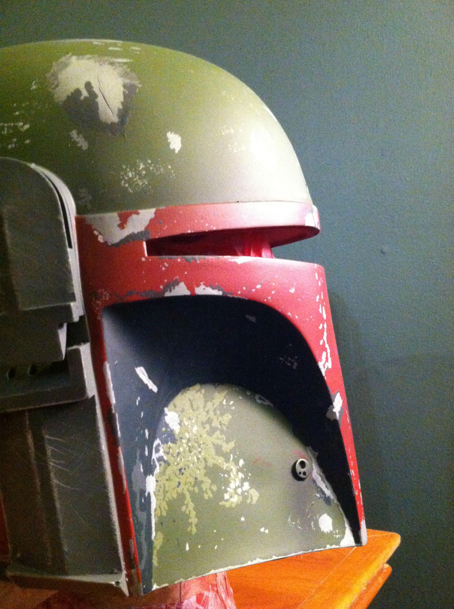

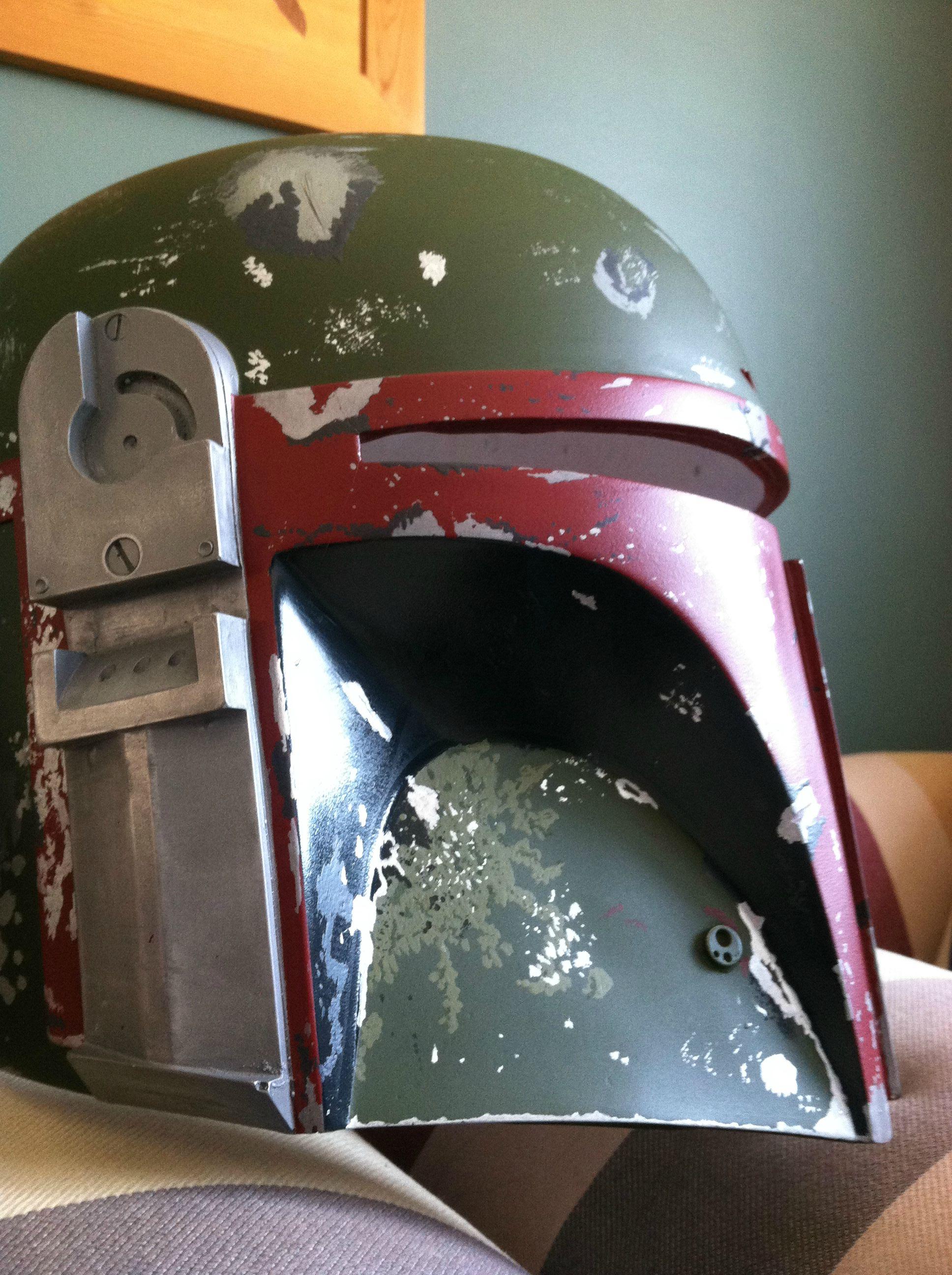

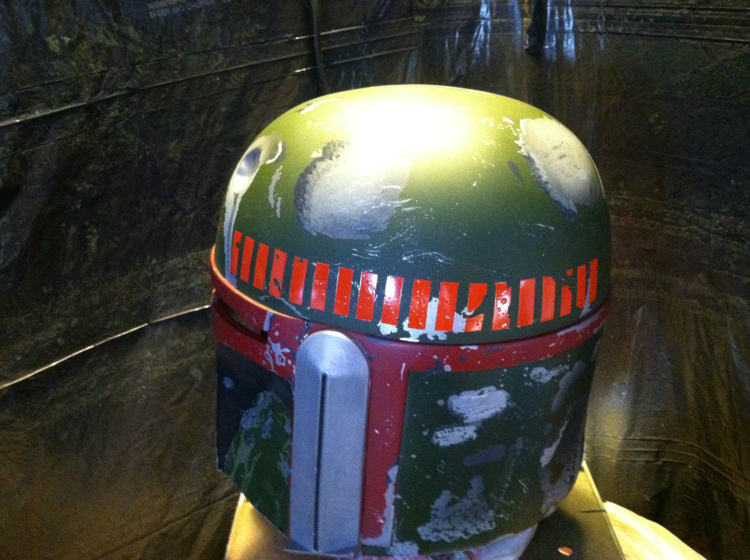

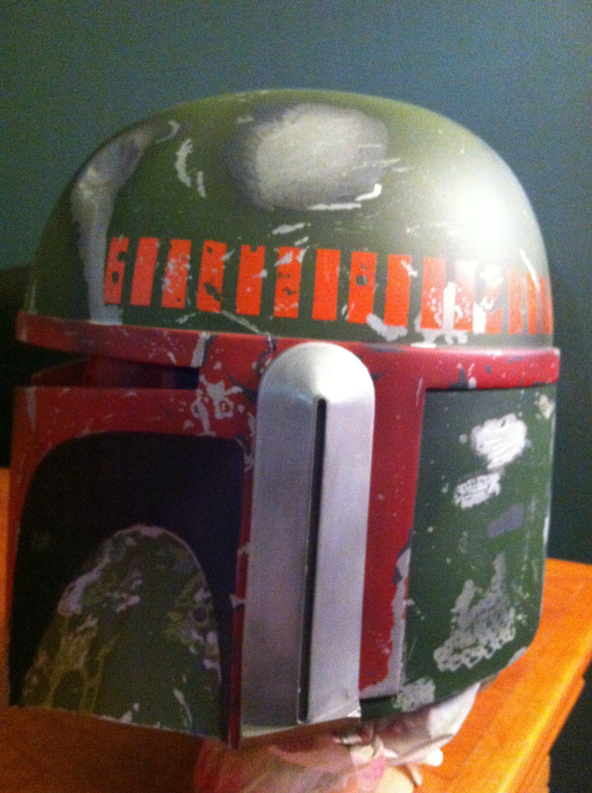

i Finished all that neurotic detail work to the cheeks and dome... gave it a layer of black weather-wash to kill some of the shine and blend it...
There's another layer of black weathering I'm going to do to blend in the larger paint damage.

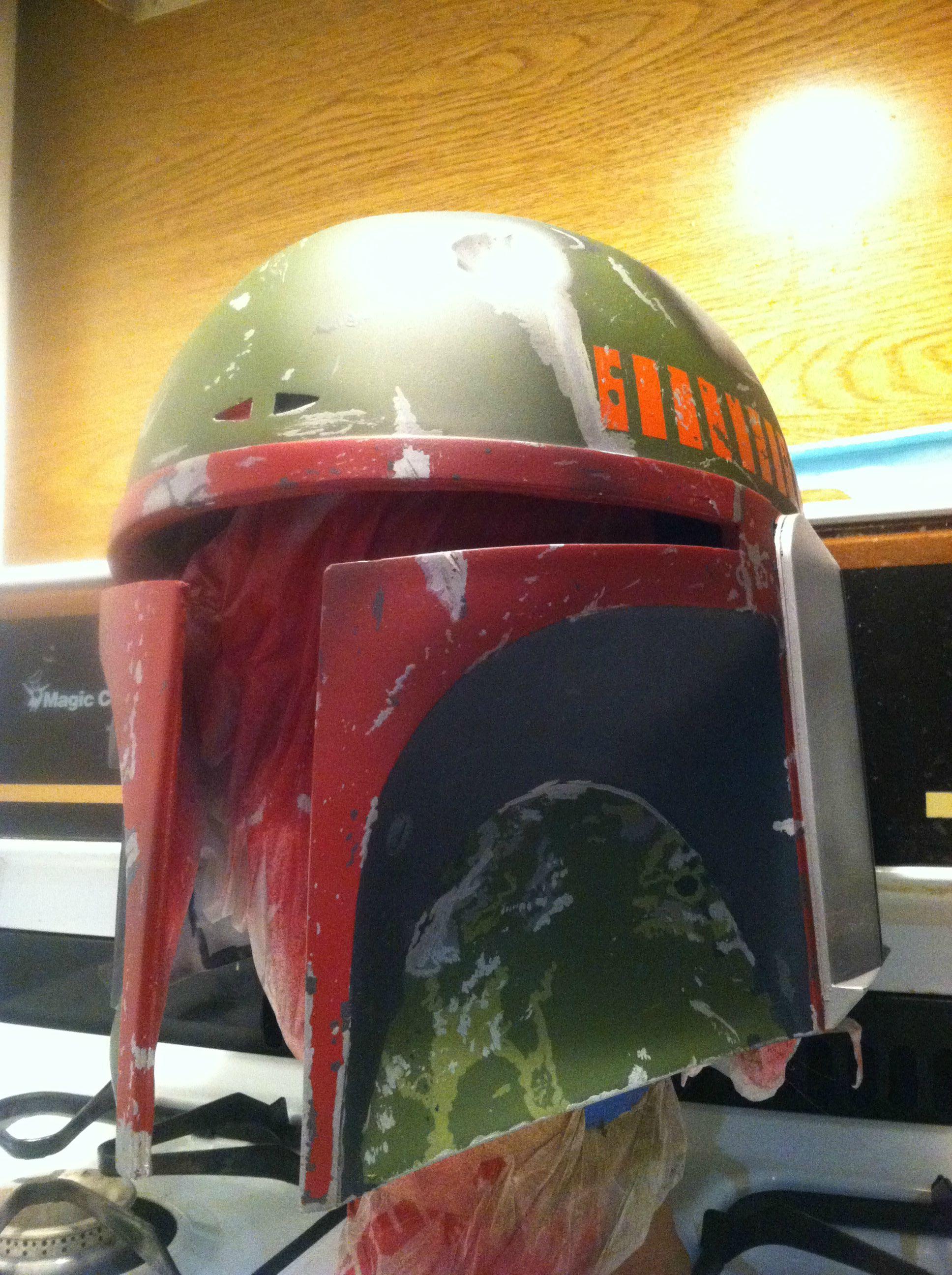

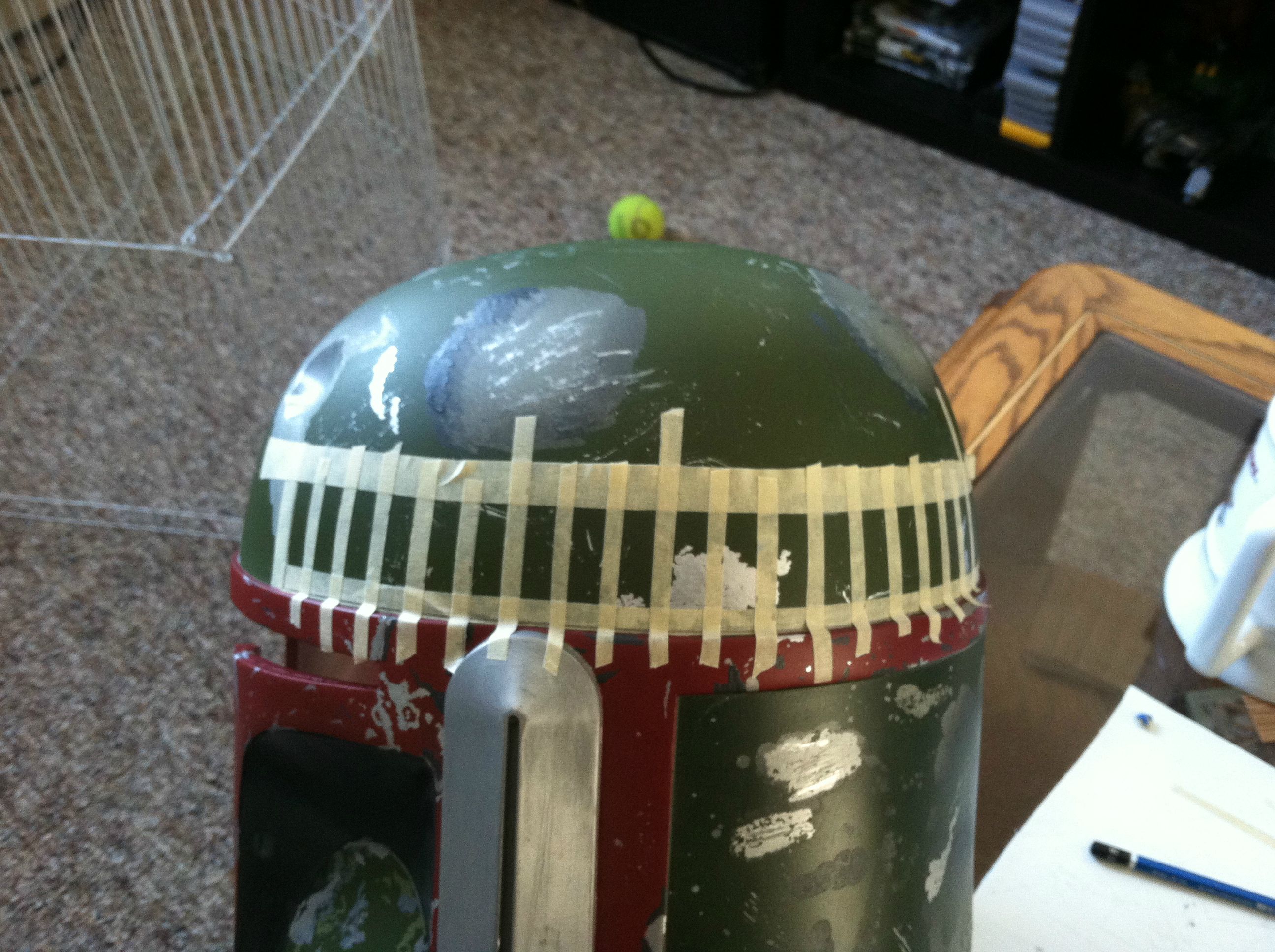

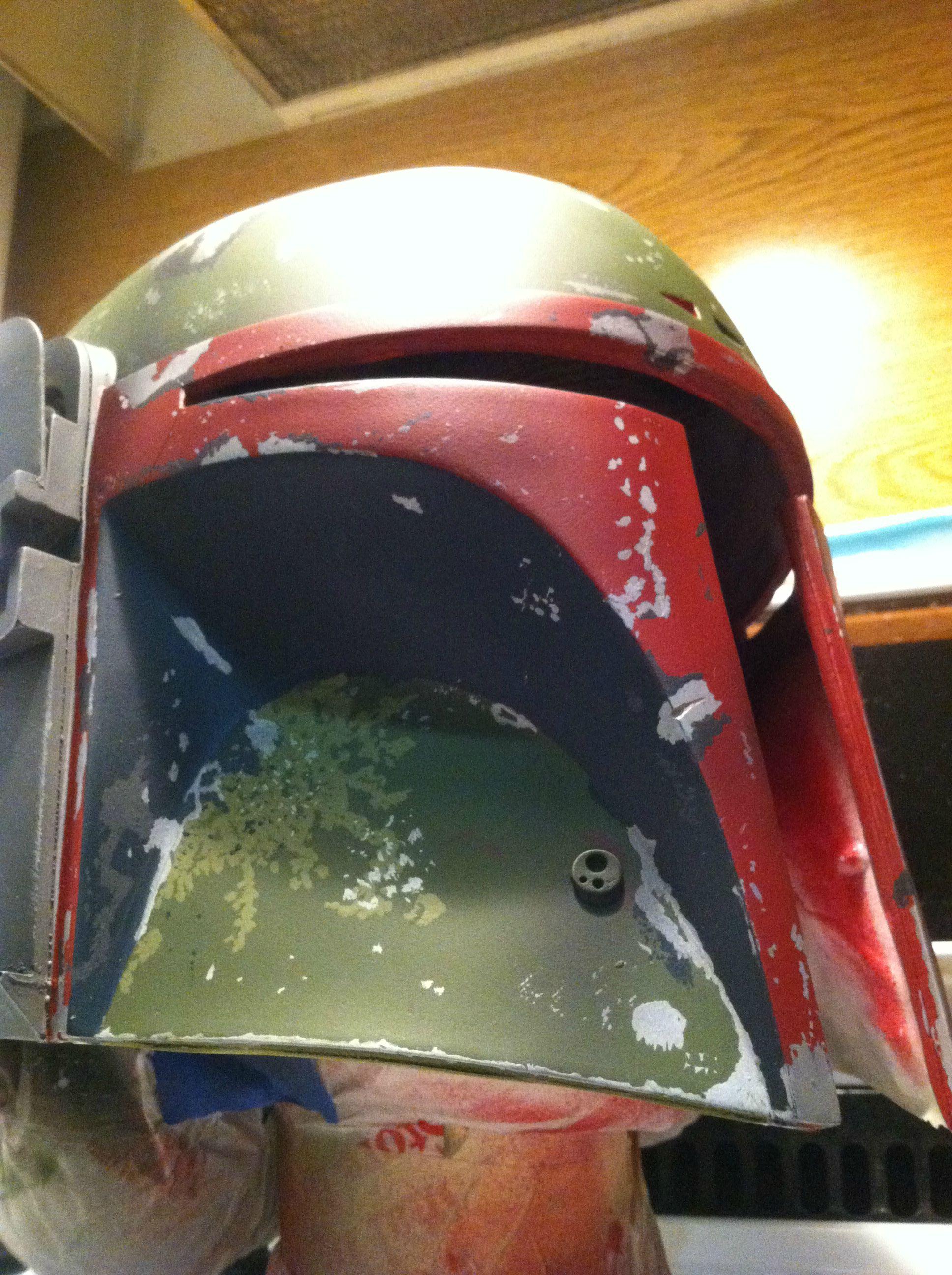

Masking off the Kill Stripes isn't so bad when you have Netflix...

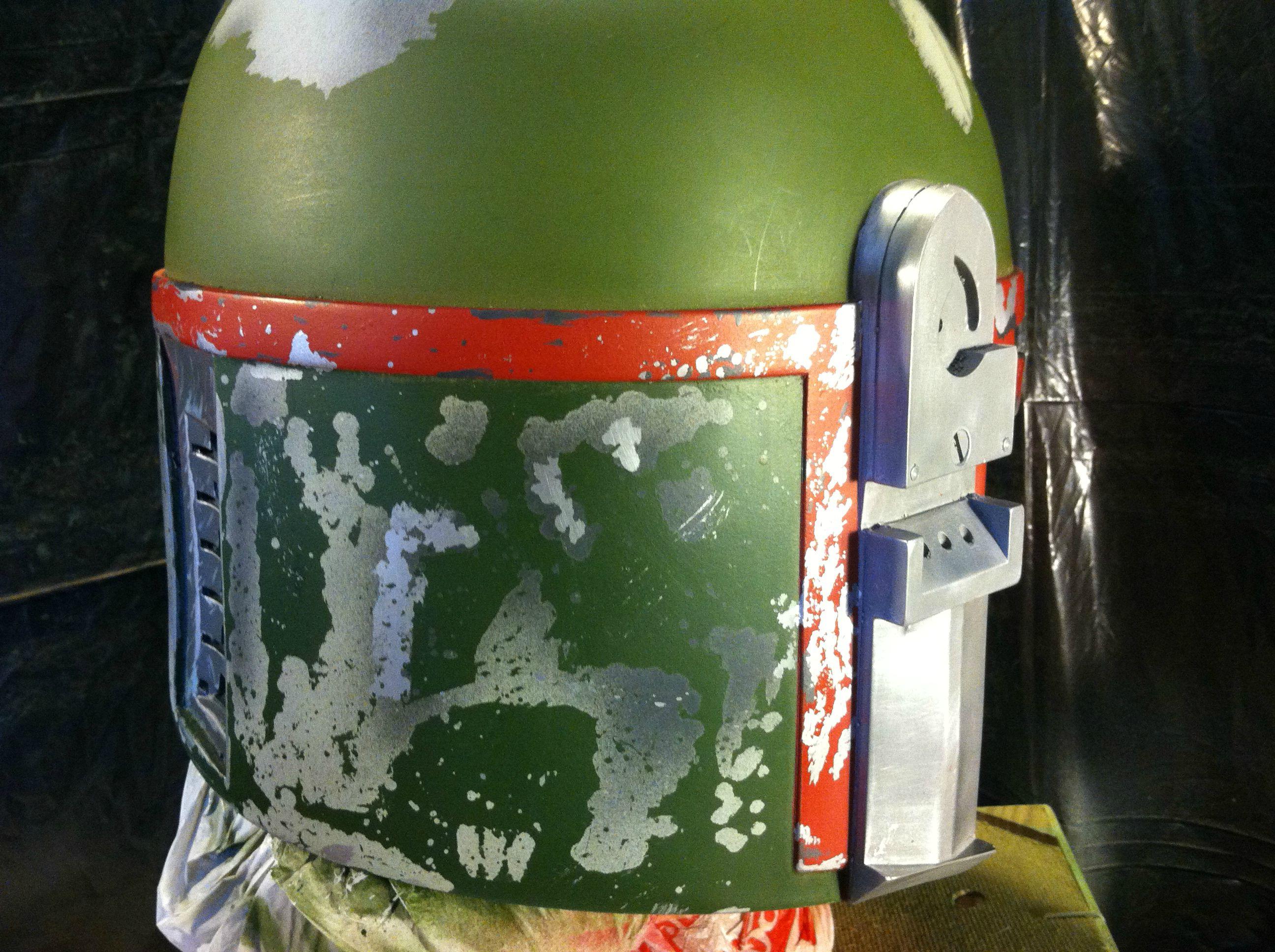

Raw KillStripes, very glossy, masking fluid hasn't been taken off yet...

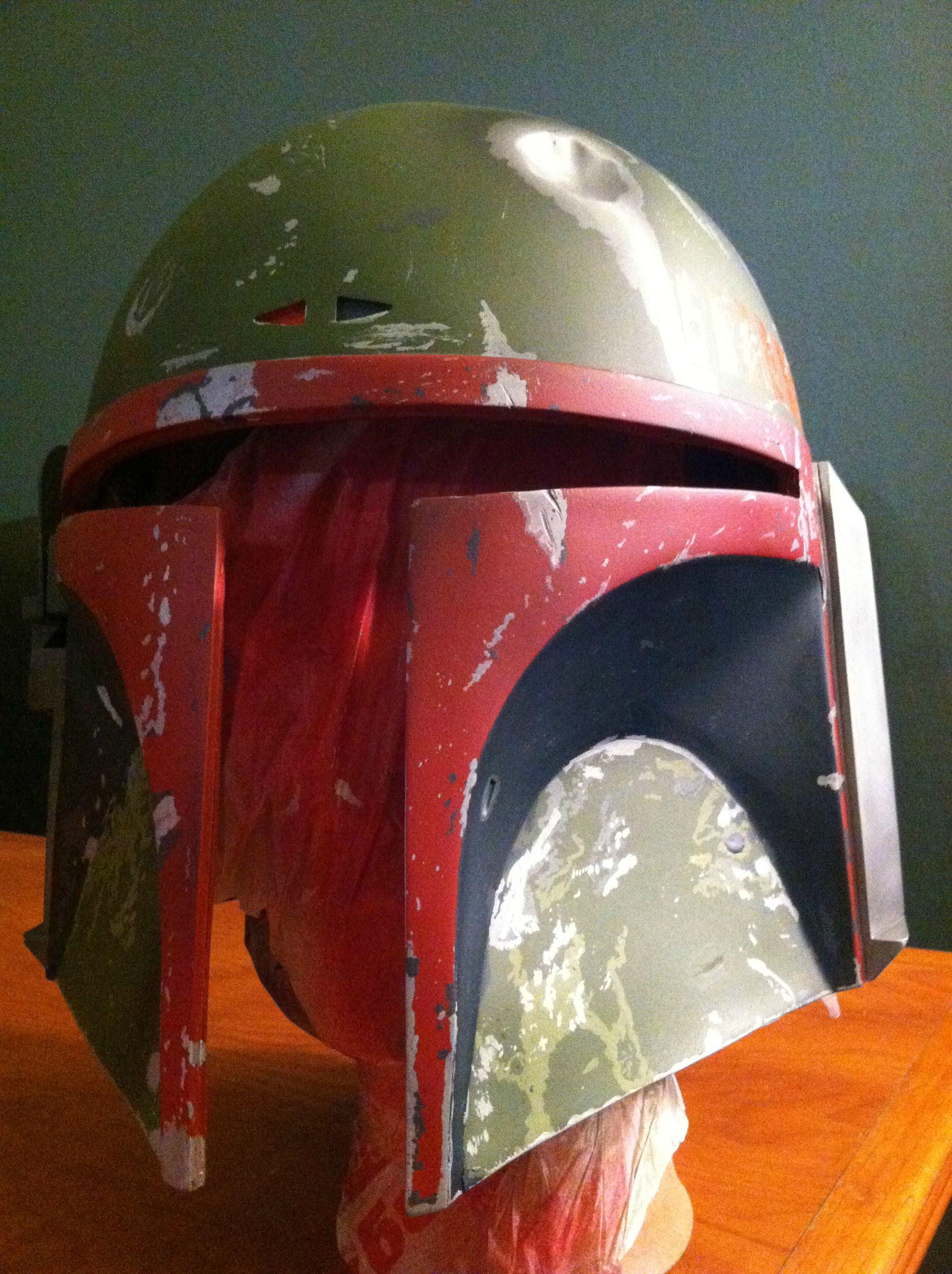

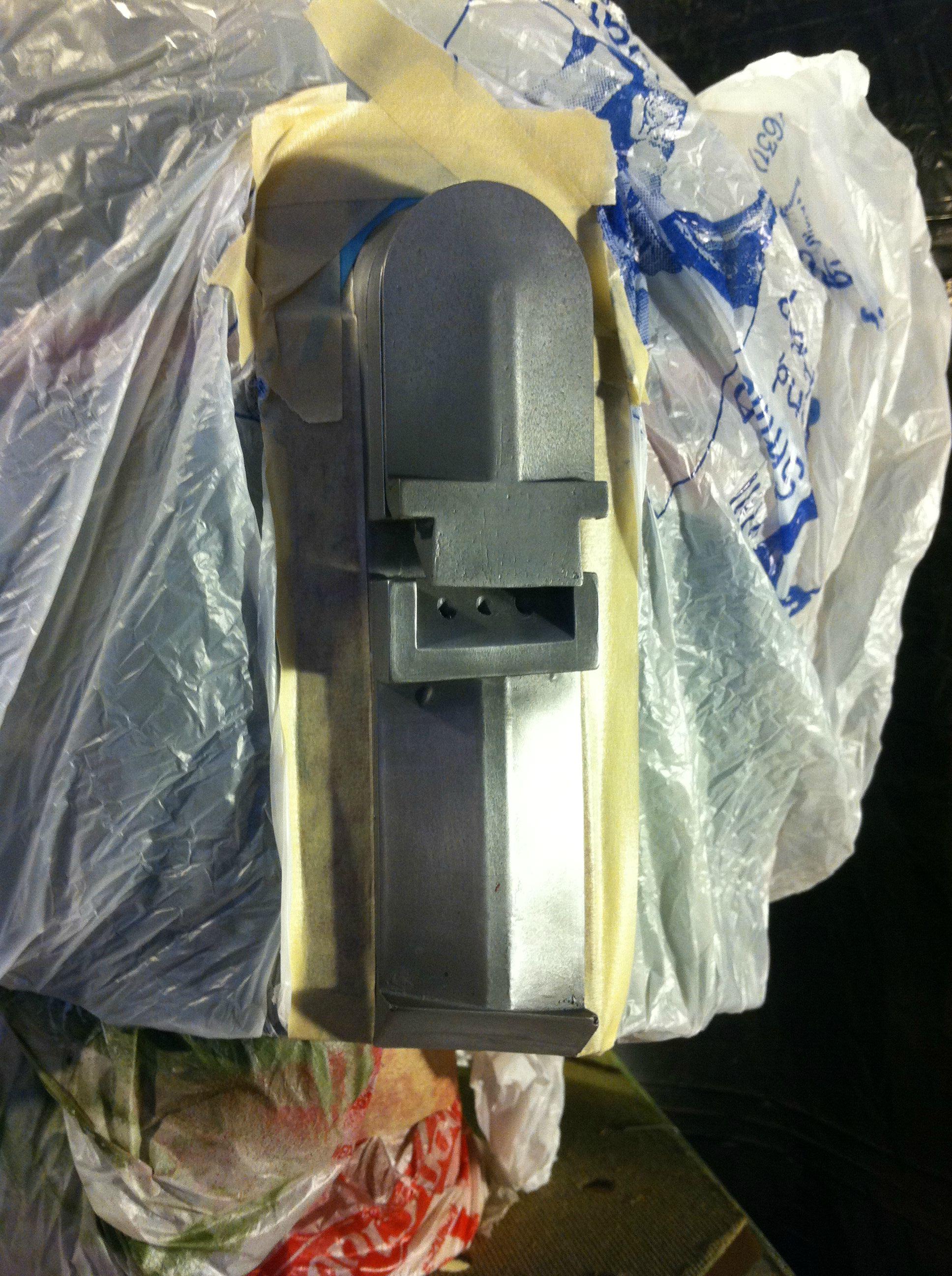

As I started Dull Coating, patting myself on the back for a job well done... I realized I <o<k3d something up... The RF Ear has to be darker!!! Grrrr- NP- Masked, painted and sanded to weather (Splashing some of that black wash on...

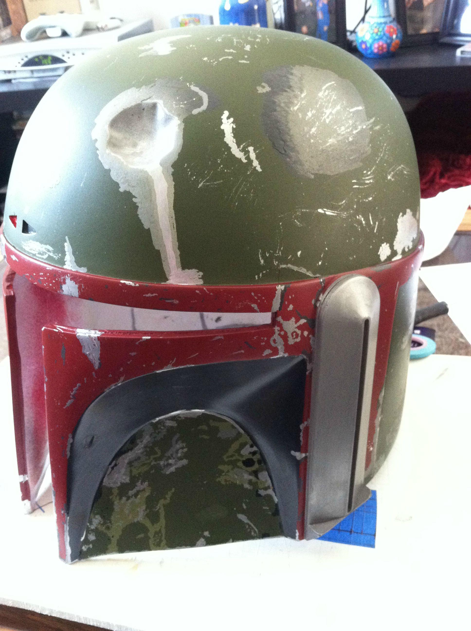

Here are some grainy pictures of the helmet without the RF assembly (Masking tape is holding the cap on)
That dent really shines in heavy and direct light.
