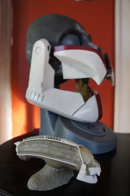

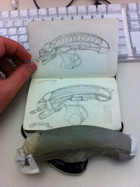

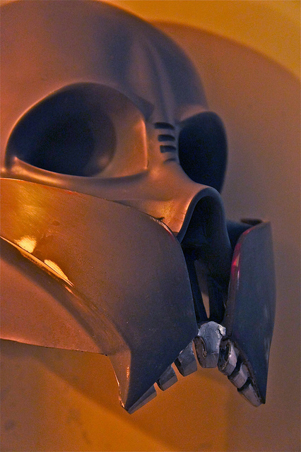

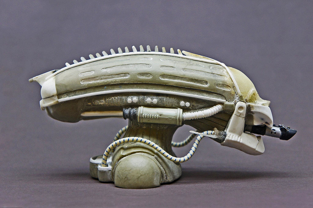

I am making a helmet for this show. My concept is a recreation of H.R. Giger's Alien, as made from the parts of Star Wars;
I have made a maquette to help visualize the full sized helmet as I work;
The full sized helmet will be large;

HRG Trooper Maquette, final master
The next image represents the progress of the maquette for my full scale contribution to the 501st and EFX's 2012 "As You Wish" Artist Charity Helmet Project at Star Wars Celebration VI. Proceeds will benefit the Make-A-Wish foundation.
The full size helmet is progressing at a pace that is almost predictable. And though I have worked out much of the proportions and placement of elements with the maquette, new challenges arise in addressing the full scale.
My task at this stage of the project is two fold;
1. To make the audience believe the recognizable elements from different characters really were designed to go together.
2. To subtly tweak the form of each element to elevate a degree of fear when viewing.

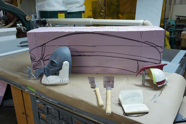

I have some additional progress images to share;

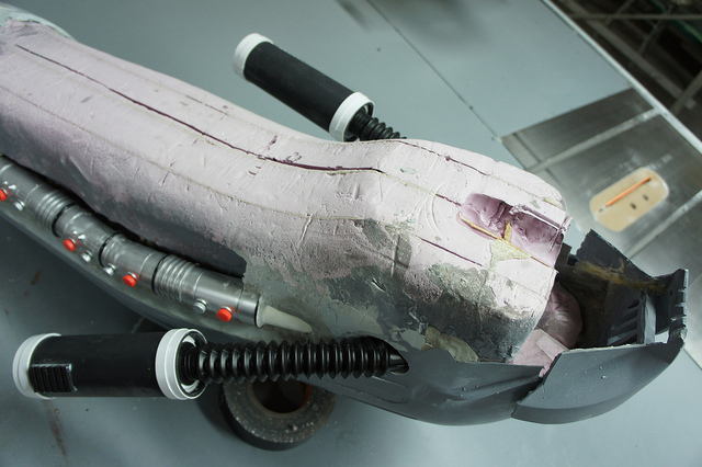

Progress images from the weekend;
This will be big. But not this big. I estimate I will shave this block down to 40-30% of its current mass.
Working at full scale afforded me an opportunity to try out the shop's Japanese Razorsaw.
I have concluded that I need a Japanese Razorsaw in my life.
After several years of shaving away deli slices from my project, shop professional Jon Olimb took pity on me and offered the use of his cordless skill saw (with built-in project light and ammo counter.)
¿Who would have guessed that so many tools were missing from my life?

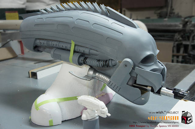

HRG Trooper; Progress continued

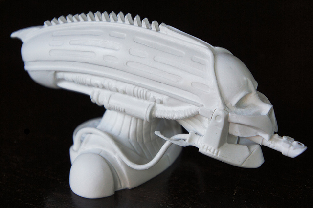

Making pink snow.

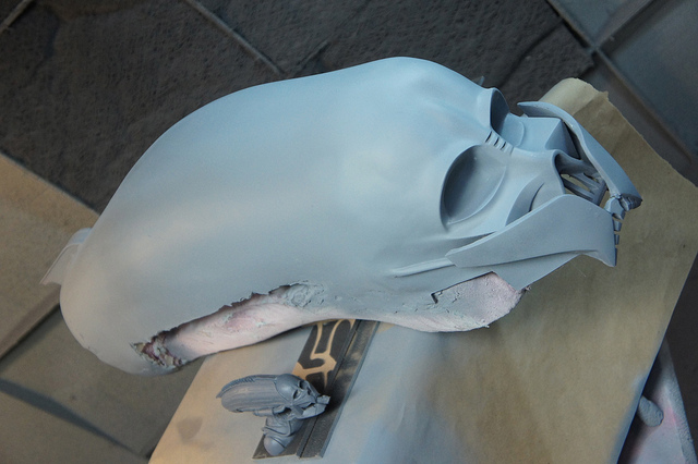

Over and over I reshaped the main body of the helmet. It is now one foot shorter than when I started. I suppose I could have taken measurement from my maquette and scales up, but I prefer to feel the shape arrive. There is a long way to go yet. I look forward to it.
In preparation for colour scheme options, I have the maquette in a uniform white. I very much appreciate the way the uniform colour brings out the piece's details.
More soon.
HRG Photo Set on Flickr

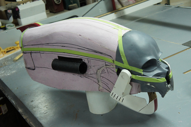

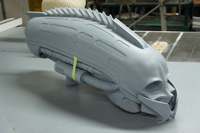

Layer by layer
Thank you,
I have cut a fairly expensive collectible to shreds. This is not something I do lightly. Over half of my production tyme on this project has gone into planning. I do believe that effort is paying off.
I like to take a page from my native brother's philosophy of using every part of the kill. I am using as much of the original helmet as possible in this design. The viewer of the final piece may not immediately know this for fact, but it is my hope that they feel it.
Layers; Grey lacquer based primer, microfil bondo, and resin jacket over a shaped foam core. The developement of the full-sized helmet follows the maquette in a manner satisfying to me. Very much a "I love it when a plan comes together" moment.
Today, I am making a pattern in preparation for reproducing the horn for the “spine” on the top of the skull.

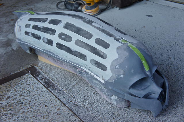

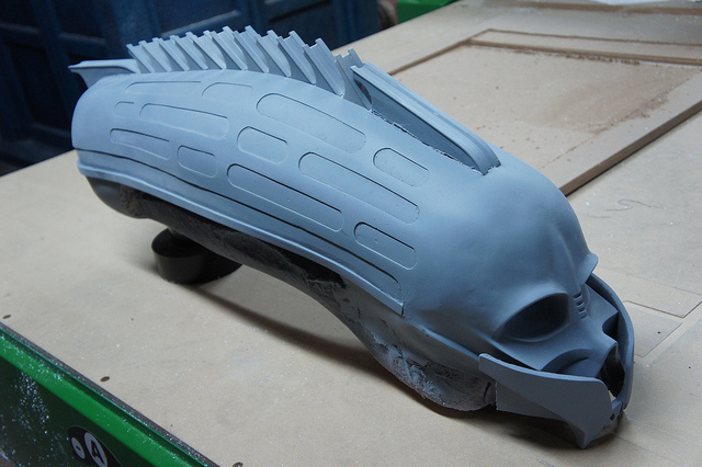

HRG Trooper progress, June 2012

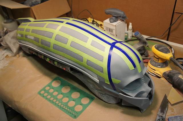

Progress from last week;
Here I use tape and a circle template to layout hours more work for myself. I had too because the Voice told me so. (There are tymes that I question the nature of the Voice's intent.)
Round two. My first attempt to rout out the “Death Star” lighting was unsatisfactory. For this attempt I filled in the previous attempt, and prepared the area a new with the elipses in 1/16" of craft foam.
Here I have added a new layer of Microlite filler and sanded it smooth to the same thickness as the elipses.
”Death Star hallway lighting" patterning solved and clone trooper "horn" reproduced to mimic spine. I have learned much by arriving at this point.

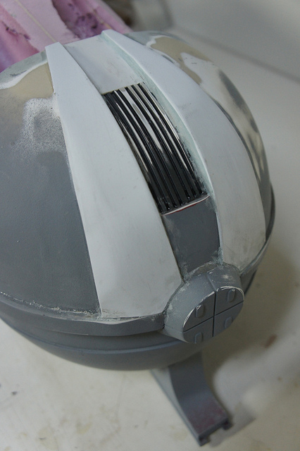

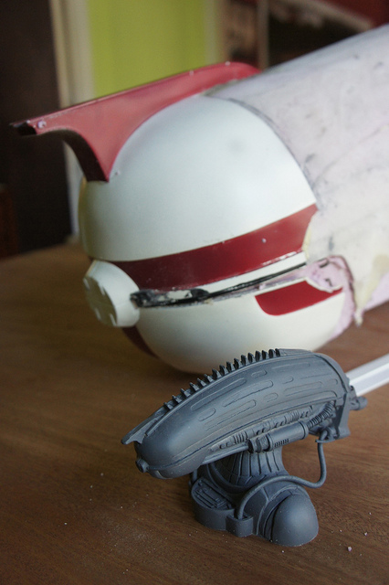

Progress from third week June 2012;
I had wanted to use a fan-made kit for the thermal detonators on the full-sized helmet to reference the 501st costuming community. However, as tyme wore on without response from various boards I realized I would simply need to make them myself. They were fun to make after all.
Despite having to fabricate the majority of this helmet, I am striving to use as much of the original clone trooper lid as possible. Here I used a heat gun to reshape the vent on the back of the original helmet and affix it to the original helmet's forehead. Together these become the bottom of the back of the HRG Trooper helmet.
If it is not apparent already, I have purposely been shooting the same side and angle of the piece so as to best demonstrate progress.
It is moments like this that I can envision having my weekends back. I do love the process.

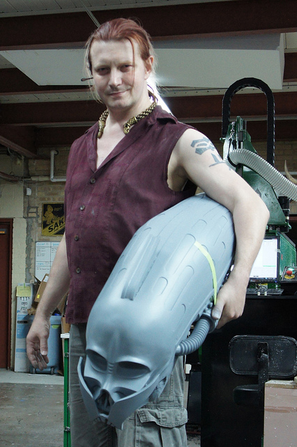

HRG Trooper; Full scale work in progress, late June 2012
This weekend I began to shape the torso display piece.
Thus combined, the piece’s final presence can be visualized.
