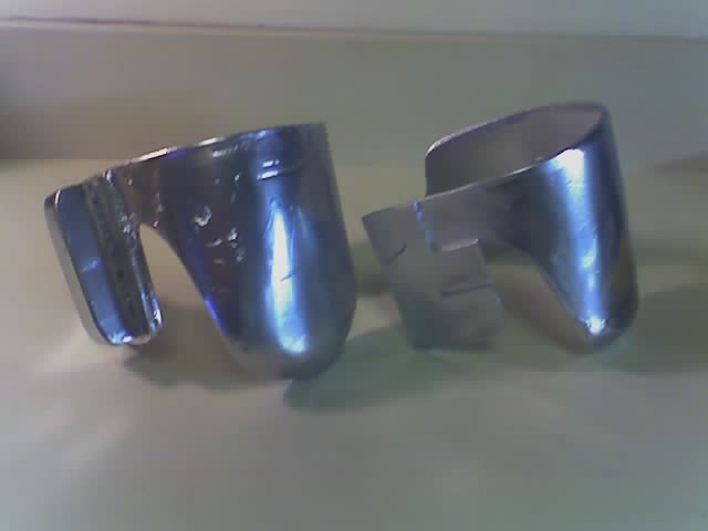

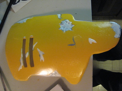

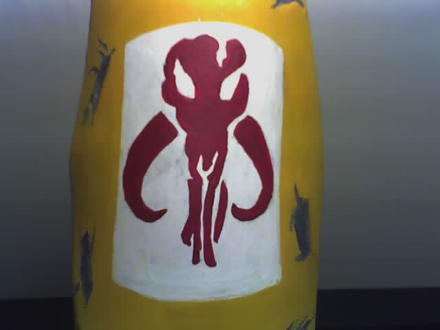

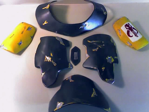

My first attempt at building armor from scratch.

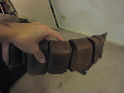

And my belt.:)

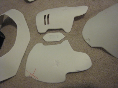

Looks cool :) Did you use the WOF Templates??
I actually hand drew out my own templates on cardboard first, then transferred them to the sintra. It's my own design. Not exactly fil accurate, but so far it seems to work.:)
Oh, and I've abandoned the use of masking tape to hold the edges of the spray. I've started using liquid latex to mask off all of my edges. You just brush it on and after it dries you apply your spraypaint. When the paint dries you go back with a set of tweezers and slowly pick off the parts that had the latex over them. It's a lot easier to control and you don't get as many "spill overs" that seep under your tape. I love it!

I really like the rounded edges you've got on there. It gives them the look of being thick. A lot of people don't do that on their scratchbuilt armor and it looks kind of one dimensional.
What type of material are you using and how thick is it actually?

Believe it or not, the armor is 1/8" sintra. After cutting out the shapes of the plates I spent a lot of time rounding the edges to make it look like hammered metal. Thank you for noticing!:cheers
