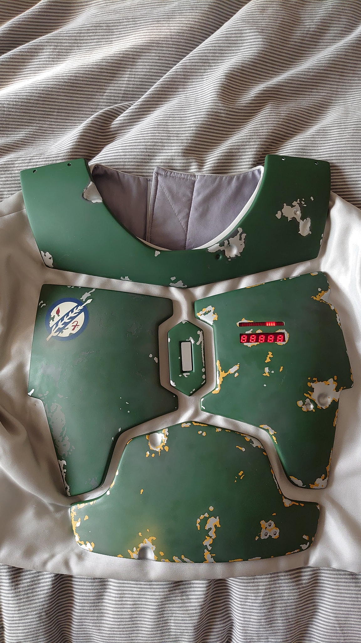

I just finished this up with AX. Center diamond and collar are almost straight Weyerhaeuser, some SP Lark Dark. Ab and left chest are Weyerhaeuser and SP Lark Dark mixed. Right chest is Weyerhaeuser and SP Lark Dark mixed with more SP Lark Dark than everything else and then everything gets more misting of SP Lark Dark & SP Lark Light. Yellow is reefer yellow. Gray damage on collar and right chest are, you guessed it, SP Lark Dark.
Then the shoulders and knees are a mixture of reefer orange, reefer yellow, mud, and armor yellow. The left shoulder is mostly mud and reefer yellow with misting of SP Lark Light.
The knees and right shoulder are various mixtures of Armor Yellow, Reefer Orange, and Reefer Yellow. Misting done with Roof Brown and SP Lark Dark.

Excellent, thank you very much. I'm going to give these a go, and maybe I'll end up redoing my own as well. Excellent work, btw.

I have been thinking about repainting my armour plates so this is partly an experiment before that.
Love the paint job!

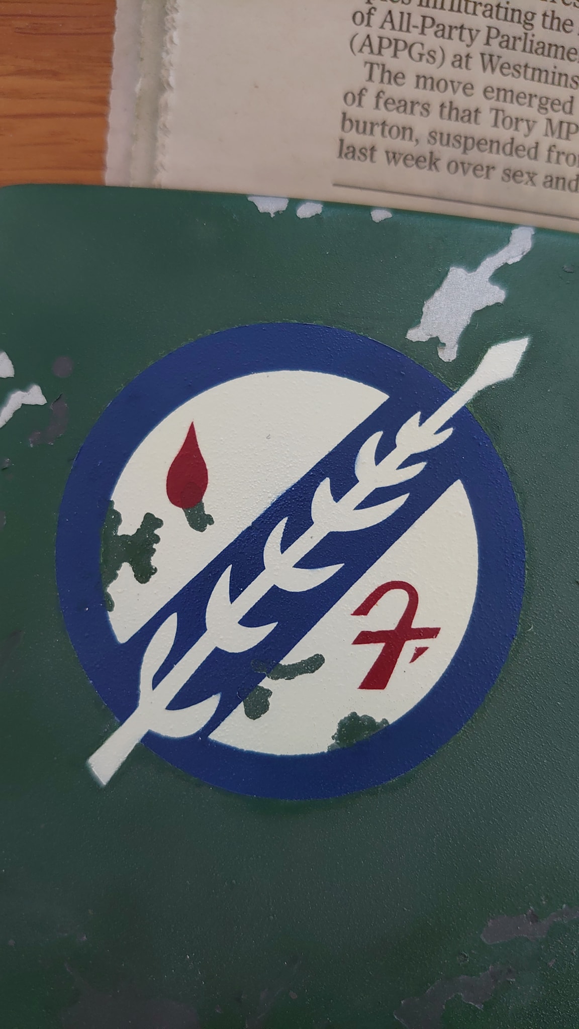

Did you use AX paints for the Feather stencil work? What type of blue?
I will be ordering these paints as well.
The feather is Tamiya Flat Blue, Flat Red, and Flat White. Just what I had. I might have darkened the blue a tiny bit.

I followed the list above, so left chest, ab plate, cod piece, and kidney, all primer, silver, SP Armour Yellow, Weyerhauser Green, misted with SP Lark Dark and Light Grey. Ab gets a slight yellow spray on the left side as is visible.
Right chest, center diamond, collar, back plate, all primer, silver, SP Lark Dark, (plus SP Lark Light for the bit on the right chest), Weyerhauser Green, misted the same as the other bits except for the center diamond which DOESN'T get misted. It keeps it darker but it still needs the Lark Dark Grey underneath. I misted most of the armour before I did the emblem, and then a smidge of the Dark Lark on it.

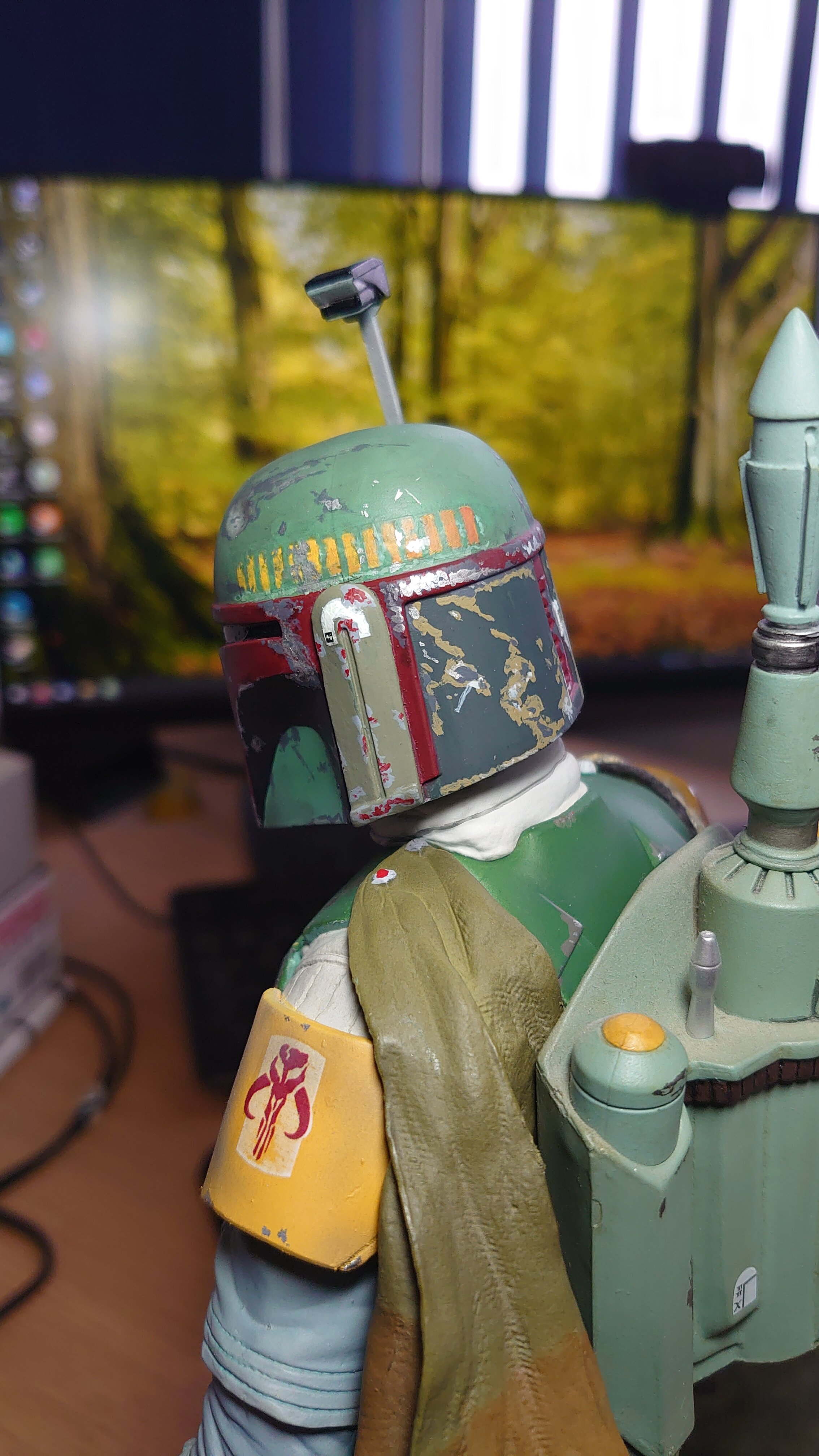

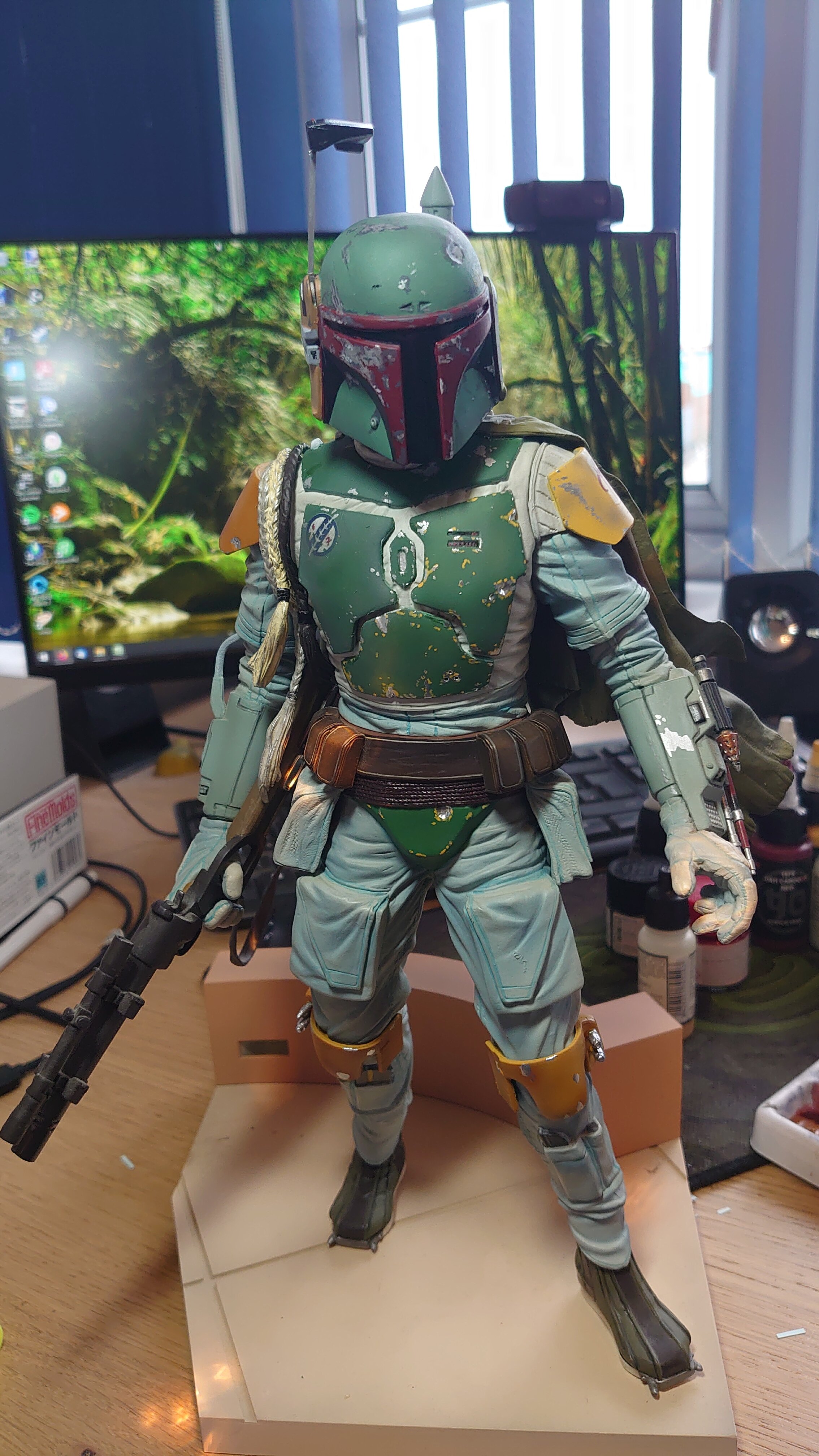

I repainted this Koto Boba, that's SP Armour Yellow on the shoulder which looks pretty good. So I think it's silver, Lark Light Grey, Armour Yellow, misted with Lark Light.

That Boba looks really good.
Did you use their brand specific thinner? Or would Tamiya do? I make my own thinner using Iso alcohol, distilled water, plus flow improver and retarder.
Thanks, full armour repaint, including knees, shoulders, and the helmet. I figured it would look better. :) All the same colours as my full size.
