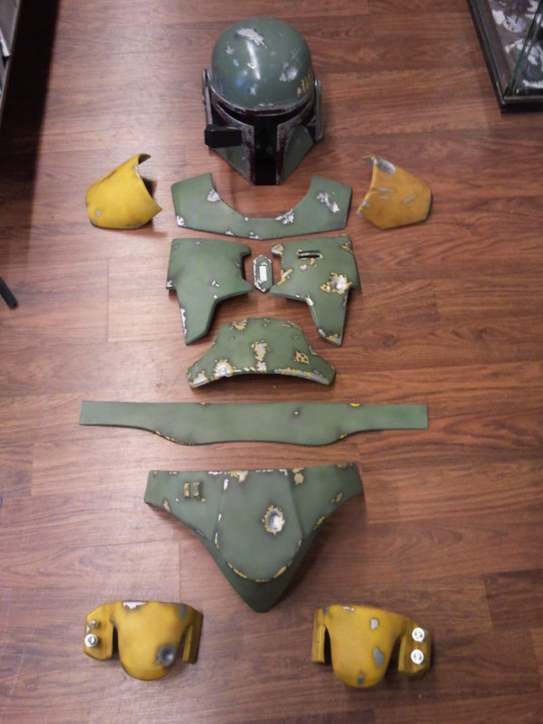

I finally got to paint some armor! It's a Fettpride armor set I bought from a member here. Paintwork is a combination of spraypainting and airbrushing and therefore fits to my routine obtained from the miniature painting hobby. I really wanted to do this so that it would "feel" like my thing and that I'd also be confident in the painting process.
I'm from Finland and it's quite hard to get krylon or rustoleum paints here in Scandinavia, and according to the shipping laws it's not possible for me to order them overseas. That's why I had to do my own research and use whatever domestic colors were available.
I had my helmet in hand to use it as a bit of a reference as I'd like the helmet and armor to be in the same color hues, knowing it would bug me if the armor didn't look "coherent". In my opinion I managed to get close enough with the shades. The Don Post Deluxe helmet that I have is not too certain color reference though, but for the time being...I'm probably going to upgrade the helmet in some point just because I want a better paintjob on the bucket. I don't want to repaint this one as it's a collectible after all and it's in a really good shape. If I want to paint another one (or have it painted by a pro) it's better to be an accurate one from a reputable vendor. But for the shape of the DP deluxe I really cannot put my finger on what people think is wrong, except perhaps the width of the visor.
Unfortunately some battle damage masking was a tad too large (especially in the abdomen) so there's a bit too much yellow and silver visible. For now I'm going to keep it how it is, if it proves to be a problem I'm able to redo it later.
I'm waiting for the Decals so there's no chest logo yet. I did some subtle weathering with airbrush techniques, concentrating around the blaster holes and other battle damage. It still looks a bit cartoonish and I might need to try some weathering powder or other stuff to create some additional texture. In my garrison forum the Fett members adviced that the colors are a little off.
These pics have been taken with Samsung and iPhone cellphone cameras and both are just a bit off from the reality. I think these pics show the armor a little lighter than in reality:
These ones are unmodified iPhone pics where I think the phone settings add some contrast, so it's not exact either. I'd say the actual look of the armor is between the Samsung and iPhone pics. Complicated! As you can see, I need to tweak the shades anyhow as the parts have a bit different color hues. It's because each armor plate has been painted individually by hand and it's all about airbrush control, some wash coat might be thicker on some piece and so on. Fortunately this means it doesn't bug me at all to make it darker/greener/etc... according to your suggestions.
What do you think, should I adjust it more darker, greener or bluer? It doesn't really seem to me that ESB armor was purely green and even the color templates out there suggest it to be more of the turquoise side. It's not a big deal for me to shade it with some airbrush washes so it's just about what you would advice. Thanks in advance!
Cheers,
-Frenzy
In the last image (with the cod and the gauntlets) the gauntlets should have a lighter green than the armor. To be more exact, the gauntlets and the jetpack share the same base green and same weathering, while the armor is a darker green. The best way to see the closest color to the original ESB armor color (which is lost forever) is the existing Pre-Pro #1 left chest plate from the LFL Archives featured on the Blu-Ray discs:
Nice guantlets!!
It shouldn't be a problem to mist the armor with a darker green. Just mask out the damage and mist the armor a bit more. I did that a few times with my armor because I didn't like it the first two times.
You're almost there!!! Looking good !!!!
Thank you guys! I appreciate it. I'll do some adjustments on the armor tomorrow, darkening the armor a bit and perhaps do a little highlighting on the gauntlet pieces.

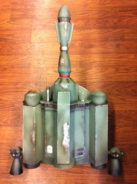

Reporting some progress again, finished some props today! I managed to get the airbrush clean enough to complete the jetpack paintjob. The undercoat was done by spray cans, which was then shaded and highlighted with airbrush. The colors, markings and details are done freehand with traditional brush. Scratches and paint chipping was mostly achieved by patting the surface with foam sponge dipped in acrylic paint. Some weathering was finally added with rattlecans. Tomorrow I'll try to attach the jetpack hooks, already marked the spots for holes today. I also got a word from the maker that my gloves and decals should ship in the duration of next week!

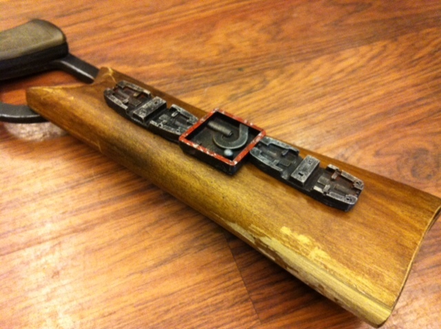

I also assembled and painted the guns during the workshop day... Kits were pretty comfortable to work with and didn't need too much cleaning. Unfortunately I didn't remember to take any progress pics of the different stages, but it was pretty straightforward. The blaster kit didn't include scope or barrel tube, so I scavenged these from the EE-3 that forum member locitus kindly gave me. The stock was in its bare form as you saw, so I first added two coats of Liberol Stain Lacquer I had as leftovers from miniature painting projects. The paintjob was also done in stages, black undercoat with spraypaint, drybrush by silver, some detailing, colors, weathering and finally a clearcoat varnish. Before sealing it up I brushed some weathering powder in strategic locations to achieve some rust effect. For accuracy I also chopped a piece off from the stock.

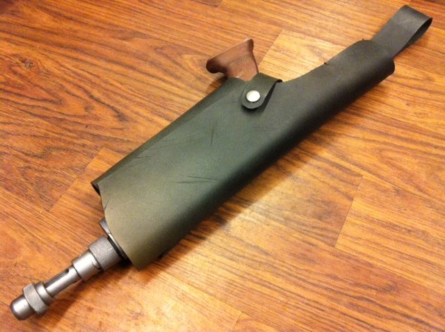

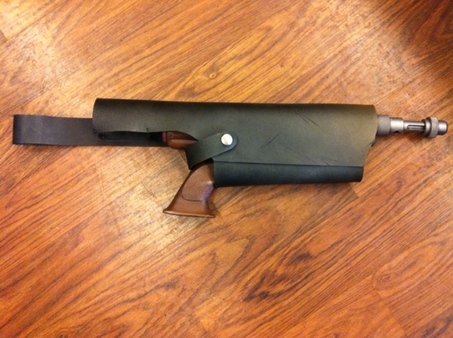

I decided to scratchbuild the holster to serve it's purpose as long a FP replica of the actual holster pops up in Cargo hold... I bought two pieces of black rubber sheet, which I bent and superglued into holster form. The strap attaches with a small magnet. The actual design of the screen-used holster is so complex that when I contacted some local craftsmen and leathersmiths even they felt challenged with the reference I sent them. This simplified version shall now serve until a better alternative presents itself.
Oh and there was some pics as well! iPhone quality, but what can you do, my main cameraman and equipment is enjoying warmth and welfare in Hong Kong at the moment. :)
