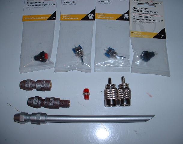

O K I have made/painted a few things ( shoulder & knee armor ) , toe spikes and an ammo belt , but I have no expirience in this area . A few months ago I purchased a Ruffkin gauntlet kit ( see pics ) and have made/ purchased some accesseries for them . I have a couple of gauntlet sets ( Ebay) which I'm not 100% happy with , so I figured I would start from scratch and with the help of the TDH community ( all you all knowing all seeing experts ) I would give it a try . Let me start buy saying , I dont have an air brush so I need to use ready available paints etc . There are many questions and I need the step by step , from scratch to the end .Do I go topical or layered with liquid mask as I did with the knee & sholder armor ( see pic )?How do I prep the styrene? Do I need to prime ? Any & all advice would be MOST appreciated .I'm sure this has been done over and over but ....... Thanks people !
