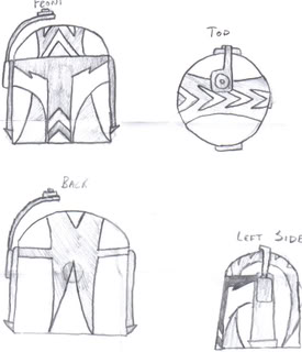

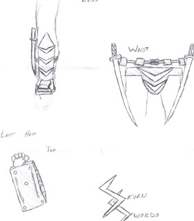

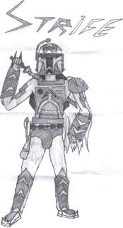

1st time Custom Costume
Ah, i just saw a picture of it on the internet. I was looking for a color scheme or some paint tips. I really didn't mean to steal it, i knew it was from someone. I just wanted to keep it because I liked the orange. ^^ Thanks Rylus Kote for the color scheme, I'll be using it as a base for mine. ^^ I just love the orange on black. Sorry NovallTalon, didn't know it was him.
Of course it is a custom, and it won't look anything like his in the end...I just like the colors. When I'm finished I'll dig up this picture and compare us...the difference will be pretty obvious. But thanks for letting me know, I never want to steal anyone's work. And I love giving credit if I can.
Dude i think getting yourself lined out is half the battle When i first started i was browsing threads and yeah you'll see alot of similar jobs to the one you want always will there is to many of us fans to be 100 % original but i really think the love we give our costumes will be what sets them apart now we as members of TDH all love what we do this is completely fun for us i live for learning now that in mind work your own magic on your costume i've been going back in forth on mine since i started luckily the guidance of some pretty senior people here will always help ya out and dont forget always always ask questions someone will know the answer i hope this helps Good Luck and Happy hunting
Hey I got to run but I just wanted to let you know I think your idea is really awesome. I'm just starting my own Mando/tribal warrior looking outfit. I too changed my design from a sniper to more along the lines of QCB. Take up close and taken quite... thats more my style. Good luck can't wait to see more of it.
I have no idea where I am going, I will just see where my creativity takes me when I'm actually making stuff. ^^ My helmet...is having some problems.
