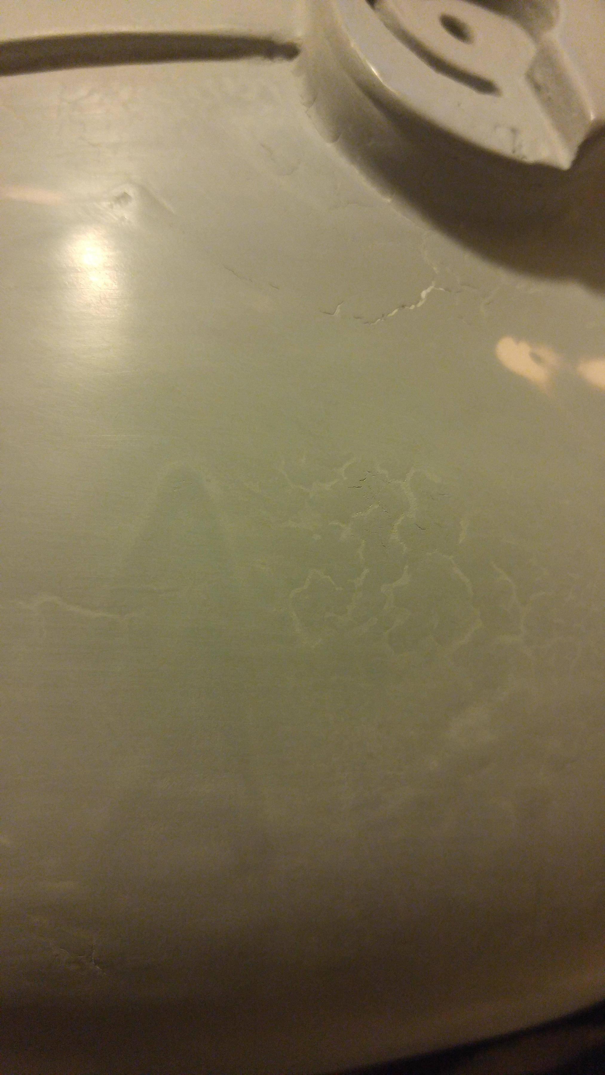

Hey guys I keep getting these little crevices and skin like patterns. Any help? I'm sanding like hell.
Agreed. Thin coats and allowing it to dry between coats is the trick. Read the can to see what they recommend for drying time between coats and remember that cooler temperatures will lengthen the drying time between coats. Don't try to get complete coverage with one coat. First you will need to sand down all the cracks and wrinkles so it is smooth again before painting. Also make sure that the surface is clean and free of oil, even the oil from your skin can cause problems. I use isopropyl alcohol to clean surfaces before painting, but always test it on an inconspicuous area to make sure it doesn't react negatively with the plastic. Never use Lacquer Thinner or Acetone it almost always softens or melts plastic.
