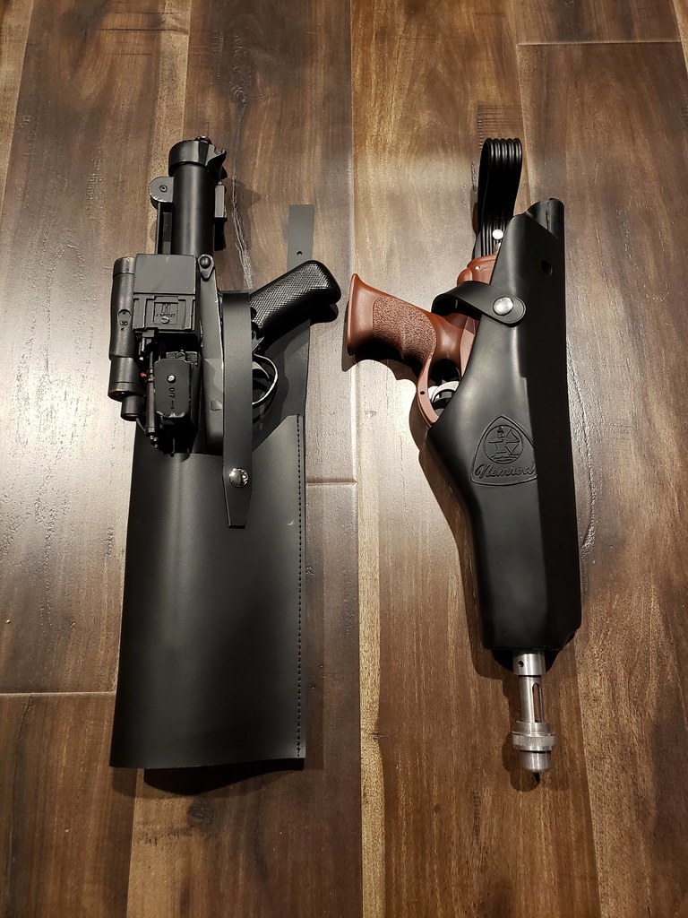

Snagged a Portumac Studios Pulce, this is an amazing piece. I paired it with a BobaMaker Nemrod holster.

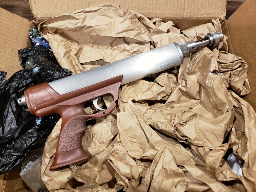

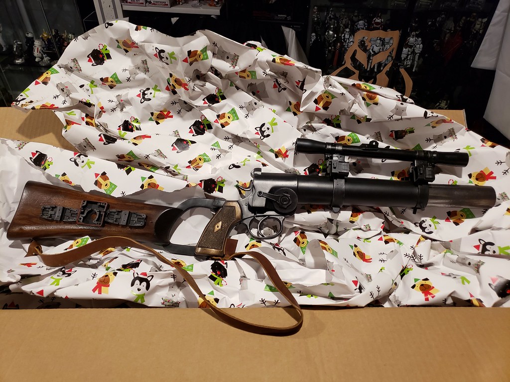

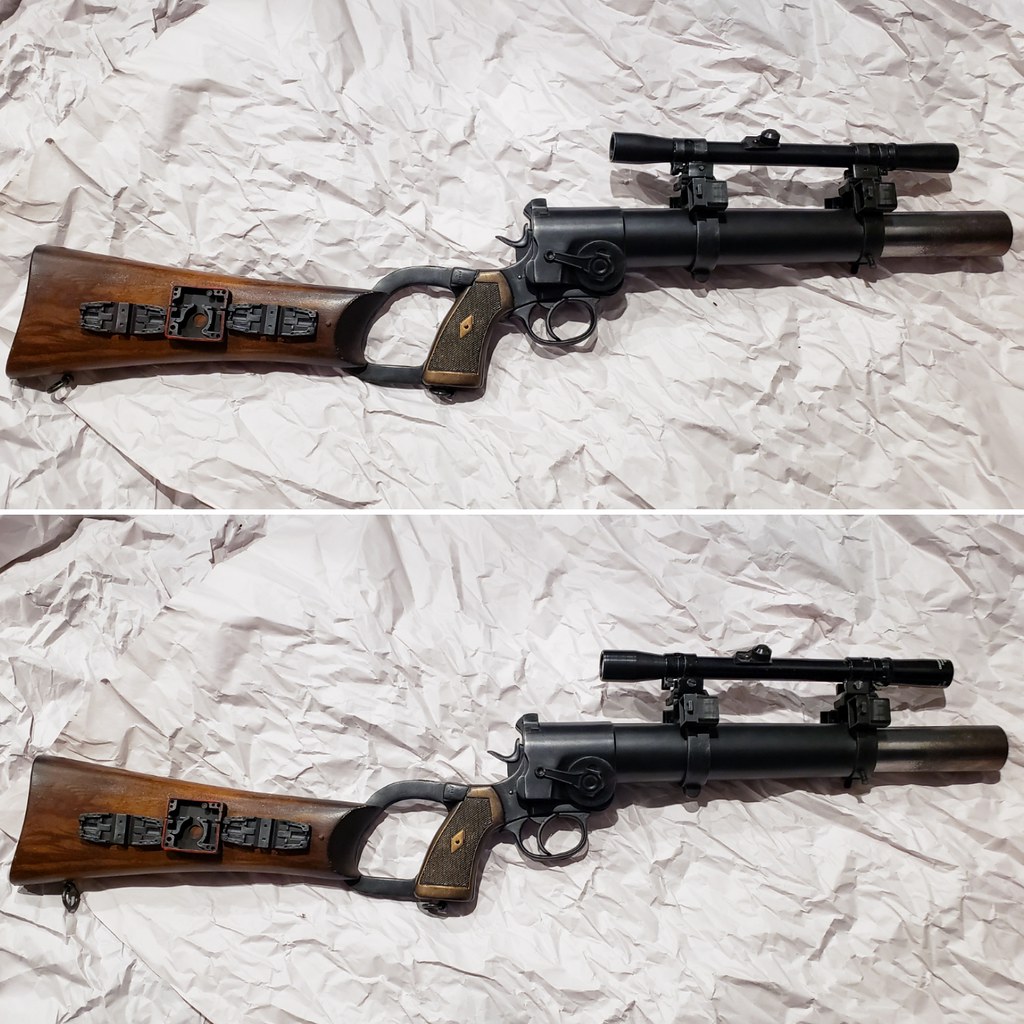

I sold my "Iconic EE-3" resin blaster kit and bought a Hellhounds Props EE-3. Very satisfied for an all rubber blaster. The wood grain paint job still blows me away.

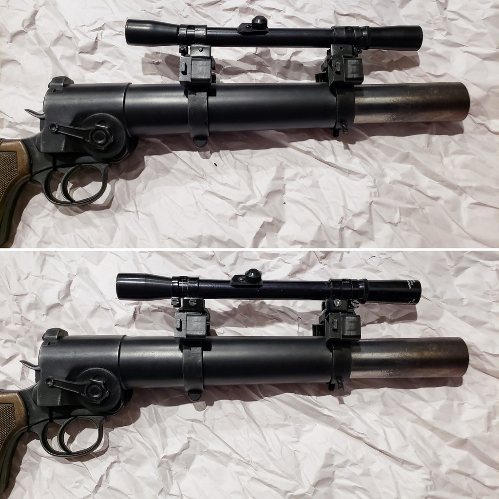

I've since added a Crosman 4x20 scope to the blaster, I like the touch of realness that it adds to the blaster as a whole. Nothing like seeing the glint off the lenses.

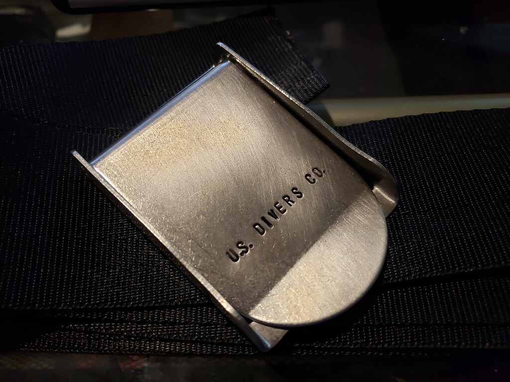

And I got a U.S. Divers belt buckle from Bigdane to go with the scuba frame I got from him previously.

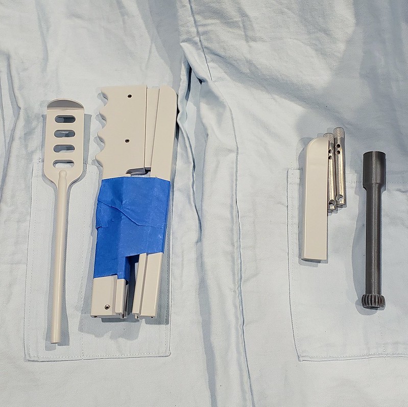

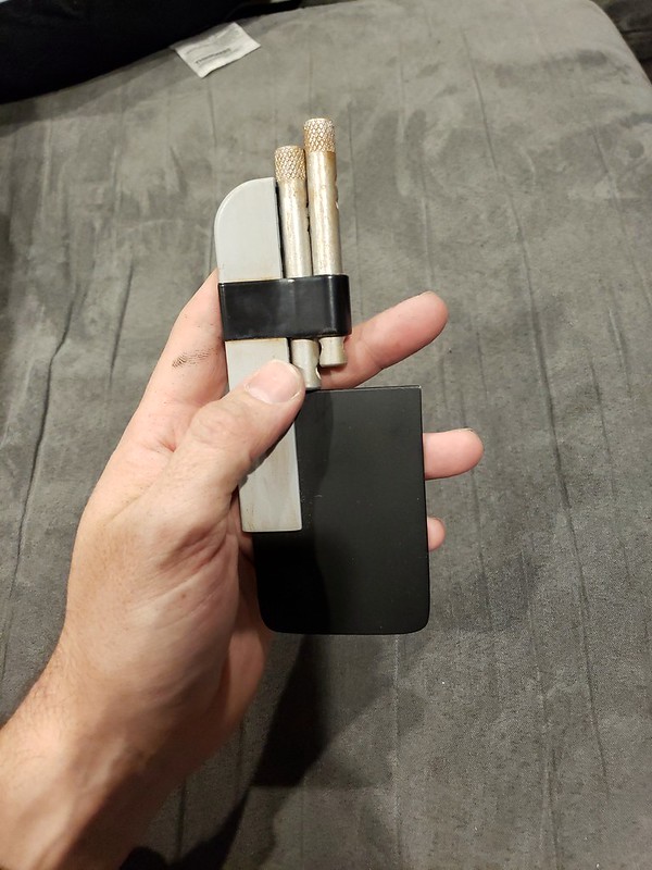

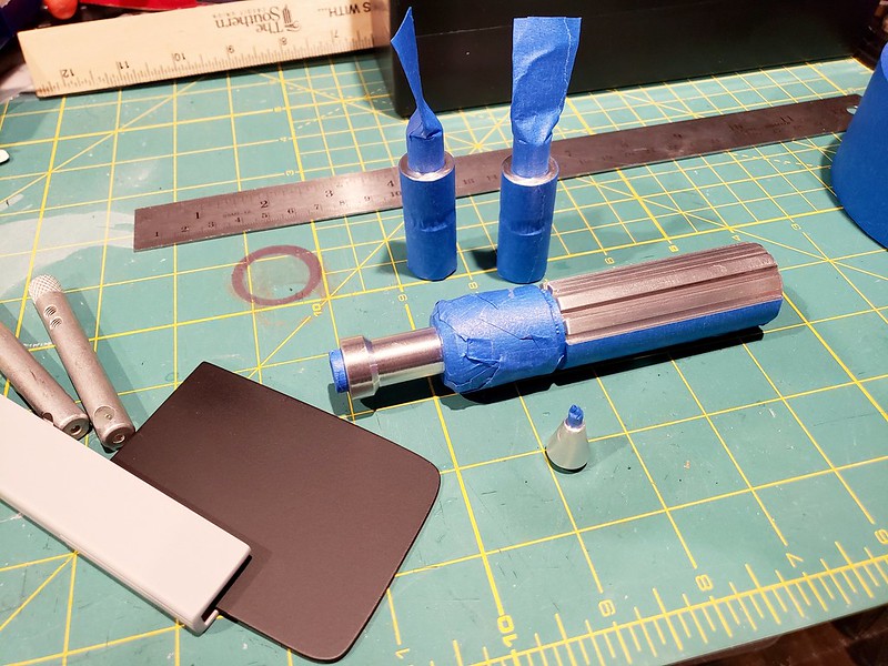

Let's see. I did some work on the shin tools. I took the Paterson tools I had ordered from B&H Photo, cut them up and painted/weathered them. I then 3D printed a jetpack adjustment tool but I may switch that out for the "found part" pipe later.

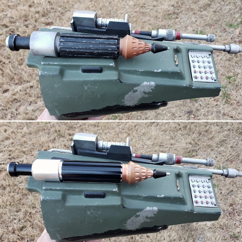

Masked off and painted my MachineCraft Replicas knee darts and gauntlet rocket:
Knee darts attached:
New rocket installed, I went with copper, definitely worth it!:

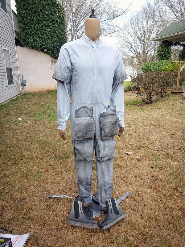

I was not satisfied with my first weathering attempt on my flight suit, hard to describe the result but the fabric started looking like denim. So that came off and I brought in the little big gun (it was a good excuse to buy an airbrush, at least that's what I told my wife):
Knocked out the flight suit and boots in very little time and I am much happier with the result:

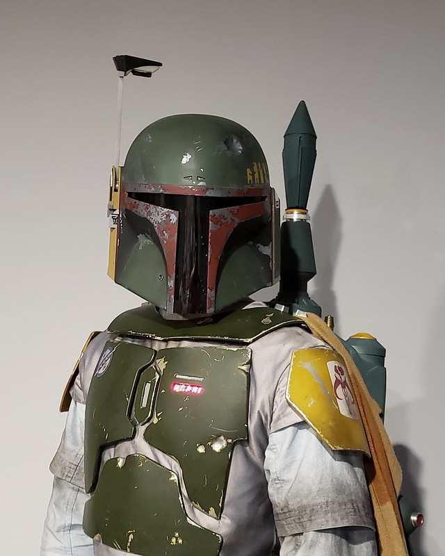

Last weekend some Garrison friends who are also neighbors of ours helped fit and sew up the harnessing for the jetpack scuba frame. That was an adventure to say the least. But it's done and the jetpack sits nicely against the back armor and doesn't droop backwards, which was the main goal. Did a chest up shot to celebrate.

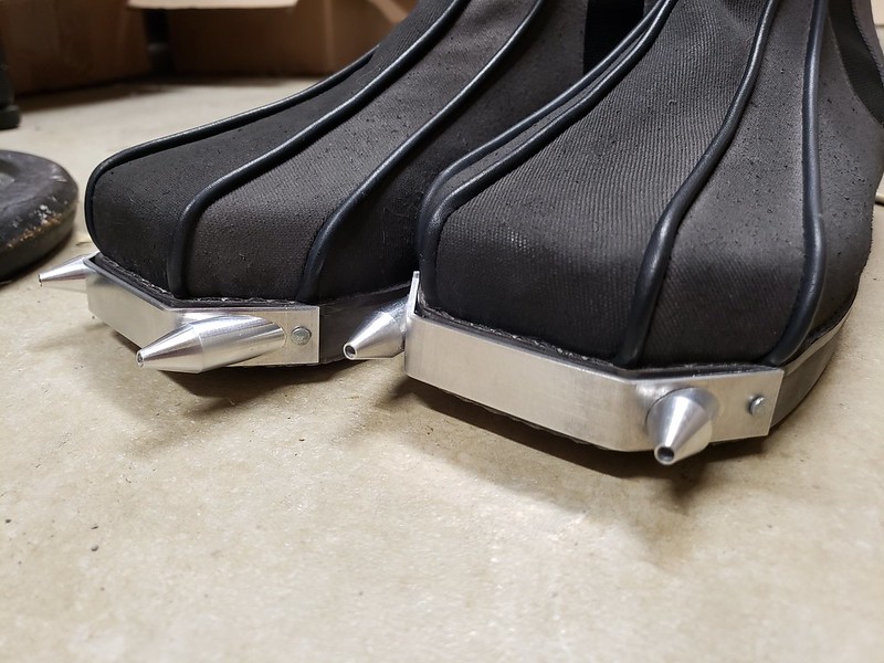

Now I've been working on little projects/details. Added the toe spikes (still need weathering):
I wanted the rivet look instead of a screw, I had in my research notes that someone on here had used floor trim fasteners (I'm sorry I didn't note your screen name for credit) and they worked perfectly. They've also got some bite. I simply marked where the holes were going to be, predrilled those with a 1/16" bit, dipped the fastener in E6000, added E6000 to the back of the spike plate, put the plates in place, and pushed the fasteners in. Then allowed that to cure. They now seem to be very firmly attached to the front of the boot, but time and troops will tell.
Also, if anyone would like a set of these fasteners to do their own boots, I'm happy to share, this huge pack was the only way I could find them at the time and they weren't expensive. Just shoot me a message!

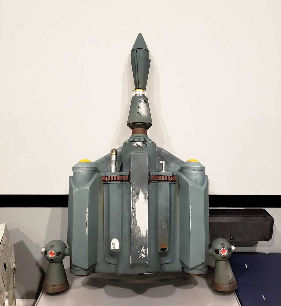

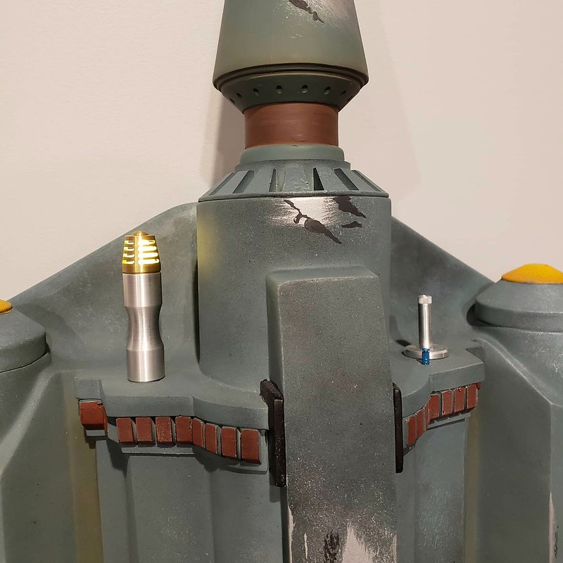

Moving along I added a beacon light kit from Jc27 and installed the blue dental file into my jetpack:

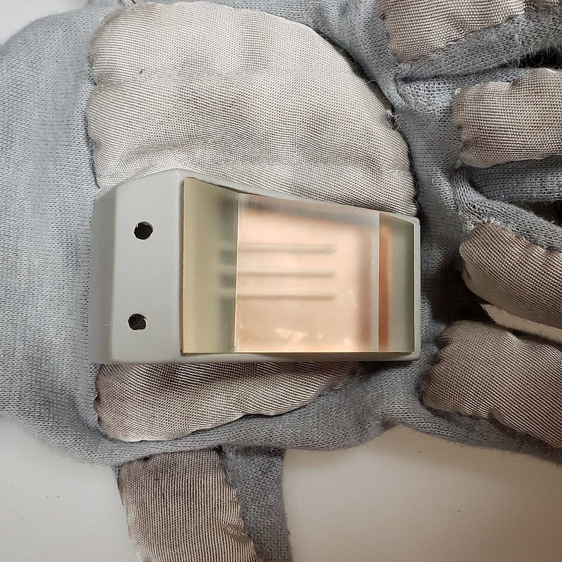

I have a spare RF topper that I'm going to finish with a lighting kit (also from Jc27) and install on my current helmet. I had noted that the TerminalFettler RF topper had a copper plate under the block, so I mimicked that as best as I could with some copper plating I had from a previous project.
