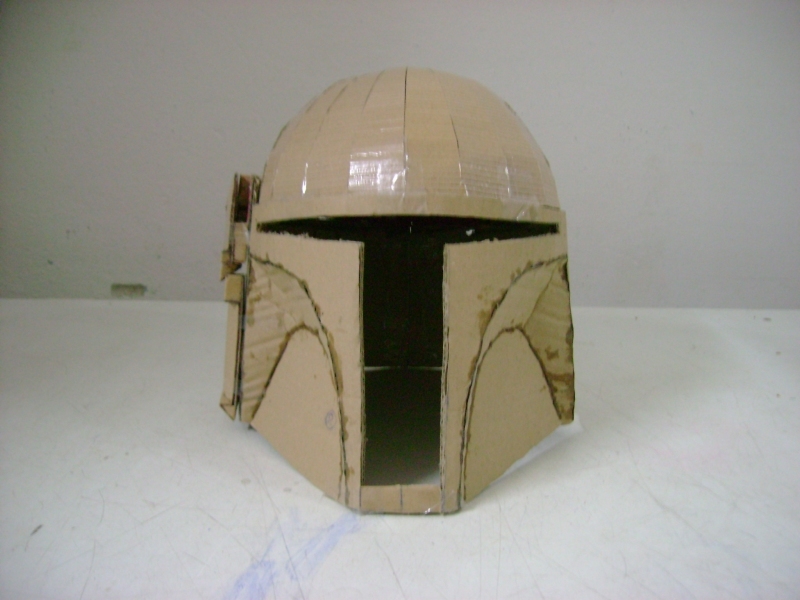

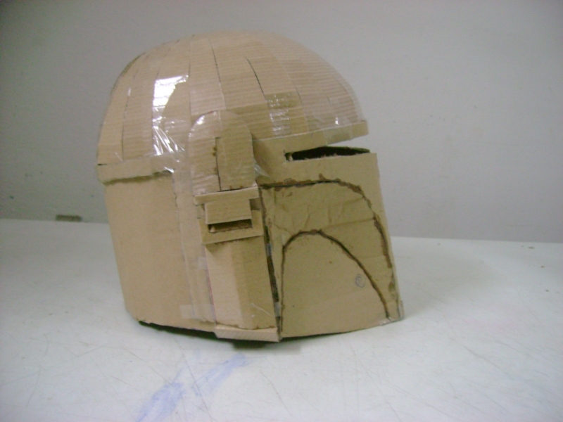

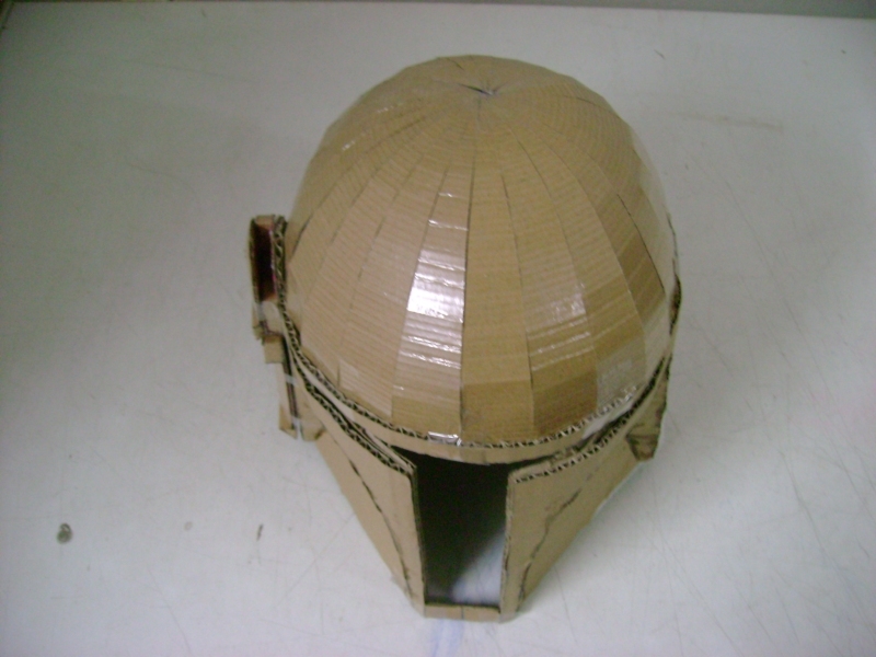

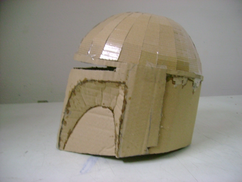

Today we will witness the rewriting of the Boba Fett helmet history. After many weeks, or I can say months, I managed to dig out this amazing piece of history: THE UGLY HELMET!!!
I'll be serious now.
I made the helmet using cardboard for packing boxes, this is why this helmet looks ugly. But I wanted to do this to see if the 1:1 templates will fit well. As you can see, the left ear is the one from post No. 57 and is holded in place with duct tape. The overall look is good, and the dome came out really well.
Until now I made the bad helmet (prototype 1 - the scaled down red helmet), the ugly (prototype 2 - this 1:1 helmet) and the next will be (I hope) the good helmet.
Don't hold it for yourself and say what you think about this helmet.
Respect!
I made some comparison images with the ESB hero helmet versus the RWH (Rafal Works Helmet) Prototype No. 2 to see if the proportions are good enough. I think the cardboard I choosed to build this prototype was a bad idea, but helped to get really fast an 1:1 helmet. Boy, that's one ugly helmet...
Respect!
Dude that is crazy awesome. I am very impressed. Must have taken a lot of patience. Consider yourself probably the 1st person ever to have a screen accurate Cardboard Boba Fett helmet! Hahaha! I like it. So what's the next step?

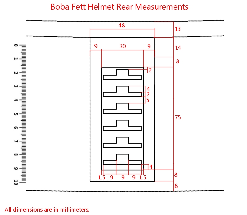

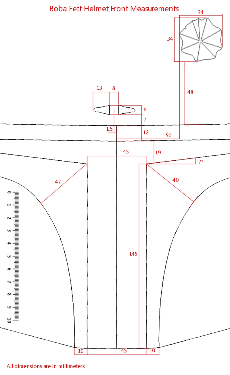

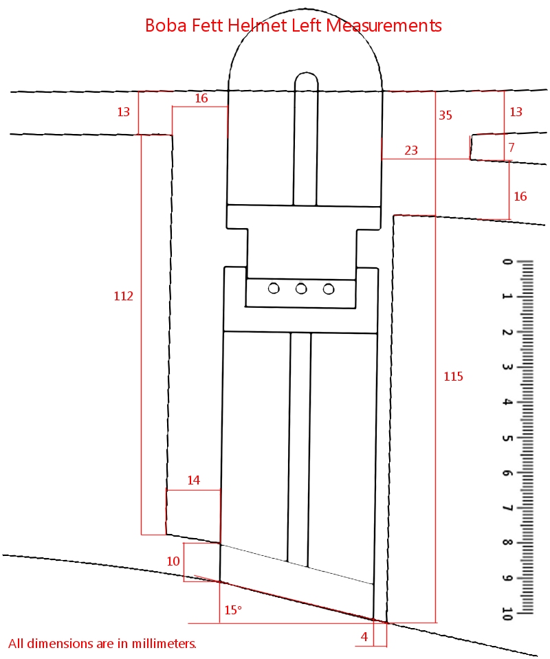

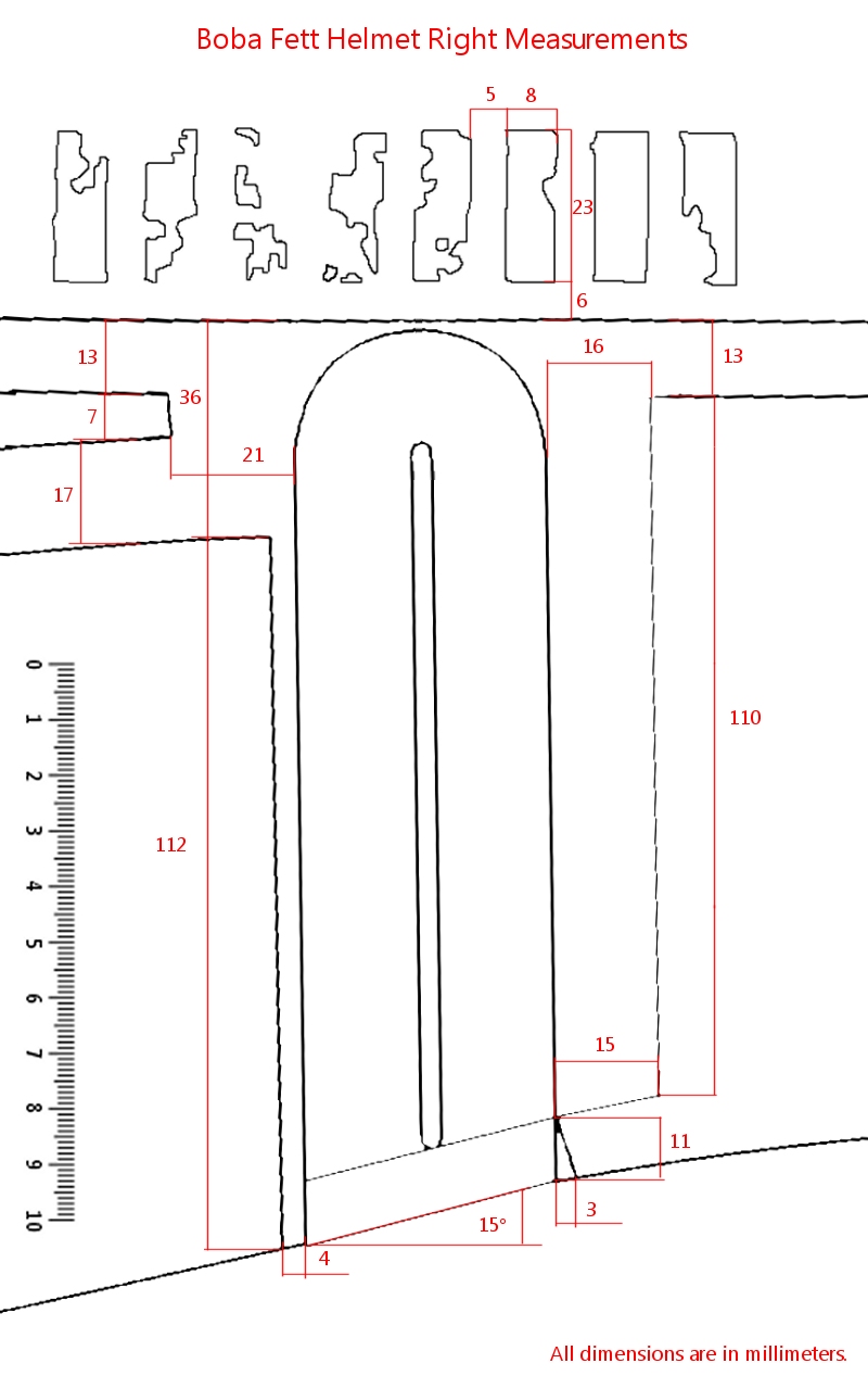

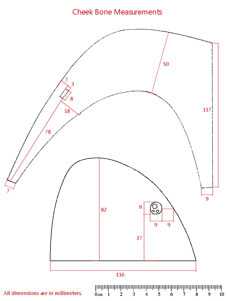

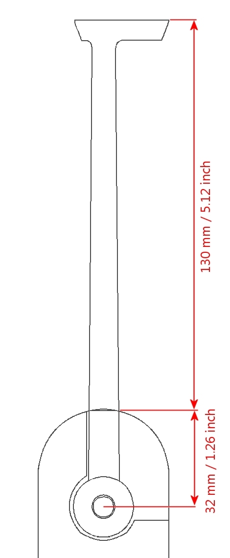

I managed to get some measurements of the movie sized helmet using reference images from the gallery, my templates, some comparison of TK409 Mystery Helmet Measurements and (sadly) poor information that you can find here on TDH. I think that most of these values ar ok but I may be wrong.
So, here they are.
frontsidemeasurements.jpg rightsidemeasurements.jpg rearsidemeasurements.jpg leftsidemeasurements.jpg earmeasurements.jpg cheekbonemeasurements.jpg RF Stalk Measurement.jpg
I hope that some of you may do some measurements of the 'real helmets' to get some values for comparisons.
Respect!
Dude you have really nailed it those mesurments are , from what i can tell perfect,,
And i look forward to making a helmet up with them
