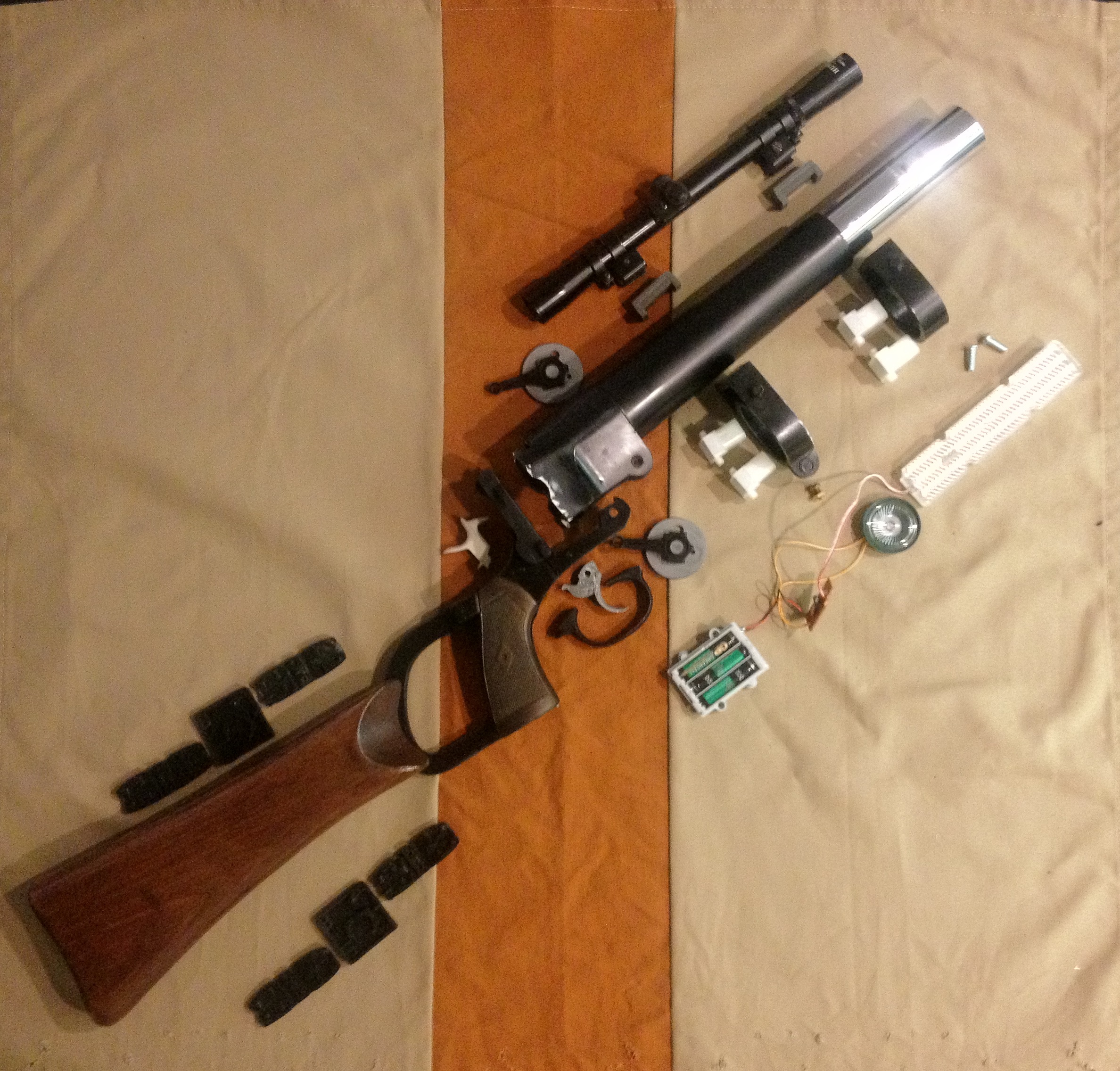

As you can see, my original plan was to use the electronics I had harvested from my son's Hasbro EE3.

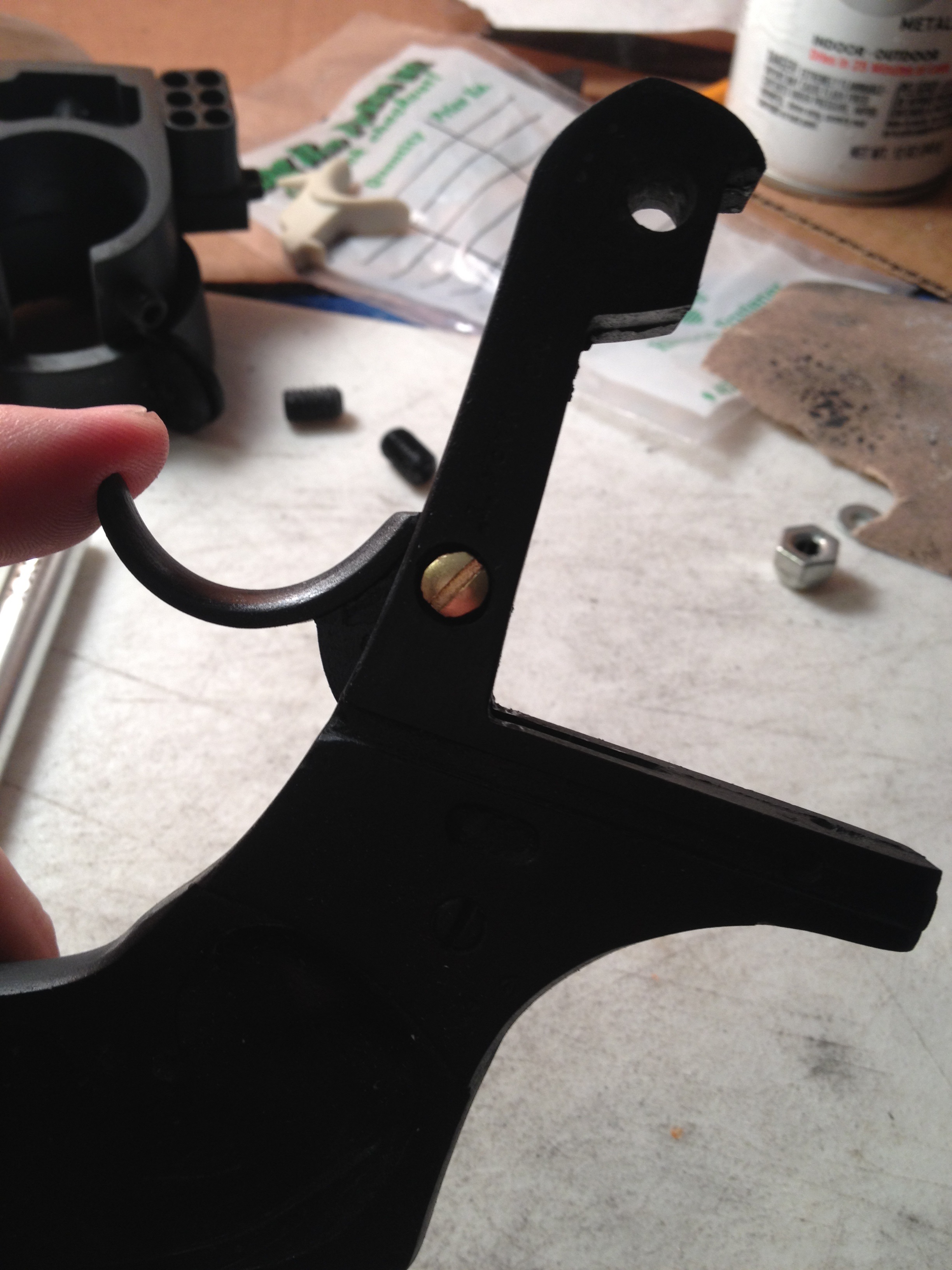

Next up was making the trigger functional. Pretty basic concept. Mike sent me a flexible rubber trigger as well as a resin one however I chose the most accurate resin trigger and proceeded to hollow out the inner trigger area.
Trigger fits, a little help from some washers, good to go.

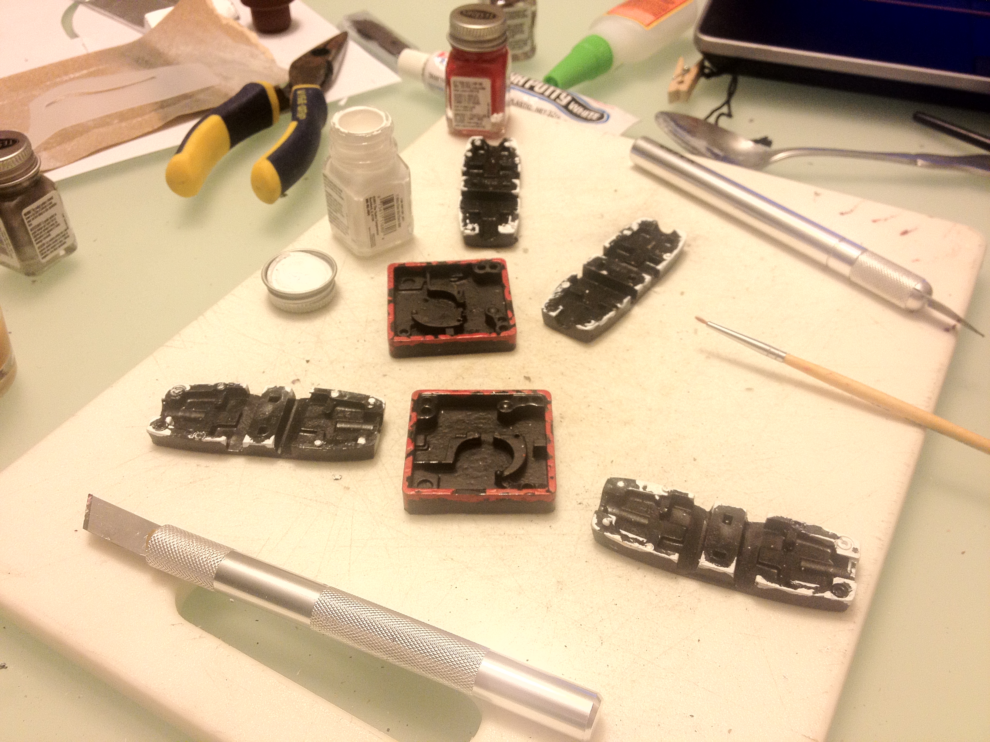

Stock greebs painted, spent way to long going over reference shots to get them on point.
My build is based on Bespin Boba, so I will be adding both inside stock greebs as seen below.

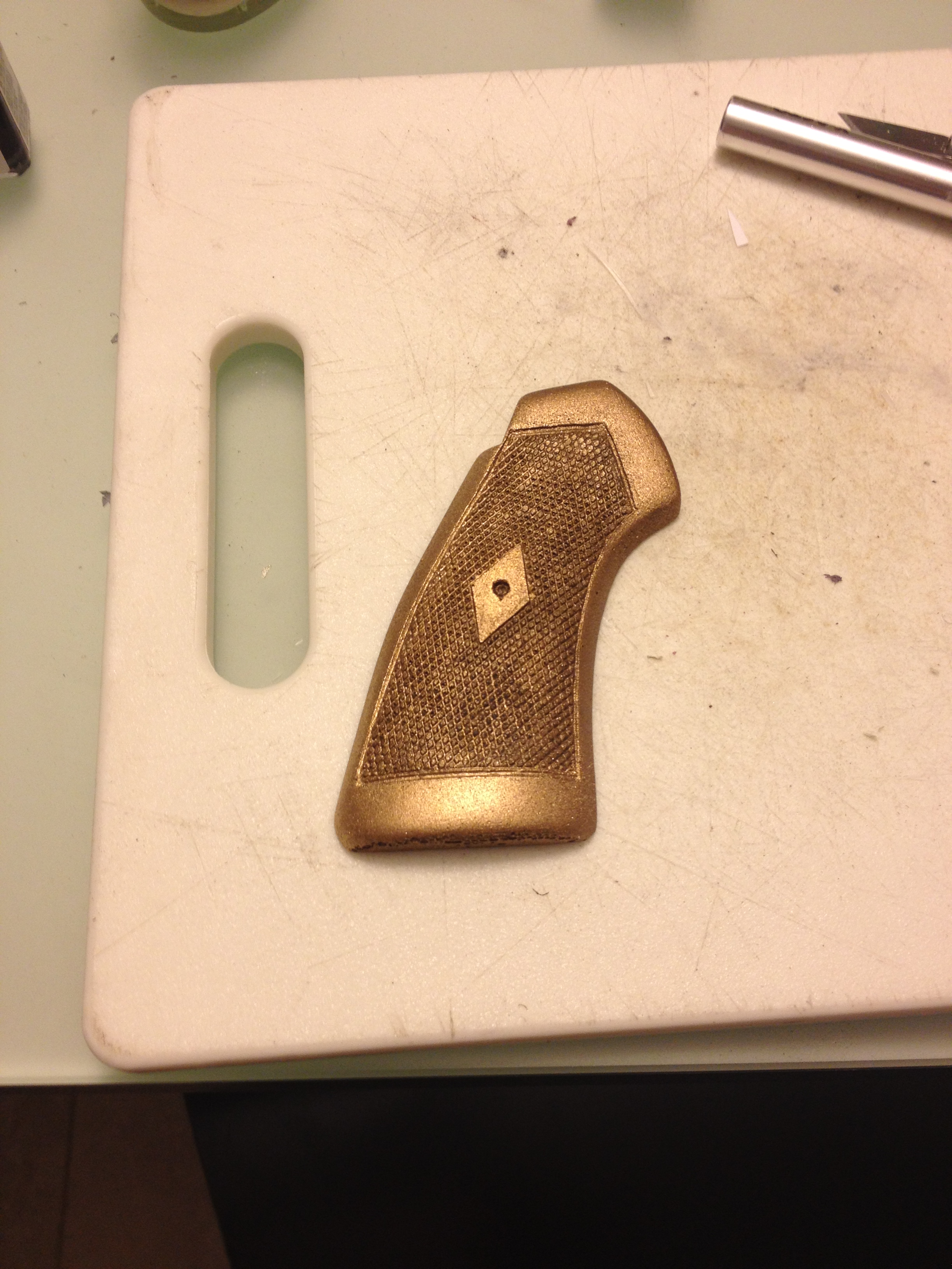

Had the pistol grip gold plated, just kidding.

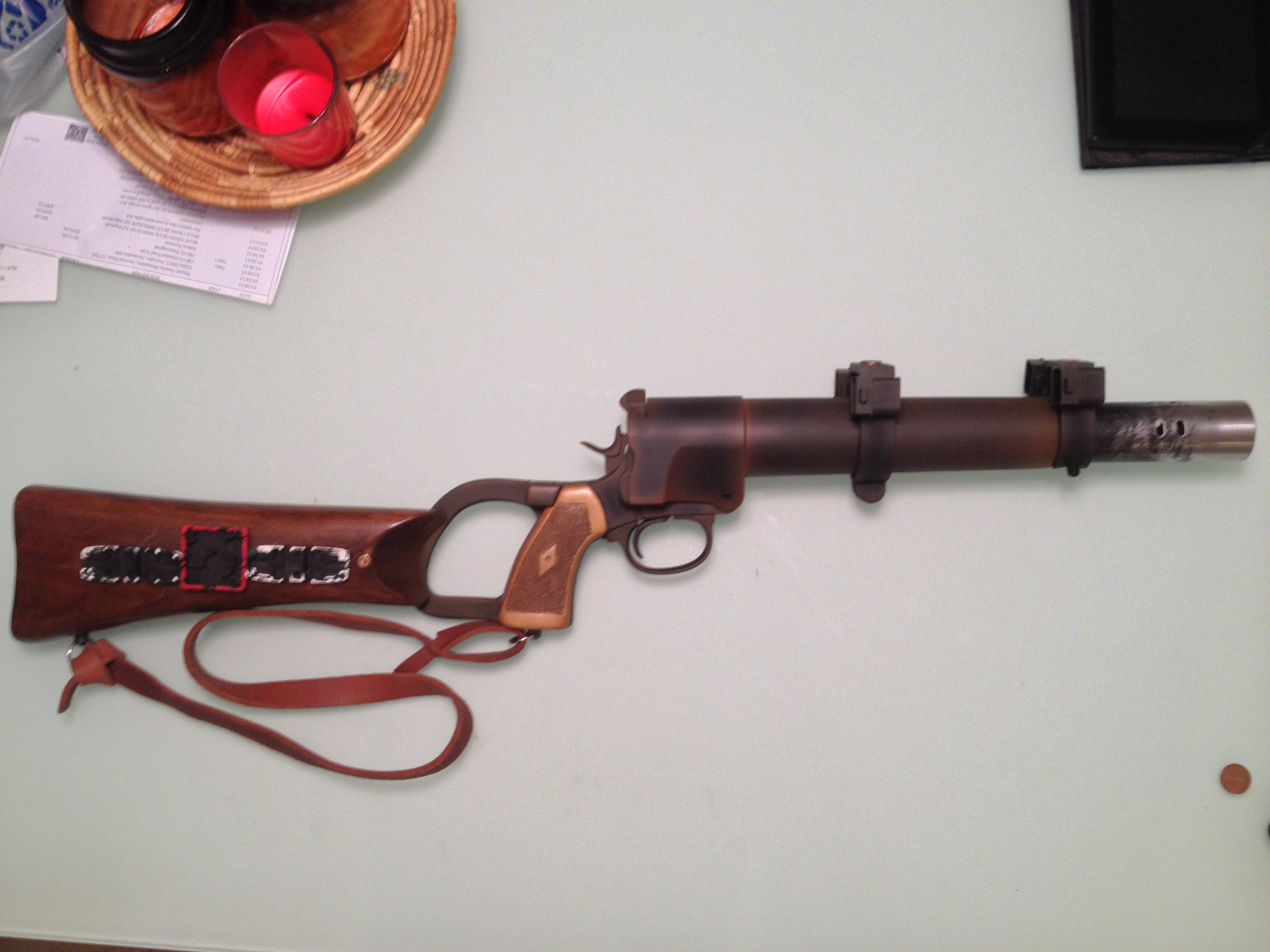

Starting to resemble something familiar...
I picked up some sweet Uncle Mikes sling rings, sourced the pin for the barrel hinge at Ace, attached the stock and the grip to the bracket and secured the stock greebs based on more unnecessary hours of studying reference photo's lol

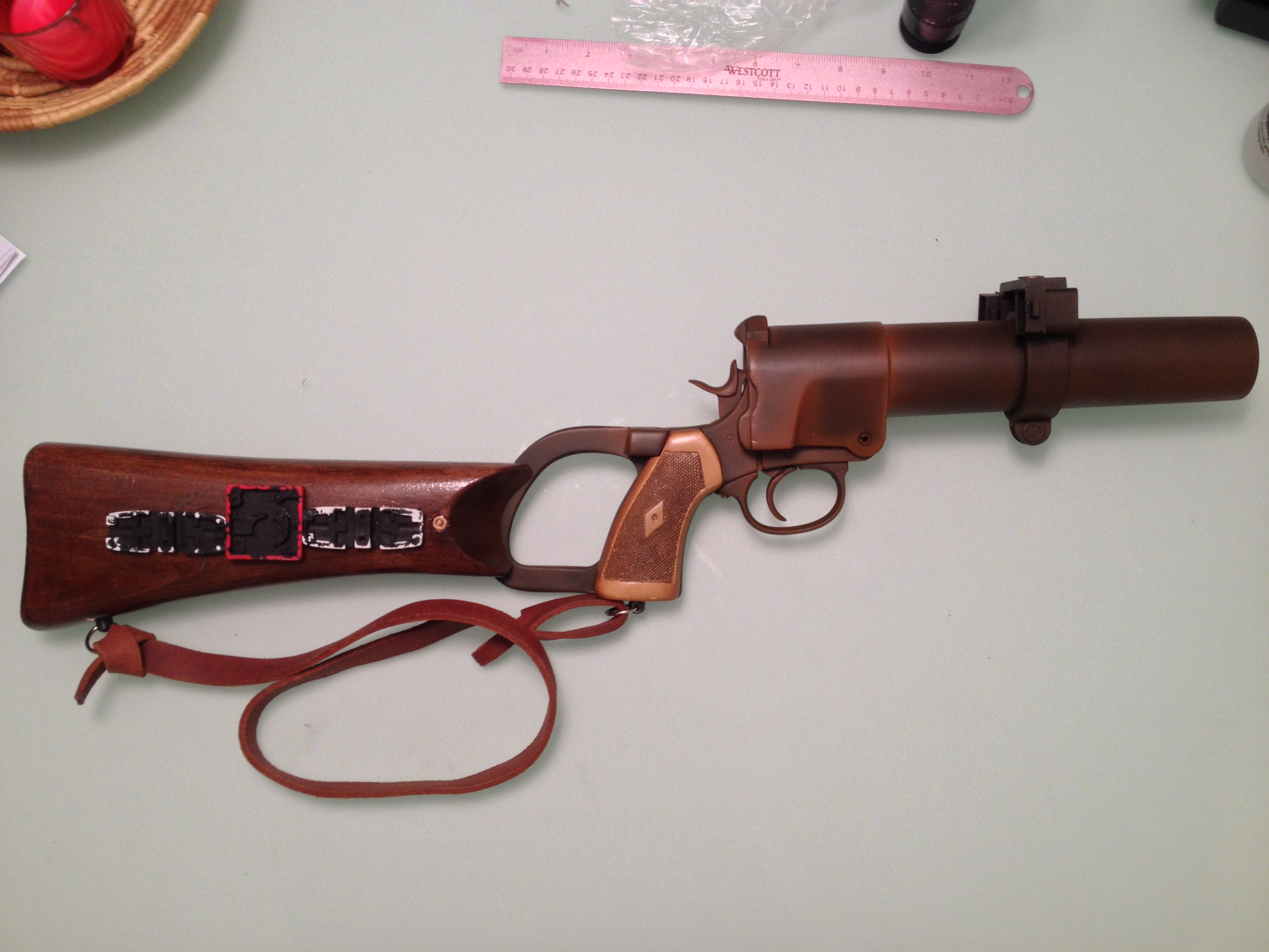

After Duplicolor primer, I used Krylon Fusion Camouflage ultra-flat black, then misted it with Rustoleum 2X satin espresso to give it a bit of that dark bronze base. The end result...
I do regret adding the stock greebs before completing the Webley and taking this picture but, alas, oh well!

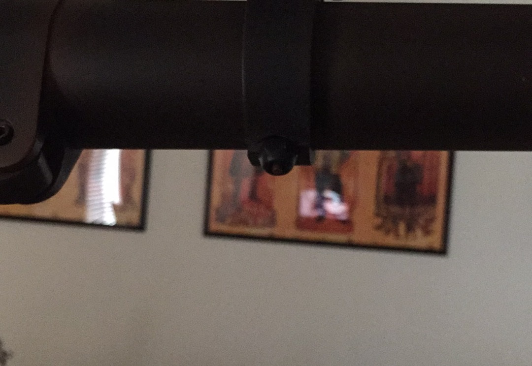

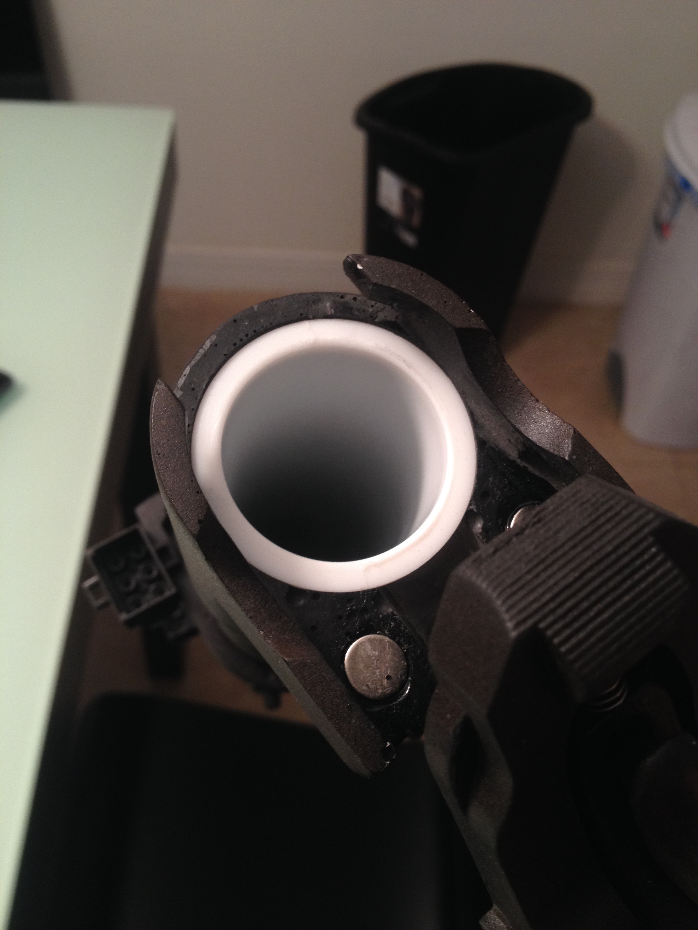

Knowing that I was destined to add the electronics meant I had a bit more motivation to make sure the barrel was overly secured when closed, and since I've been somewhat addicted to magnets since I was a kid, big ones, small ones...its a problem for me, i decided to use some powerful N15s I picked up from K&J Magnetics to help things stay in place.
On the breach...
On the breach lock...
I figured that since a real Webley MK1 uses a spring to aide in securing the breach lock, they may just be on to something so I added one as well :)
We'll see how that works out a little later.

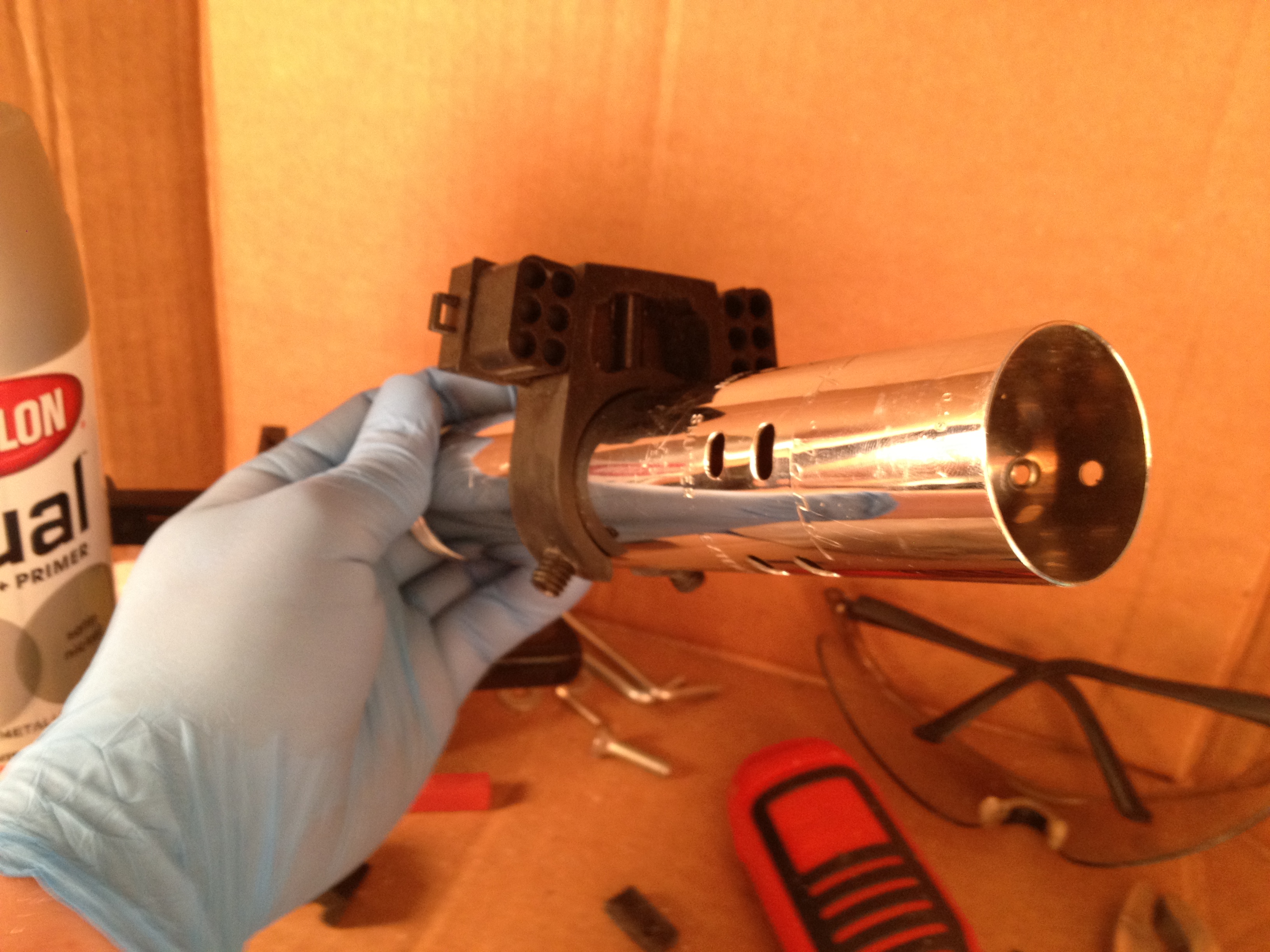

Remember that bright shiny Heiland???
A little Rusto 2X satin black and not bright and shiny anymore...

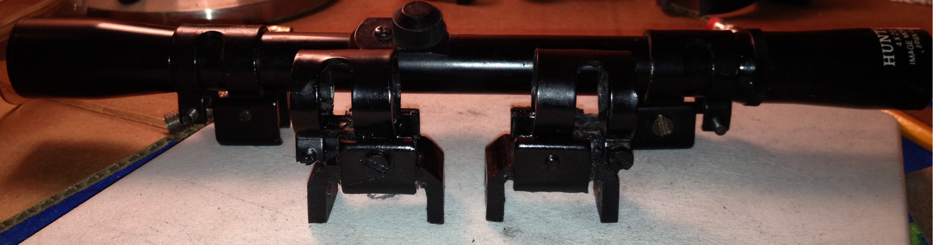

I had little need for the super clean casted scope rings that came with the ICONIC kit after acquiring the vintage Hunter from Andy. I would however, need to rethink the shrouds used to attach them to the barrel mounts since Mikes had them molded into the casted rings.
I ended up contacting Simon for a set of his shrouds. In the mean time, I figured that the casted ones, in all their beauty, at least deserved a brief moment in the spotlight. So I slid them on my cheapy eBay 4X20, added some paint and wtih a little help from some magnets, I told you its a problem, took what was now an EE3 out for a little test run as Boba the Bounty Hunter.

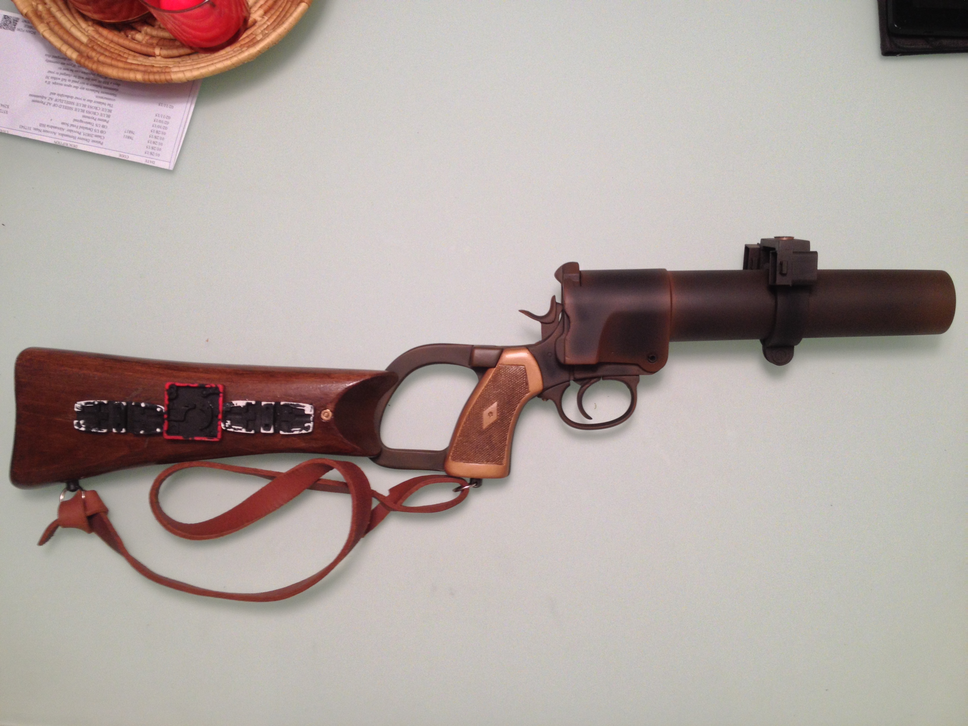

With the trial run behind me, time to break out the Badger for some bronze-ish accenting of the Webley.
WHOA, take it easy Walmart adobe orange!!!
Ahhh, that's better...

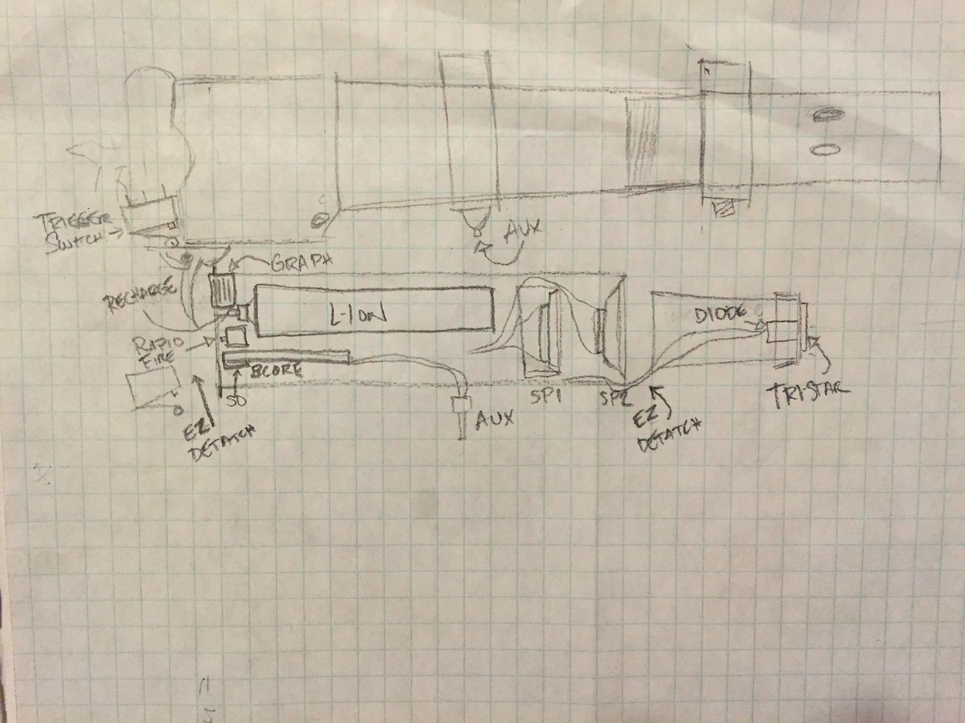

First things first, needed to draft up a schematic and get a rough estimate as to what goes where...

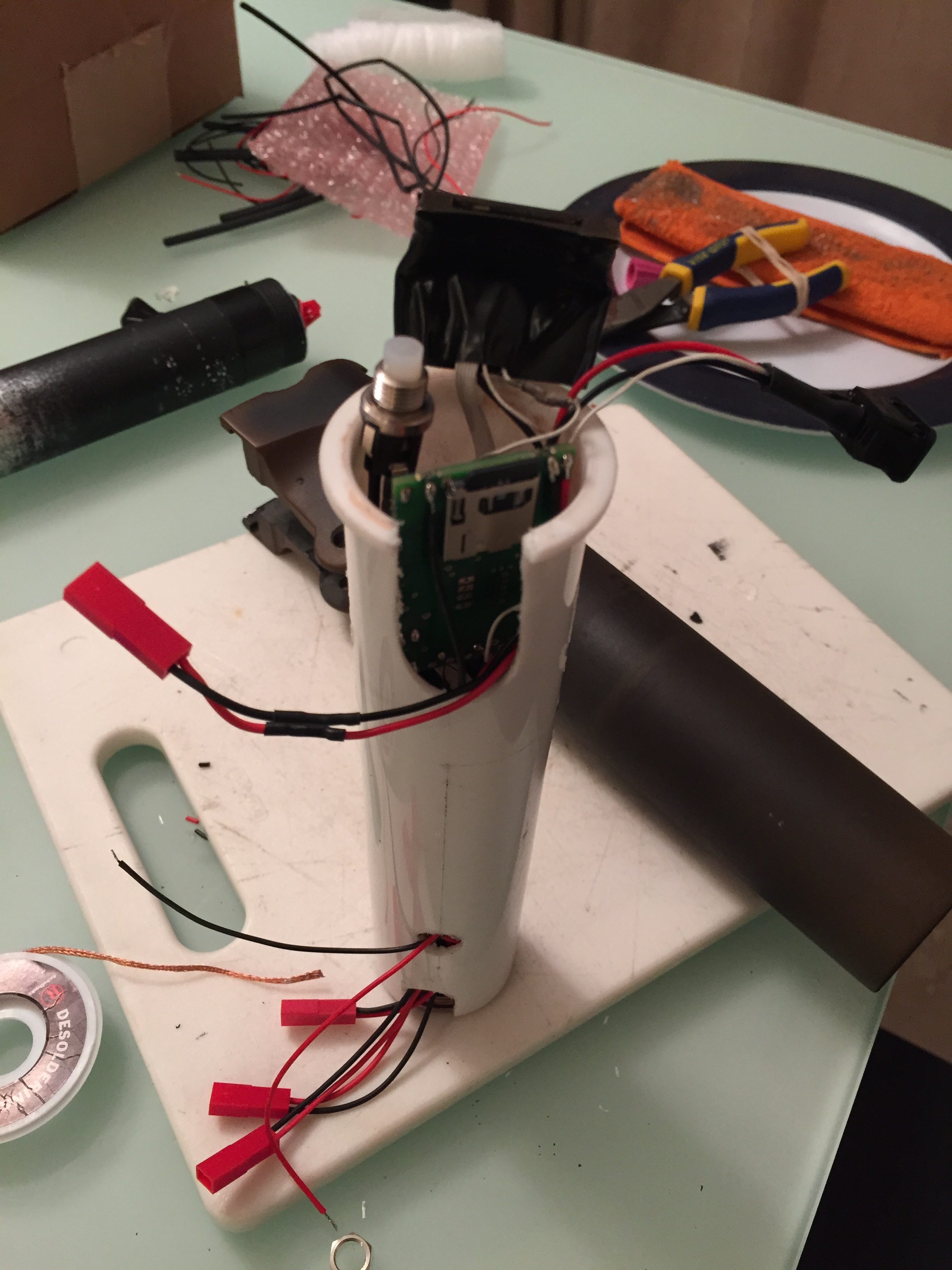

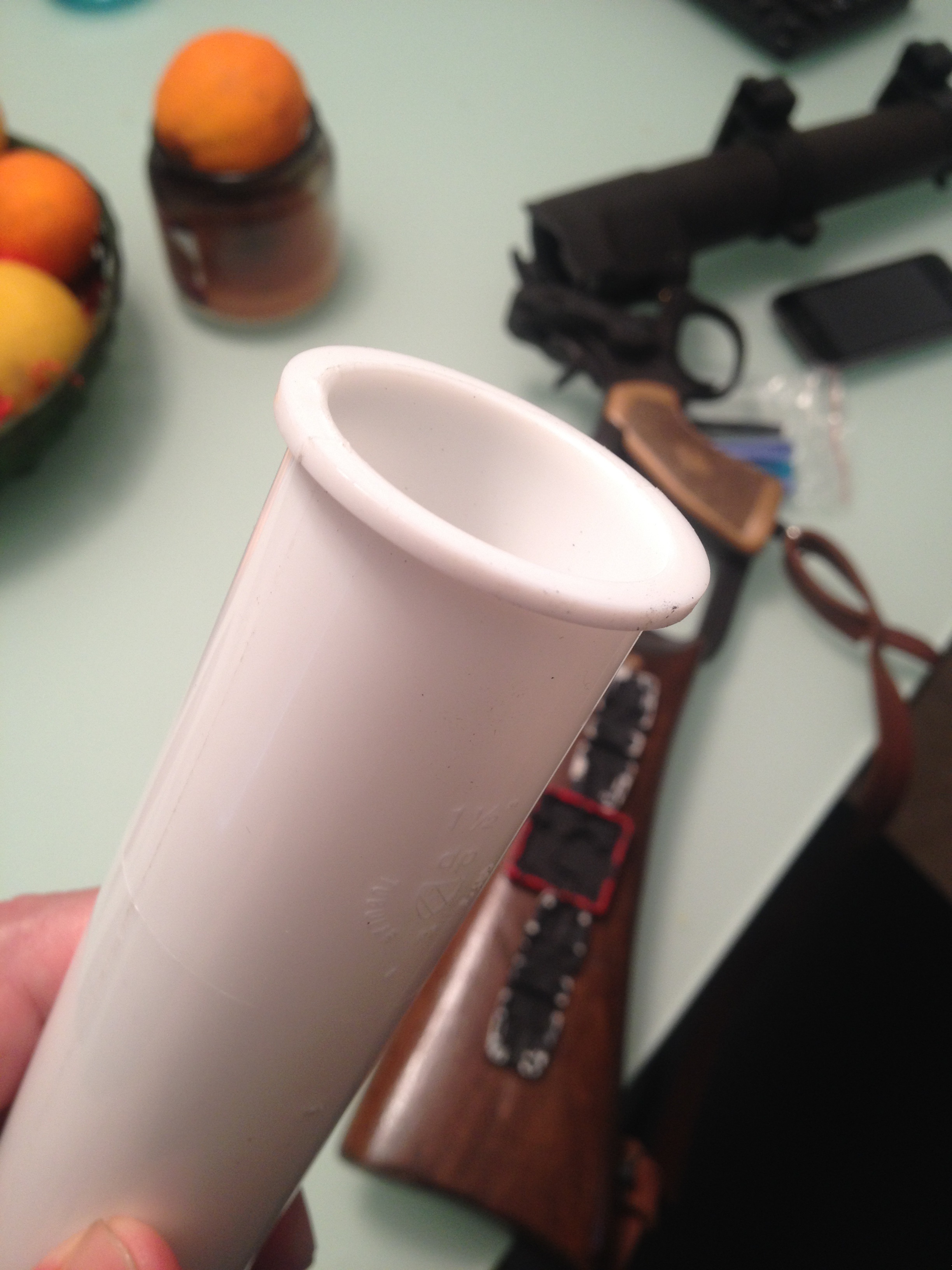

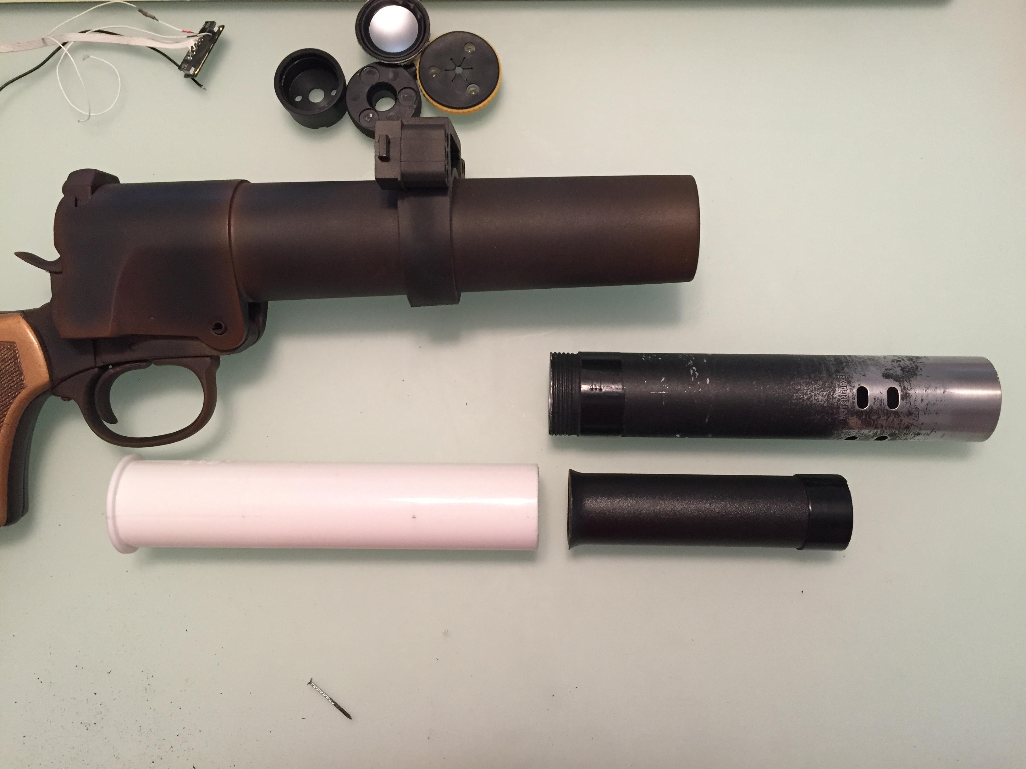

With a rough plan as to where everything would go, I set out to Ace for some sort of housing for the electronics. My had originally planned on using PVC based on RedArc's build however when I saw the sink tubes, the PVC idea was out the window. The sink tube is super low profile which allows for even more room to cram everything into. When i got it home, I was even more amazed that the tube was a perfect fit down the barrel and the lip of the tube sat completely flush in the breach which secures the tubing in place once the breach is closed. This also allows me to completely remove the entire assembly like you would a spent flare gun cartridge...
boop!
Now that I had all the inner housing components, I was able to make adjustments that ensured everything inside had the maximum clearance while also maximizing the space provided. The sink tubing, once inserted, backs up directly to the flash tube. Inside the flash tube is the LED/laser housing. Thanks to the threading on the Heiland, the LED/laser housing only slides in so far, allowing for wire connectors from the main body to the LEDs and laser diode.

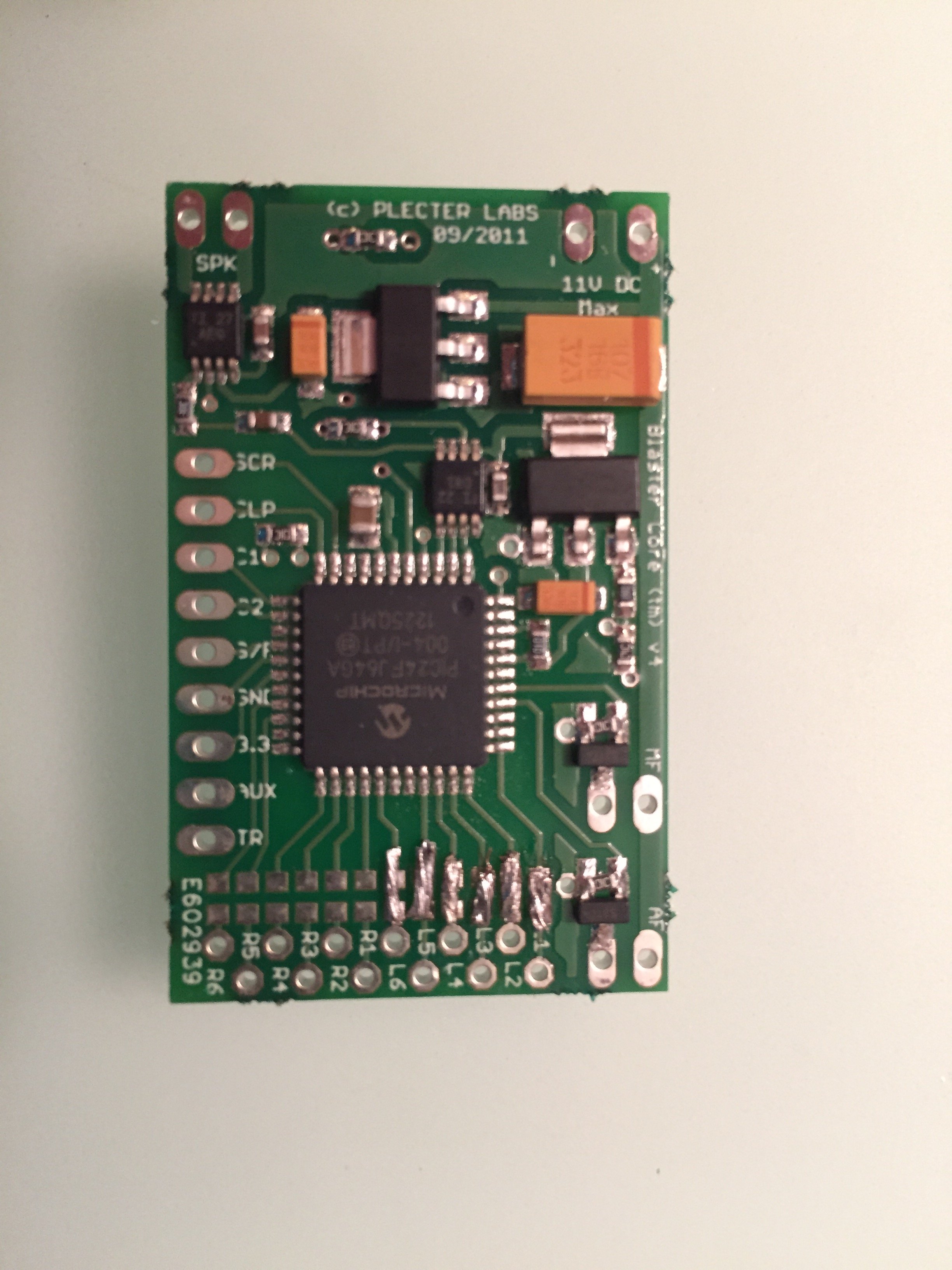

So the BlasterCore board finally came in!!!

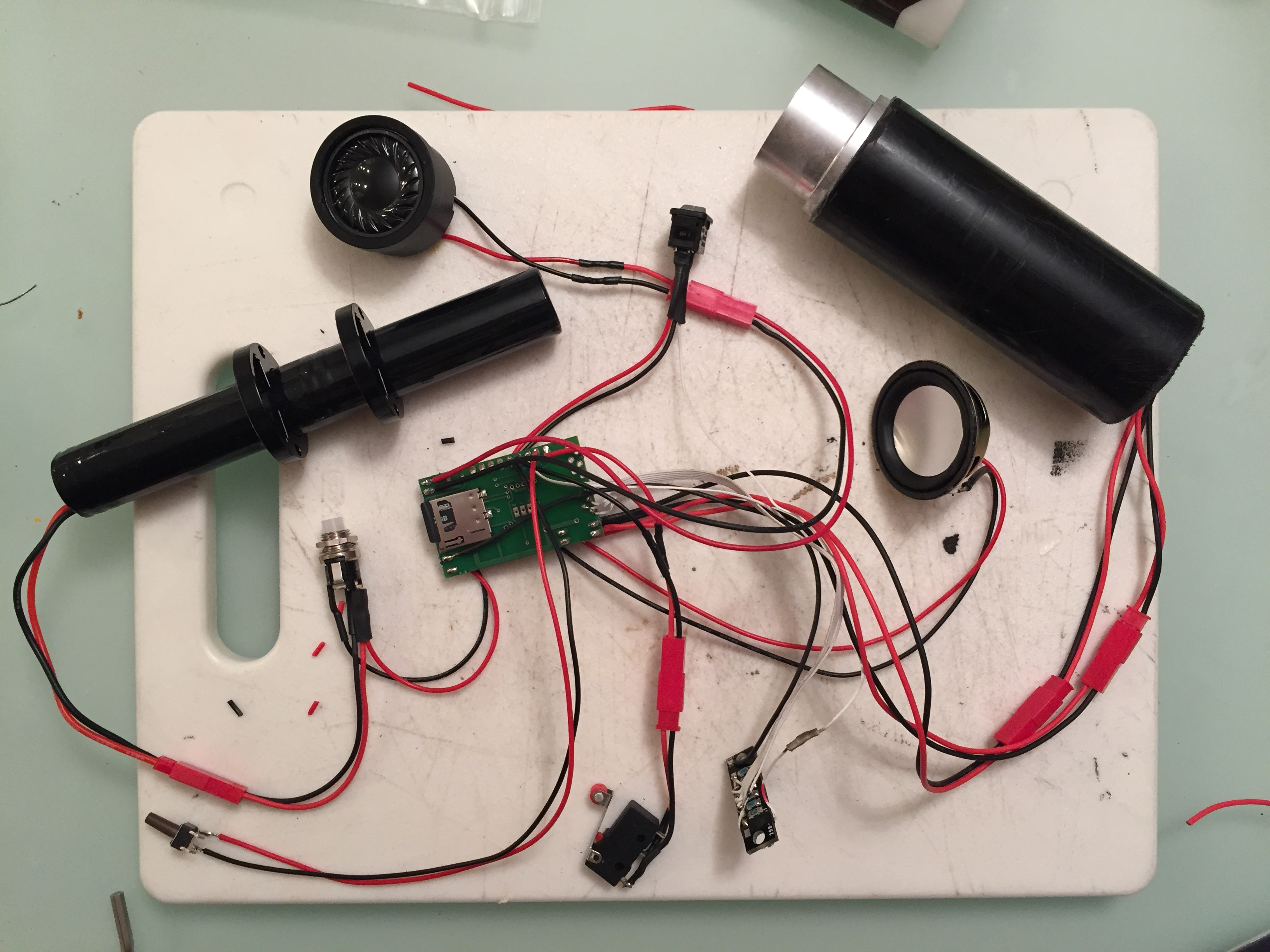

Along with my original plan to use sub-par electronics, I also had an electronics buddy od mine that wanted to put it together for me since I had ZERO experience. Never soldered or assembled anything electronic other than care stereos back in high school. Well my electronics guy drug his feet for a long time and pretty much gave me the run around to the point where I gave up on that idea. Thanks to Bryan pretty much telling me to quit being a puss about it, I dove in head first...
When I listed patience in my list of components I cant stress how much this is key to this type of work. Before I could even think about installing the electronics into the blaster itself, I had to test everything to make sure it all worked, had the right resistors and wired to the board properly. Not only was I dealing with very small wires, the board connectors were just as small.

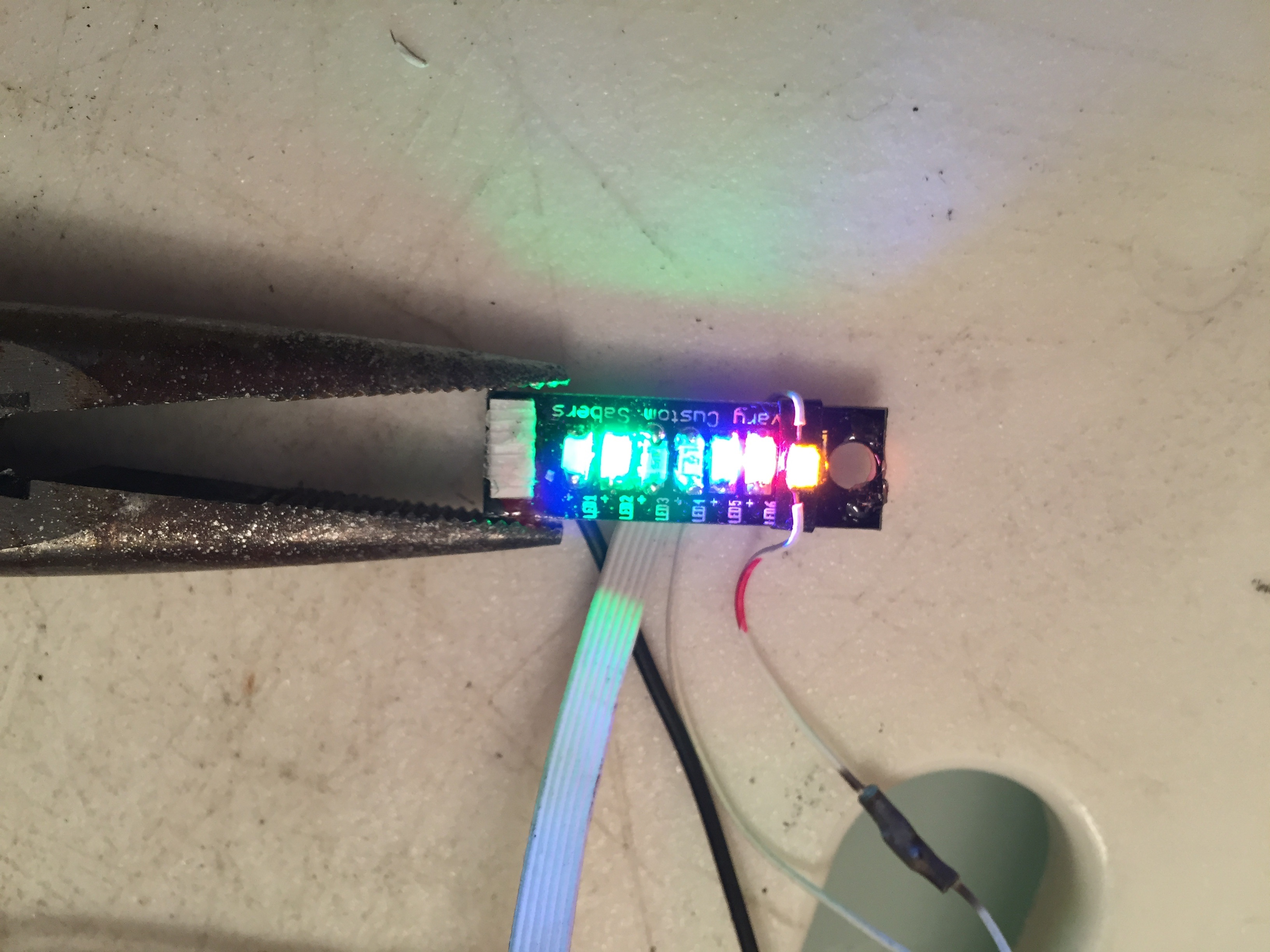

Good thing I listen when an expert is speaking because the LED ammo bar graph LEDs were off sequence a bit. Had to rearrange a couple LEDs roughly a square mm in size each by unsoldering and resoldering them, again, patience. lol
Better :)

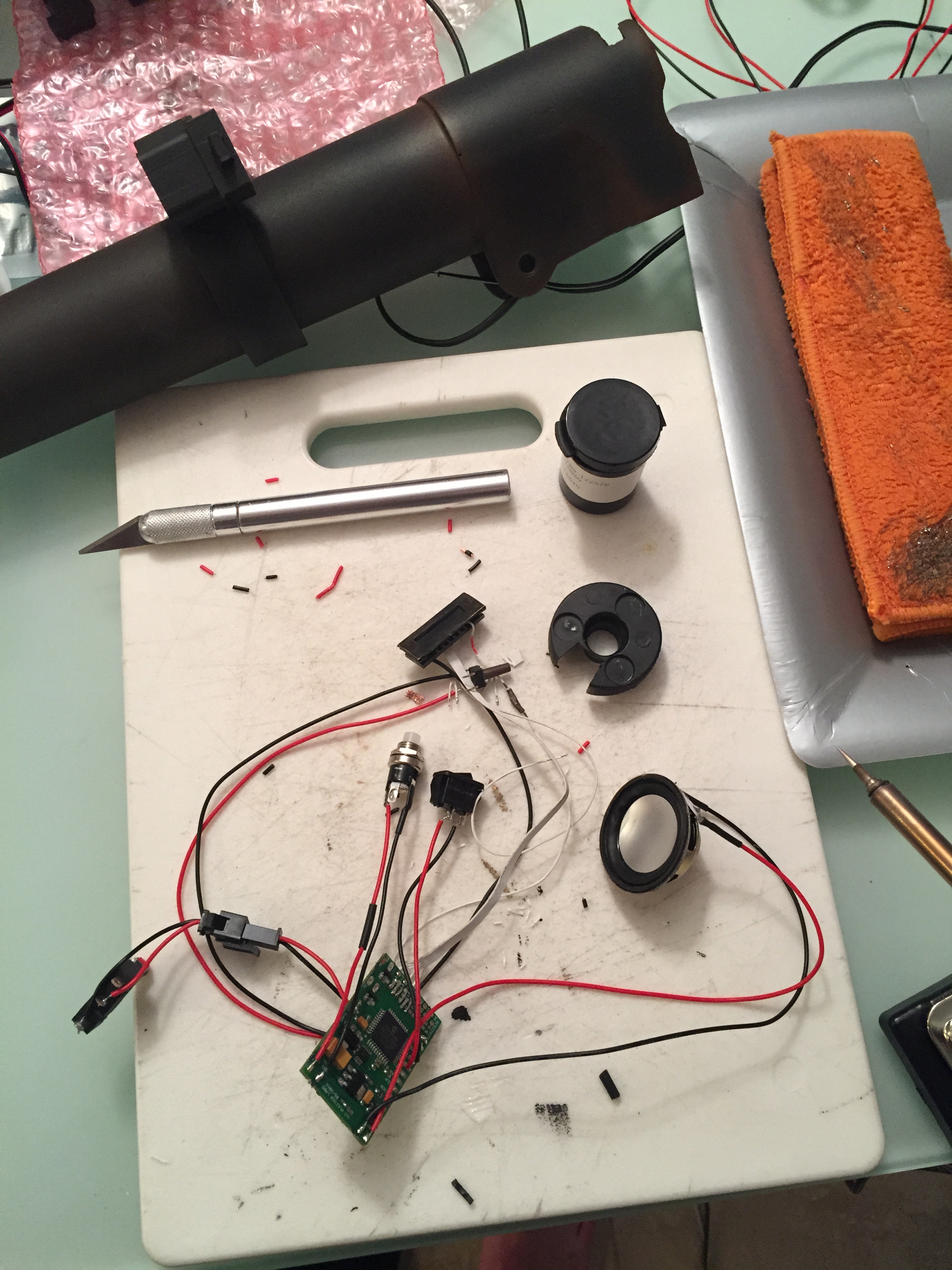

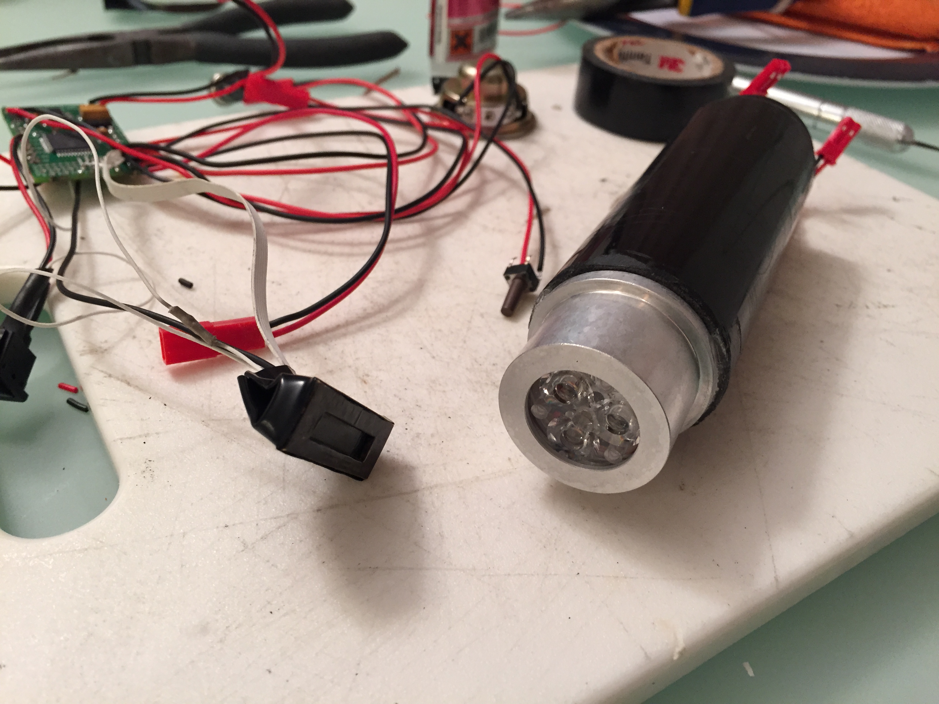

Here's a look at the LED/laser housing. I decided to add the 22mm premium speaker to the LED/laser housing so that the speaker fires out the front of the flash tube. This adds direction to the sound and is noticeably much louder to anyone standing in front of the blaster as opposed to anyone standing to the side. The bass speaker is mounted at the end of the main electronics housing and with the barrel acting as a resonance chaber, really adds some umph to the overall sound of the blaster.

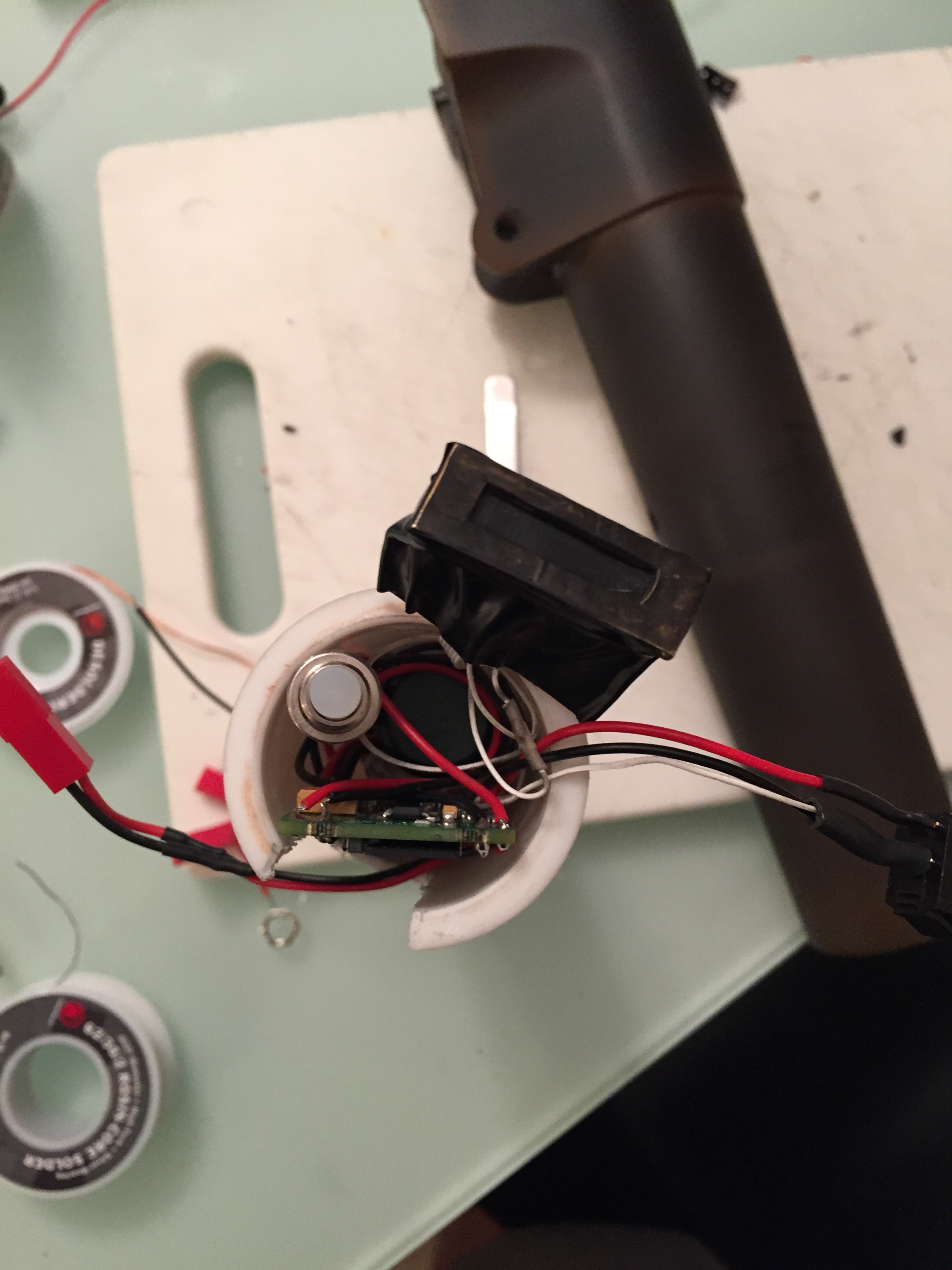

Everything works! Now that the electronics have been tested, it's time to exercise space management and try to put it all together.
I did say try lol...
After a little hacking of the sink tube, but still retaining the lip that helps secure the housing, successful fit!

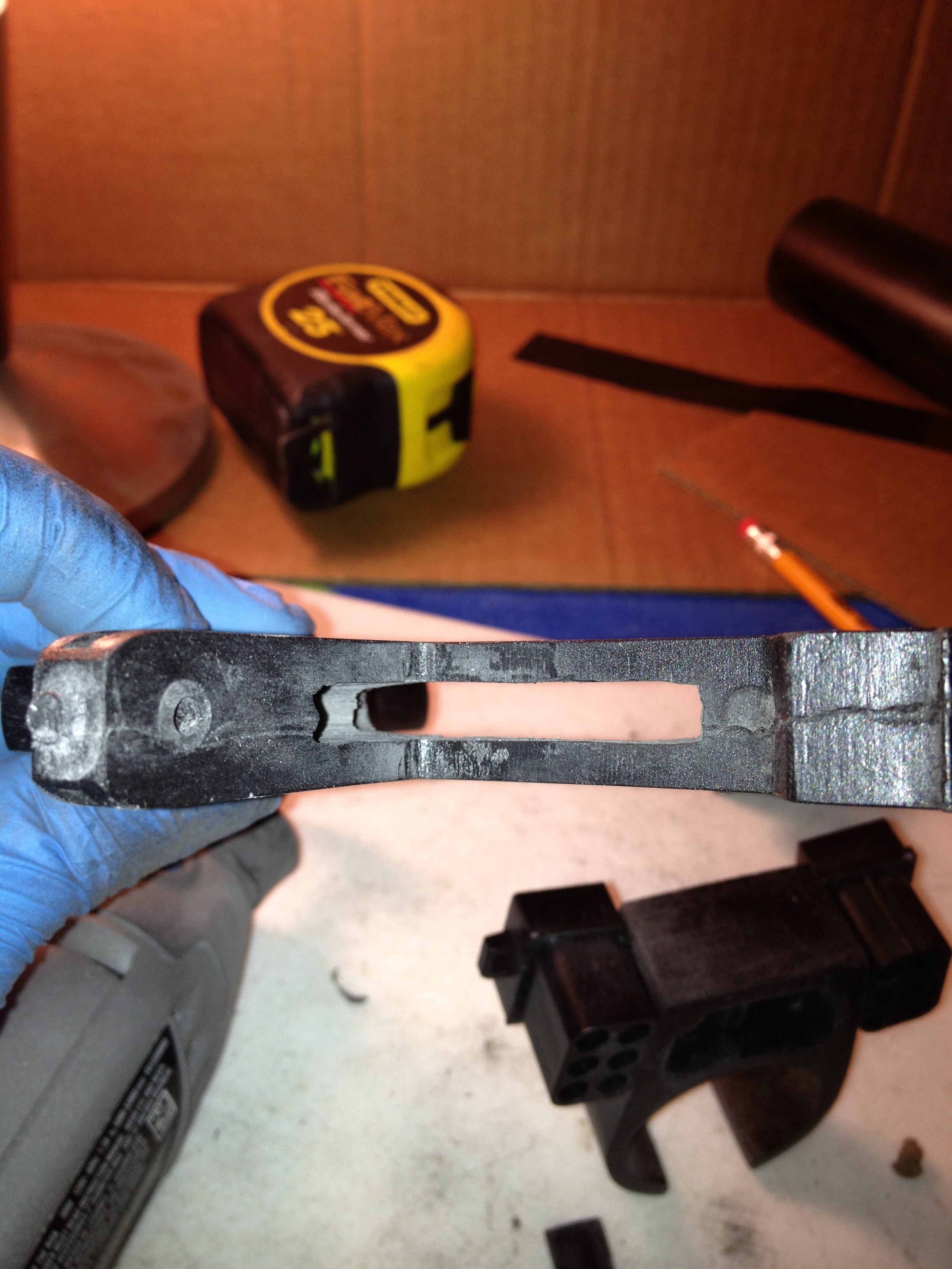

So now with everything gently crammed into the barrel and flash tube, it was time to wire the final piece that would be the only external switch on the blaster, the auxiliary switch. This is a must for the BC4 to operate to its full potential. I used a tactile momentary switch I picked up from TCSS and it just happened to be the perfect size for the idea I had to mount it with little to no interference with accuracy.
The only tricky part was feeding the wires out of the sink tube and out the hole beneath the larger scope mount on the Webley then solder the switch outside of the barrel and feed the wires back into the housing. I used a cheap bolt nut cap to impersonate the illusive bottom scope mount bolt and cover the switch button, I think I got it pretty dang close and the switch protrudes JUST enough to press it, but almost flush with the end of the cap...

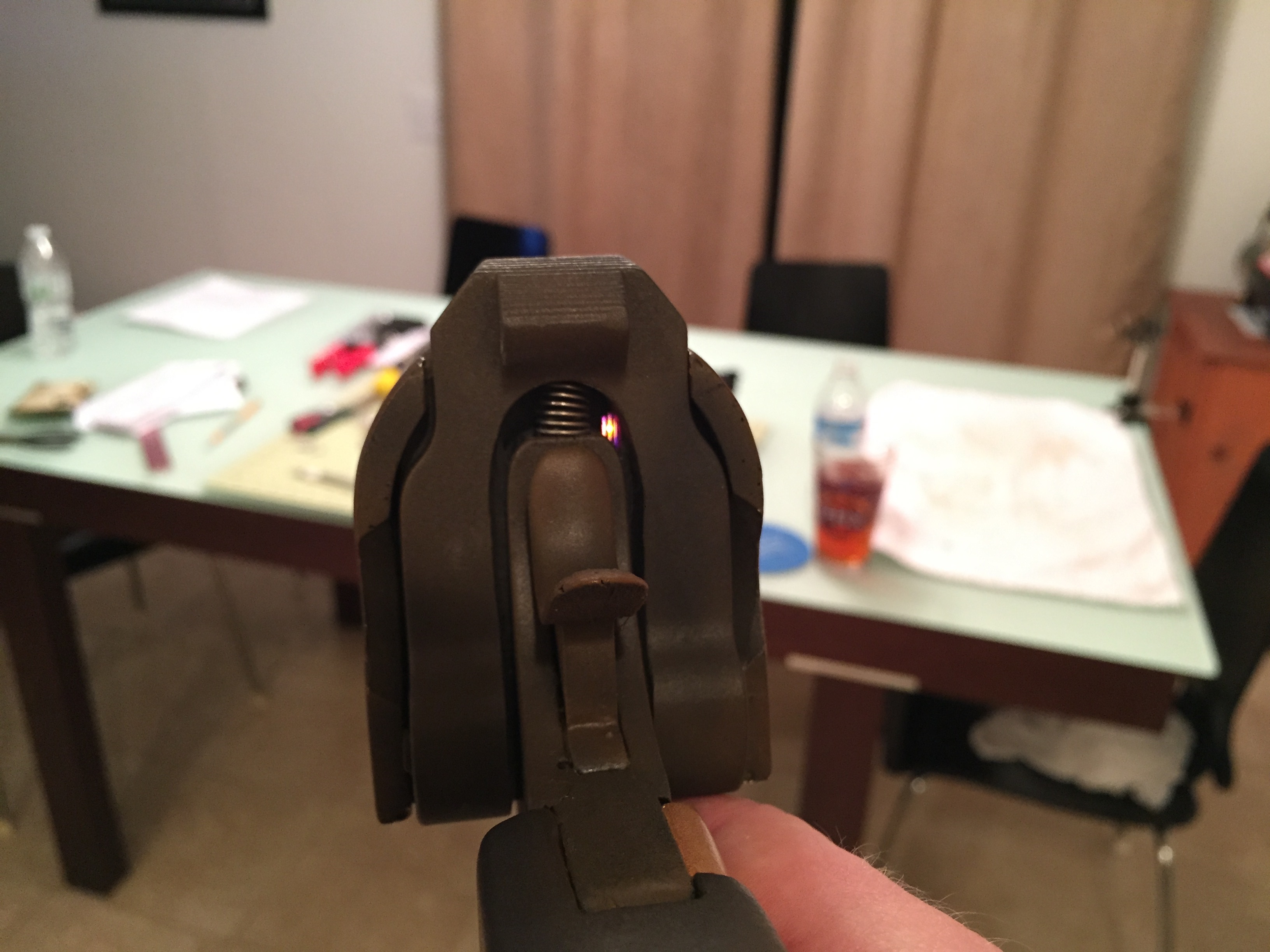

Closing the breach rubbed against the rapid fire switch so I carved a bit out of the breach lock to make some room and in doing so, gave myself a very useful view directly to the rapid fire LED. Now I can see if rapid fire is activated without having to open the Webley, accidental geniusness is a habit of mine. jk
