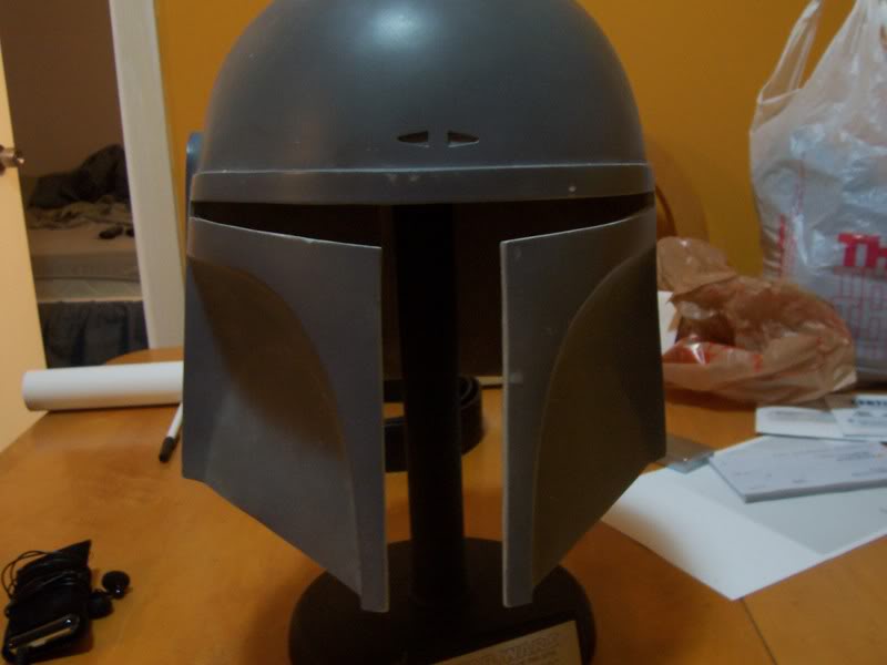

Nice work on the helmet !! Better skills than me I'm afraid - I can build , but paintwork has always been tough for me - If I was to pay an artist to reprint my target helmet - what would something like that cost ? Ain't gotta be screen accurate or nothing but it's gotta be better than it is - LOL
Not sure what they charge, there are a few excellent painters here on the forum, I'm sure you could find one. There's probably a waiting period depending on other customers in line. Ive seen some amazing work on here.

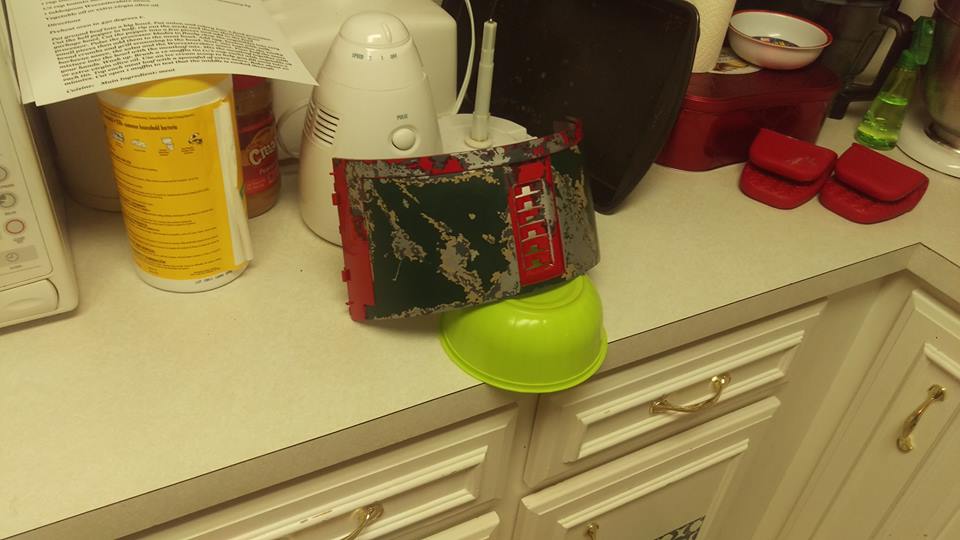

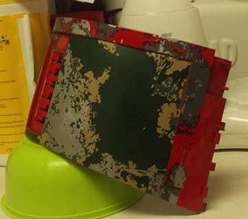

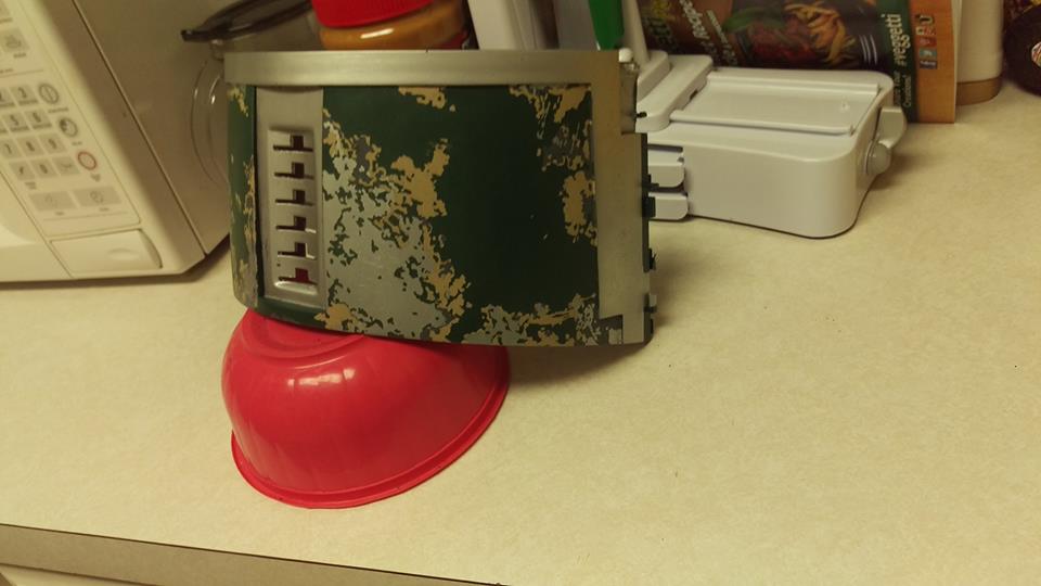

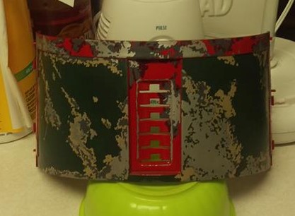

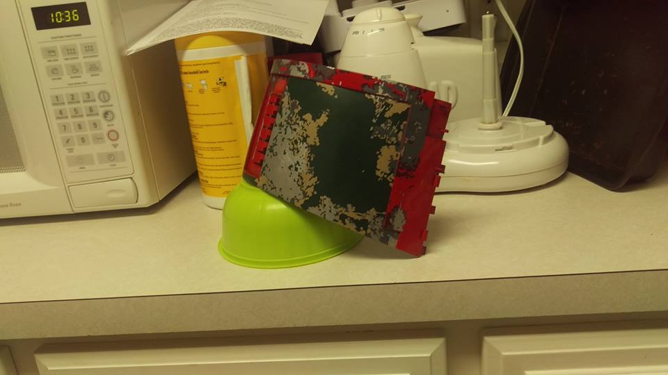

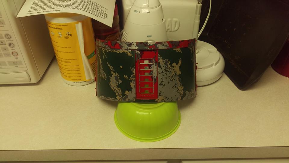

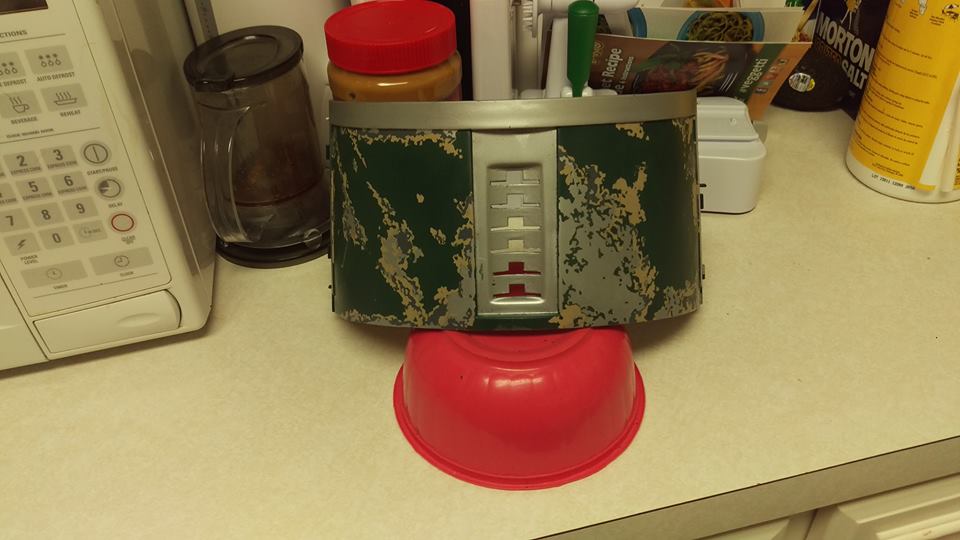

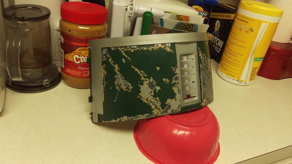

Yes, each color is layered. The whole helmet is primered and painted silver, then each corresponding color is layered and masked out to reveal the damage.

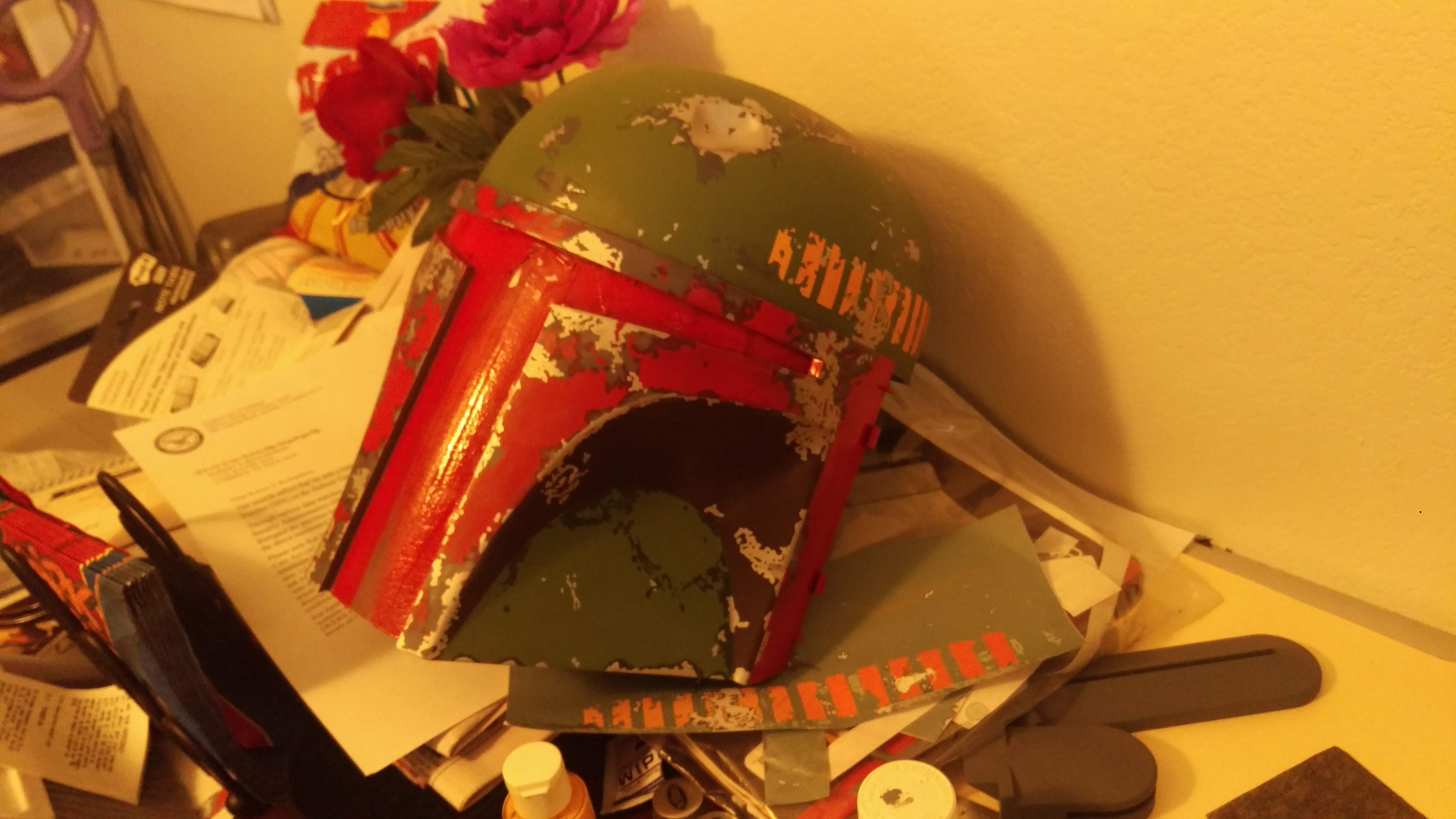

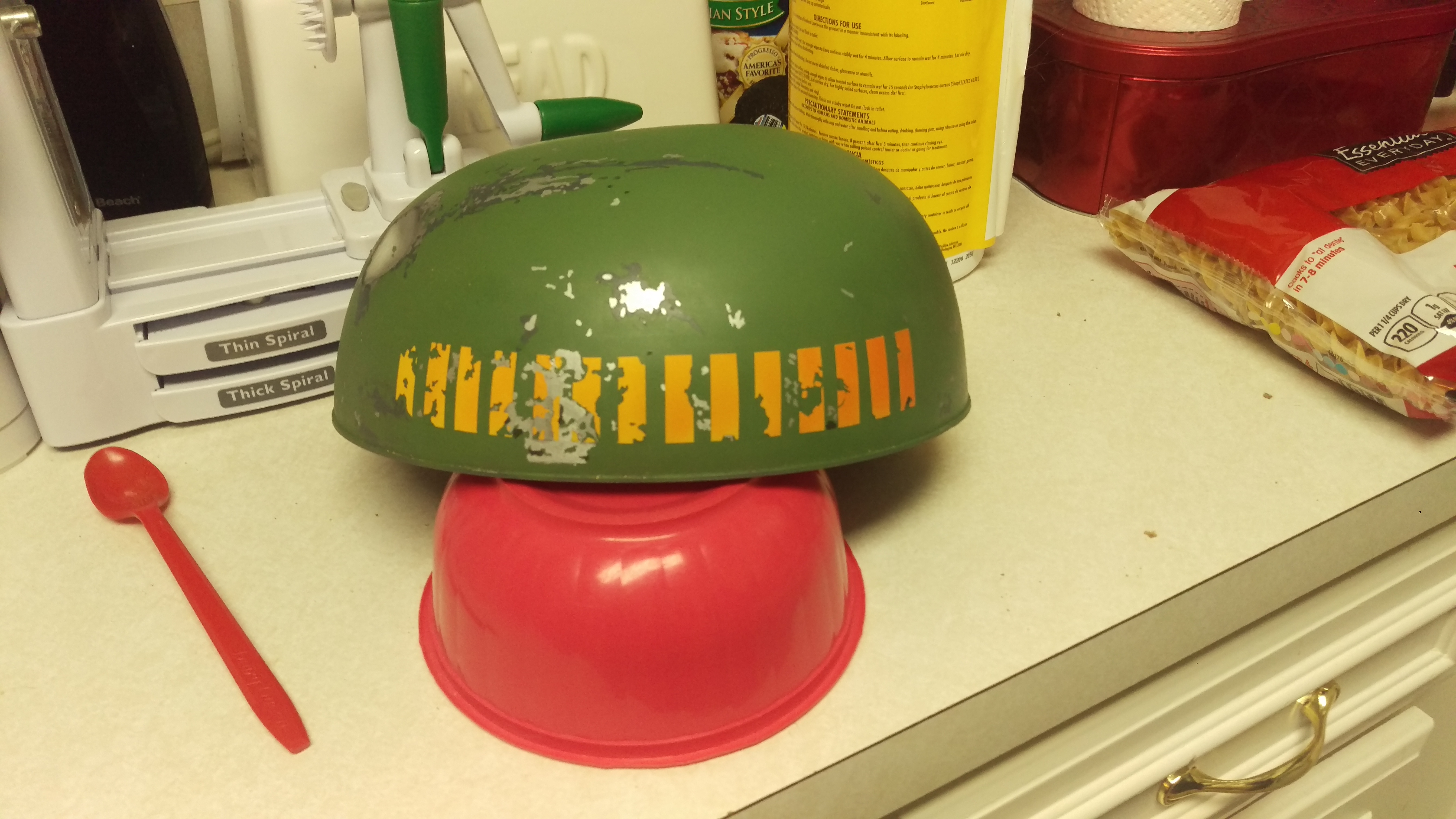

Ok there's actually 2 light greens in these pics. The lower cheeks are Rustoleum army green spray paint. The dome is testors flat green(army green) enamel I airbrushed on. The testors flat green is just a tad darker than the spray paint, and I like it a little more, I have since repainted the cheeks with the testors flat green. All of the colors I have used are "close enough" for me, none of them are from the paint lists you can find here on TDH. Although I might actually order some of the accurate paints in the future, I usually just go to the spray paint isle in the store with ref pics on my phone and find the closest thing I can.
