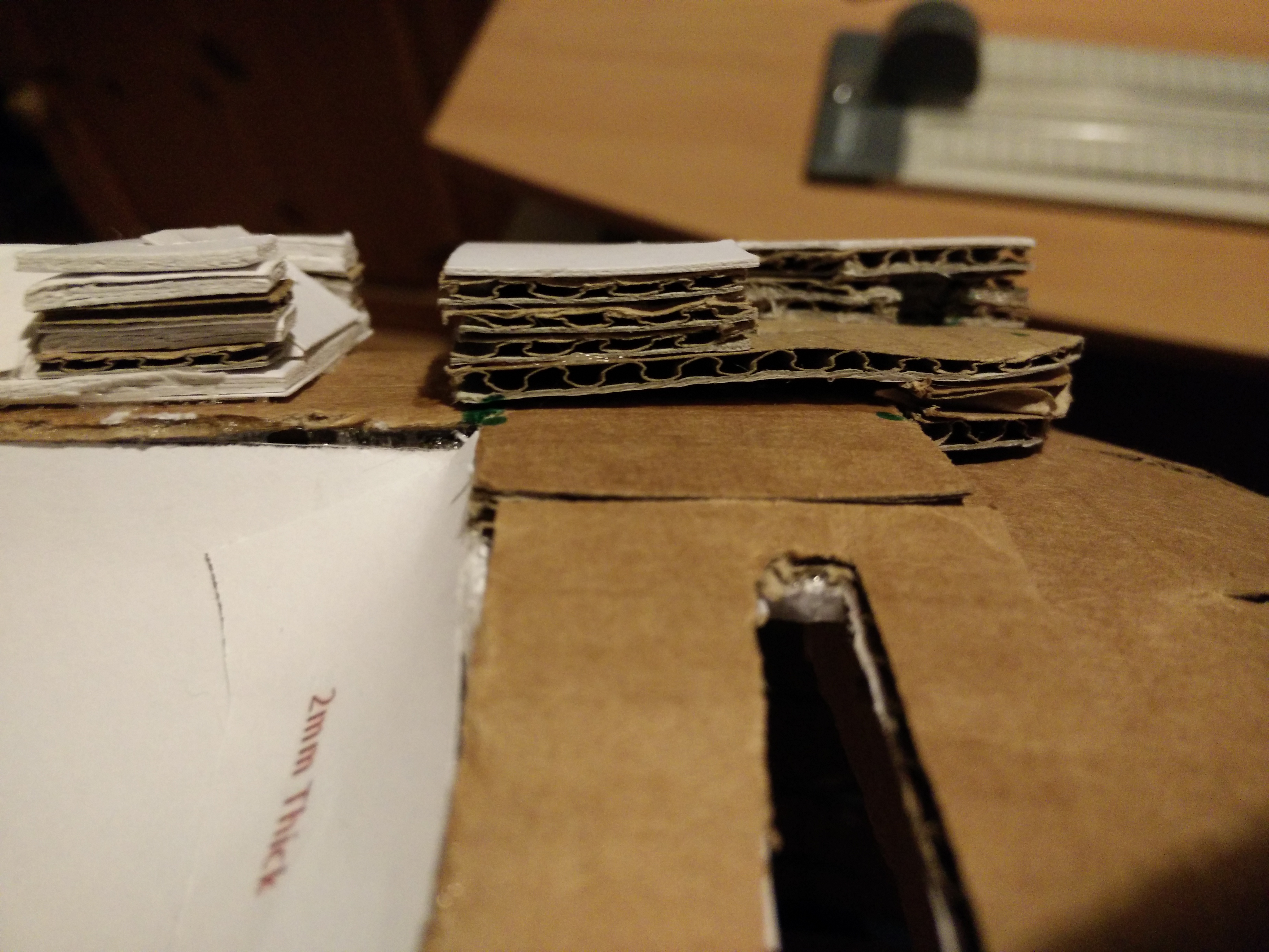

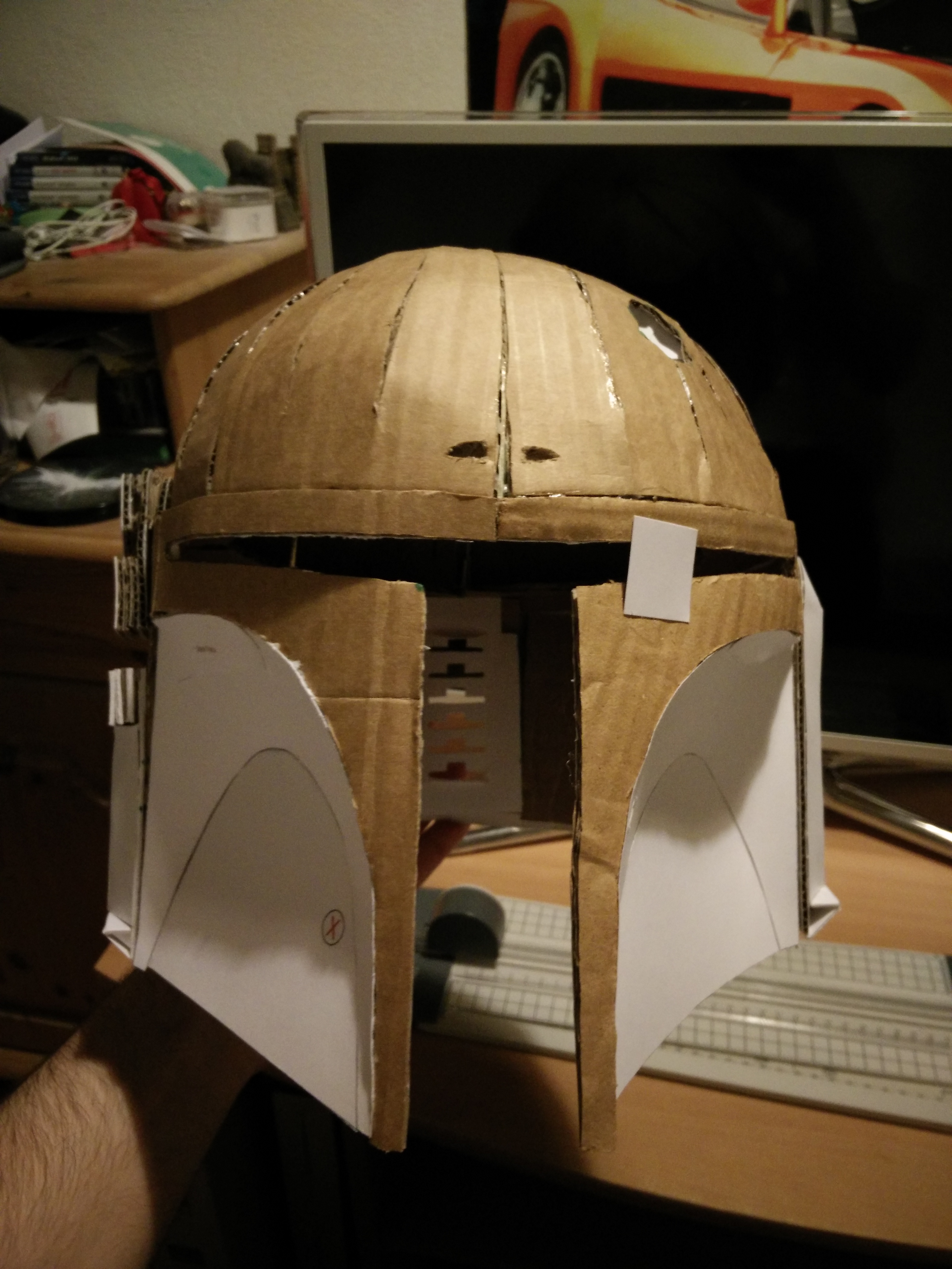

So I just finished building my helmet using RafalFetts fantastic templates and are planning to use fiberglass resin with fiberglass mats to strengthen it.
The problem is that I want to make sure that the material I've used is suitable ( genius me didn't think of it before).
Could anybody give an opinion on the situation, please.
I recommend to use pepakura models with a bit thicker paper. sure that takes longer but the result is awesome. I made one and take epoxy resin and fibreglas cloth
Will it be for display only or do you plan on wearing it? if its for display and you fiber the inside and fill the outside it should be ok for show,... if you wear it then it may dent/crack very easy with due to the card being hollow...
It will be for display.
So resin and fiberglass on the inside (and all carton pieces?) And body filler on the dome and visor?
Yeah I don't see why it wont be ok, like that for display, keep going with it update us with pictures and progress I am sure it will turn out just fine, do the resin/fiber first on the inside and harden it all up the start with your filler (y)

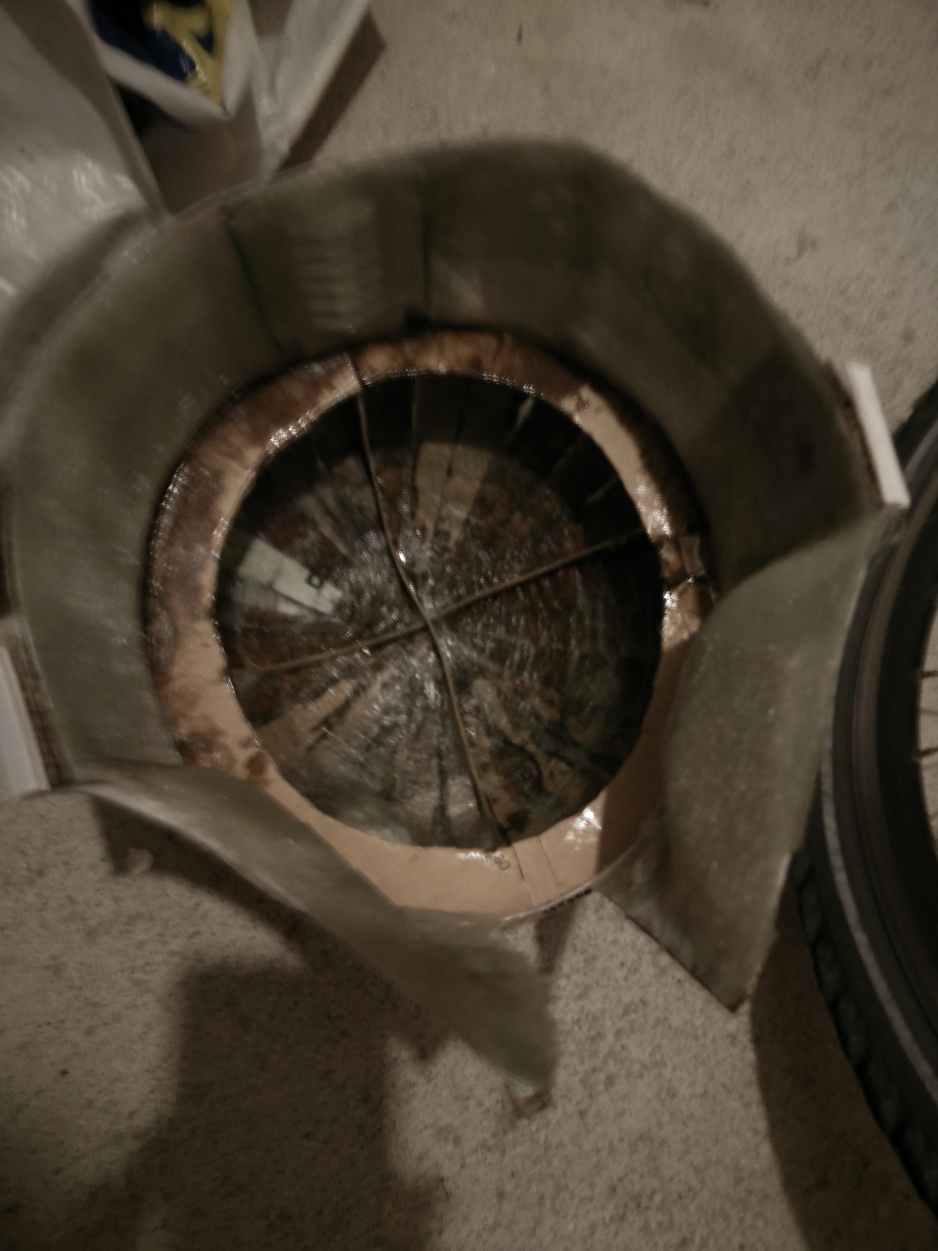

IMG20160205182746.jpgI got a chance to fiberglass the inside of the helmet.
Will be using filler tomorrow or the day after.
Ps. sorry for the bad picture
