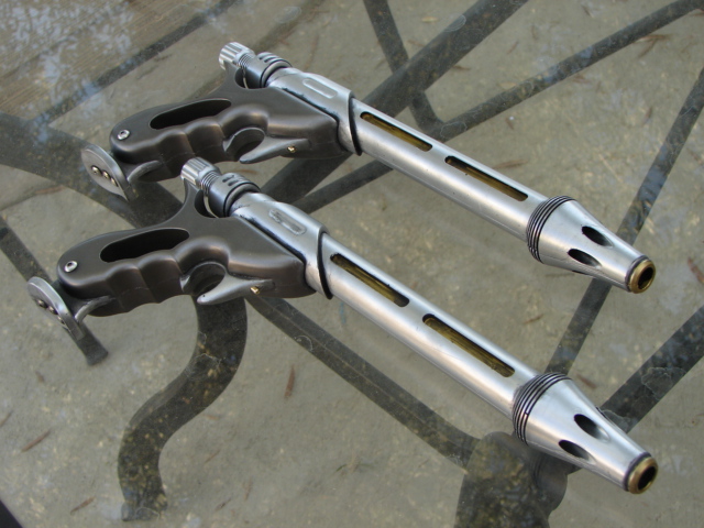

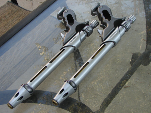

Here are a few pics of how the rubber versions look with "the works". These are the first successful pulls...so my #1s. The #2s are in the garage drying with a base coat of black paint. The handles will get a Medium Titanium final coat later tonight, followed by a coat of Titanium on the triggers and base parts. All of the paint finishes applied are SEMs, so it's made specifically for vinyle/soft surfaces and will withstand the small flexing that occurs in the rubber. Unfortunately, a single can of SEMs costs about $12, so it's quite a bit more expensive than the normal stuff. At the moment they are fun to build...but still a lot of work!

In all seriousness, they do look aboustly wonderfull! And I do wish I made more money.
They are shinier in person and especially in the sunlight, but I took these pics around 6 p.m. in the evening shade. But they do have the usual Rn'B shine.
I don't have any plans to paint up a resin pair, but I will if I can find some free time. I'm guessing a similar finish scheme would work: base coat of black on everything, rub down with 0000 steel wool, Dupli-Color Gray metallic paint on the handles, Dupli-Color Silver metallic on the triggers and bases, gold metallic on the barrels & tips, Rn'B on the barrels, triggers & bases, charcoal grey flat paint for the weathering. I would use Dupli-Color brand paint on the resin versions because it is a very durable paint made for car/truck applications.
Glad you guys like them! If someone wanted to work hard enough spot filling, sanding, painting, sanding, painting, etc...the seams actually start to disappear.
