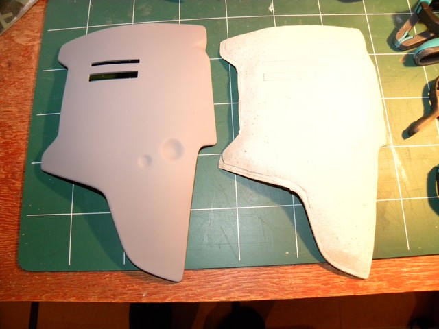

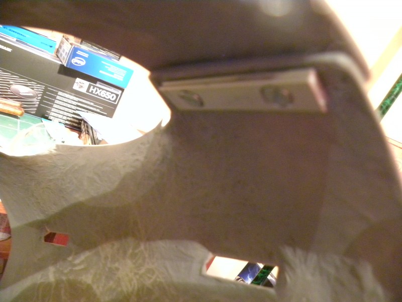

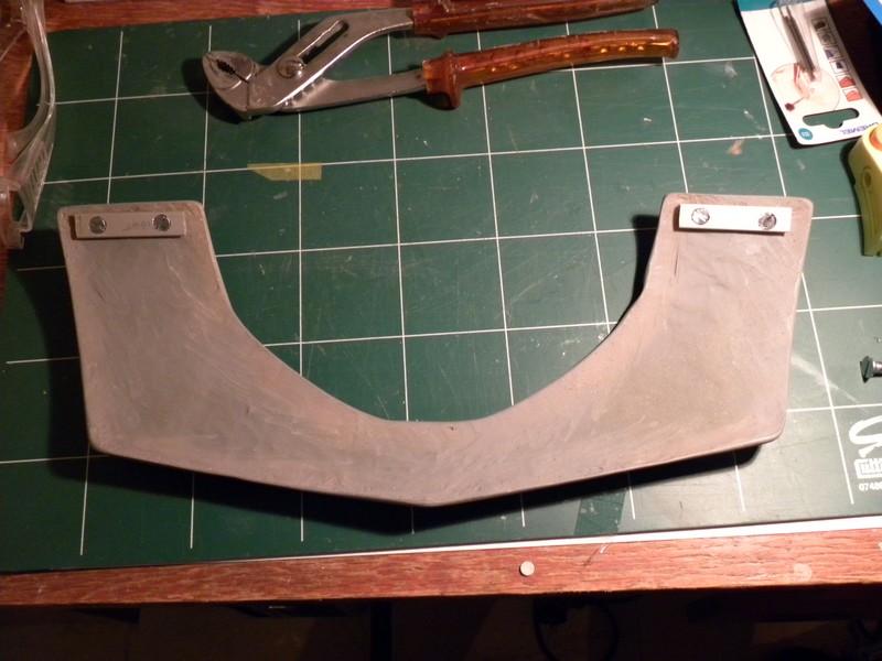

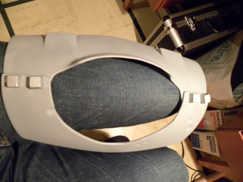

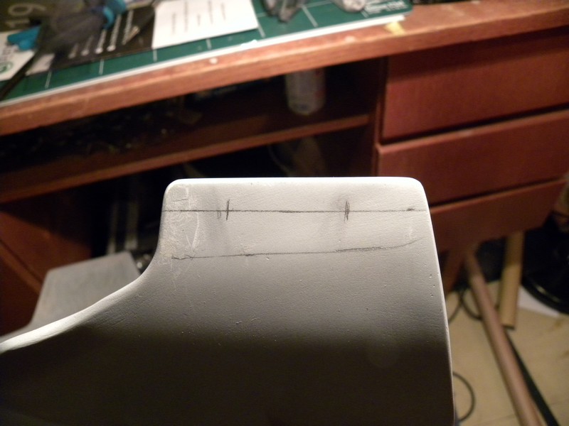

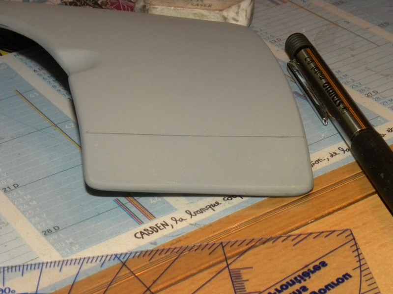

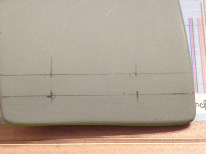

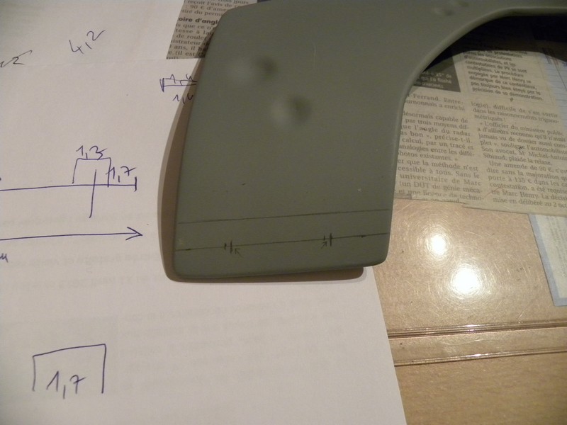

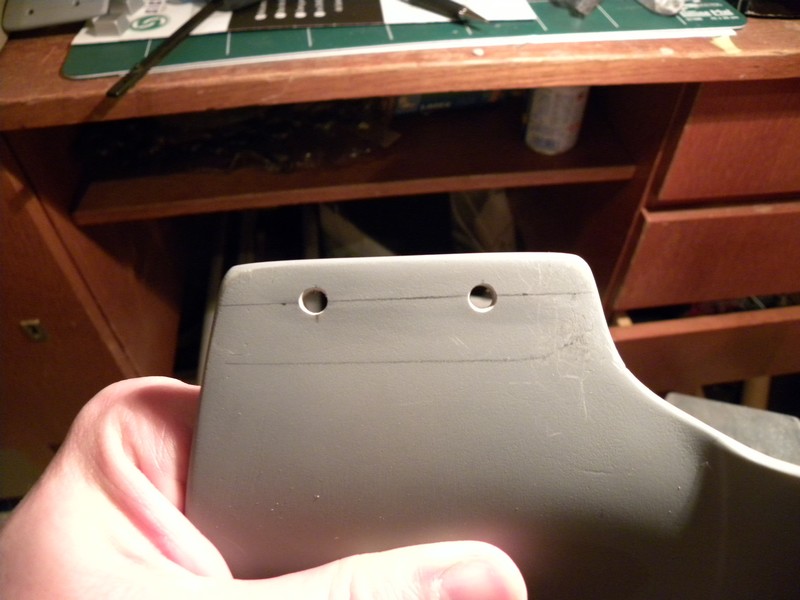

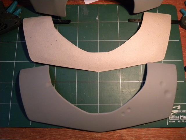

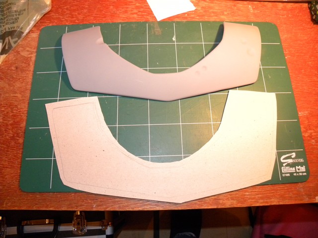

When i put the collar and backplate on me, I made marks on the flakvest. So it will be easier to know how to put the cardboad pattern later.

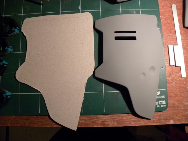

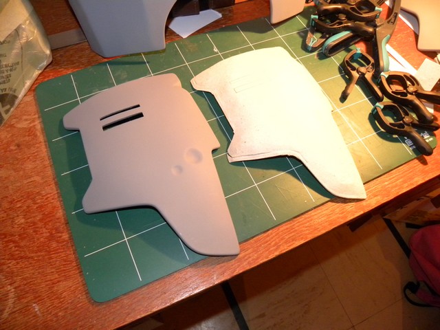

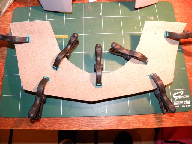

This is how i do to make holes on cardboard.

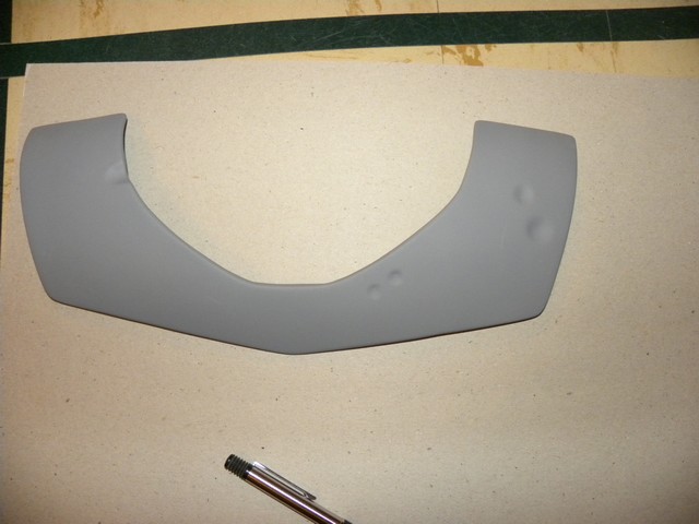

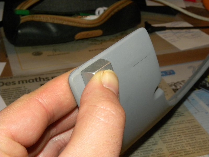

After i made marks on collar using cardboard

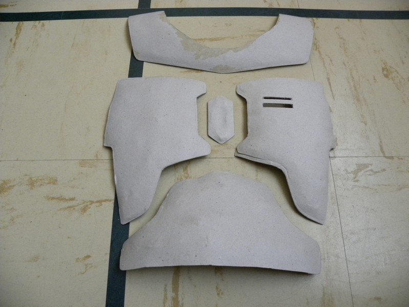

Aha, I've finally figured out what you painted onto your cardboard armor templates to stiffen them up! :p PC Products 16 oz. PC-Petrifier Wood Hardener-164440 at The Home Depot I have some of RKD's armor coming sometime in March, and I was fretting about getting the bolt-eyelet attachment alignment right. Any progress/luck with your attachment method, StrumFett?

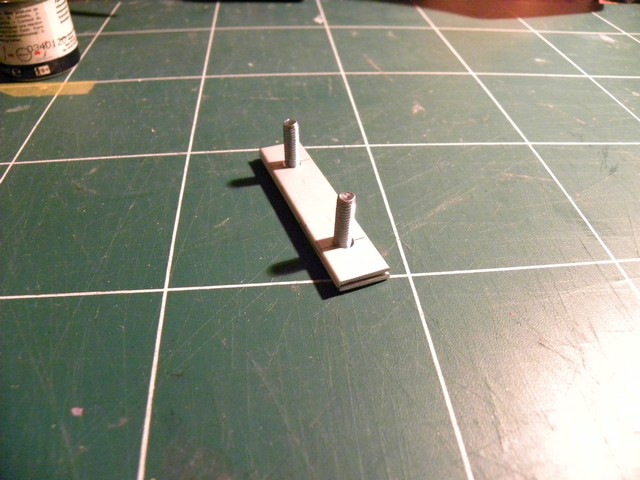

Hi !

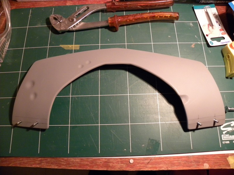

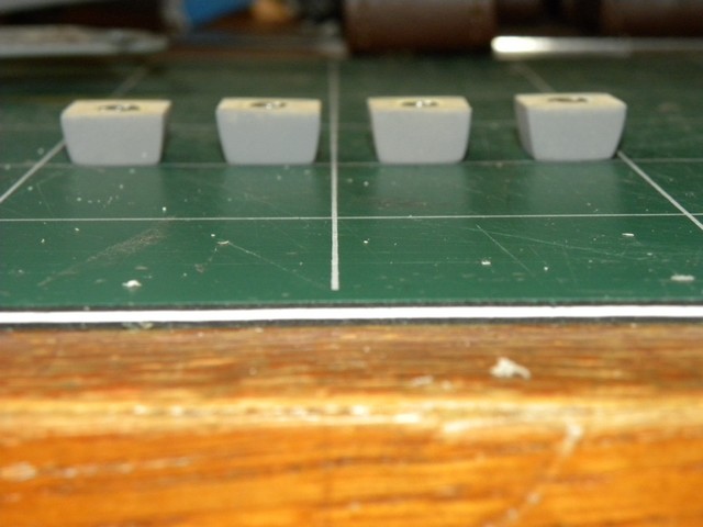

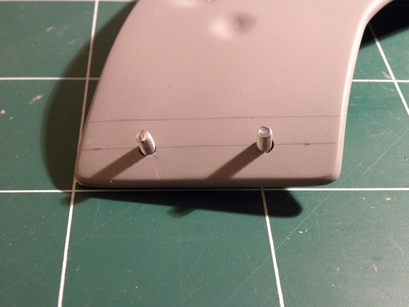

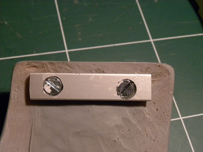

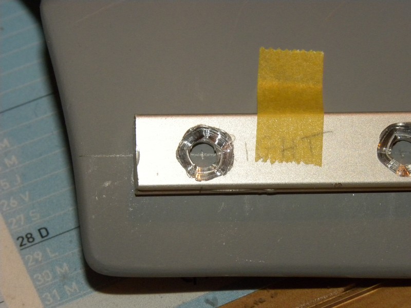

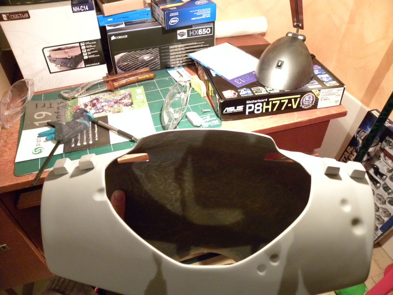

Today, i started fastening bolts on collar :

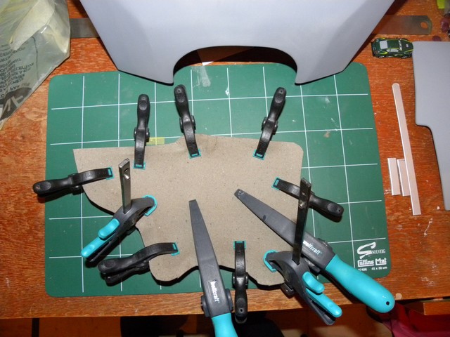

First, I used epoxy dough, flattened with the box.
With an eyelet, i pick small amount of dough and i put it on the marks on collar.
I put the bolts on the dough and quickly put the cardboard pattern on bolts to be sure that the arrangement of the bolt will be correct.
I just have to wait drying.

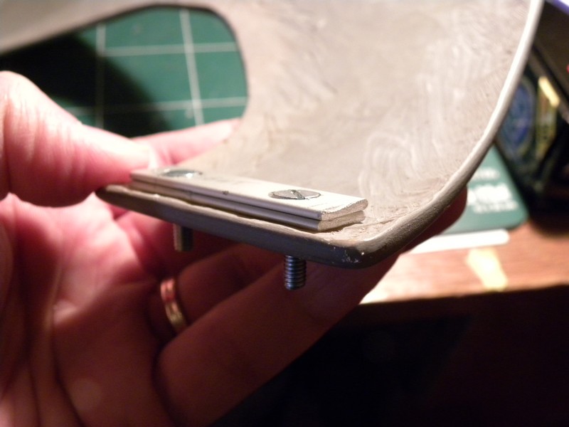

Note : Depending of flatness of the back of collar (fiberglass like mine are less regular than vac formed one's) bolts can take differents angles. It isn't a big problem because most part of the bolt will be cut (i think i'll just keep 5 millimeters)

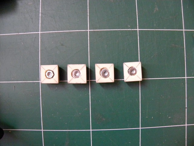

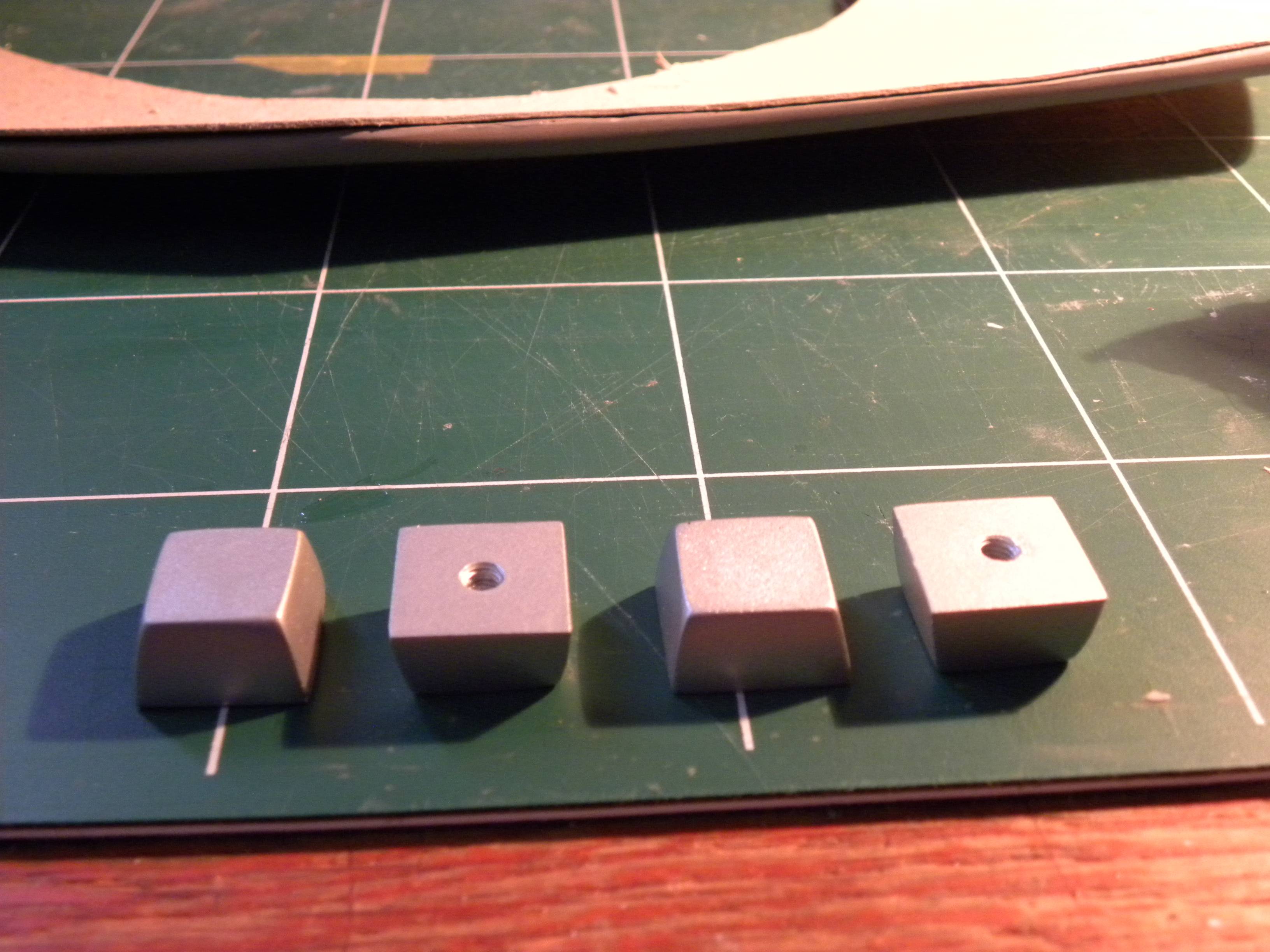

Just a quick update before : I changed the bolts because the head was to high.
So i use 6mm eyelets with 4mm bolts.
This is the new bolts
I put on them epoxy dough to have a stronger attachment.

I made all the holes on cardboard and then i made the marks on the armor.

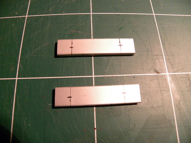

I've finished to put eyelets and bolts on armor :
This is the vest with the marks i made using cardboard pattern :
Vest with all eyelets :
Armor with bolts :

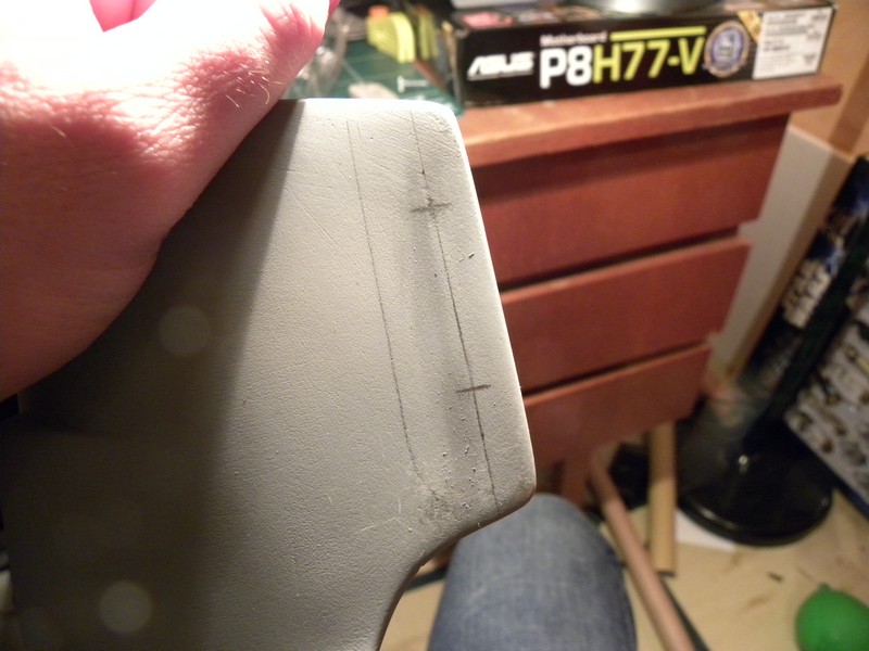

Tu cut the bolt at the right length, i made a mark on one of them while the collar was attached on the vest. After, i used rings to have the same depth, so i cut all the bolts in the same time.
