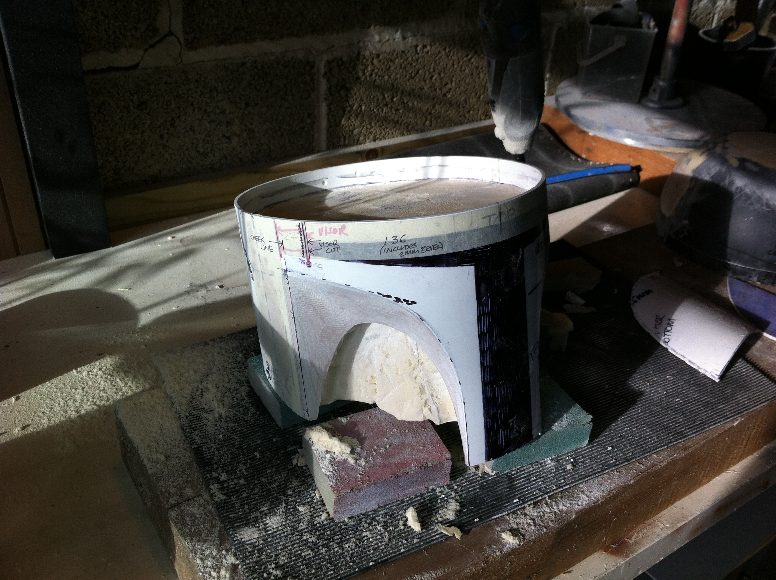

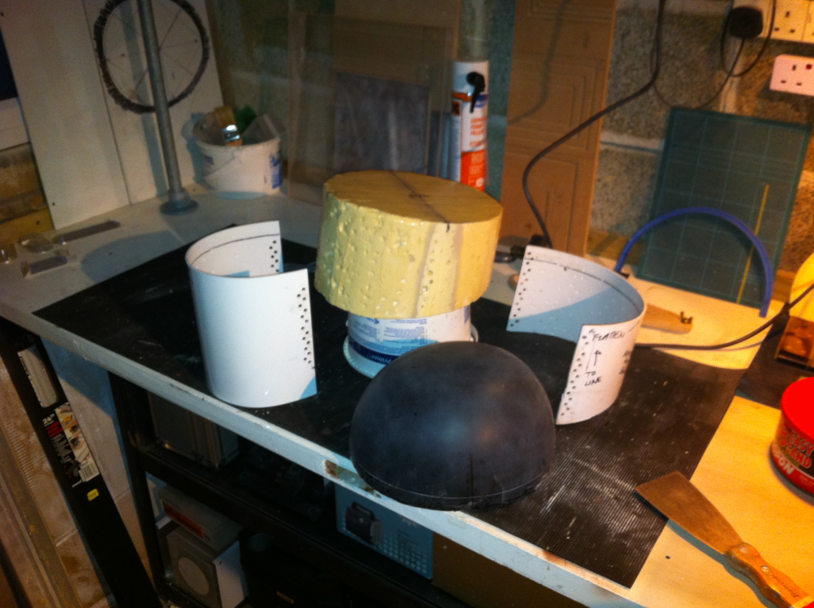

I thought i'd start up a WIP thread as i attempt to build another helmet from scratch. This time the dome is scratch built, so no BMX helmet to limit the overall shape of the sculpt... The materials I'm using are standard plastic card, alloy sheet and various foam as well as polyurethane resin and Isopon P38 (Bondo). The first pics show the really basic starting point to get the general shape and scale...

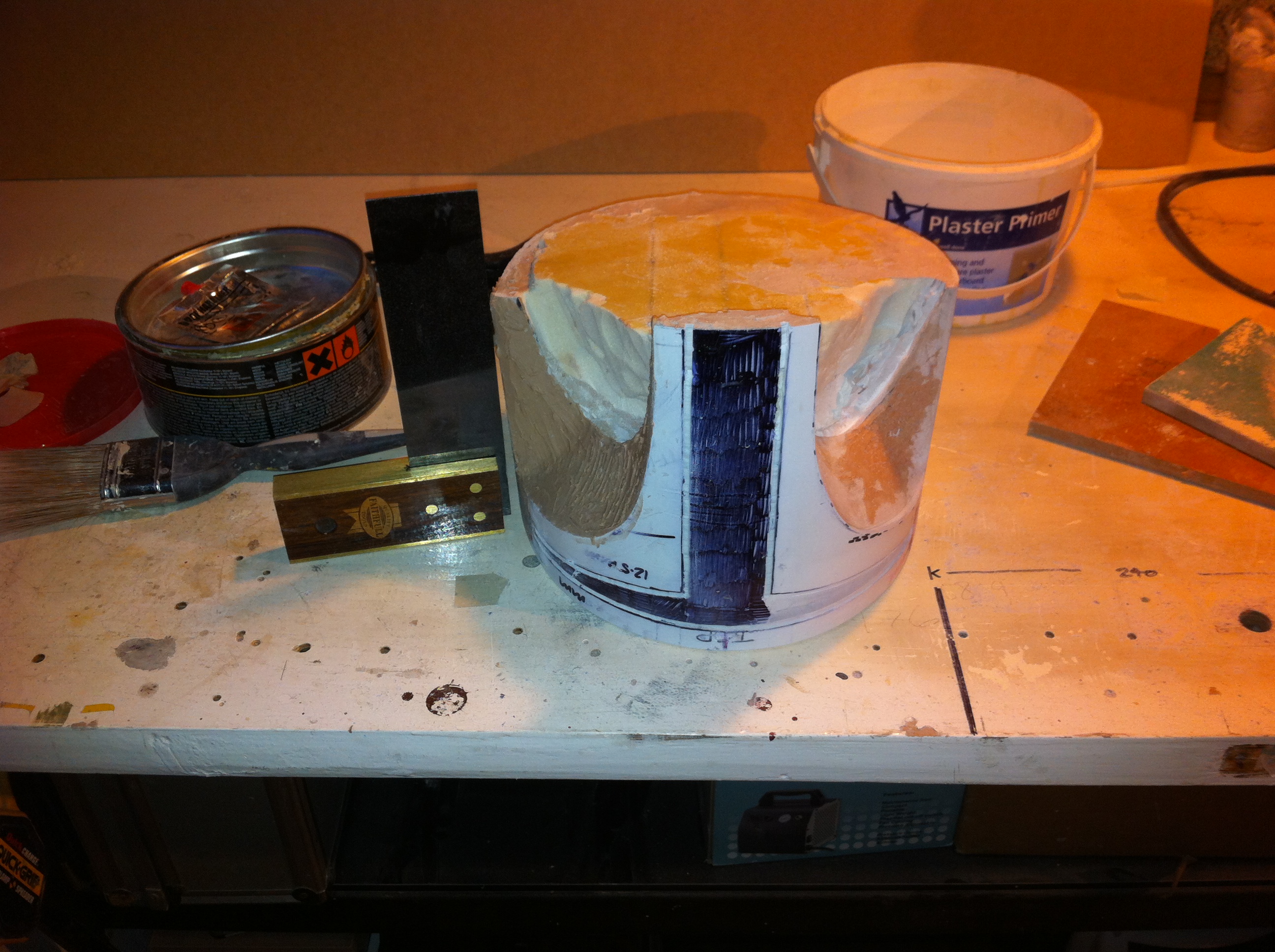

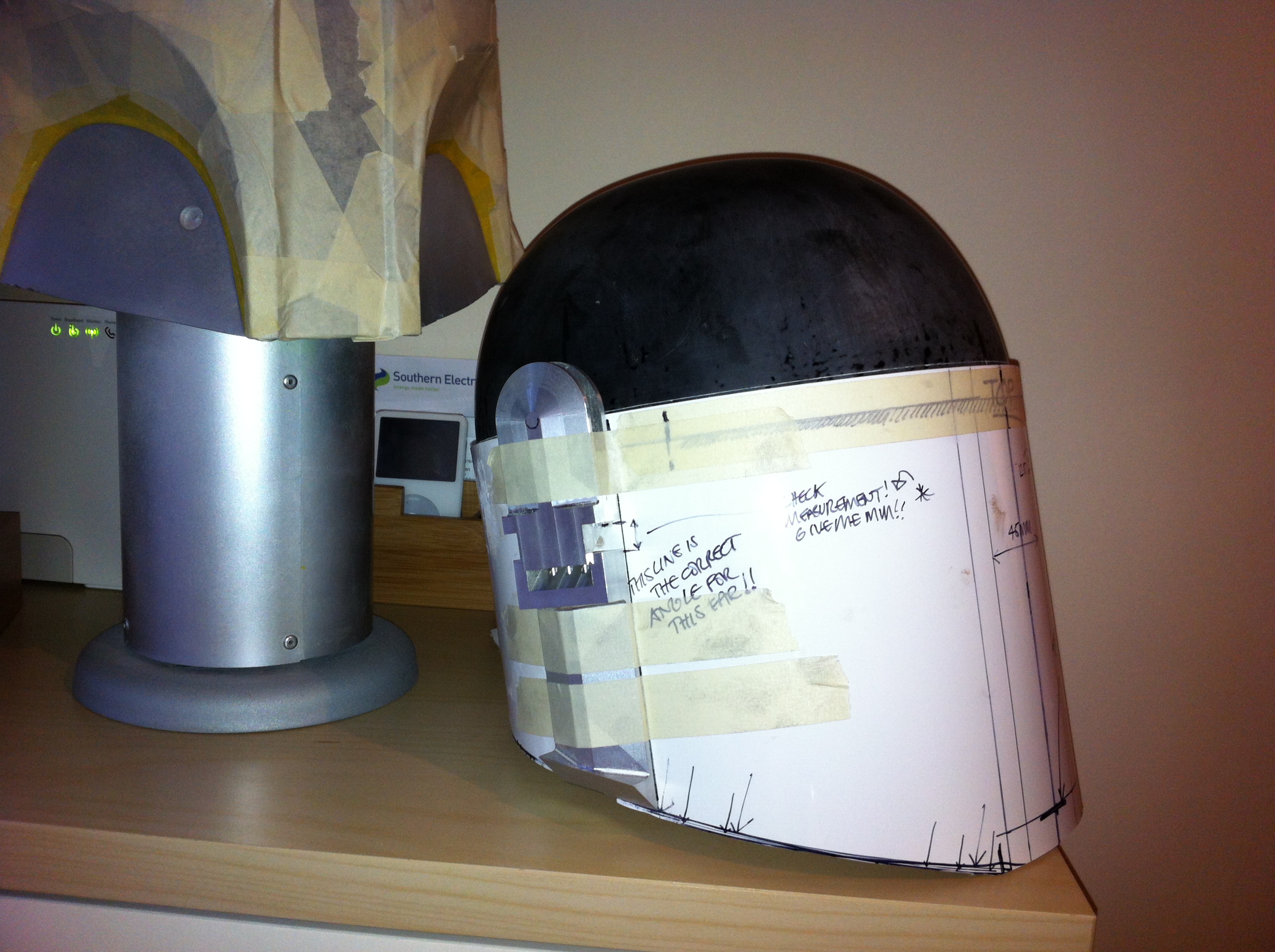

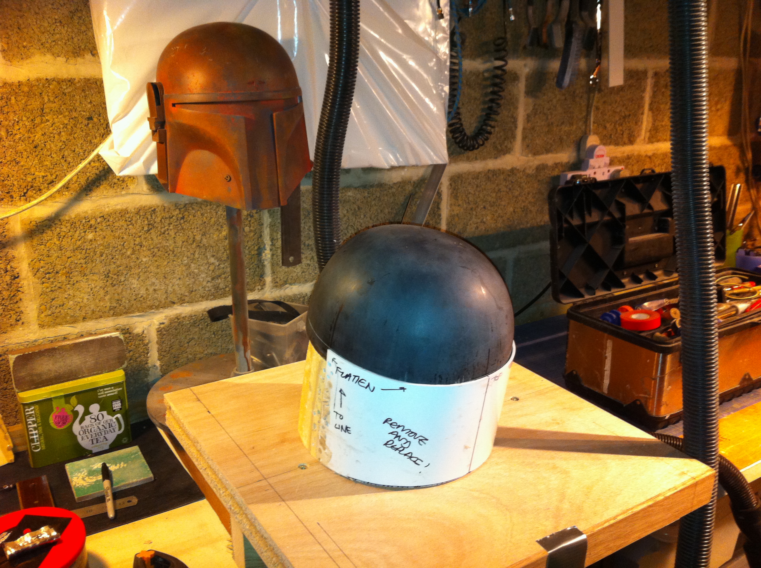

Thanks guys. Here is a shot of the back panel section in position, this section will be sculpted over with Bondo to achieve the slight compound curvature as seen on the actual helmet. At this stage the dome remains a separate piece that drops into position. I actually have three domes at the moment, all slightly different shapes...
Here are a couple of shots of the lower cheeks going in and checking the sides of the helmet with a square. The lower cheeks will be sheet aluminium as this will be less prone to being sanded away as i adjust the upper cheeks through the coming sanding stages...
