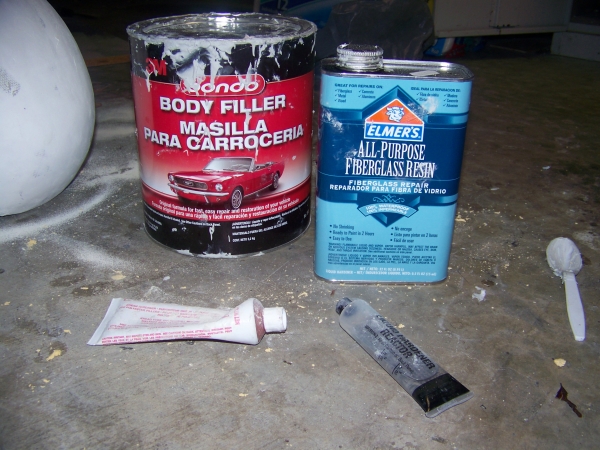

Heres what I did so far: I found out that if you mix bondo with polyester resin(add both hardeners)
it makes a great gelcoat when it comes to making a mold for silicone mask, so I did that poured it on.

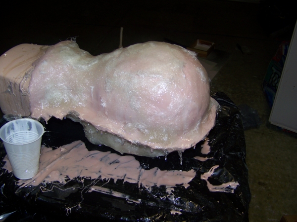

Once it cured I mixed an epoxy resin thats about 12 hours to cure, added some fiber-glass mat(about 1:1 ratio of fiber-glass and resin) applied it,
once I did that a few times I started on the other side and should do the second coat tomorrow.

There is no silicone under, it's just my sculpt, bondo/polyester, and fiber-glass. As soon as it's cures I will take the negative apart, lay down some clay about 1/2cm. thick, then do the bondo/polyester/fiber-glass steps to make the core.
After that I will drill some holes(so I can get the silicone in and the air out), inject the silicone, let cure, take the core out, put a modded mannequin head in it, and finaly inject a silicone foam into it.
