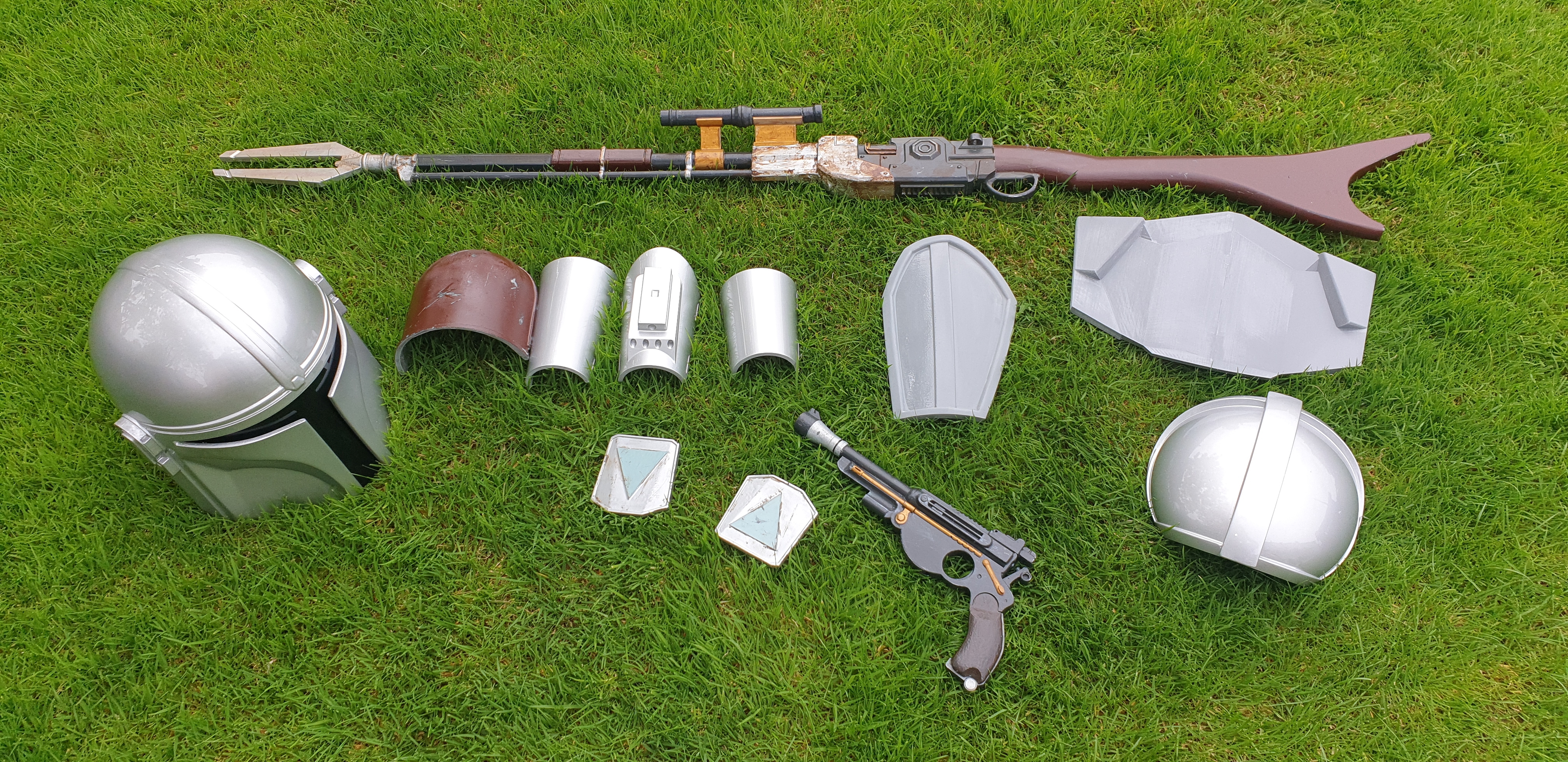

Anyway..the Mandolorian tv show is awesome and I immediately decided to make my own suit. I have trooped with a few mercs in the past and the odd Boba..so I know about the expanded cosplayers. With the advent of 3D printing it does make obtaining parts much easier. Although some work is still required and some mistakes have been made too. The photos show a costume I bought from the land we don't mention. I dumped the plastic armour with a view to making hard parts myself. The soft items are not too shabby at all..infact they need to be tossed in the cement mixer for a tumble. Here are the pictures I have taken of my progress so far. I have had printing failures..painting failures and sizing failures...all a road to learning. The guns are printed glued together and painted. The armour is 3D printed and sanded and filled and sanded and coated and sanded and painted. The helmet took two attempts to perfect..it is still a tad small but I can get it on. The visor is fastened only around the eye slot and merely held in place down the face parts to allow flexing during fitting. The visor I use is very flexible as you can see from the pics.
