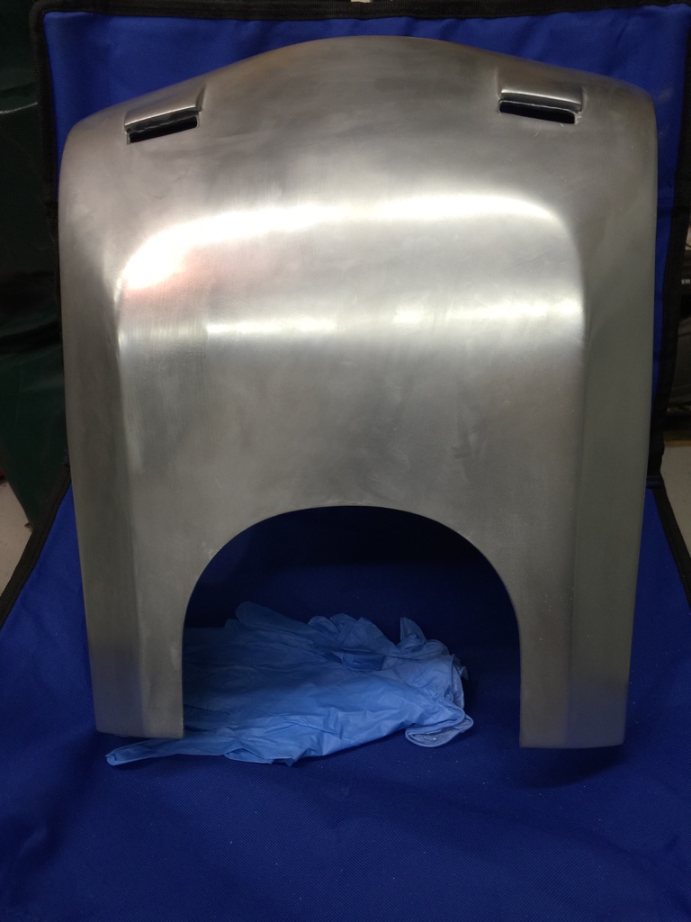

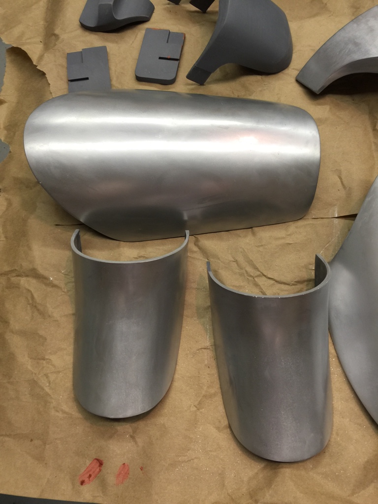

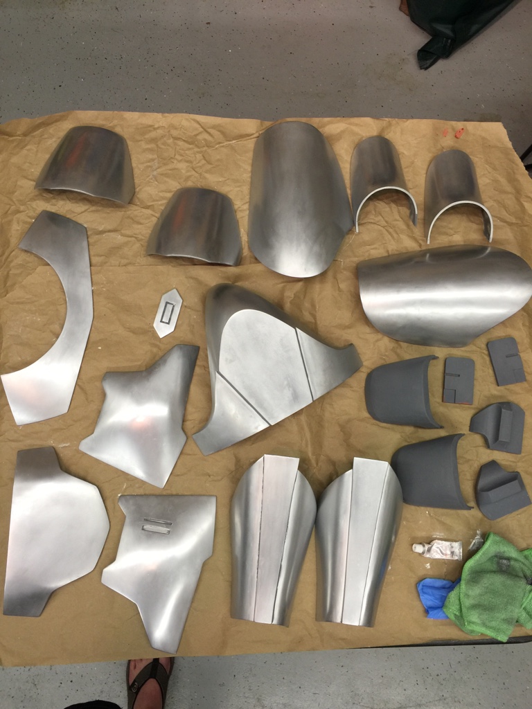

My first time.
Sanded with 400 dry
Primed with Rustoleum 2x. Waited 30 hrs
Wet sanded with 1,000 - waited 12 hrs
Used my hands with rub n buff silver leaf
My armor looks like this. Is that how it is supposed to look. I see some swirl marks. Did I use to much? Not enough? Can I recoat?
The tube had a 2014 date on it. Just ordered last week.
ImageUploadedByTapatalk1431301912.736007.jpgImageUploadedByTapatalk1431301925.088657.jpgImageUploadedByTapatalk1431301934.806189.jpg
Any advice please.
Sent from my iPhone
Looks great on my IPhone, but that may not help. Swirls in it like too much put down? Like build up? Maybe take it off and try again using less? It is ok though if it's not completely smooth like mirrored finish. It will still need some weathering, and it should look used. I've only done small parts with R and B, so not sure when covering a large surface area.

You will get some swirls no matter what you do. You can try buffing with a very soft cloth like an old t shirt after a few days of the rub n buff drying and that will help. You can also wet sand the rub n buff after it dries and try again and I found you get a better finish the second time. I think the rub n buff fills in some of the small pores and gives a better base to work on.

I had the same problem at first with rub and buff. When I first did it I put it directly on the piece and it lumped up. The second time I put it on my hands then rubbed it into the armor and it worked perfectly.
