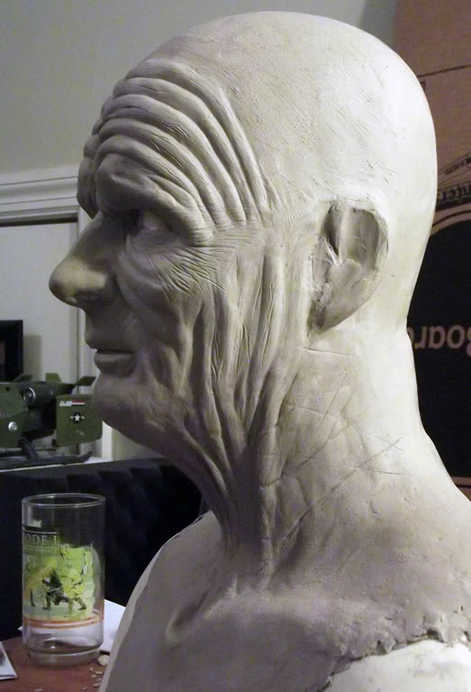

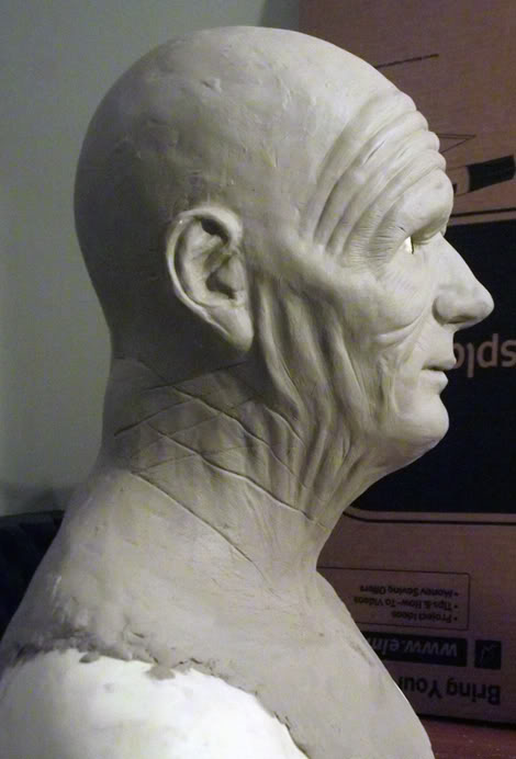

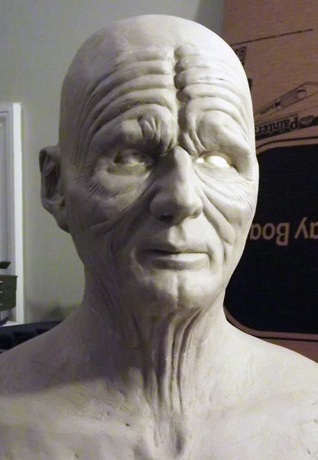

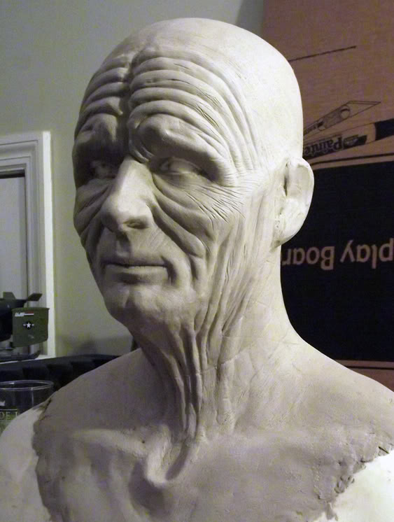

A buddy of mine and I have been wanting to do some silicone masks, so I figured since I wasn't as familiar with making them I'd start off with something familiar to use as a test subject. I'm not used to working with an armature and needing to keep thickness in mind, so I thought doing something I liked would work, but not something that if I made mistakes in the design/molding/casting process I wouldn't be compelled to go back and do the same subject again. I've done plenty of sculpture, and casting in silicone...but not like this. Seems fairly straightforward in the creation of silicone masks, but still.
Anyway, I chose Revenge of the Sith Palpatine as it's something I do with makeup I created back in '05 for the release of the film. Just some quick prosthetics I made in two days time. I'm familiar enough with the design, and it's something I felt I didn't need to be completely accurate on with making it look 100% film accurate and 100% accurate of Ian McDiarmid as each wearer's own bone structure is going to alter the features slightly anyway.

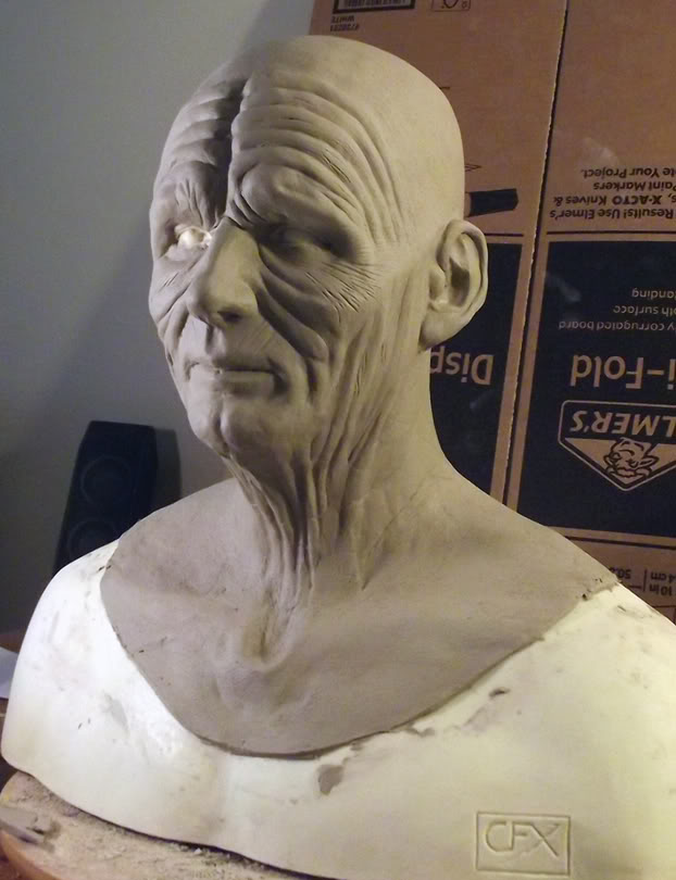

So, WIP time. Sculpt is nearing completion...need to add his left ear, fix a few symmetry things and finish texturing. I'm attempting to mold next weekend, as my first lesson learned is not to use WED clay. Works great for solid sculpts, but thin applications such as this is causing it to dry up quicker than usual. The harsh lightin is muting a lot of the texture that is already there, but once it gets closer to competion I'll take some better pics. there is a lot of detail that is not coming through in the pictures.

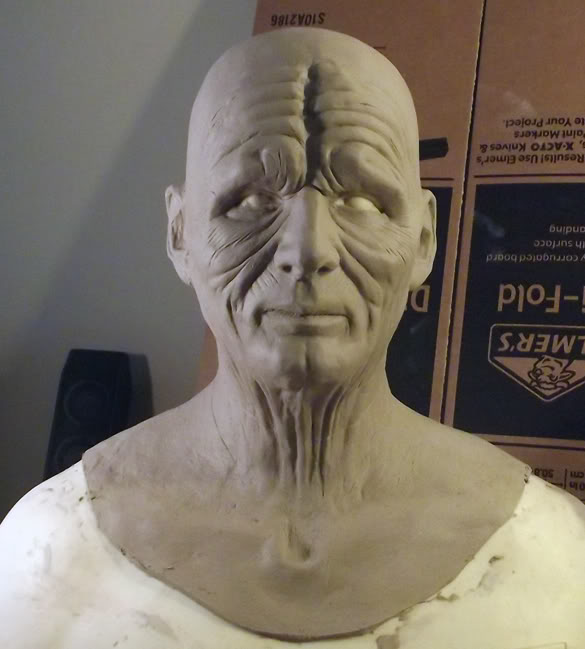

About to get started working on it today, and got a better pic with my phone that shows the detail.
Kinda sad that my phone got a better pic than my camera.

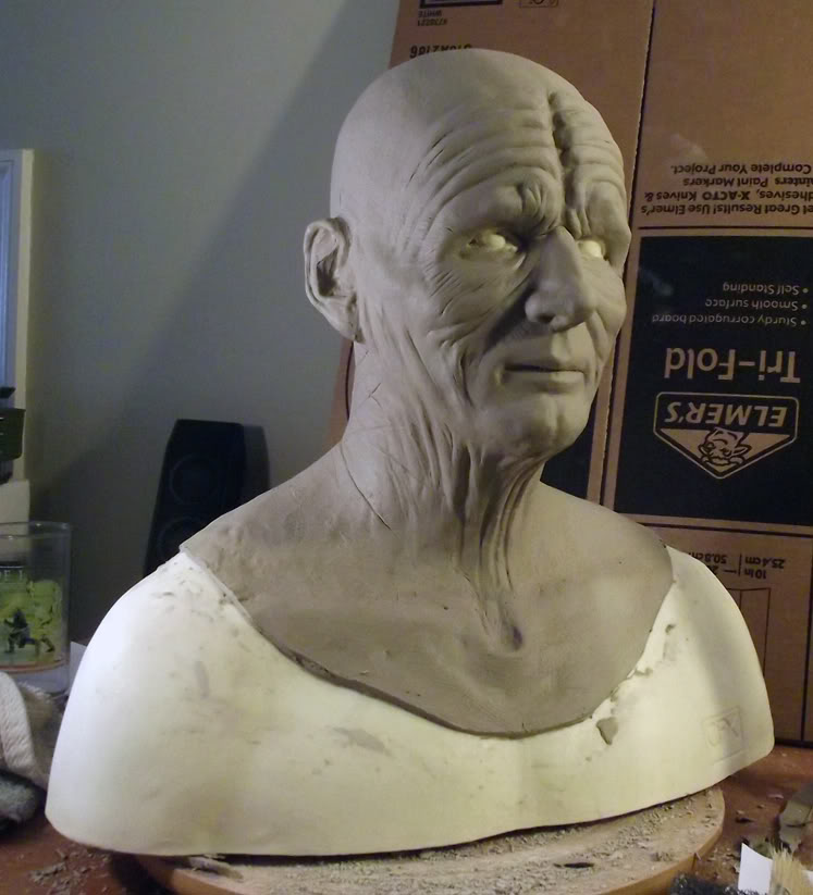

I did do something similar, it's just not showing up well in pics. I have a few different tools for pores depending on where they are on the face, as the pores on your nasal labial folds will look different as say on your forehead. This one is pretty much wrapped up now, just holding on until molding. I'm scared to work too much more on it as the clay is really starting to dry up. I'm spritzing this sucker several times a day and keeping it as air tight as I can. I'm using Chavant for the next sculpt.

thanks, unfortunately I found out the hard way that wed clay and fiberglass don't go well together. Not sure if the mold is going to work or not. May have to start over, but after having all these problems with wed I learned my lesson. Chavant was ordered today.
I'll let you know. Mold may have worked, after sitting for a few days, the problem area dried up. It was weird, but both halves have been done. De-molding Thursday and if everything turned out okay, I'll be ordering the silicone early next week for the first pull Easter weekend.
It would seem that the moisture from the wed clay, which is water based clay, caused the first layer of gel coat to remain tacky. At least it did on the separating wall and on the backside, which only had that layer. When the wall was removed, I couldn't see any problems with the first half of the mold, but the one layer on the back remained that way until four days later when it suddenly seemed fine. So, I finished the mold. I had planned on a silicone mold at first, but I kept reading that most people making silicone masks just used fiberglass molds so I made that choice without checking to see if wed would have a problem. I think it's going to be okay, and will see in a few days. Next sculpt will be done in Chavant, so I won't have that issue or the time constraint of trying to get the sculpt done before the clay dries out. Wed is great for sculpting busts, but didn't work well for this.
