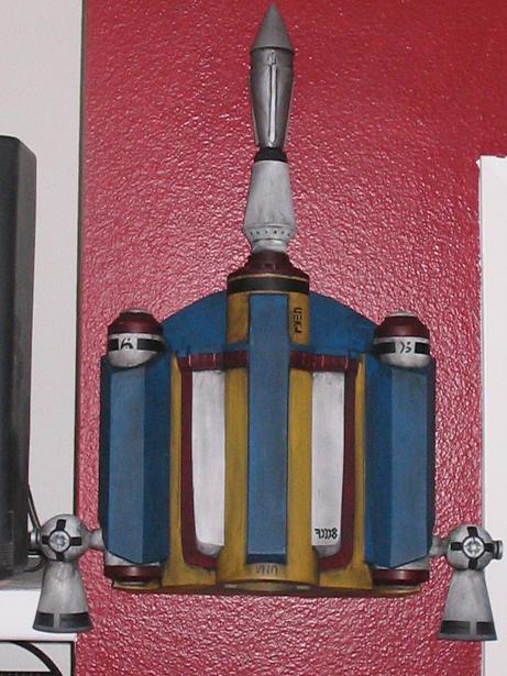

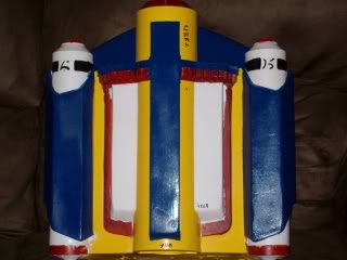

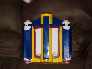

I have just about finsihed painting my jet pack. I think it is looking pretty good aside from having to add weathering. Please feel free to make suggestions from the pictures below. However, I do have some questions, but the pitures first.

ummm...
I believe the top tank caps have the paint reversed
they should be like the lower tank caps
You're correct Slave1pilot, he's got the colors on the top cap reversed.
As for your two questions, do a quick search in the "Rocketpack, blasters and shin tools" section for some of the scratchbuild jet pack threads. You'll find some great ideas there for attaching your rocket.
As for the thruster attachment... you'd be best off to drill some pilot holes ( for placement ), then increase the hole size to accomodate the thruster. For this, I used a spade bit... but I'm sure that there are other/better methods for doing this.
Nice looking pack there slave1pilot! ;)
There are minor differences between the Jango and ROTJ packs, the most notable are the lack of excessive weathering ( scratches ) on the Jango, and the lettering/symbols. Jango has different symbols and more of them.
Naush, when you weather your pack, try to add a misting of orange to the yellow parts to tone them down a bit. You don't need much, just hit the yellow areas more towards the edges/seams where they meet the other colors, and feather outwards.
As for the general type of weathering... just keep this mantra in your mind. "Less is more"... you can easily add more weathering, but it's a re-paint to take it away. ;)

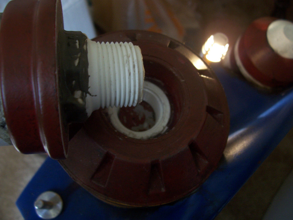

For the thrusters, I drilled a pilot hole, then gradually increased its size with a sanding drum on the dremel.
This is what I did for the rocket - these are I believe 1" PVC male/female couplings I found at Home Depot. They are JB Welded on.
Ugh, I don't know how I mixed up those colors. No worries. I can fix that. I was thinking about using a screw or two to hold the rocket in, but I like the idea of using the pvc. I'll see what I can find. Thank you for the assistance so far.
