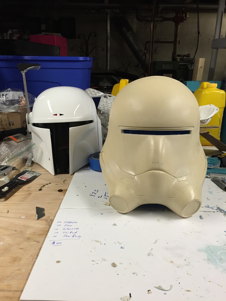

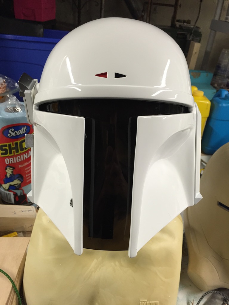

Not thinking I left my resin helmet in my basement ( 80 degrees )for a couple days. Normally I keep it on a post but this time I didn't. As a result the front is all distorted now. Thoughts on how to get it back to the right shape? I was going to put straps around it and leave it down there for a day or two. My other thought was to do the same thing but run a hair dryer over it. I want to wear it this weekend and don't think I will be able to get the fiberglass one done by then.

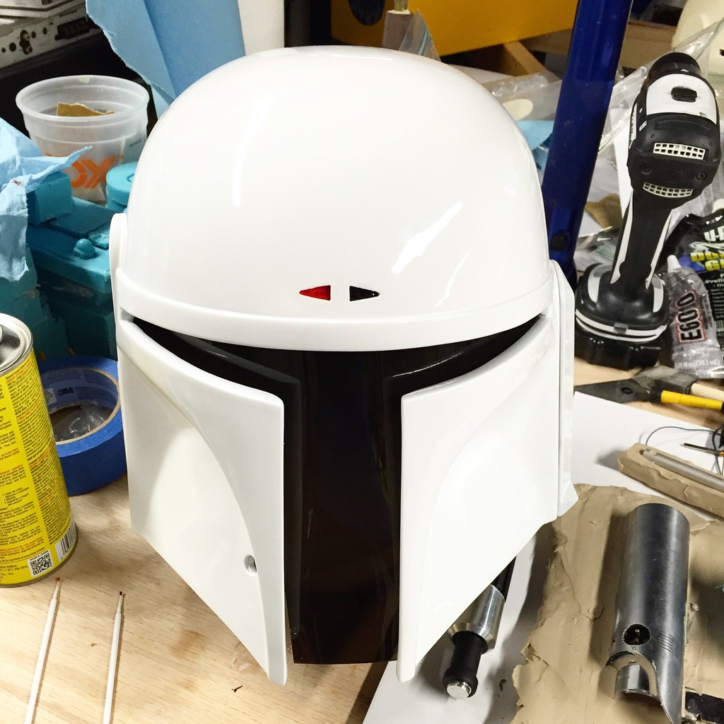

It actually had a really nice gap and shape from the start. It is an AnimeFan dentless helmet. I was concerned about it warping since I was told that could be a concern. I always kept it on a roll of paper towels as a stand and had zero issues. Hopefully it goes back Into shape for the weekend since I don't think I can get the DVH one ready that quick. Here is a pic from before with the visor just sitting on the helmet not attached.
It got a little bit better. Tomorrow I am going to get it secured in the shape I want and put it out in the sun for an hour or so and then put in front of the AC. Don't want to give it too drastic of a change incase it were to crack the paint or cause it to peel. It should be fine. Worst case is will make the visor more secure and hold it in shape that way. Thanks for all the help!
