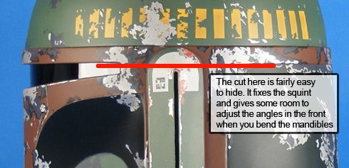

Here are the guide photos I used. Helmet photos from rebelscum.com
The cut I ended up making was a bit longer than that... almost to the keyslots. The longer the cut, the more you trash the paint, but the easier it is to reposition everything.
