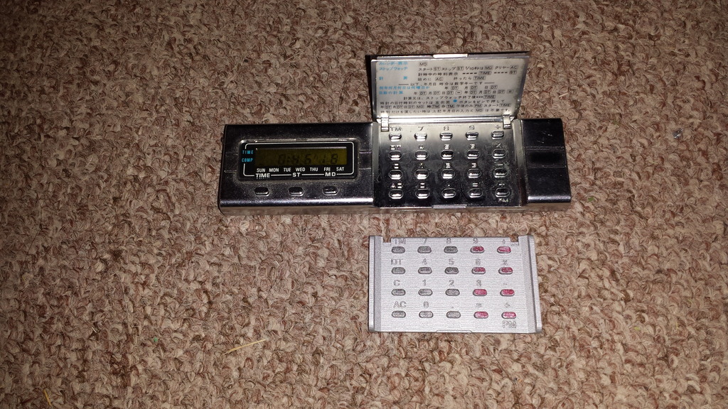

The one I offer is modeled from an actual Casio MQ-1 calculator that I own.
Any reason why Rafal's might be different? Pretty sure all his is to scale too.
Because I asked him a little earlier yesterday about it.

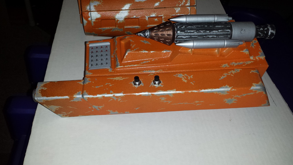

I can't answer anything in regards to the accuracy or the method in which was used by Rafal to design his version, this would have to be answered by him. I am sure his is spot on as well. His is a 2 piece which I have also modeled & have printed which is what is in the above photo but I need to make some refinements before offering it for purchase.
In my opinion the quality & accuracy would be equal. The differences in them would be so slight due from error of measuring them that you wouldn't be able to tell by just looking at them.

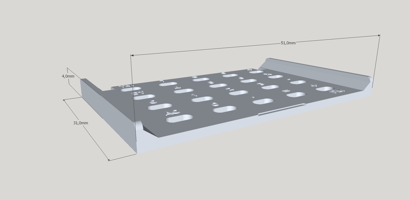

Here are some measurements of my model:
I used only images to do the model with measurements taken from Art's left gauntlet and these from an older post:
The general dimensions are 2" wide x 1-1/4" long.
Now if you want some really, really, really specific measurements.....
Originally posted by Braks Buddy:
The dimensions for the keypad are as follows.
Overall Height: 1.24" - 31,5mm
Width of flat section of keypad: 1.75" - 44,45mm
Width of small bevelled edges along the sides of keypad: 0.097" - 2,46mm
Height of keypad button: 0.078" - 1,98mm
Width of keypad button: 0.152" - 3,86mm
Alright! Thanks guys, just wanted to make sure because measurements on both where different haha.
