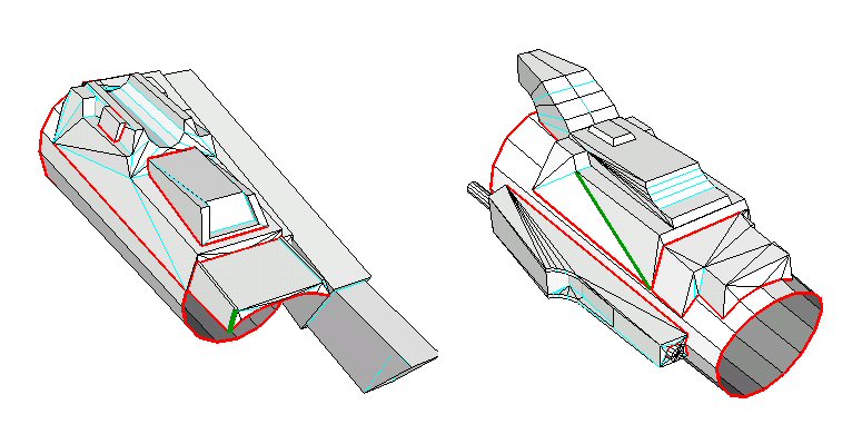

I have created Fett gauntlets using pepakura. ;) They are modelled based on the blueprints drawn by our own WoF. Some details was fet out to keep the build as painless as possible with finer details being left out. Though the basic shape is there on both left and right gauntlets.

High quality is the wrong term. High Poly. ;) A high poly model is not always necessarily better than a low poly model. It depends on the intended use.
Most 3D models you find online are high poly and therefore no good for Pepakura. You'll end up with hundreds if not thousands of parts which will take up alot of card and also take forever to build properly.
3D models intended for Pepakura use need to be relatively simple. With the key details being focused on. This is where lower poly models are better.
Don't forget, if you plan on building a prop or costume part with Pepakura then your whole build will be covered with bondo/filler in order to smooth it all out after fibreglassing. The Pepakura part of the build should only be seen as a base. A starting point that lays out the basic shape and key details. To finish a pep build well it still takes time, patience and a degree of skill to complete to the point that people would never even know it started out as a card build. ;)
