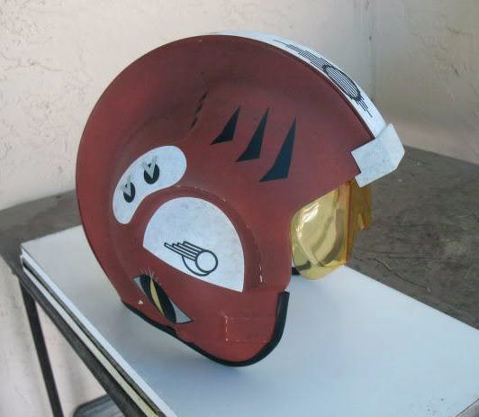

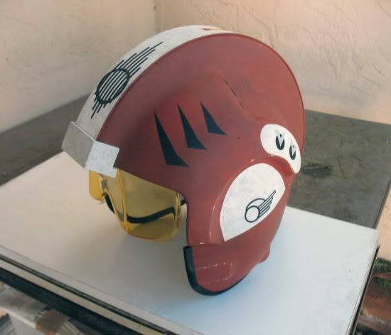

For the main color, I chose Floquil Zinc Chromate Primer, which gave a really nice red-brown tone. The overall paint scheme on this helmet was pretty simple (compared to some of the other pilots!) and I simply masked the areas to remain white, and spray bombed the whole helmet.

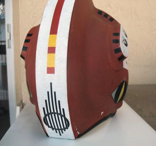

The "V" markings, the "sliced onions" on the Mohawk portion, and the "flying ball" on the cheeks were decals from Lucksy31. Thanks Scott! I finally got to use them!
For the "tiger stripes" on either side of the Mohawk, I masked and painted them with Floquil Engine Black. These were trickier than I thought they would be to mask off, with a couple of shallow angles.

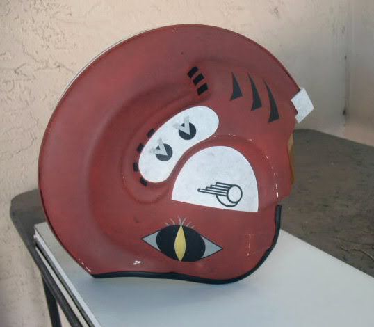

The eyes on the lower cheeks were also masked and painted. I had to do this in 3 stages; first masking and painting the main black portion, then masking that off and painting the gray outer portion, then masking it all off again the painting the yellow pupil. I hate waiting for paint to dry, so this was really tedious for me!
The eyelash details were hand painted with a 3 0 brush. (Yes, there are eyelashes on the screen caps, so I added them!

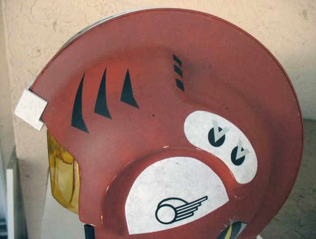

After everything was nice a dry, I went back and did a heavy black wash over the entire helmet. I don't usually do washes, and I worked quickly to keep it even over the whole surface. I dabbed it away in certain areas to leave a little more of the base tone, but basically the whole thing was "slopped" with thinned flat black acrylic paint. Gives it a really nice, grungy appearance.
