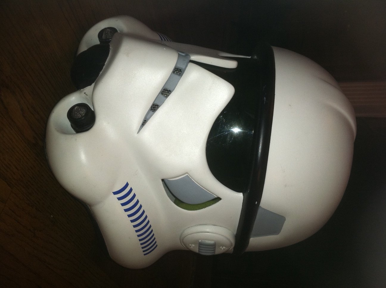

I recently bought a used Master Replicas Stunt Helmet. I wanted to rework the entire helmet to be a bit more screen accurate as well as incorporate a better speaker and fan system. I know that everyone does TK's, but they are fun and this is my first attempt at doing trying to make one quite like this. Please feel free to comment and/or criticize. Thanks.
I almost forgot to take a picture before I started stripping the old paint. This is the MR CE completely taken apart in every way possible.

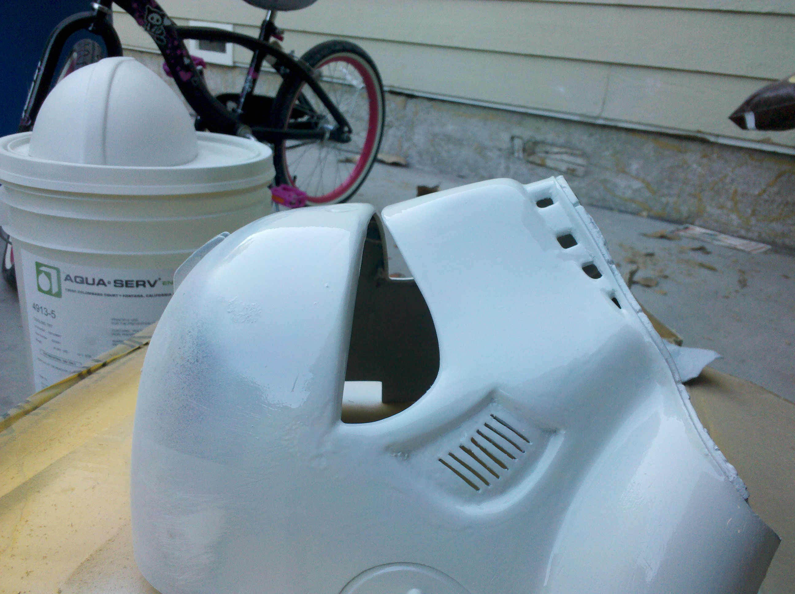

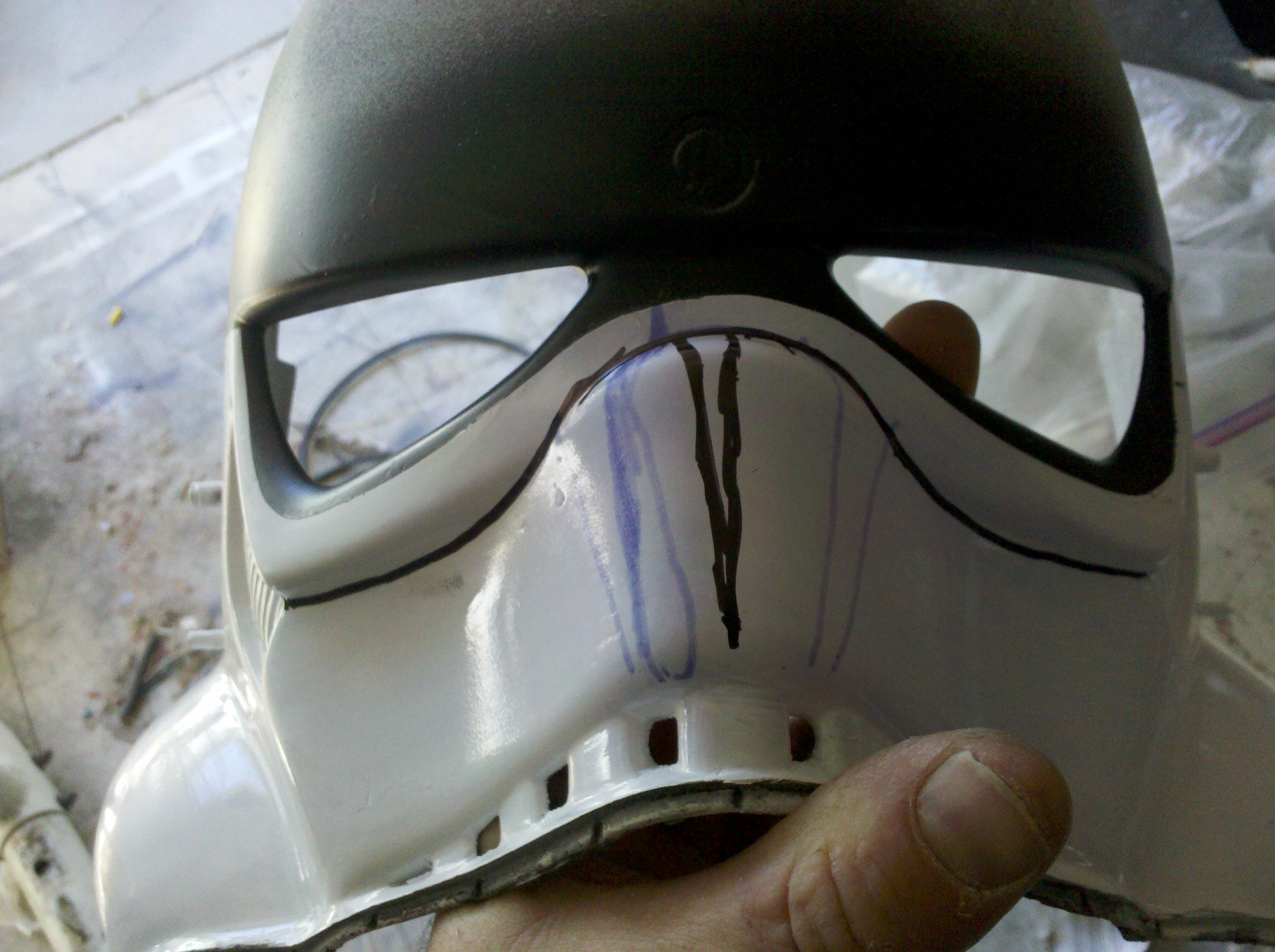

In order to get close to this, I had to do some reshaping of the faceplate. As you can see here, I marked off the cheeks and nose, which had to be moved back in order to get that flush look.

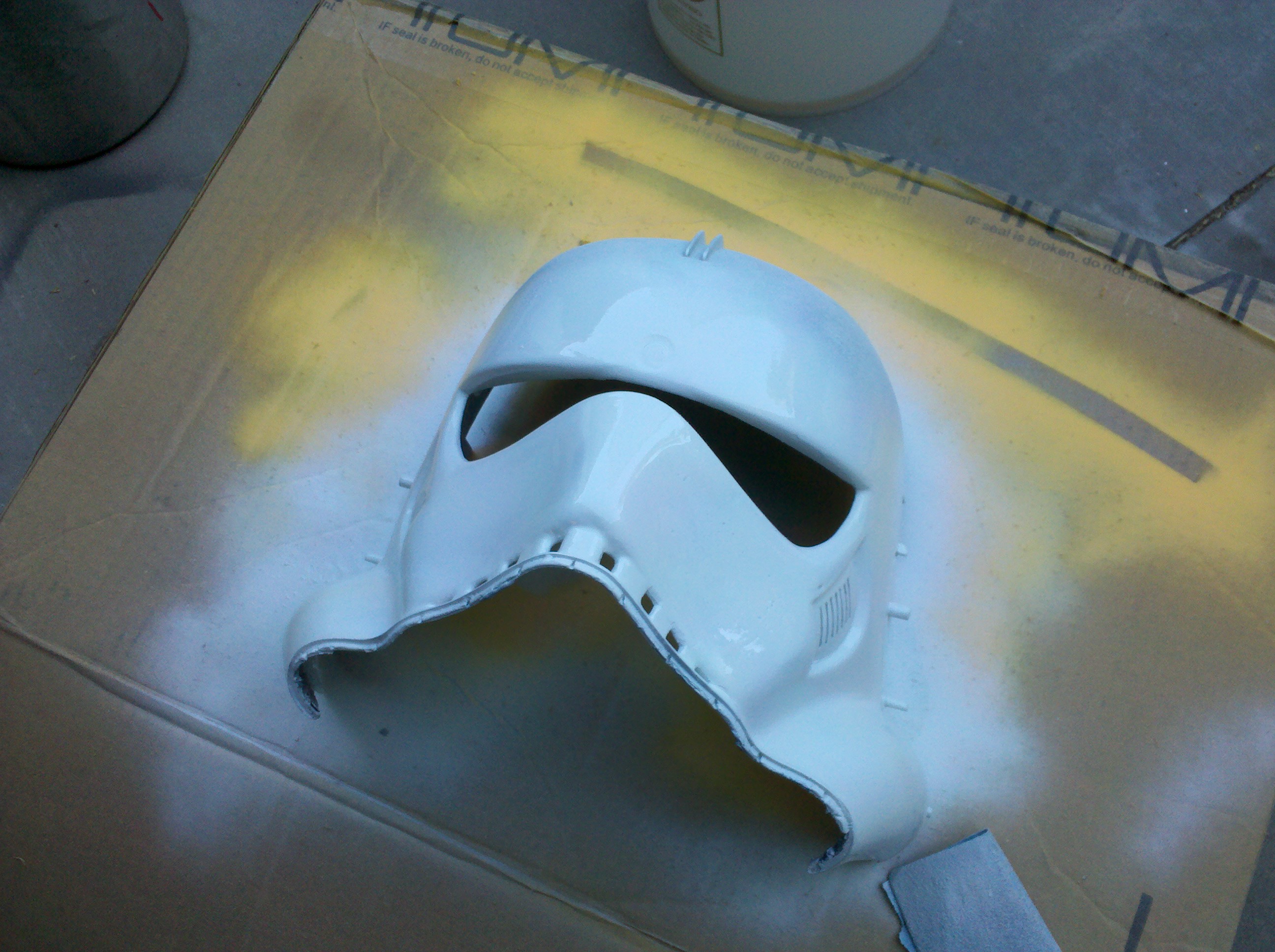

I cut everything out with a dremmel, then used a heat gun to get the plastic to fall back about 3/8" of an inch. Then, I used epoxy to seal the deal.
After the epoxy dried, I cut the visor so it would resemble the images from the game. I then used fiberglass filler to smooth out the faceplate, sanded, and sprayed a single coat of primer. Obviously it is still very rough and needs some trimming sanding, etc. But I think it's coming along. I'm not sure if I am going to keep the side vents or not. I'm not going for accuracy necessarily, just having fun with it.

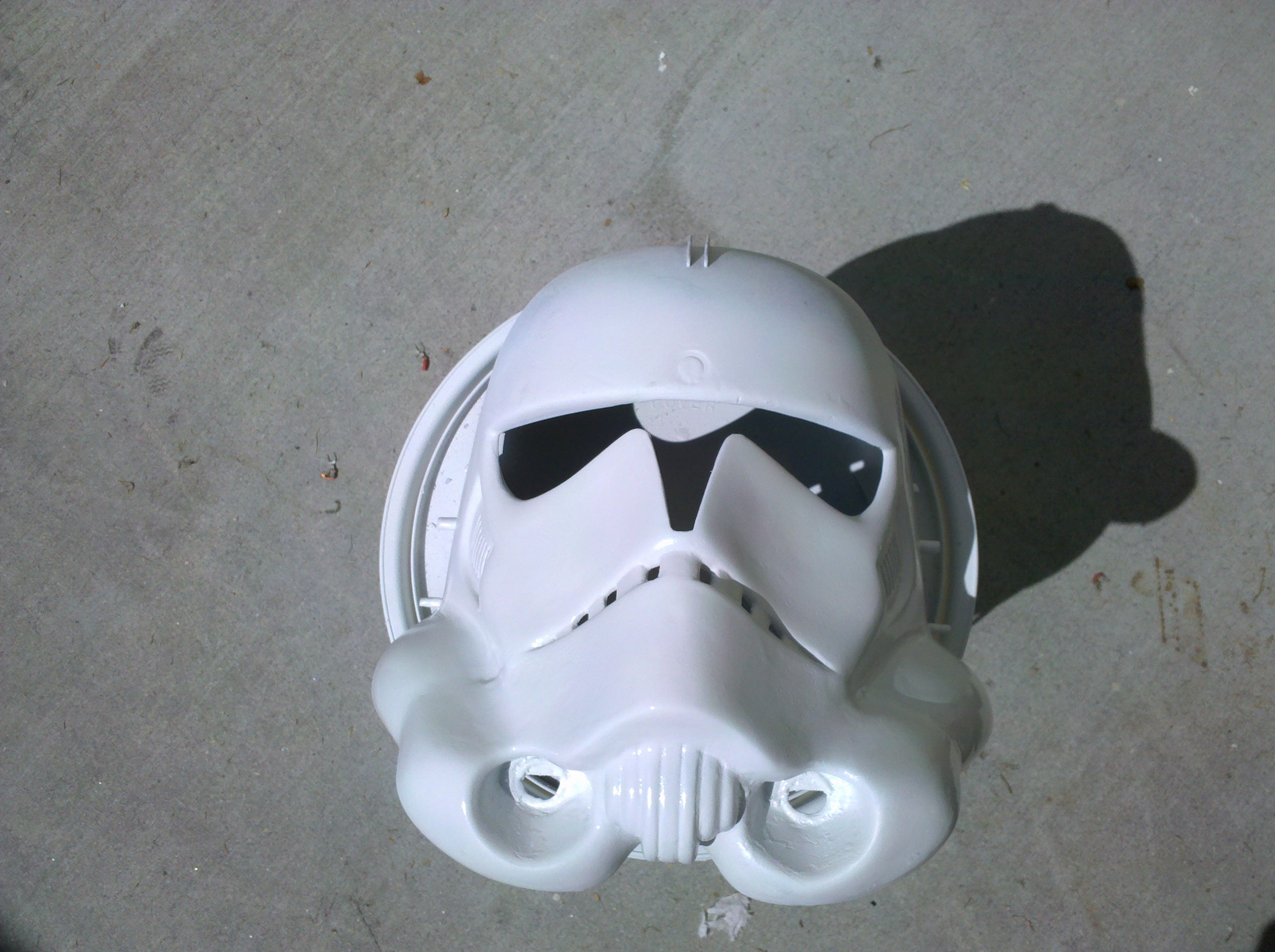

Okay, I decided to go with the 'T' visor look. I thought it would further the transitional look. I also cut the area below the frown back about 3/4" to shrink the helmet down and I also had to cut the chin down a bit to make it look more like a Episode III helmet. I think it is going in the right direction. I have seen this done before, but it has always been with a clone helmet modded to look like a stormtrooper, never the other way round, (that I know of).
Your comments, advise, and criticism are greatly appreciated. I will update further when I get the rest of the plate sanded and filled. It's pretty rough right now, but the shape is there.

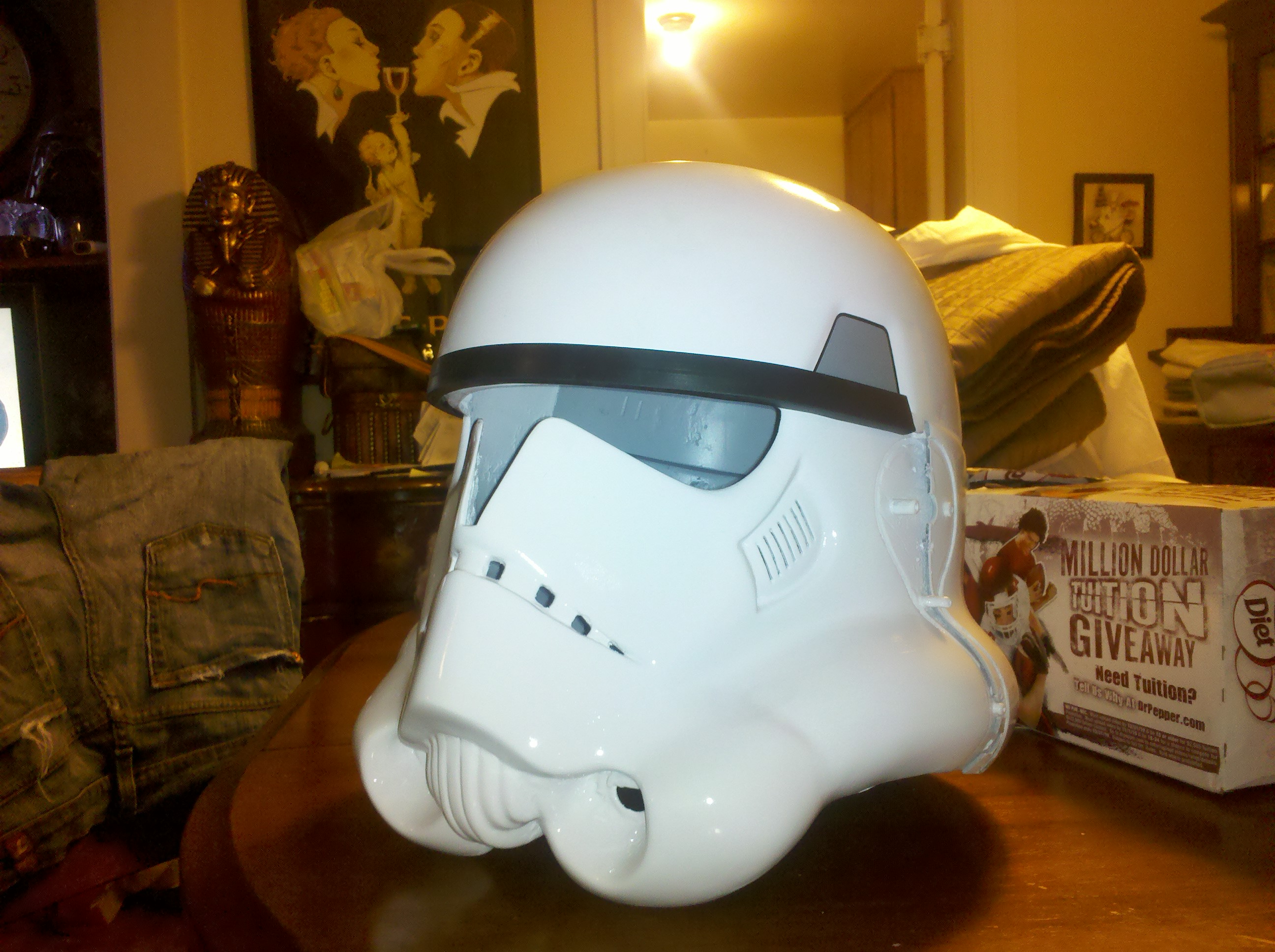

Here is a shot of the helmet loosley reassembled. The parts are just resting on each other because I still need to sand the faceplate, so not everything is lined up right. And I have not put the ears on yet either.
Looks really good. Are you going to put a crest on the top of the dome like in episode 3?
I don't know yet. I have cut out a few pieces of styrene to play around with. The problem with stormtrooper helmets is that they are just so big. I'm worried it will end up looking like a bobble head.
Thanks for the compliment BTW.
I dont know if being a transition helmet and all if Id leave the dome the same as the stormy helmets...like look at the pics it has a clone like dome on it where it doesnt have the depression in the front two sides...I dont know if this is something youve thuoght about but I think Id incorperate it maybe?

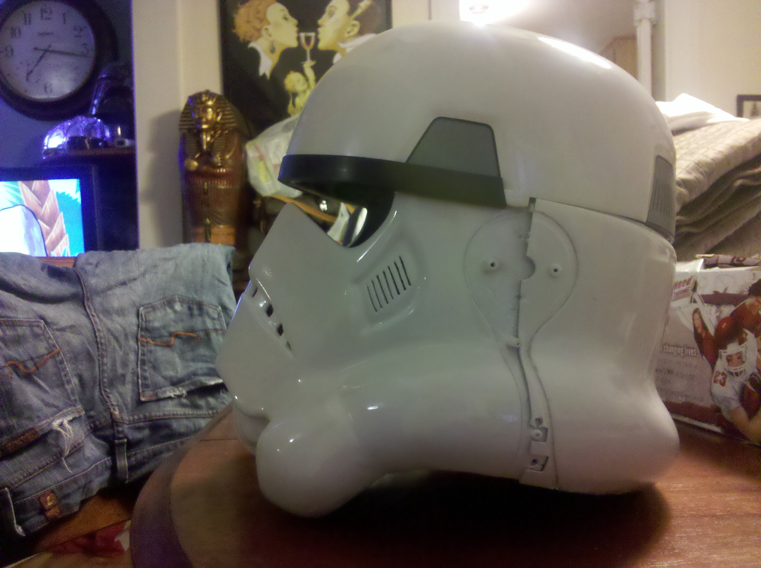

Okay, It's getting closer. I took some advise and changed the cheek dimples, (you can't tell here) and modified the back of the helmet. I'll post more photos after the chin and frown are painted and I get some weathering done.
I never did finish this thread. Here is the finished pics. Not the greatest looking custom in the world, but it was fun to do regardless.
