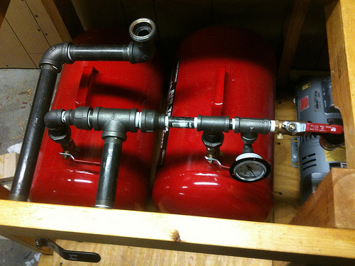

this is the setup i'm building:
2 10 gallon tanks, evacuated by a rotary vane pump.
my pump is a 3/4 horsepower, 10 CFM, but only rated for -26". the pump is about $800, which i why i was surprised to see a $100 one that says it will do 29.9.
for a small / casual use system it may be easier to just use a shop vac.
