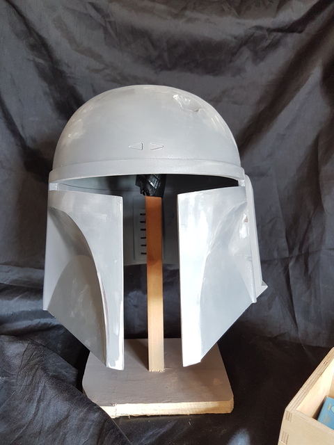

So I want to make a buck so I can cast a helmet, I do like my one I made from the templates and I will keep it going as long as I can as its perfect for trooping, that said I want to up the game a little, I did start a brief conversation about this on my ROTJ journal but am moving it here, I need as much input as possible ( I wont say criticism as I hate that word)

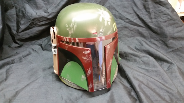

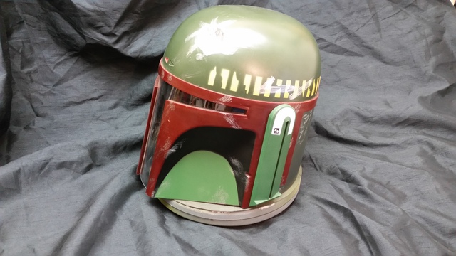

So I got this helmet that Target was selling some time ago its kind of ok, there are lots of inaccuracy's on it that if modded could make a useful buck to cast from, I am sure by now everyone is aware of these helmets and the work needed to get it up to a good standard.
I have seen some painted and they look fantastic but I can see they have way more potential.
mods include
Remove visor
Reshape the dent (it's not in the right place but not far off)
Widen visor area and infill visor grove

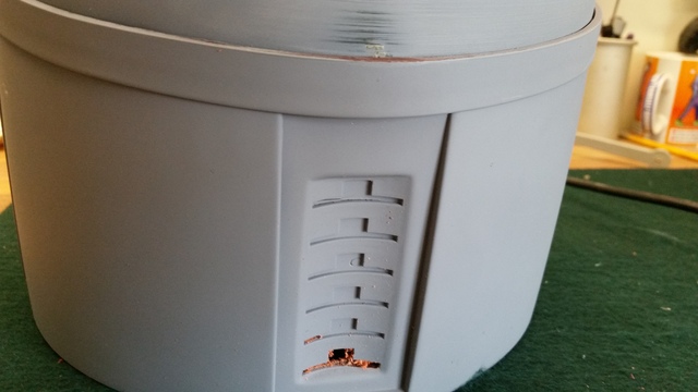

Cut key slots and make slightly taller

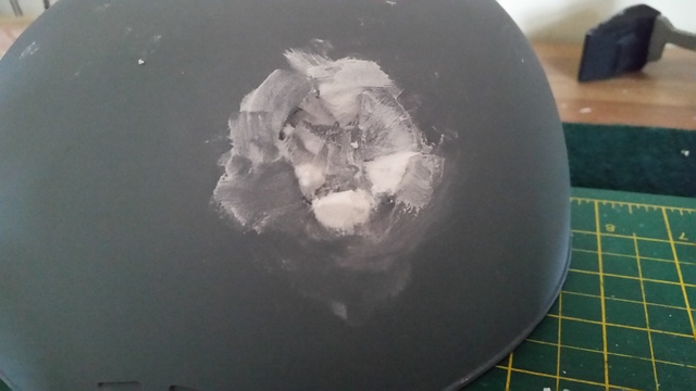

Add the damage, scuffs, and chips
Re-position right ear and move up.
Fill and curve the top of the dome (as it has a flat top)
Re-shape bottom of left ear
widen range finder cap and slit
Make new range finder
These are but a few mods needed as a start, but the end game is to have something that looks correct, is solid and can take a silicone mold for casting.

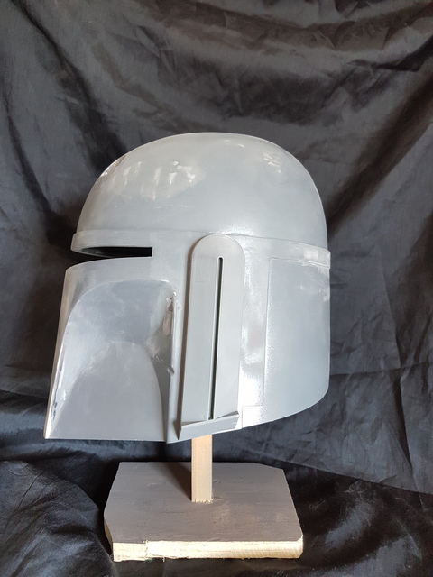

the top of the dome needed filling out so I have come to a good point where it looks good but could do with a bit take off
it is smooth as marble so dead happy about that. but needs curving inward a bit perhaps??

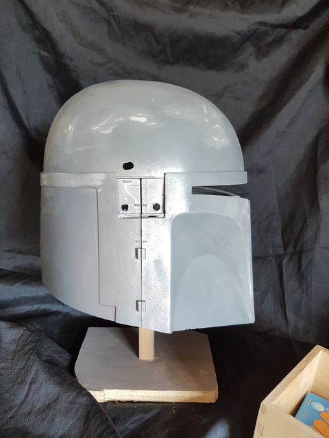

Boushh lid maybe:unsure its a tricky helmet to get right the one I have made could do with a bit more time on it. I will still go ahead with this modded Fett lid and cast one even if its just for my self and see if it's something I can do with a quality finish.. It still needs lot's of work I am trying to work out the correct thickness of the visor section at the moment and come up with a good balance as it was before it seems a bit shallow so the visor was cut out widen up a bit and filled smoothed.

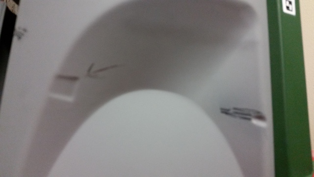

If anyone knows the answer to this quastion it would be a great help - The front of the visor where the mandible curves from the top of the cheek round and down to the bottom of the chin? is the leading edge of that a crisp sharp line or is it slightly curved/smooth? I have never been able to tell just from the original pictures? the Target lid has a very smooth curved edge to it looked?
