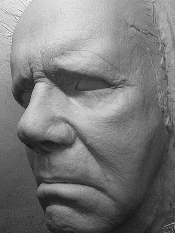

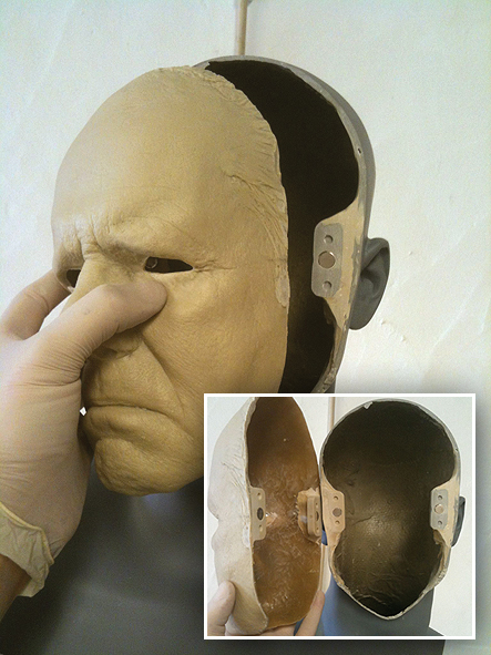

As some here may know, a few years back I did a project with Jeremy Bulloch... I cast his face and offered a limited number here on the TDH. Part of the reason for this was to eventually use one of these casts for my Boba Fett mannequin. Well I've finally got around to making a new mannequin for my costume (new pose), so for this I will be adding Jeremy's face to the mannequin. I obviously need the face to have 'open' eyes (Jeremy's eyes were closed when making the original life cast for obvious reasons).
I was tempted to 'de-age' this cast, but I think I prefer the face as it is today, I may add a scar or two on the final copy though.

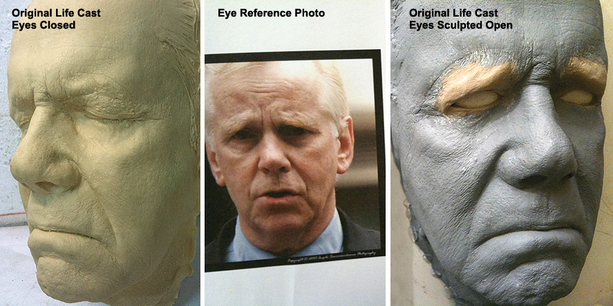

I removed the closed eyes from the cast and sculpted 'open' eyes using wet clay. I will now need to make a mould of this then produce a fibreglass copy. Once that's complete, I will replace my mannequin's face with this copy, I will then paint it with fleshtones add realistic glass eyes.

The mould is now finished and I've produced a fibreglass copy. The next steps will be trimming this and fitting it to my mannequin's head. I want the face to be detachable so I can access the eyes which will also be removable, this means I can alter the eye position if needed.

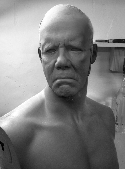

I've replaced my mannequin's face with the 'trimmed' Jeremy cast (just held in place with duck tape at the moment). Pretty freaky so far, still needs eyes and a good paint job.

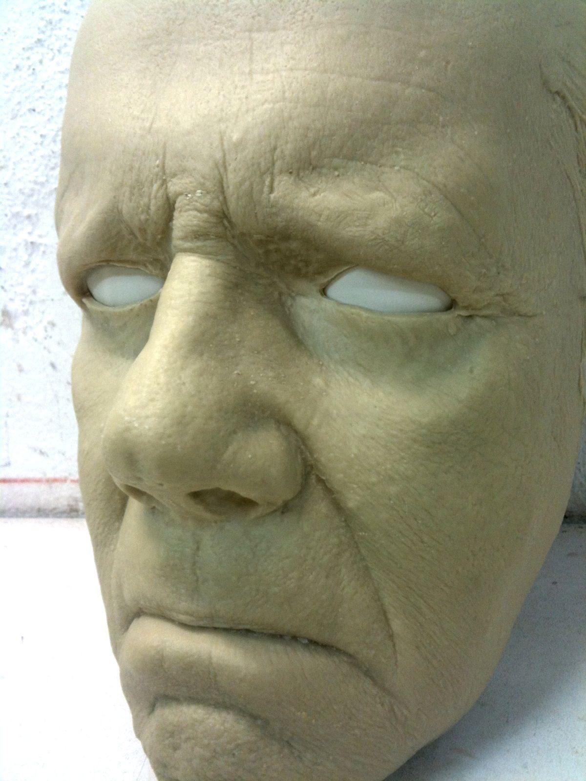

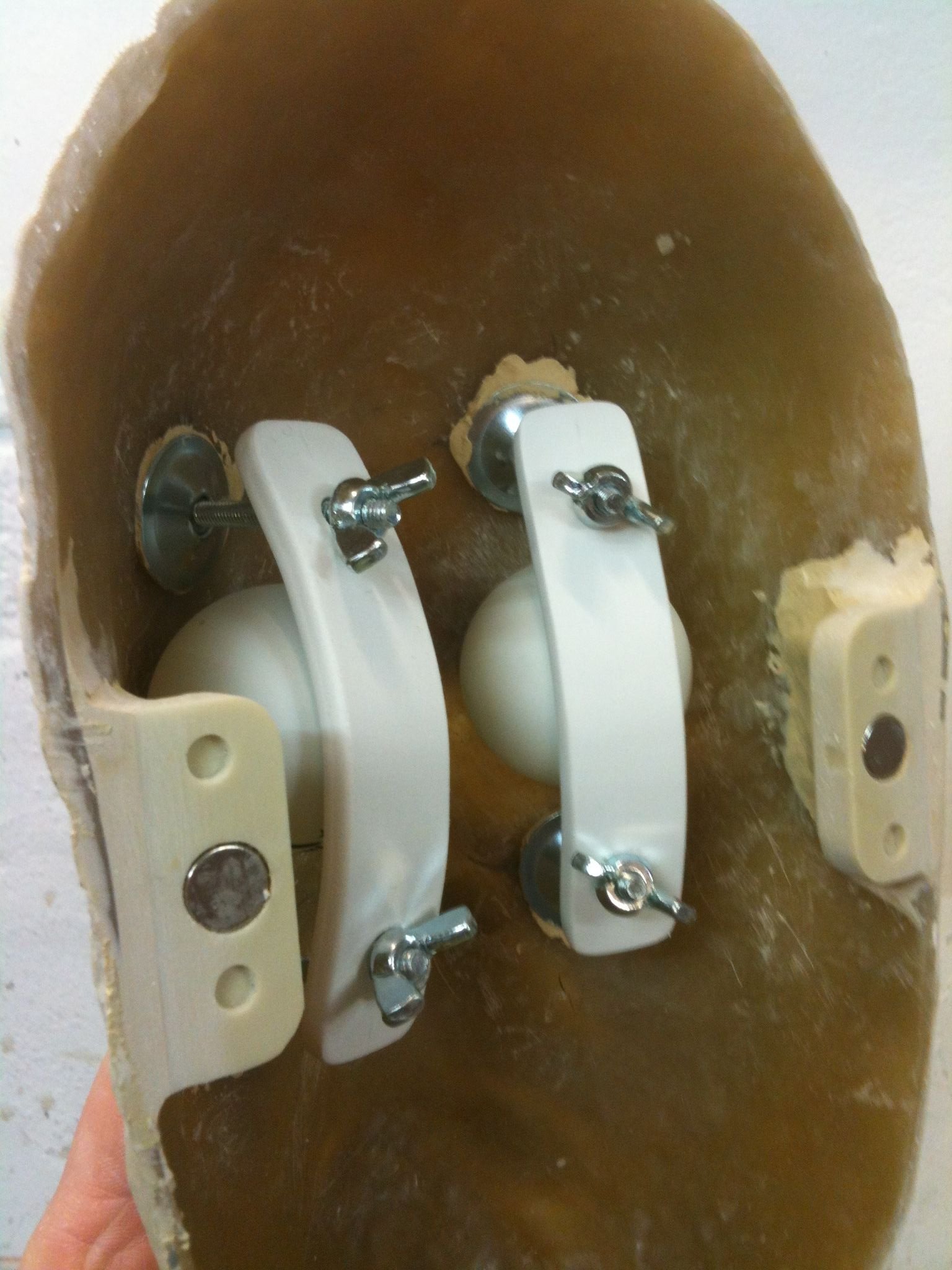

The face now has magnets on either side so it locks to the mannequin head. I've also installed the eyeballs, they are removable and can be rotated easily. The next step is to add the eye details to the eyeballs.

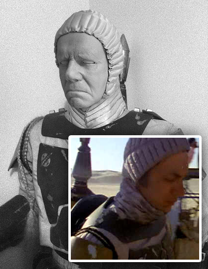

I've now finished the Balaclava, it's also made from 'tackle twill' to match the neckseal. It has a drawstring around the front which is tied underneath the chin. I'm really please with how this turned out (a big thanks to my talented wife who sewed this together tonight).
