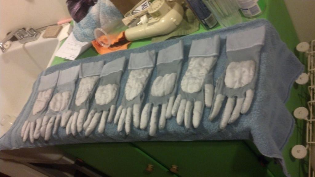

Since I began offering Boba gloves in 2011, I have been constantly tweaking them to create the most visually accurate glove i can produce. I started by testing out pre-made gloves, that i sourced online. They had a strange shape, and were very cheaply made. So I drafted my own pattern, it was a simple one cut pattern that would be folded over and sewn then the thumb was stitched in. I didn't have a source for accurate tackle twill at the time, so i had to make the pads for the back of the hands out of a less than desired material. Also, the patterns for the pads were undersized and didn't always turn out as uniformly as I would have liked. The first revision of the original glove was to create a pattern for the pads that I continue to use. As well, i used two different colors of fabric for ESB and ROTJ versions. The second revision was to switch to a white fabric and dye the gloves to the appropriate color, which was the process used to create the grey ESB gloves (I believe the ROTJ gloves were reused from ESB, but due to poor storage between films they bleached out a bit and were therefore a lighter shade). I finally sourced tackle twill and began using it for the pads as I went back and redid the base pattern for the glove.

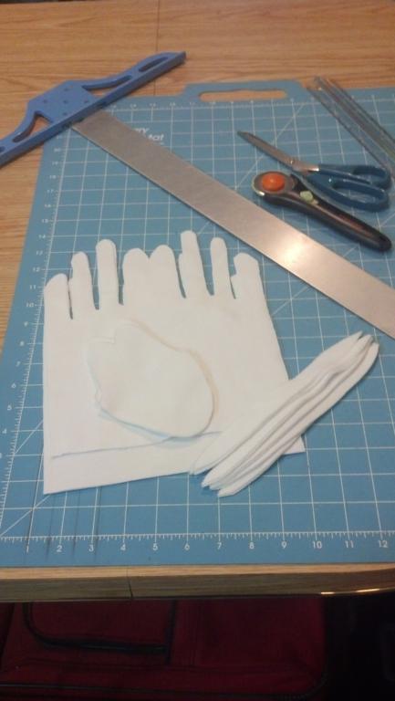

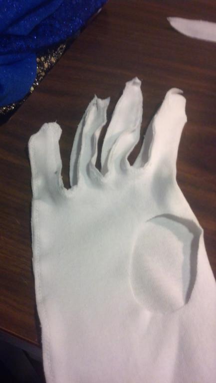

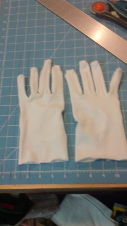

The base glove cut out with thumbs and gussets.

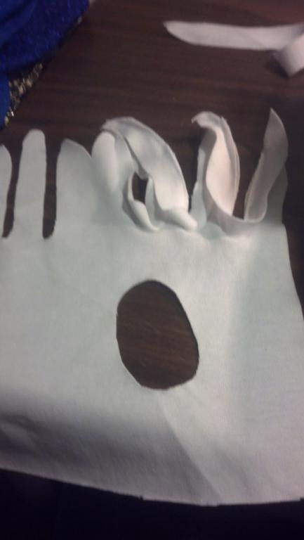

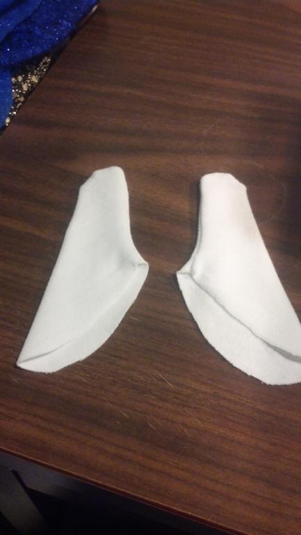

The first thing is the sew the thumbs in opposite directions to create a left and right side.

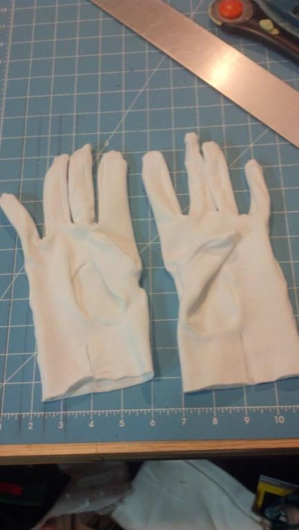

Next is to attach the gussets to the hand, making sure to flip one glove opposite to ensure left and right. The hand is flipped onto the gussets and closed so when it is finished being sewn it will be inside out.

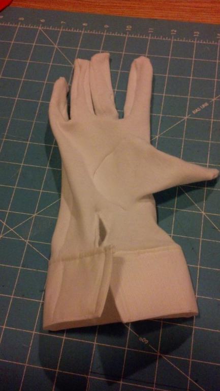

The thumbs are sewn in, with attention to their placement so the seams fall correctly. Also, the wrists have been split to accurately recreate the split found in the original parade gloves.

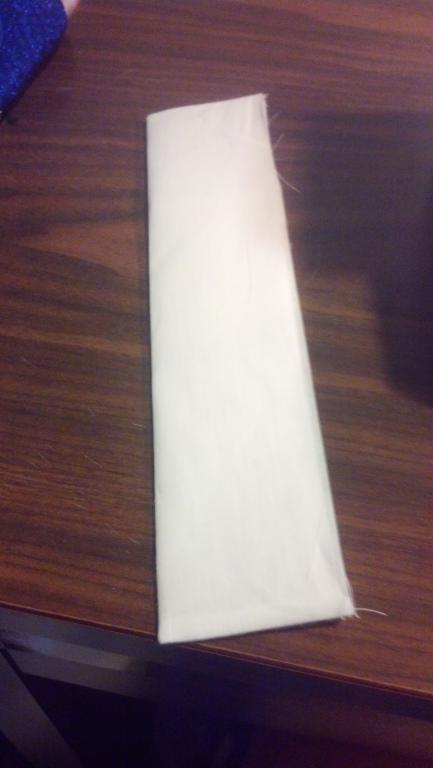

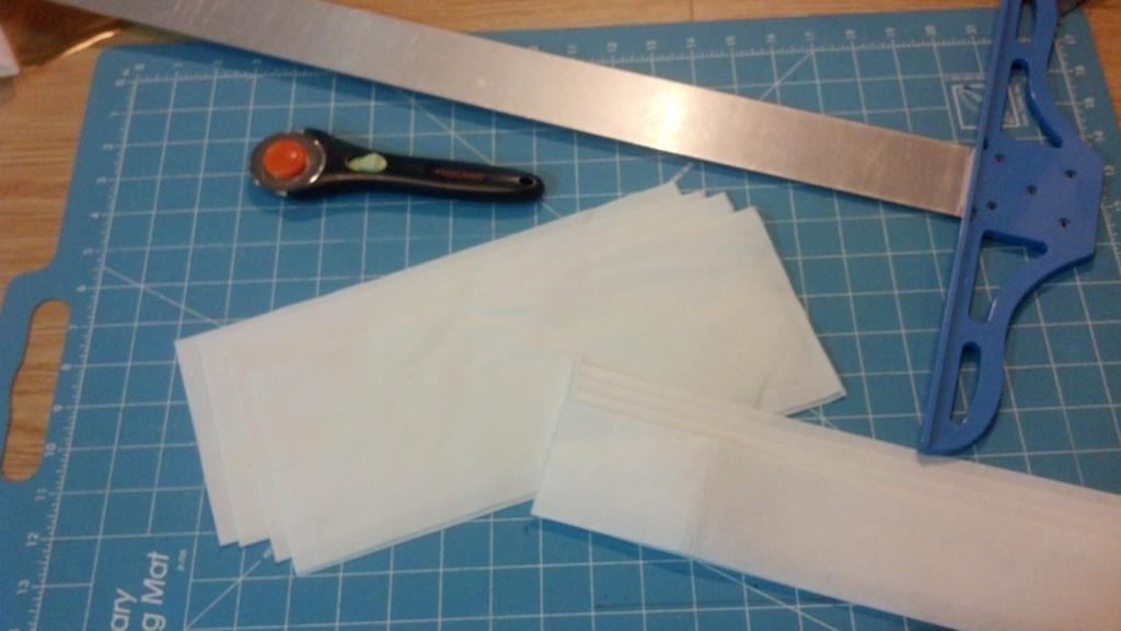

The cuffs and the interfacing cut out ready to be sewn.
Cuffs sewn and flipped, ready to be attached to the glove.

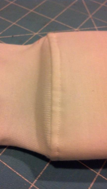

The cuff attached and the split serged.

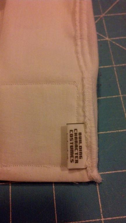

Details of the stitching and attachment of the cuff to the glove, as well as one final change to the gloves: an identification tag with care instructions printed on the other side.

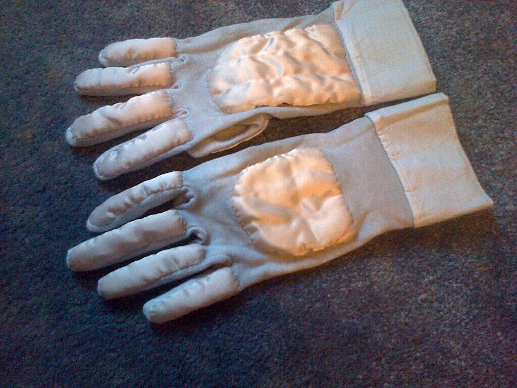

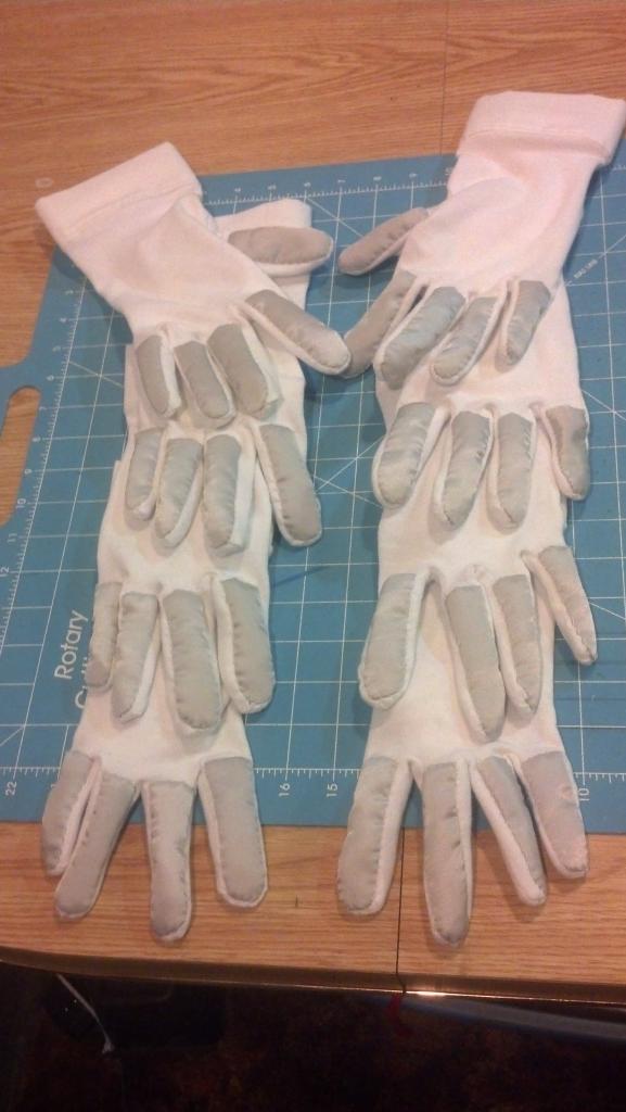

An example of the pads, hand stitched to the glove.
Examples of finished gloves in both ESB and ROTJ.
