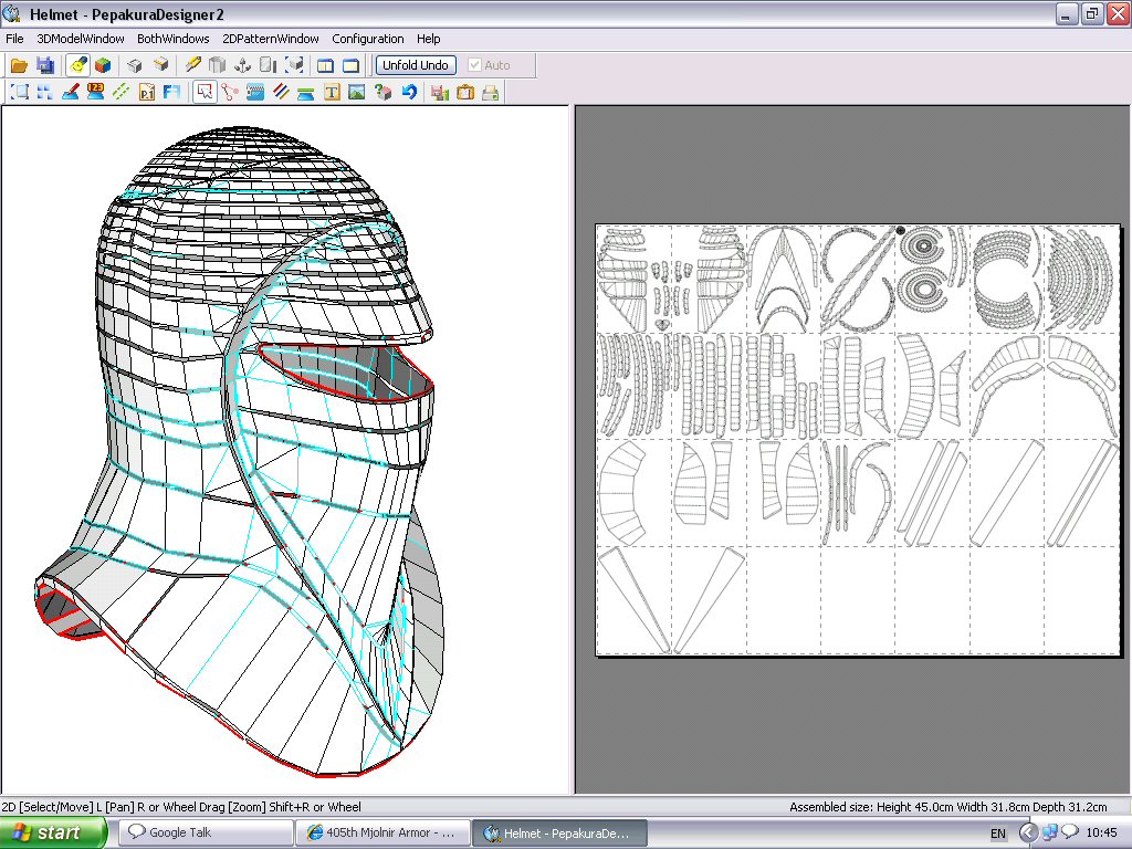

Been a while since I posted anything here. So I wanted to come back with something to show.
I've been spending quite a bit of time over at the 405th and I've been surprised at how they are using papercraft software to create some really impressive Spartan armor. I designed a chest perm for them and then I modelled up some Fett gauntlets for a friend ;). This got me thinking Star Wars again and so I chose to try the Imperial Guard helmet.
Hopefully this will build into a decent likeness of it and using the 405th techniques, bondo will smooth it all out.
I'm still unfolding the model into the 2D patterns so I have no idea yet how this will turn out but I'm postive. :)
Hopefully, if it turns out well, I'll continue on to hopefully design armor based on Kir Kanos. See how this goes first.
I wondered if anyone here can help me with something though. Roughly, how tall is the Gauds helmet in 1:1?? I've never seen let alone owned one before so I have no idea. My guess is around 40-45cm?
Any feedback or comments are welcome as always. Thanks

Unfolding all done. I hope to testbuild tonight, I just need some confirmation of the height of an actual bucket.
It'll take 23 pages of A4 to print then build.

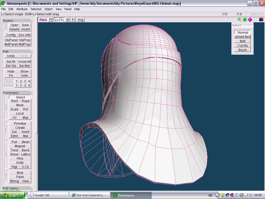

I have all the measurements I need now. Plus I'm tweaking the model after some faults were pointed out to me. It didn't look close enough to the real thing. The face was quite a way off for a start. Also there is a ridge that runs from the front/chin area up and around the back of it. So I'm afraid there are no build pics yet, but I do have a screen grab of the improved back of it.
Hopefully I'll have it ready for a testbuild in a day or two.

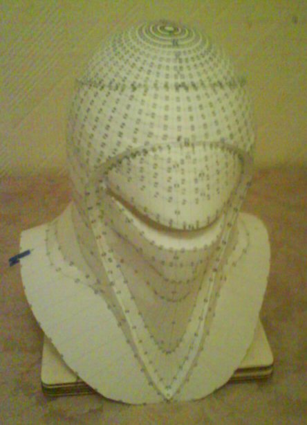

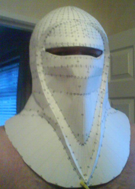

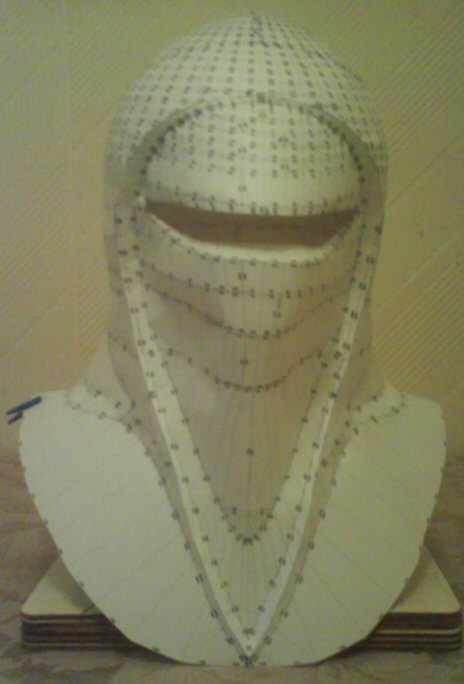

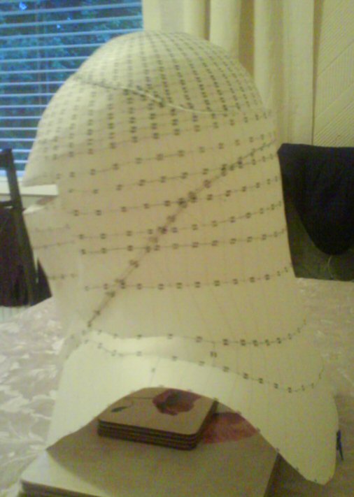

The build is finished now, it's not too bad as it goes. I'm really pleased with it. It get a little tricky in places, but taking your time will see you through.
Here are some pics:
I've fibreglassed around 65% of the inside now too, I'll go back later and finish it off to get it all solid and ready for smoothing out with bondo.
I'll post pics of that too.

A4, but cardstock. Not paper. It'll be too flimsy and won't hold it's shape well. Anything around 120 weight upwards would be fine.

@ t-bone, For glue, I always use PVA glue. I'm in the UK so I'm not sure if it has a different name over where you are? It's a general glue, used in schools for arts and craft, but is also called wood glue as it's used in woodwork too. It's white when wet, but dries clear.
