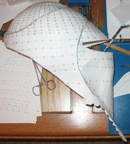

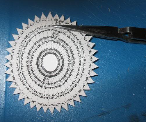

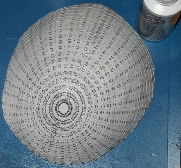

Beginning the dome
Finished dome. This was the most tedious part IMHO.

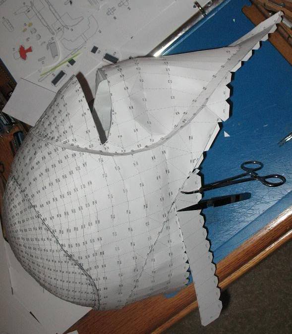

The Face
Face and dome connected

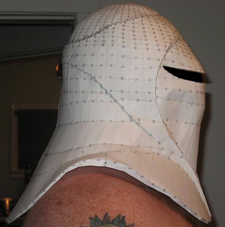

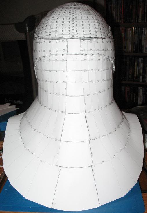

Adding the back. Ran into an issue here you'll see in a sec

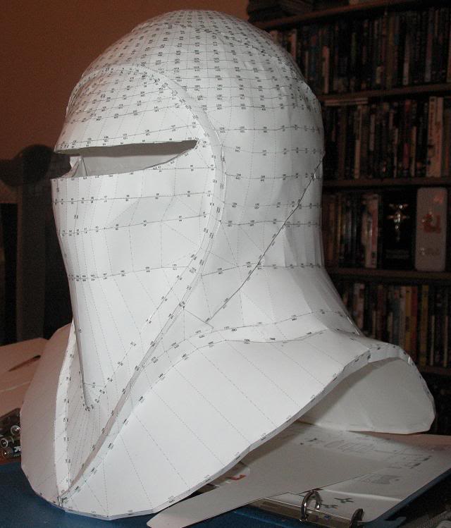

The front
The back and the issue. I ended up with a gap in the back from the raised area down. I believe the reason behind it is because I used standard letter head instead of A4. The program automaticly adjusted the aspect ratios when printing and I think it shortened these parts just enough to cause the issue. I simply measured out what pieces I needed to make, cut them out, and glued them in place. I actually think this was a "blessing in disguise" so to speak. If not for this I don't think I could have gotten it on.

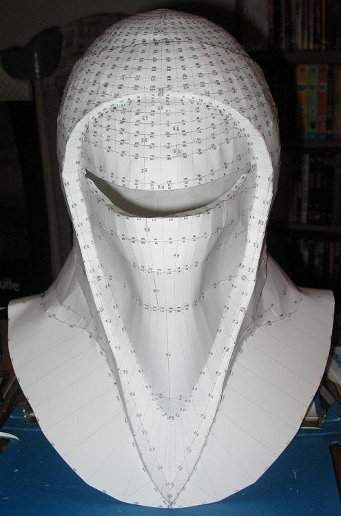

Front Right finished
Rear Left finished
Over all I think it turned out great and I have something to work with now. It was a fun build. Thanks again Skip.:cheers To get it to fit my head and shoulders a little better I am going to section it and add strips of card stock where needed. It's a little snug in the cheek area and not quite long enough to sit on my shoulders. Again I think this is due to the translation from A4 to standard size. If you want a RG Helmet and cant afford to purchase one of the ones that pop up every now and again I recommend this project. It will require patience. Especially on the dome.:lol:
Looks sweet! Well done! ;) I think you may be right about the print difference. I'm in the UK so used A4, I didn't get this problem. Sometimes it can be caused by not lining up the tabs properly but you wouldn't get a gap like that, so I think the A4-Letter problem raised its head with yours.
I'm just relieved that it worked to your benefit though and improved the fit. Can't wait to see it glassed with some filler over it! I haven't the time for mine lately but I'm eager to see how it will turn out.

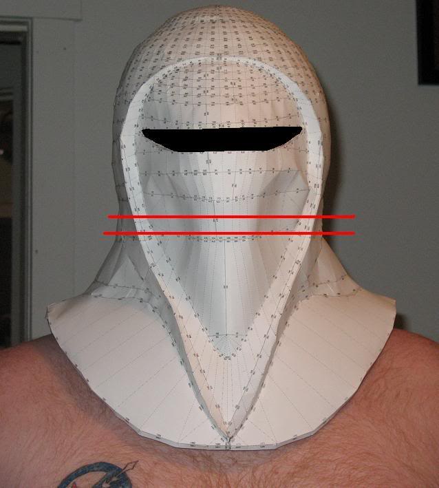

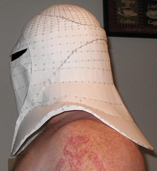

To try and show where the mods will be here are some pics of myself wearing it.
The red lines are where I think it would probably be the easiest to add to the length.
This one shows about how much length I'll need to add. (I know the skull is faded but It has been recolored three times already and every time I get a sunburn it gets a little bit lighter.)
For when I do the entire costume I think I'll try and leave the bottom of the back flared out like it is so I have room for a back plate. I plan on doing like a Crimson Empire style armor underneath the robes.
I agree, tat's probably the best place to add height to it. Nice build BTW. ;)
I do have plans to model the CE armor the same way I did the helmet. ;) Though I have no idea when it will happen.

I made the horizontal cut around the helmet but I found that I'll need the help of my lovely assis... I mean wife:lol: to get it put back together. I'll post more pics when that's done.
dont forget to add enough height to account for the thickness of the material when strengthened and or padding.

At this point I dont think I'll need to pad anything and I plan to do all strengthening from the outside.
I have started reassembling at the horizontal cut and am now trying to deal with allignment issues.:facepalm I think I have it figured out but we'll just have to wait and see. I may have to print of and rebuild some areas if my brainstorm drizzles out.
