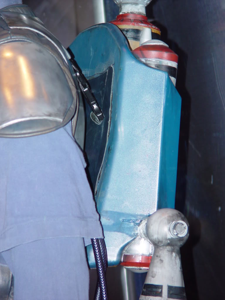

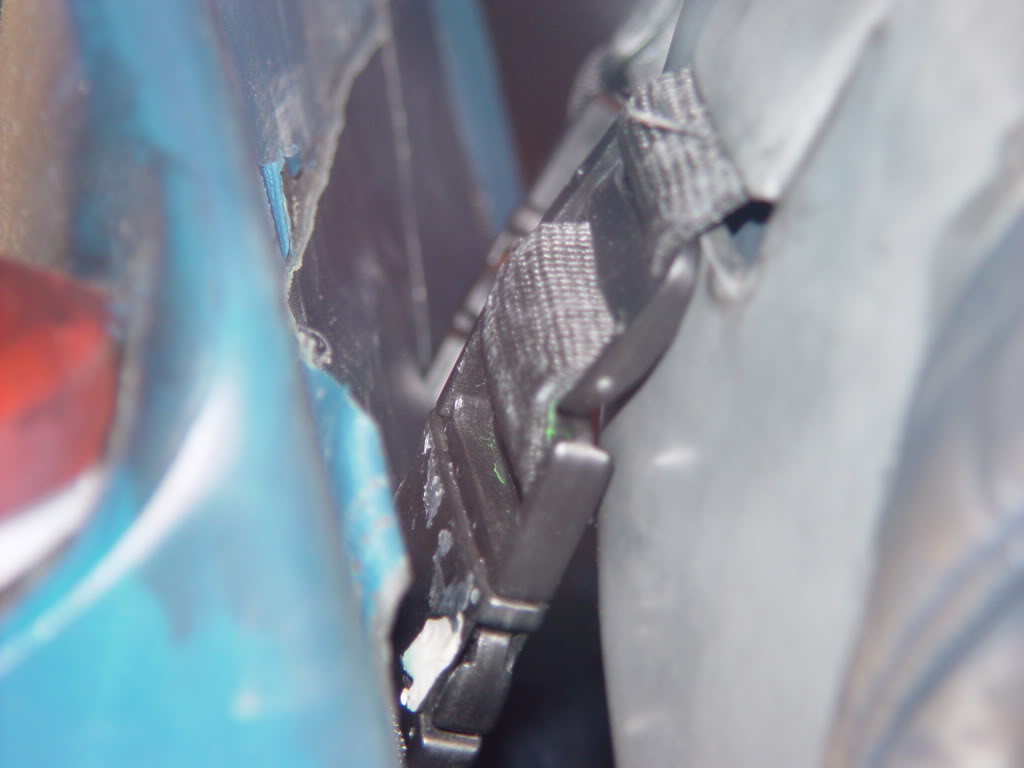

Well I will tell you how I did mine, but that doesn't mean it is the only way. I too have a MLC arena JP and a Seeker harness.
I first mounted my back armor to the vest in its final location. Then I used a sharpie to mark where the slots in the back armor landed on the vest. Using a sharp razor I cut the slots enough to allow the straps and clips to pass through them and the backplate.
For the JP I cut two slots just above the opening of the door with a dremel cutoff wheel and small files for cleanup. I would have liked to put them lower so that the JP would have riden higher on my backplate, but I was afraid to get too close to the opening of the JP and cause the fiberglass to crack. Using the other straps that came with my Seeker harness I stuck the non-clipped end down through the opening I had created and looped them around the two metal rings inside the JP. I pulled them tight on the inside so that only the clips were left outside the JP and secured the ends with chicago screws.
As far as the JP door goes I drilled a hole in each corner through the door and JP. I then glued in some nylon threaded nuts to the inside of the JP. I could then put the door on and screw a nylon screw into each corner to hold it in place. I used nylon so that it wouldn't scratch the backplate as bad as metal.

Im familiar with this set up, Im curious on the best way to attach the straps to the JP itself. what do you use to keep the rings mounted inside the jp? maybe some pics of the inside jp set up?? :confused :D
On the MLC arena that I have there are two metal brackets that are fiberglassed into the bottom of the JP. I slide the straps throught the slots that I have cut in the JP and loop them around the brackets. I hope that answers the question. I would snap a pic, but I don't have a camera with me right now.

Grinch as I said earlier I cut my slots just above where the door sits in the JP. I have heard of people cutting the slots in the door itself, but I was just not comfortable since it is thinner fiberglass. The lower you get the slots the higher up on the backplate the JP will sit which is why some have gone that route plus it is accurate to what is on the movie. As far as the slack on the straps goes you will have some. They are designed to fit multiple packs and setups. You will have to secure the ends once you loop them through the brackets inside the JP. Like I said I used chicago screws, but you could do it different like gluing or riveting it for example.
