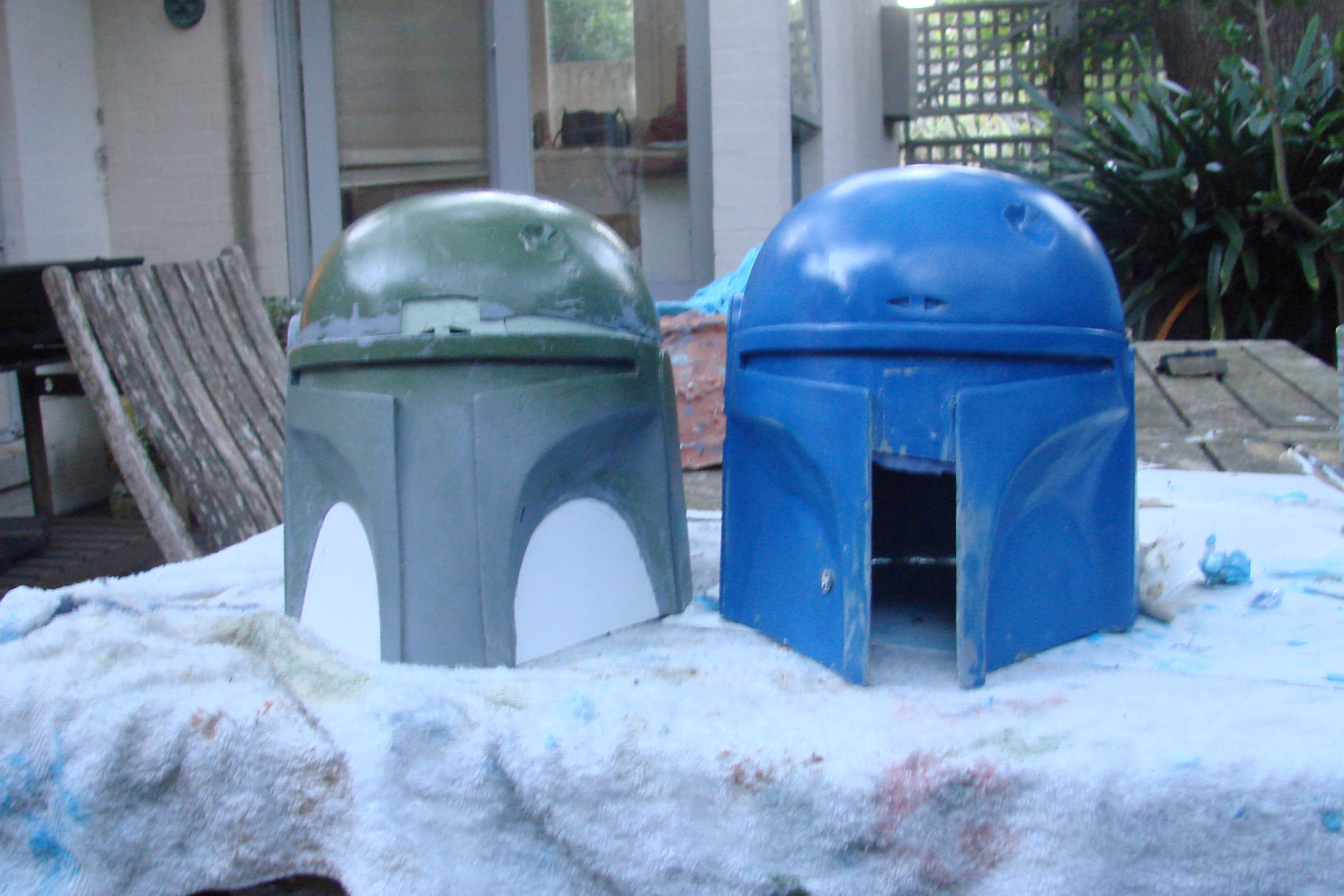

No the helmet i used to make the molds was made using 10 and 4 litter paint pots plus i used the dome and the back section not the key wholes from a hasbro voice changer helmet with magor moificatins to the dent and filled the join and changed the shape a bit see my thred,titled Hasbro BF mod (UPDATES) ididnt take photos of the build but this shows how i joind it upDSC03675.JPGi hope that makes sense
I read the thread here. Holy sith. What work. You scrapped about 1/2 of that helmet, and not only rebuilt the majority of it, but detailed it to exacting specifications. And paid way more than it was worth. $95 AUD is about $93 USD. Ouch.
The detail on it looks great.
So what's a "plastic paint bucket," and what parts of the helmet are made from them?

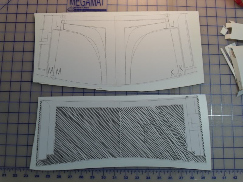

In the meantime, here're a couple pics of my first field test of the templates, prior to further revisions I'm making:
My reduced and modified templates (photocopies, not originals). The lower one is just for the back half of the brow band. I have the join between the front half and back half hidden under the earcaps.

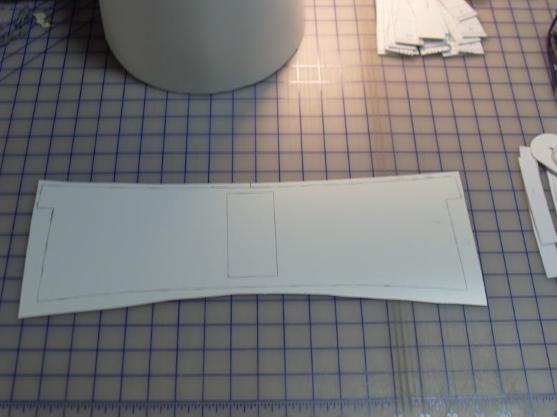

The back skirt, already marked on the 1mm sintra. You can see how much I raised the bottom edge at the sides and back (the original bottom edge is the edge of the sintra).

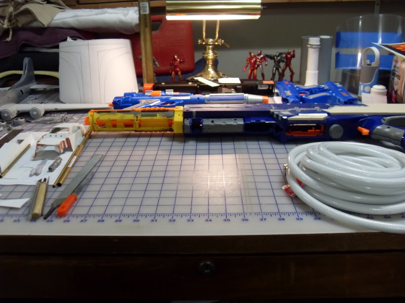

In the back, there, on the left.
First attempt, since revised (but, as with all my more recent pics, the images were on the hard drive that died and haven't been recovered yet).
These might even work for the metal pieces, too, as I will use rollers to get the sheet metal to curve, get it fitted to the shape as closely as possible, then cut and weld/braze. But I'll most likely use these to make moulds from and make shaping forms out of hydrostone or some such. A forge would be nice to put the finished piece in for annealing once everything was joined, to relieve stress/fatigue, and having a heat-resistant shaper to stick it on as it gets more malleable would probably be a good thing...
