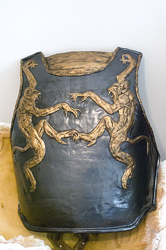

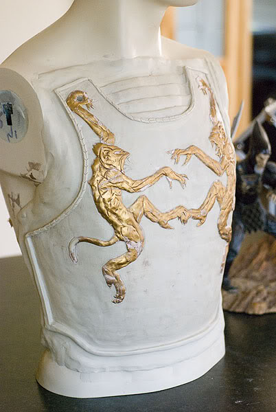

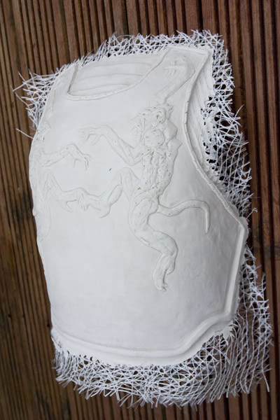

Have you considered building a clay model of the armour on a mannequin and then moulding it from latex/silicone. This is the method that I'm using for Thades armour, I used a fibreglass subsitute to make the casting (jesmonite).

This is a fantastic piece of art man!

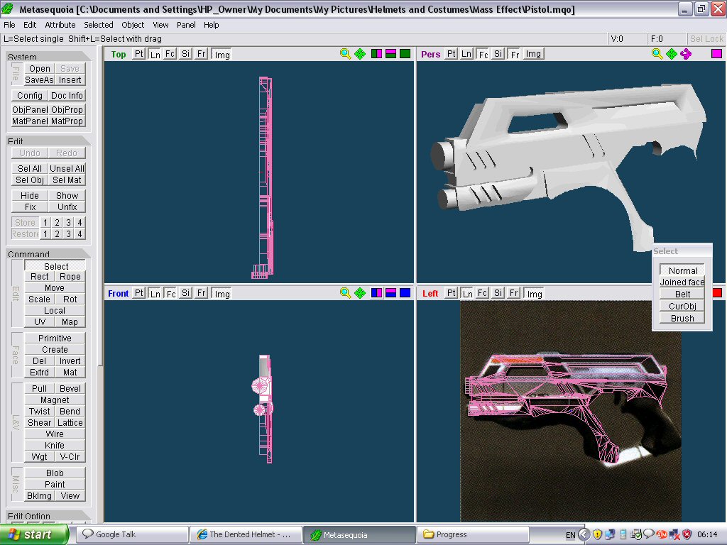

I have a 1 car garage and a rather large room that il be doing alot of the work in, and alot of tools lol, I have been doing some research and i have decided to construct a "mook up." i found a 3D modeling programe called "Metasequoia" that im going to be using. I'm most likely going to be using some sort of craft foam or cardboard and resin. I now need to know how
a. how to use it (tough one.)
b. i've seen people use like images to form the 3D model on the computer [http://www.thedentedhelmet.com/attachment.php?attachmentid=26853&d=1219295864]

You won't need a huge amount of workspace or clay, I'm using klean klay that can be reused over and over again. My workspace is a small office in my house.

The program that's almost always used for paper/cardstock building is Pepakura Designer/Pepakura Viewer. The designer is used to "unfold" 3D models, which can then be printed onto heavyweight paper, cut out, and glued together. then comes a long process of resin, fiberglass, sanding, and repeating, usually with some Bondo thrown in for good measure (obviously nasty stuff for your lungs unless you use the right safety equipment... you don't want your actual voice to sound just like Grievous)
