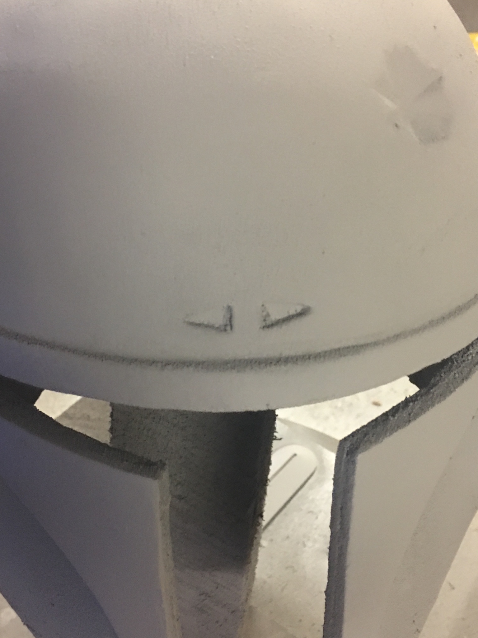

Hey all, I was wondering if anyone has any advice on etching the triangles into a scratch build helmet. As you can see from the pic I attempted to use a dremmel and the end result was something unspeakable.
Any advice on how to etch into bondo with a little more control?

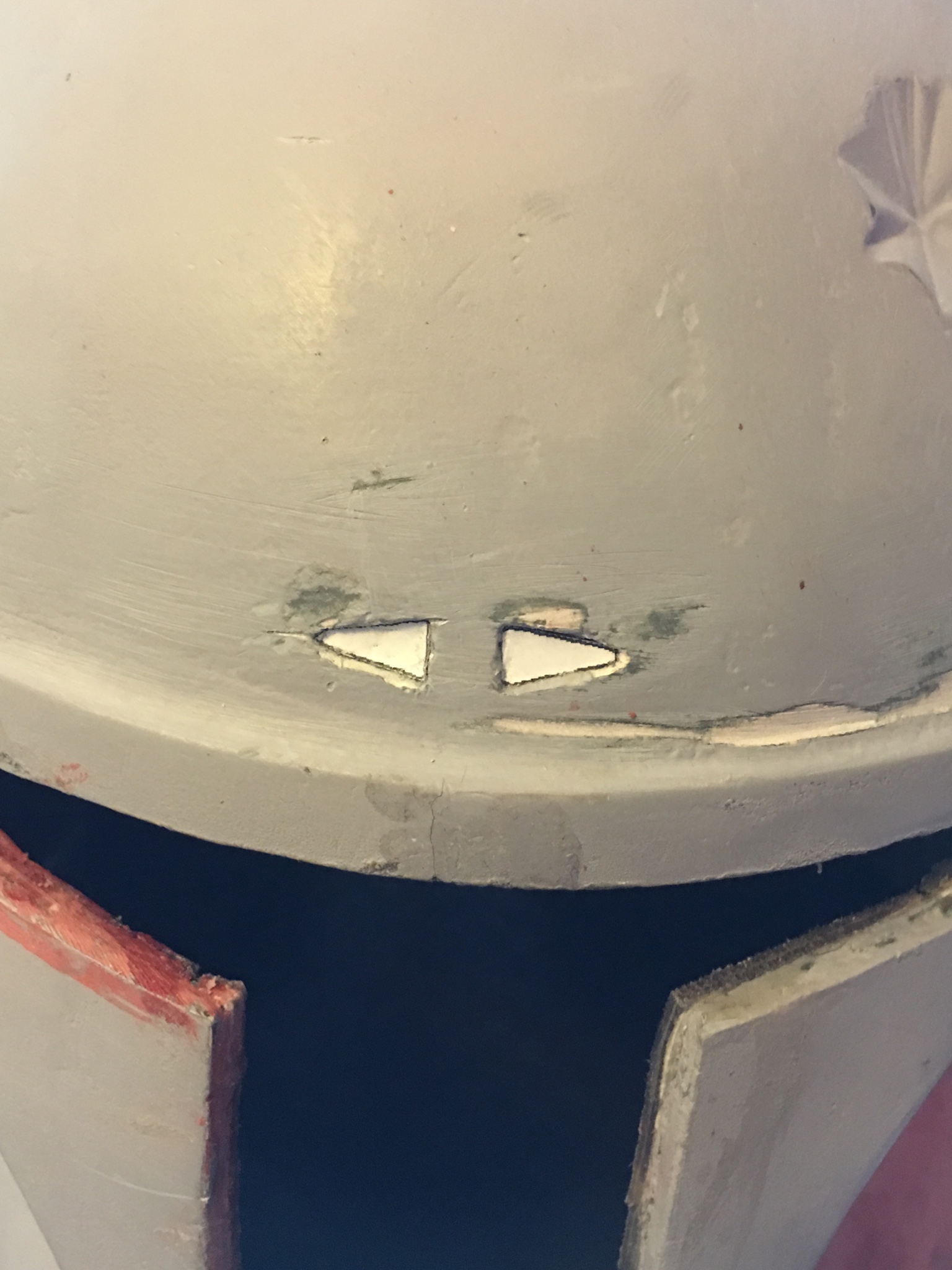

I took a bit of everyone's advice. First I fiber glasses the back end of the cut outs. The I filled in the triangles with two 1mm thick cardboard cut outs each.

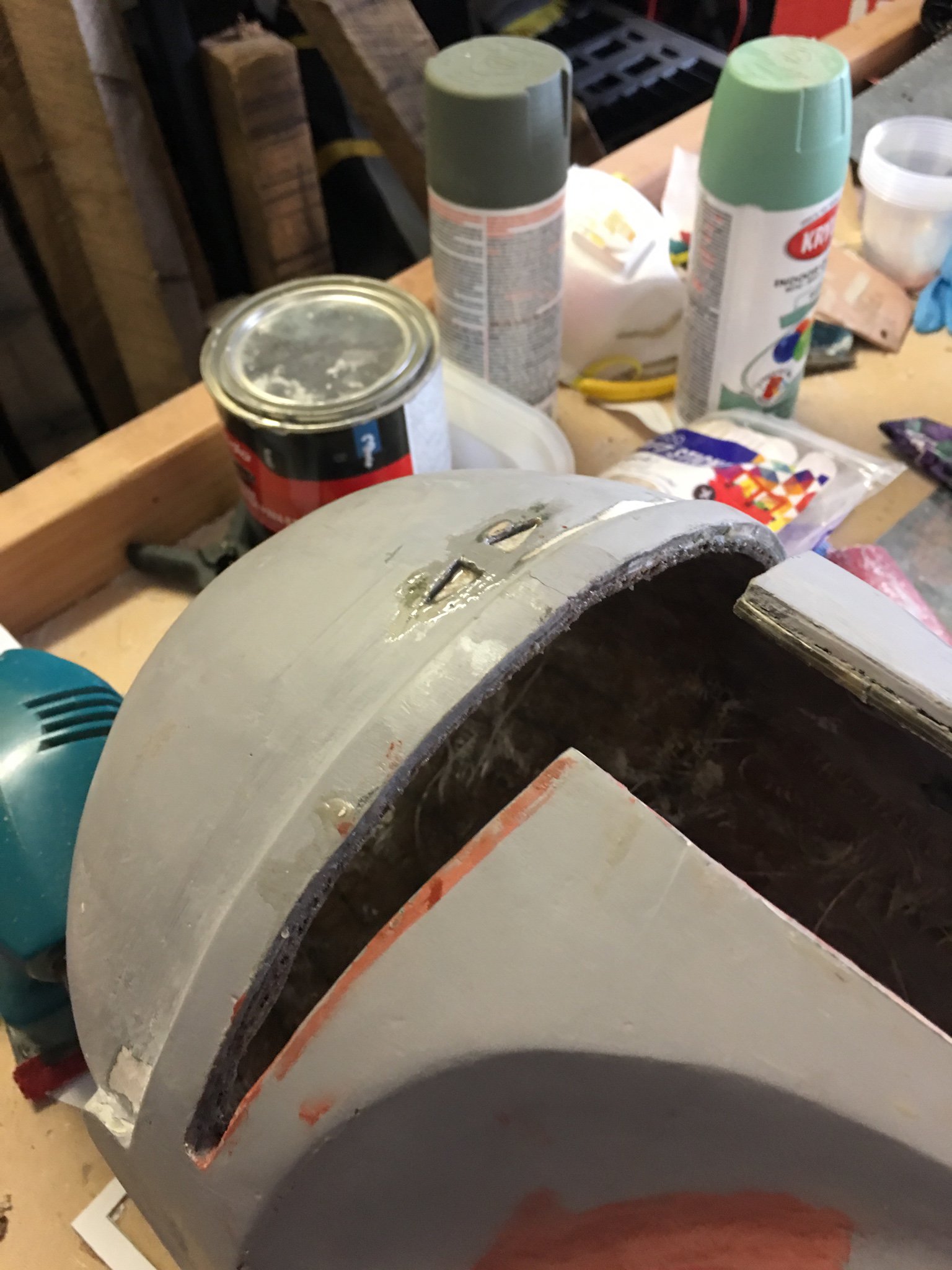

Next I coated the top layer cardboard with fiber glass resin cleaning up the edges with a clean plastic brush to avoid that nasty capillary effect.

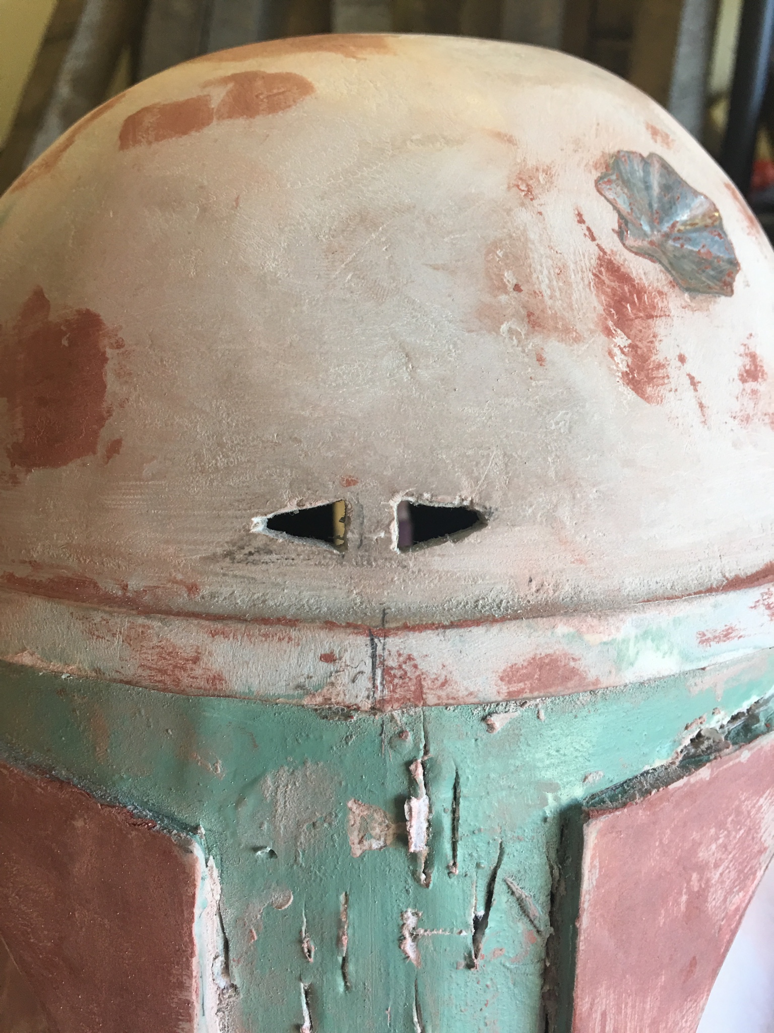

And this is the end result. The particles on the recesses are from the primer filler I just used on the entire dome. Once it's dry I'll clean those up.
Thanks again for the help everyone you saved me from a lot of trial and error.
