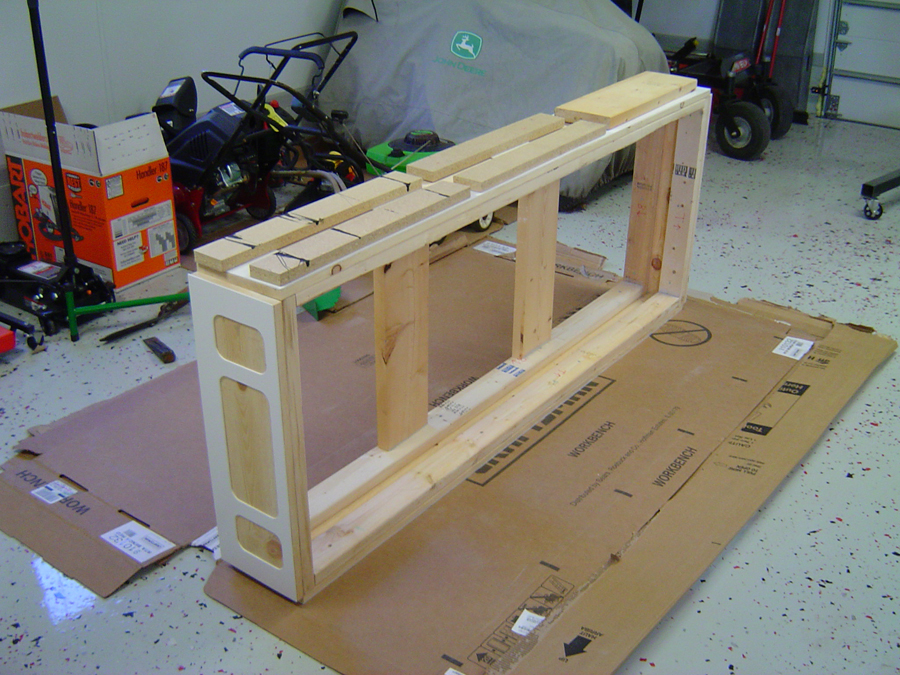

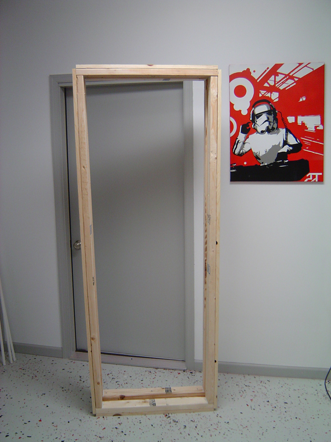

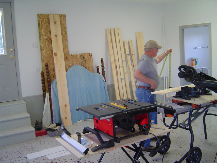

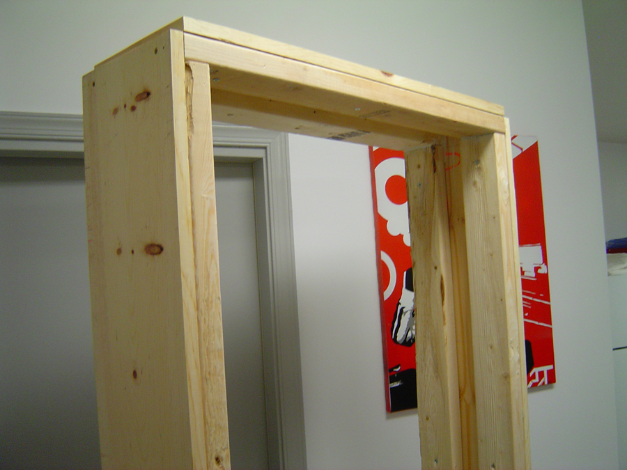

Got some work done on this over the weekend at my Dad's new garage he built, he just retired and I'm envious :lol:. It was cool for me to work on a father & son SW project, and I could tell he was excited about helping out with it. Surprisingly all the supplies only cost me about $65. Started off with 3 1x10 8', 4 2x4 7', 2 2x4 6', 4x8 sheet of masonite, some 2x8 flat wood screws and #10 3.5" flat wood screws, Great Stuff expandable foam-yellow lid not the red, 3 8' pieces of 1/2" quarter round, a bucket of Natural colored wood filler, and some Liquid Nails.

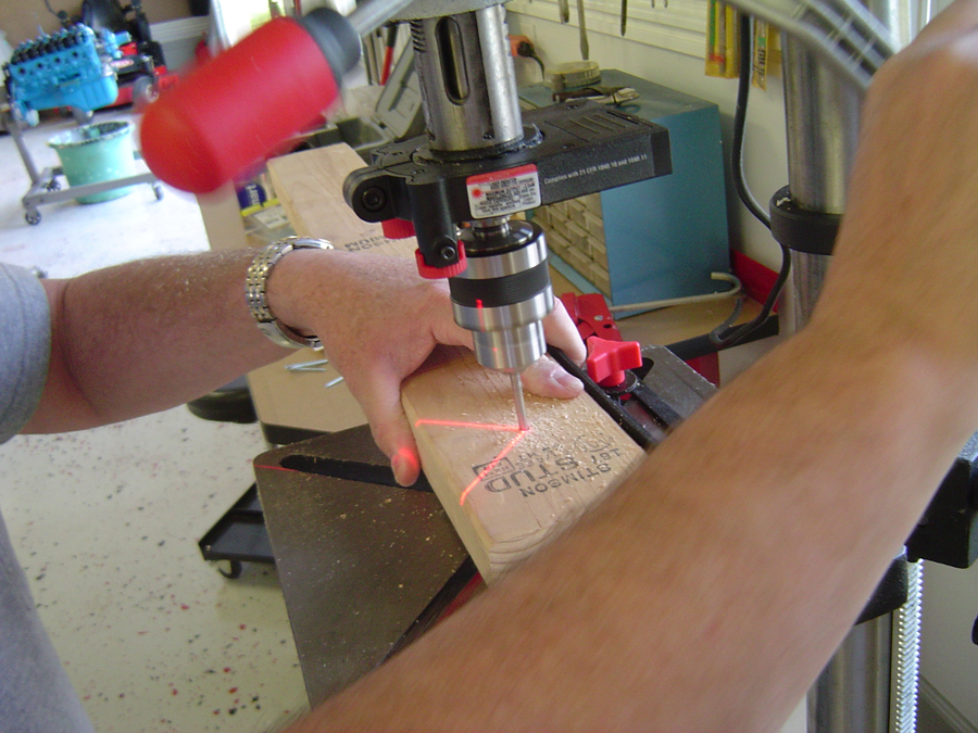

We pre-drilled some holes in the 2x4s that we cut to line the tops and bottoms of the 1x10 frame so that they could be set up to add the quarter round. The frame has a weird shape since it's shorter on the top than on the bottom, but it will be nice and sturdy...and heavy too haha.

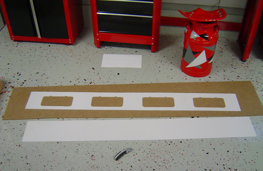

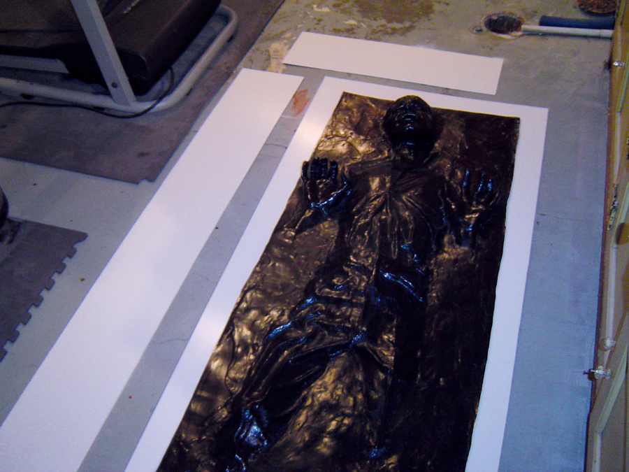

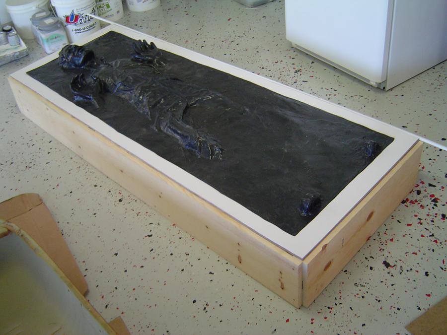

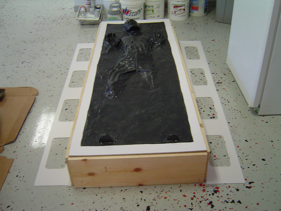

Then I measured the spacing for Han to lay on the sintra sheet I had cut before. Surprisingly when I cut the excess rubber off I followed the outside line or frame edge that was semi-visible and it was almost right exactly on size with the blueprint. I centered Han on the sintra and then traced a line around him so he would lay perfectly inside it. Then cut that out to make a frame for him. I also cut the sheet of masonite to size too. Here is a pic of the sintra frame, Han, and the masonite setting unmounted on top of the box. Making sure everything lined up good, I don't even think I'll need that much filler since he fits so perfectly in the frame. The 1/4" sintra is almost the same height as the rubber mold too.

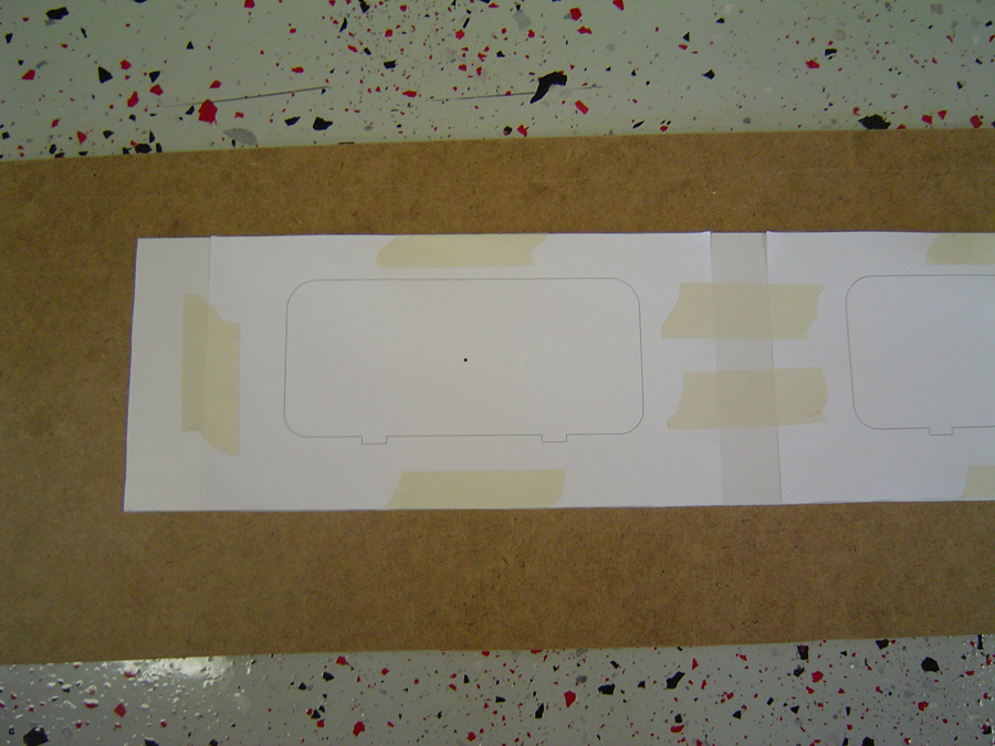

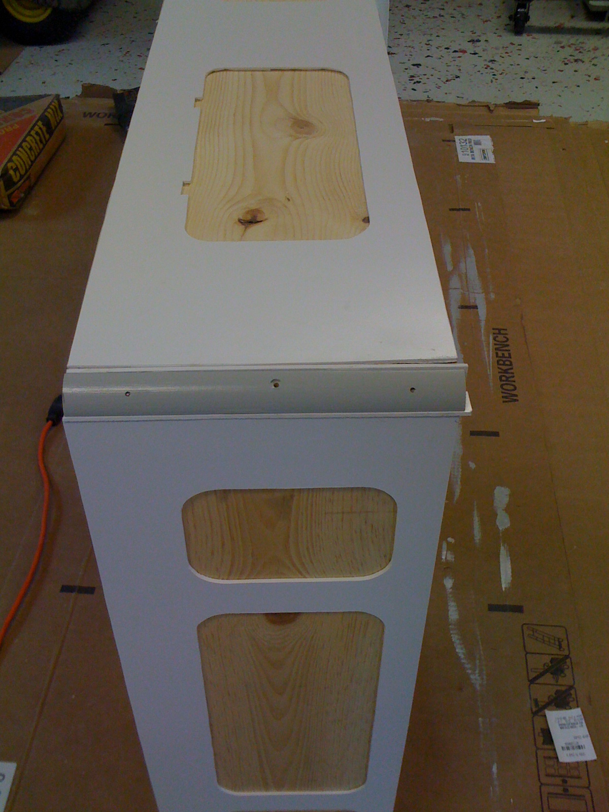

Next I taped the templates I posted in the Building an HIC thread to the sintra side pieces. I cut them out along the top and bottom edges that are included on the templates and just aligned them across the top. This way they'll all be along the same line since the bottoms of the pieces may have to be trimmed or sanded a bit. Just a note too on the panel sides if you are building a rectangular HIC instead of the ESB trapezoid remember to come in 5.25" from the side to start the first panel shape, then go 1' 7" from center to center. This compensates for the extra inches for the trapezoid angle shape.
Then I cut the shapes out with my Stanley craft knife and used some medium grit sandpaper to smooth all the inner edges.
And last we used Liquid Nails to glue the sintra pieces to the frame. I am getting some panels to put on this thing too but didn't want to bore out the shapes on the top and bottom. I thought it would look cool to at least have the shapes cut out where they would be and then paint over it. Here it is drying with some 2x4 scraps weighing it down.

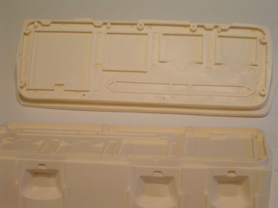

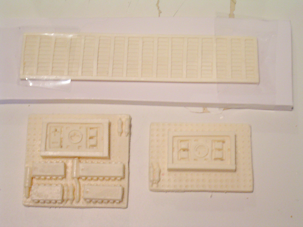

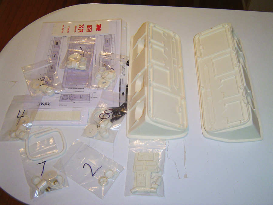

Got my panels and greeblies from Angela and Dung today, and all I can say is
WOW :thumbsup:. These are absolutely amazing, the details are awesome and it came with a perfect side by side comparison of the panels and individual envelopes that hold each panels set of greeblies. It even came with the decals too!! Now it's time to get started on painting these guys and maybe a trip to RadioShack to fit and research my electronics. I'm wondering if I'll need to bore out an angle inside the wood where the panels will be mounted. I couldn't tell if specs were mapped out on the blueprint or not. I know I'll be using an old light table's opaque white plastic top for the underside of the hero panel. Then I'll probably buy some sheets of reflective, mirror-styled material to line the insides of the other panels.

Wow, Im impressed. They're even prioviding a set of Glen's excellent
alien script decals! I have those panels too and I love them....of course
mine didnt come with decals :-)
Really looking forward to your progress Jacob!
Mike
You beat me to it PFB, I haven't logged in for a bit. The panels were made by Angela and Dung Nguyen and you can inquire about a set from them, they are very reasonably priced for all the stuff you get. Here is their email dnanguyen@yahoo.com again. Hope to have some more progress done after this weekend!

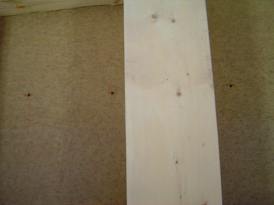

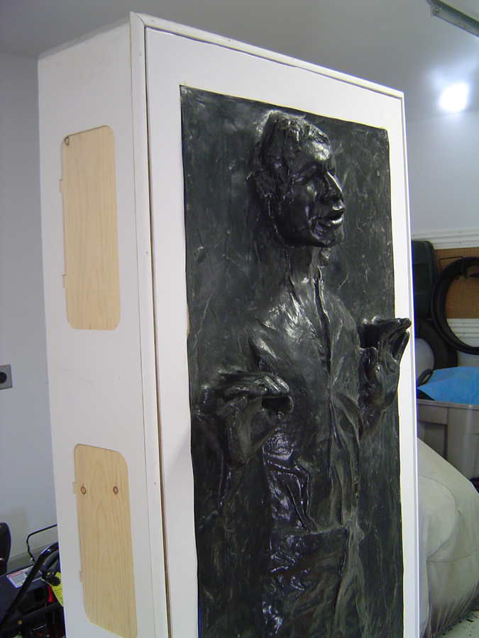

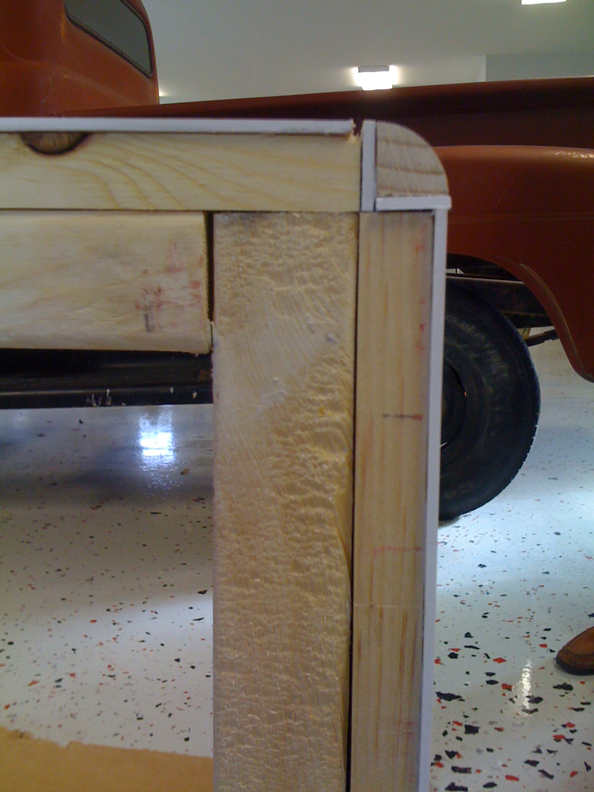

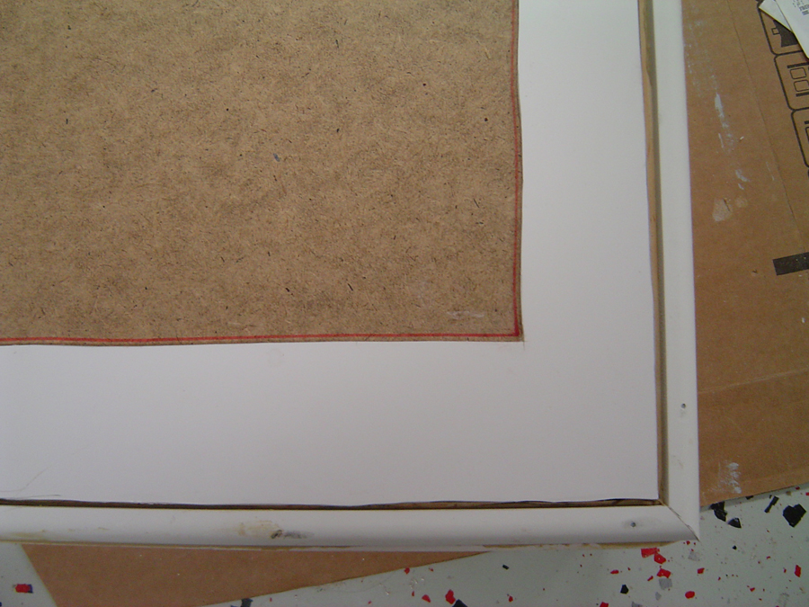

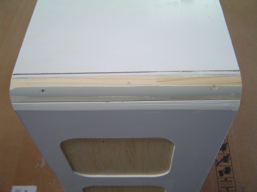

Got a little bit of work done on the rounded corners this weekend. We did the short corner pieces that will meet the face of the block with Han on it. They didn't meet up exactly, but really close, so we used some sintra scraps to fill the extra space so the corners are as smooth as possible. We used liquid nails to glue the sintra pieces and the .75" corner wood pieces to the frame. Then we pre-drilled 3 holes in each piece of corner wood and nailed them down with finish nails that were countersunk slightly. Once everything is roughed on there and glued and attached I'll go back and use filler, sand, trim, and probably use a black primer on all the sintra sides and the frame around Han before I paint it all silver.

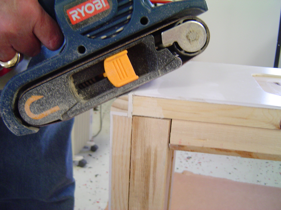

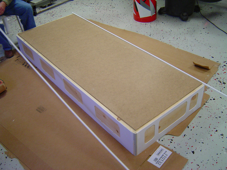

Over Thanksgiving we got some more done on the HIC. We started by using a belt sander to round off the edges of the quarter round and the sintra pieces.

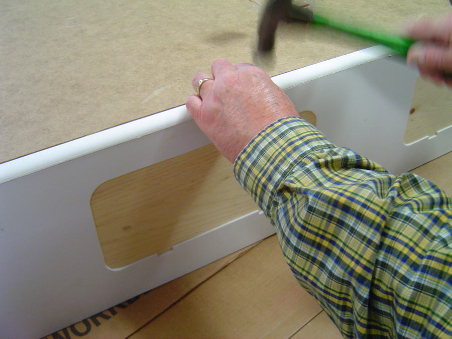

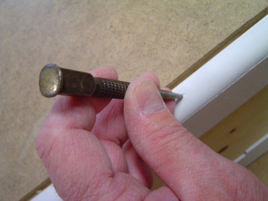

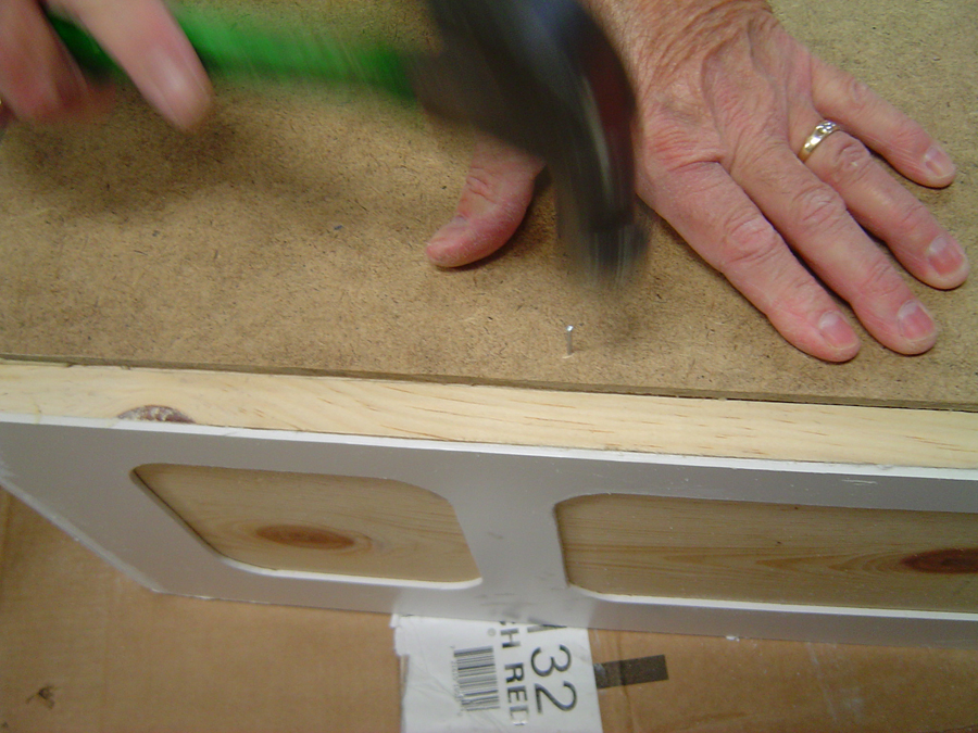

Then we used finish nails to nail down the masonite base and the quarter round on the front on the box. We countersunk the nails again so we can use filler and paint over it to ensure that it's smooth.

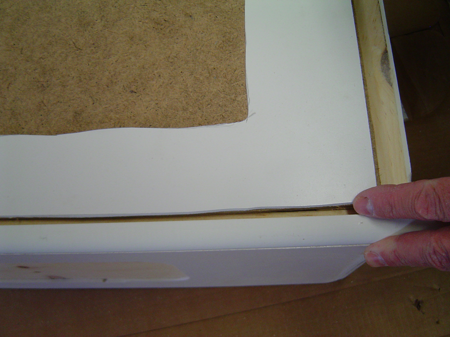

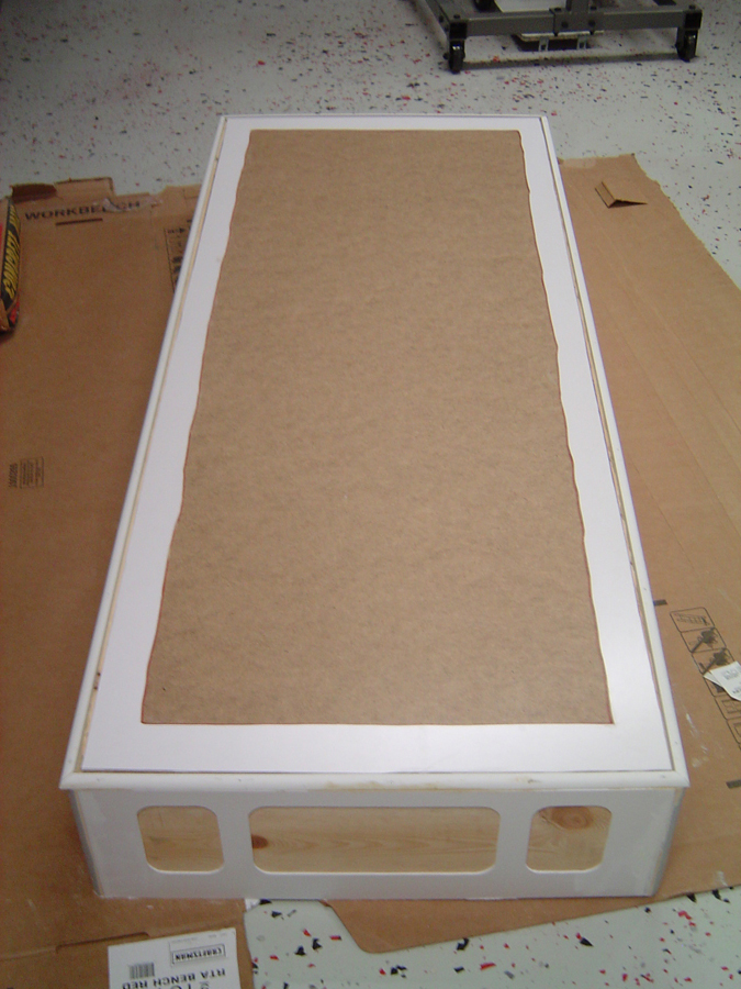

Next we mounted the sintra frame for the rubber Han with Liquid Nails. I traced the inside of the frame with a red sharpie so I knew where to glue, rather than glueing on the floppy sintra frame itself.

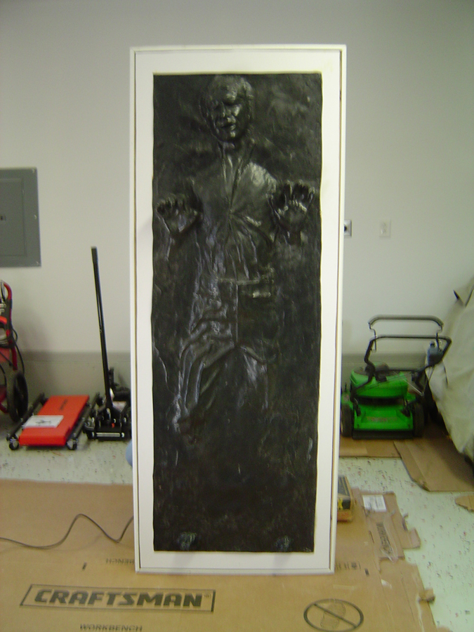

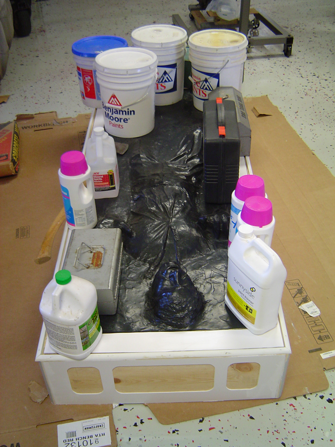

Finally we mounted Han on the masonite inside the sintra frame with Liquid Nails that we applied a ton of directly onto the rubber. He was a pain to get to stick on there perfect so we put a lot of weight on him to help him out haha. There were a few areas on the edges mainly that we had to periodically go check and re-glue that were coming up a little bit. All in all he stuck on there pretty good though. Almost perfectly even with the sintra frame height in most areas.

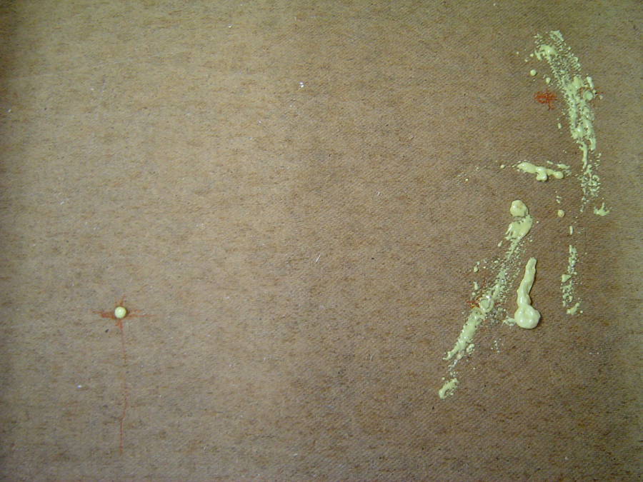

Last we measured the length to the head, hands and arms, chest and knee that needed to be filled with expandable foam. We marked the spots and drilled holes, then filled the holes with foam. It will probably take you a few times with the foam to get it completely filled and solid. I will probably get some more done in the next month. Don't want to rush things though. Final steps will be the bondo in the gap areas and sanding and painting.
