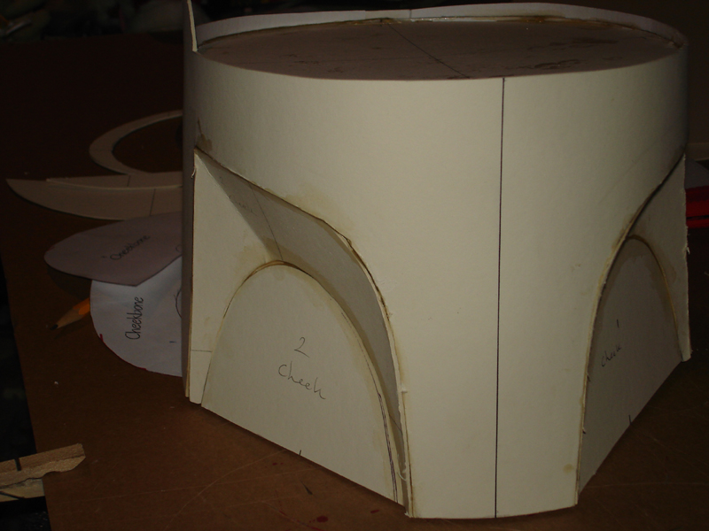

Well here goes the beginnings of my first build. I am starting with 2mm matte board and overlaying it with fiberglass. This is also the first time I've worked with fiberglass so this might turn out nasty....
This first pic is the sub-helmet with the first application of resin. Only the front half has the fiber and resin applied.

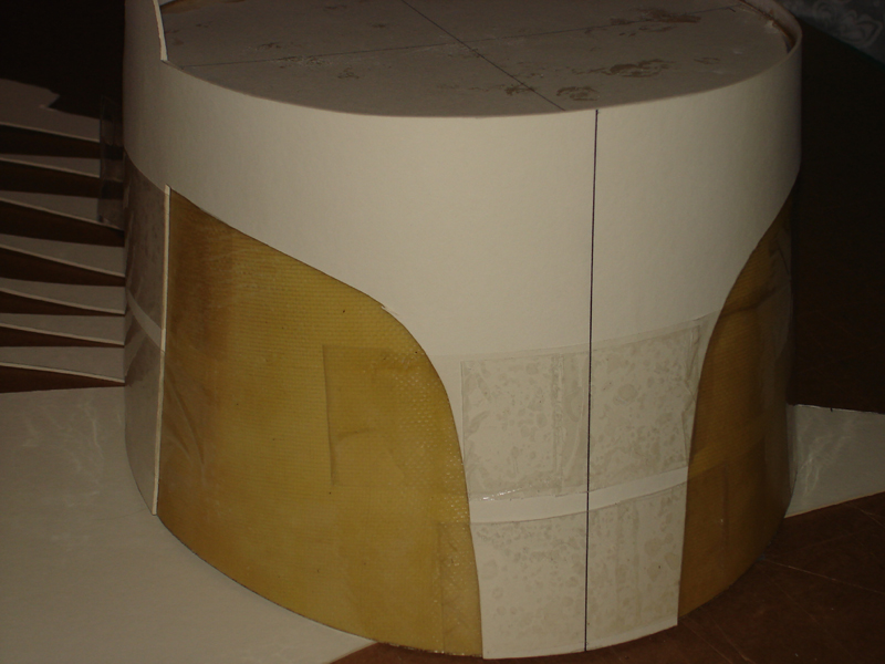

Visor is now over-layed, glued and drying in preparation for glassing tomorrow. Once the visor band is glassed in, I'll start working in the dome and correcting some of the trouble area along the brow band.

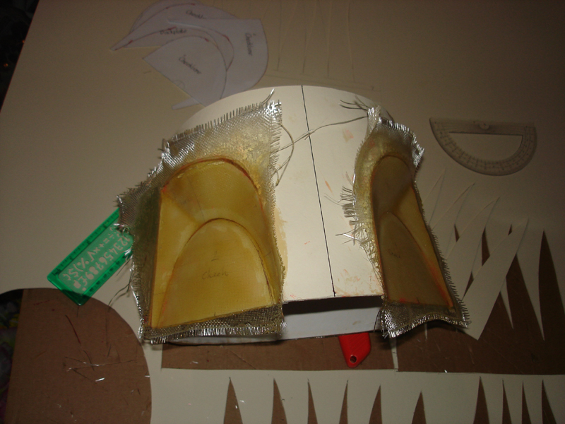

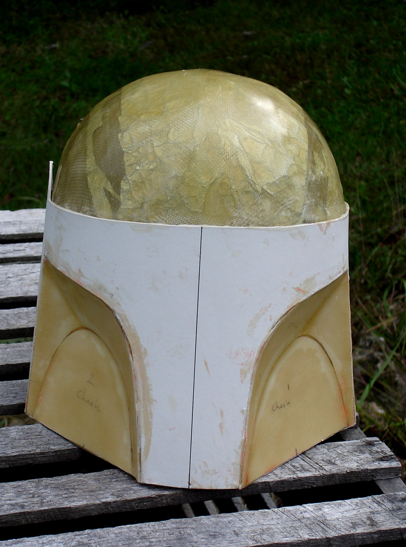

Got the cheek plates in place and glassed over. Not the cleanest of jobs but this is the leaning curve helmet and it will look better once the bondo and paint has been applied.

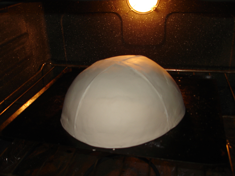

After several frustrating attempts with the cardboard cutouts, I have made a dome form that I will fab the fiberglass directly on. The added benefit is that if it works, I'll have a ready made form to make future helmets with. If it works...

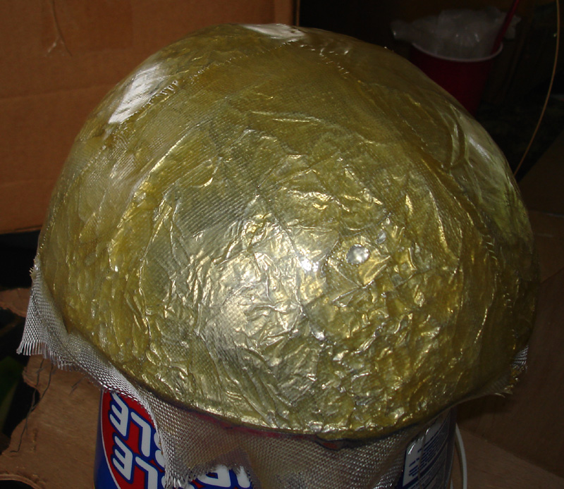

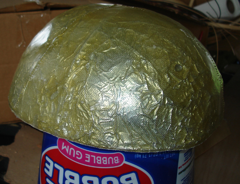

Here are two shots of the 1st layer of glass. The shiny undercoating is the foil I covered the form with. I suppose it is part of the helmet now.... the upside being that the tin foil will help to repel alien mind-rays, always an important part of one's defensive array.;)

I couldn't get the dome to shape up like I wanted so I set up the dome base with the two cross pieced and glued in styrofoam as filler. I then filled in the remaining shape with Crayola brand air-drying clay. After the clay was dry I just fiberglassed over the form.
If you go this route, make sure you undersize the form by the thickness of the fiberglass, otherwise you'll have an ill fit to deal with. And I would suggest covering the form with something other than aluminum foil as a resist. Perhaps plastic wrap and then dry fiberglass cloth.
