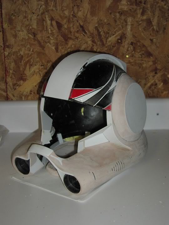

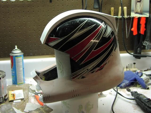

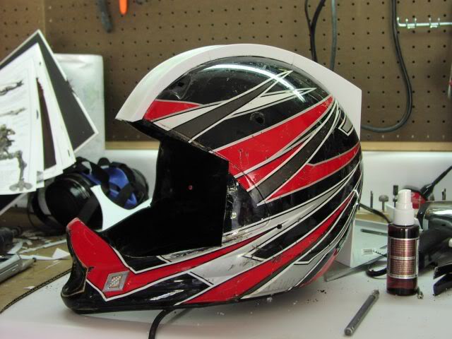

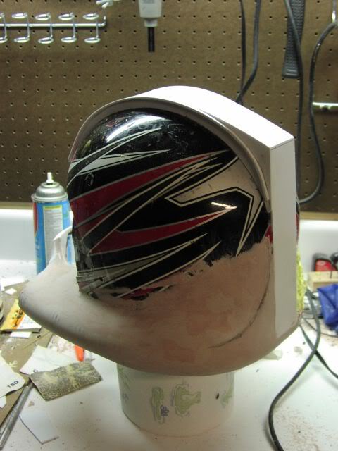

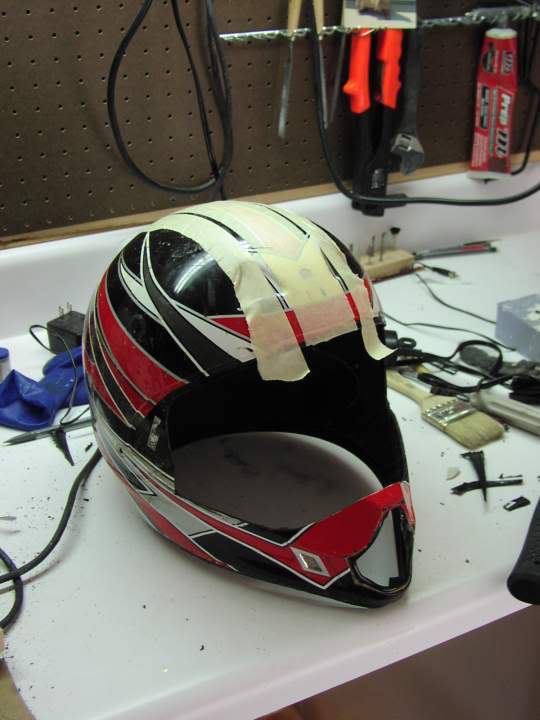

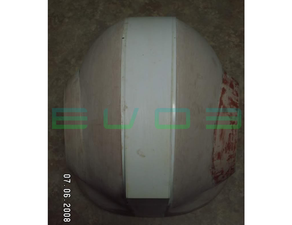

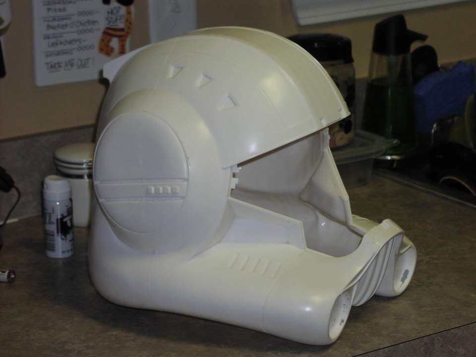

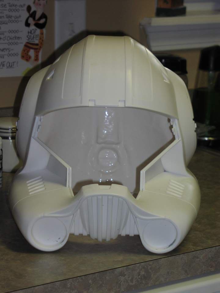

This is a project that i started about 3 years ago. There were a few other projects that kept putting this helmet on the back burner and although i finished the helmet quite a few months ago, i just got around to molding it. This forum seems pretty hands on when it comes to builds so i thought id post it here from beginning to end. Just pics though.......

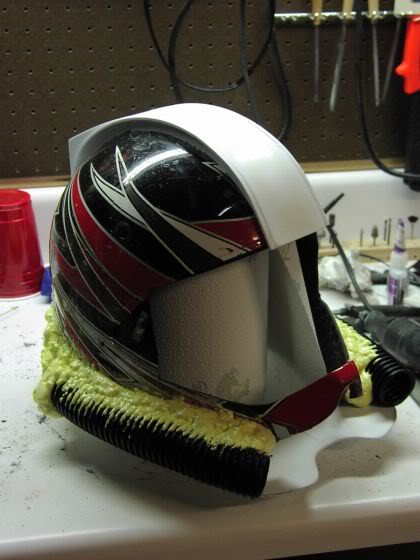

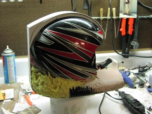

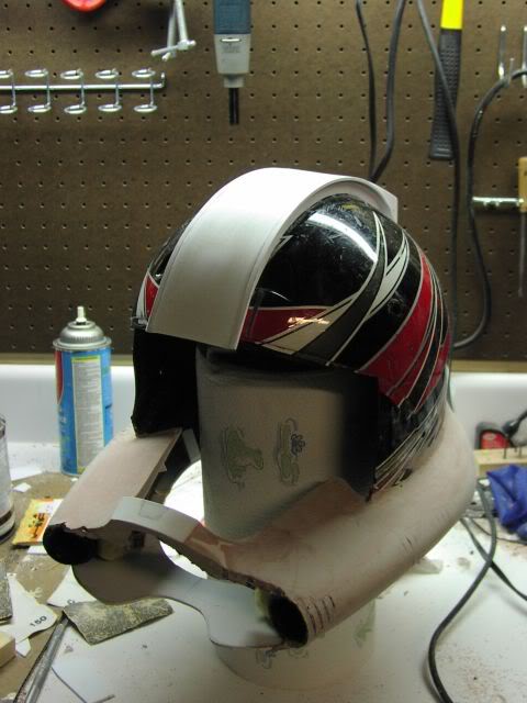

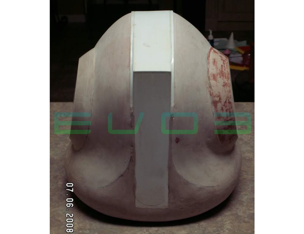

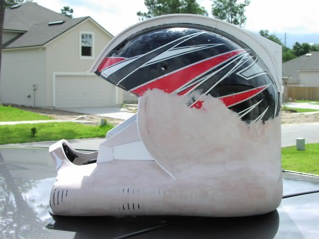

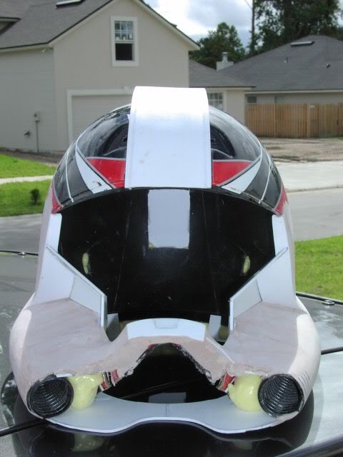

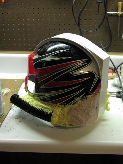

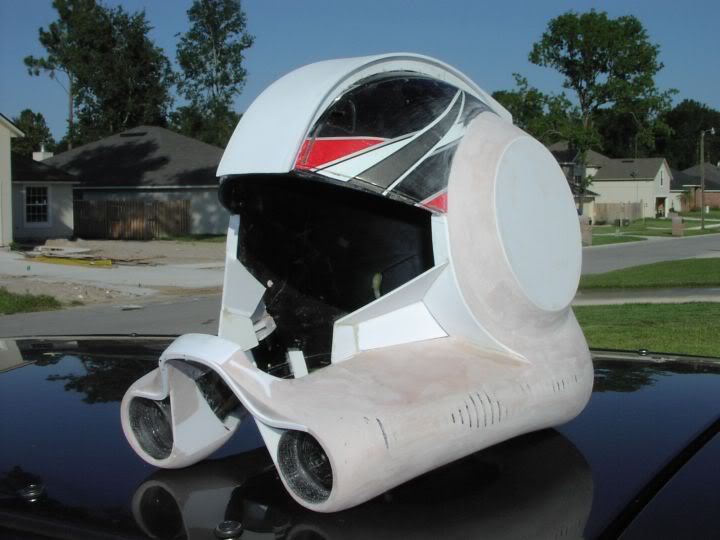

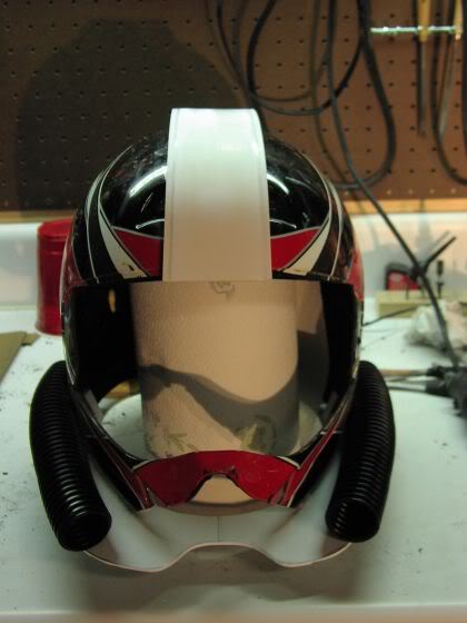

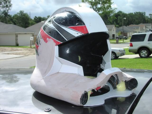

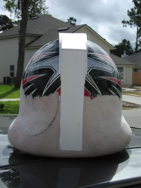

This is where it restarted.....

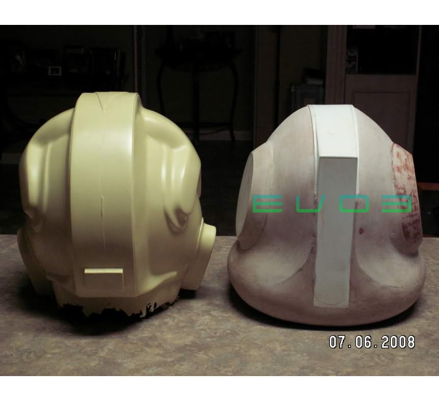

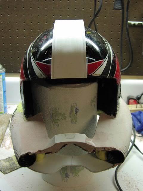

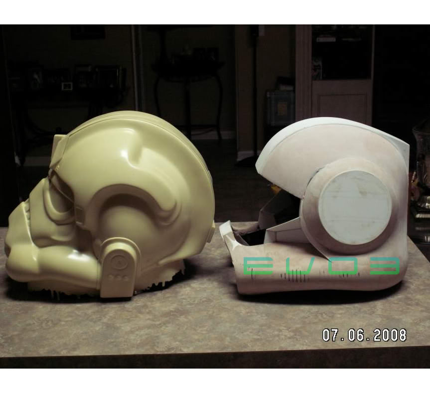

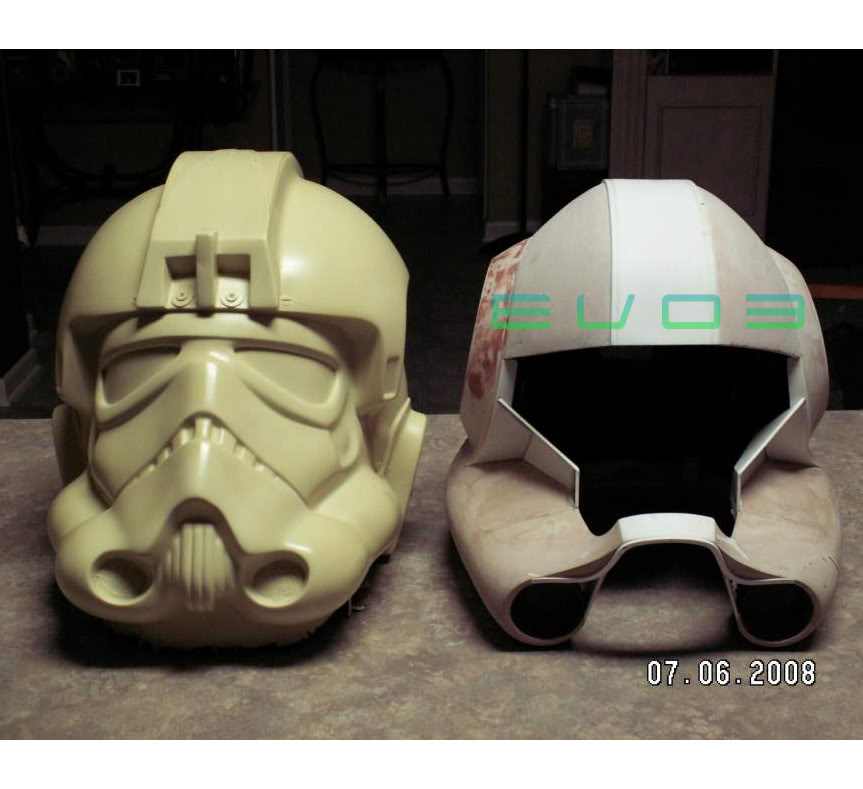

Now some side by side pics with a TIE helmet for size comparison.........
And here we have the clones!

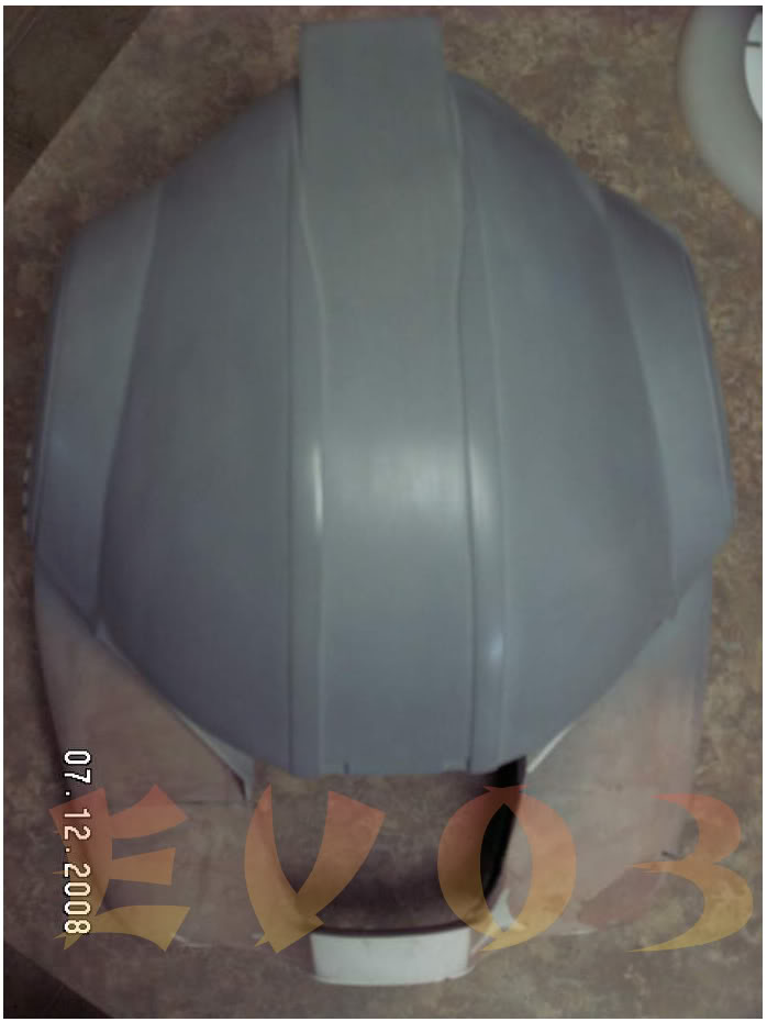

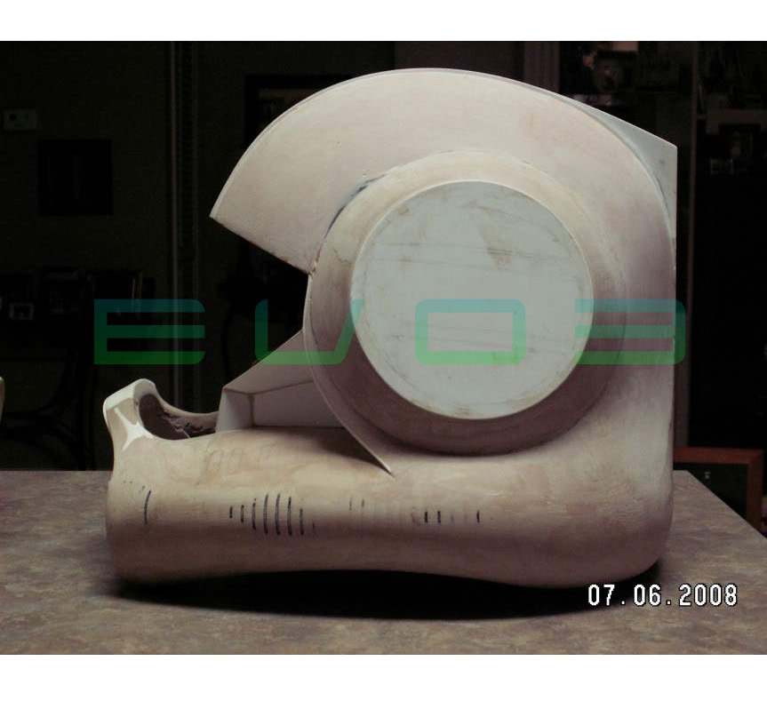

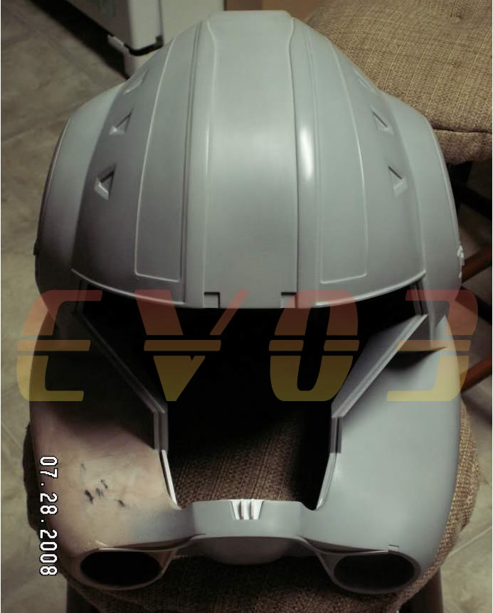

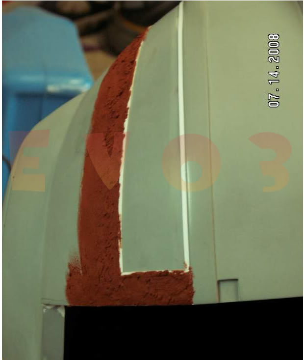

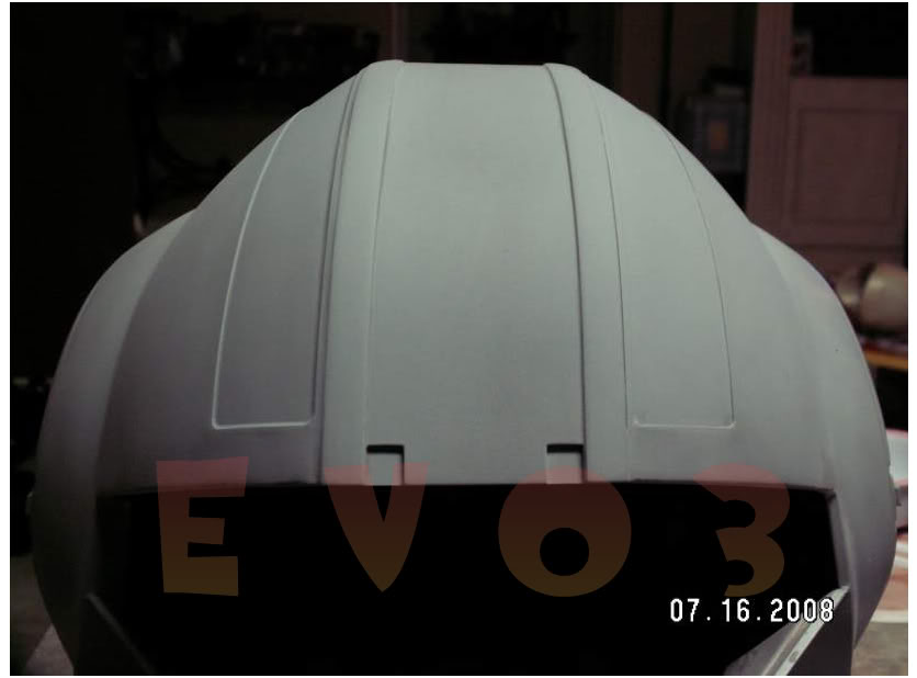

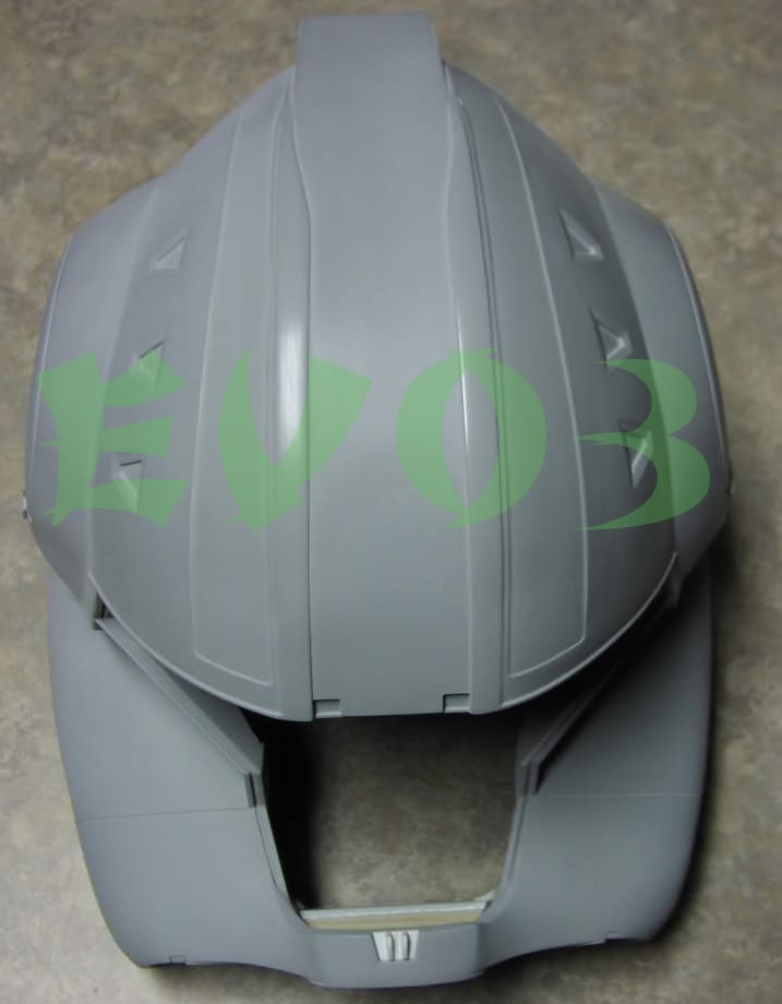

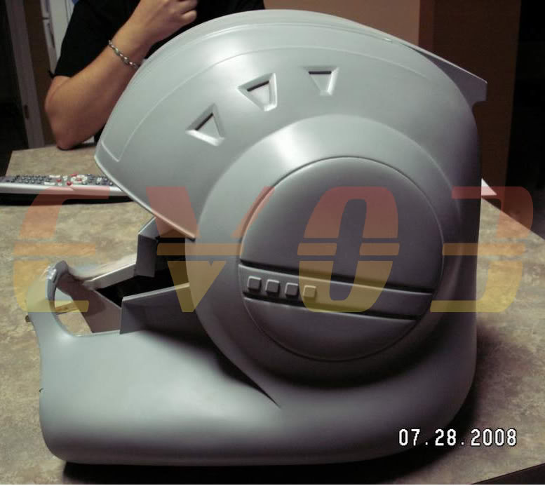

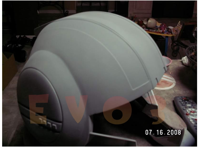

And after hours of getting high on Bondo and spot putty, here are the fruits of my labor. You'll notice the mohawk has been fixed and it is now indented.
A view from the top shows how the raised lips on the mohawk go back to blend into the helmet.

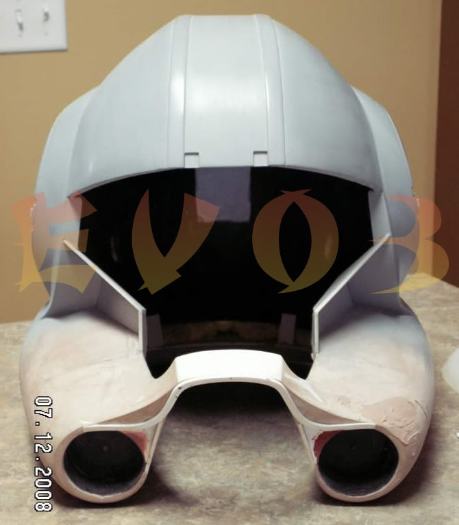

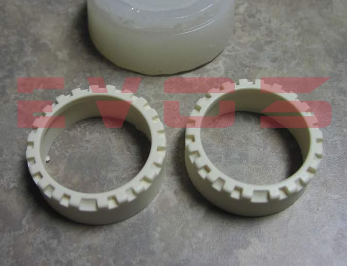

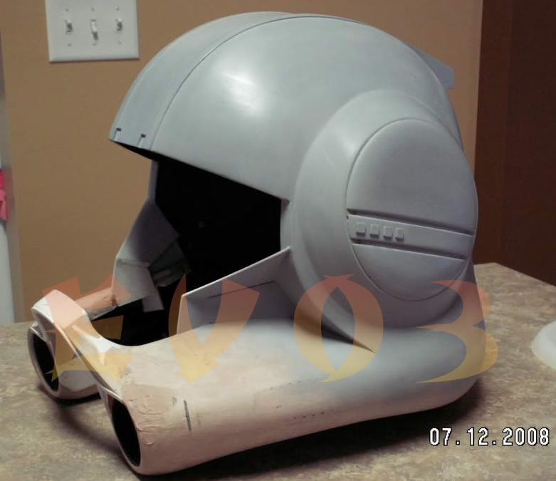

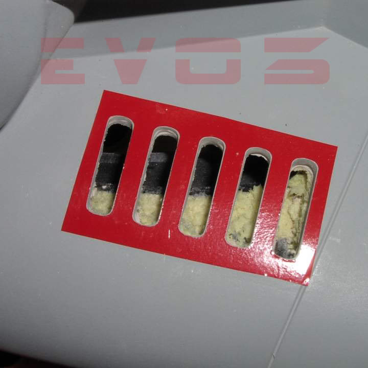

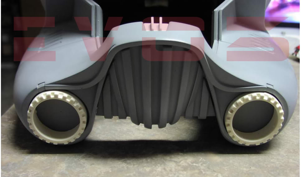

From here, i just plugged up the holes from the back with epoxy putty then when that dried, i came in from the top and epoxy puttied the holes. Next was the hose couplers. I fabricated the prototype from PVC pipe and some styrene strips.... a little epoxt putty as well.
Molded that piece and made clones!!!!!

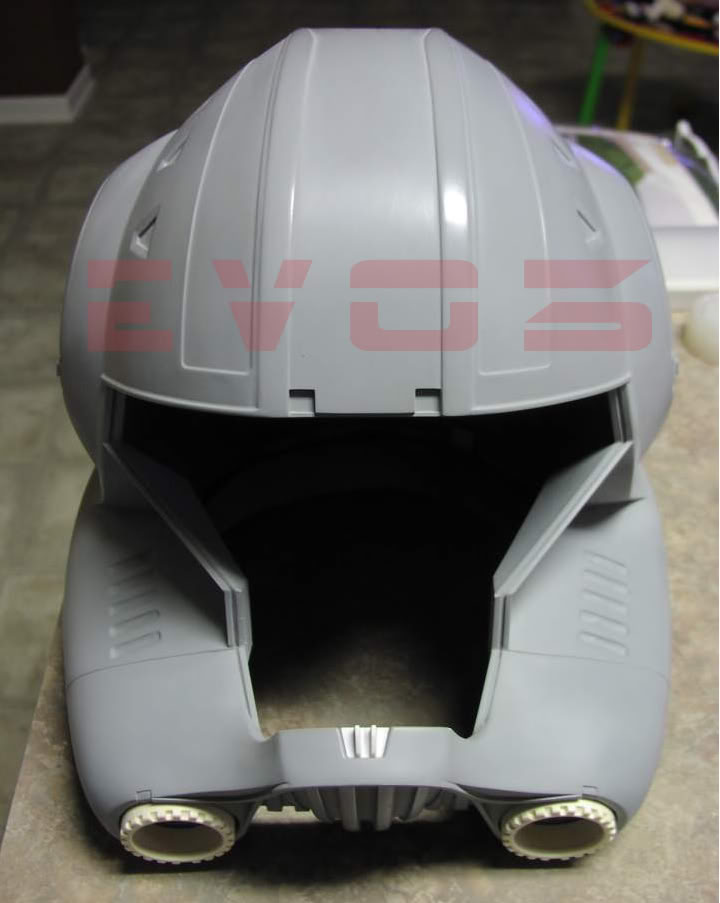

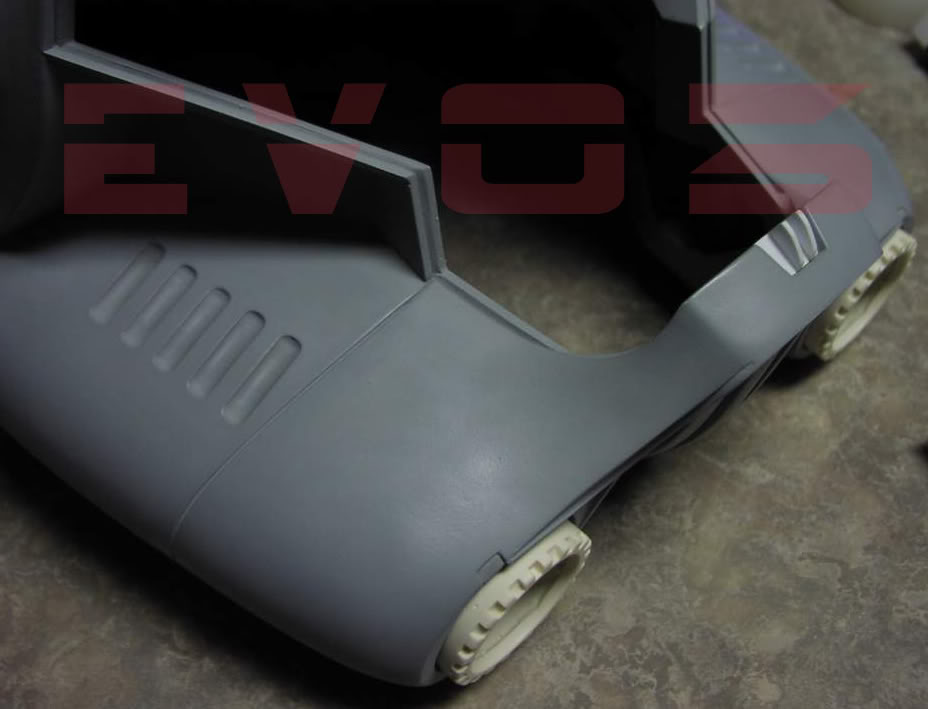

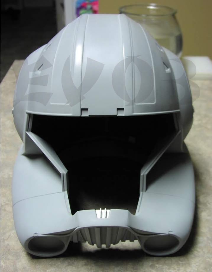

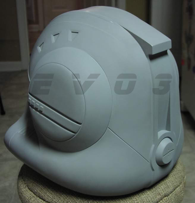

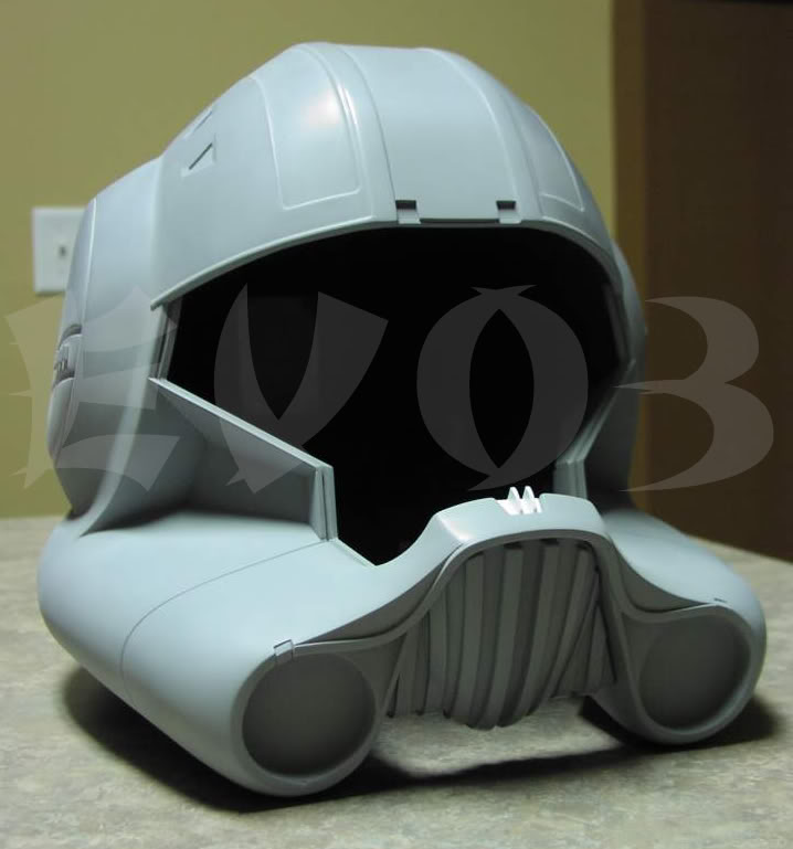

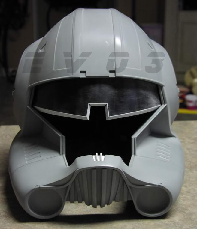

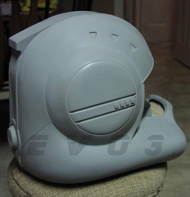

Heres the helmet with all the front work done. Just for the record, the hose couplers will be cast separately from the helmet.

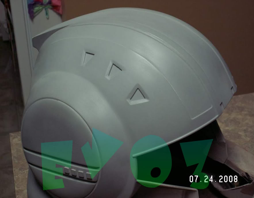

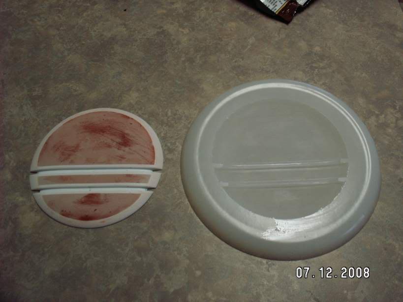

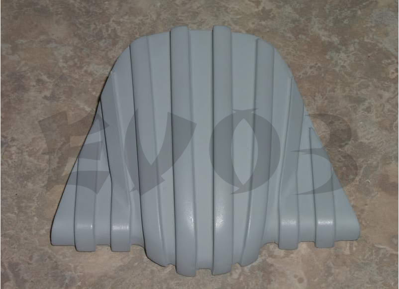

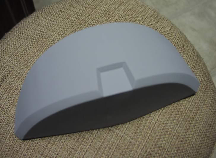

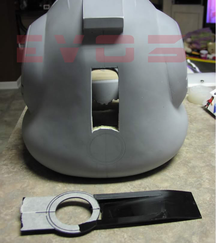

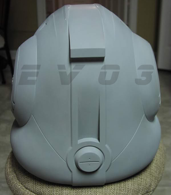

Work on the back detail has begun as well already.

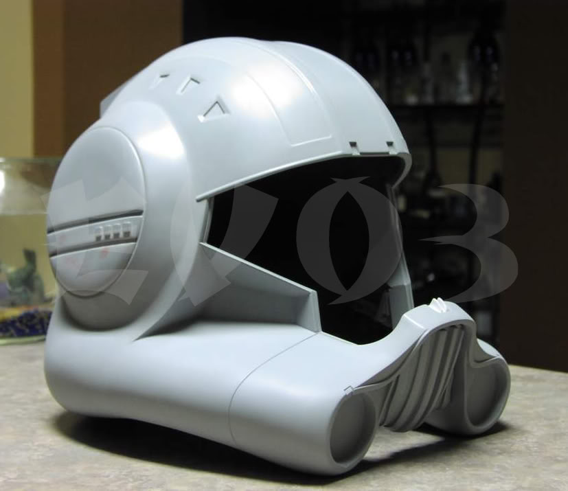

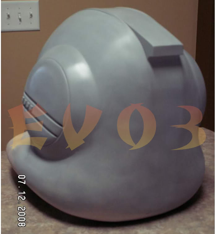

Back plate installed and ready for primer.....

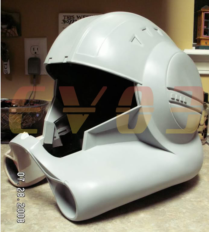

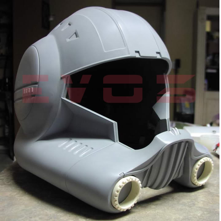

All primered up!

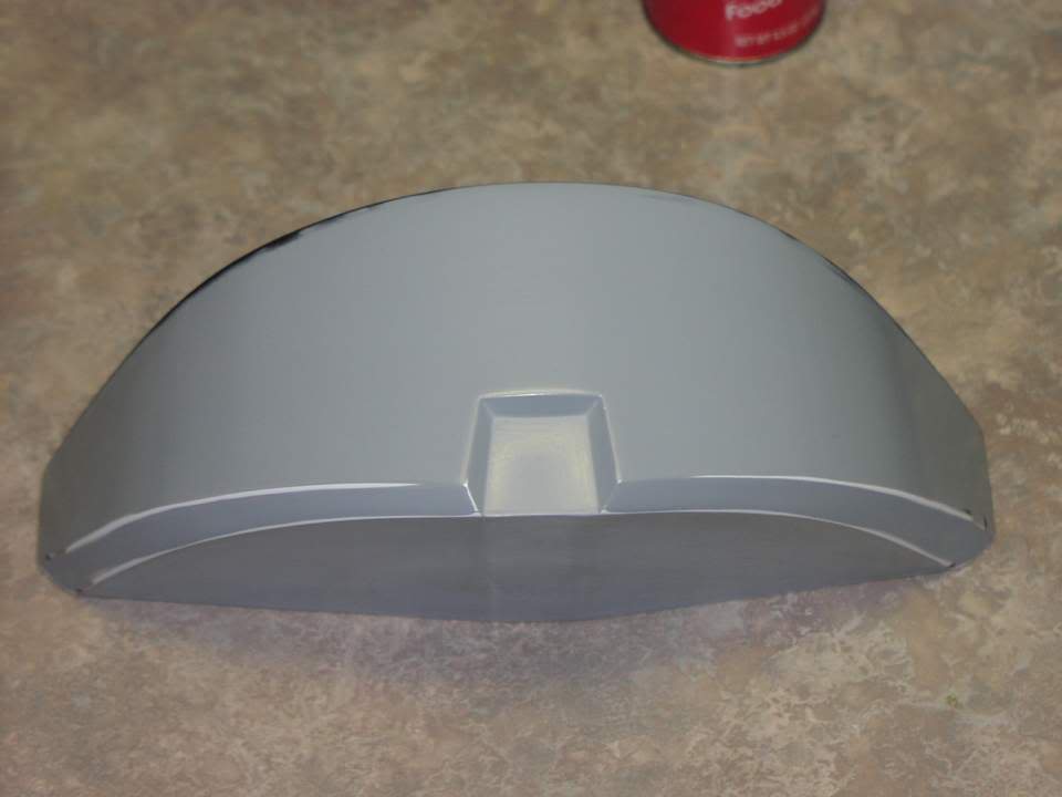

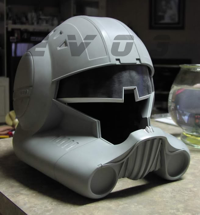

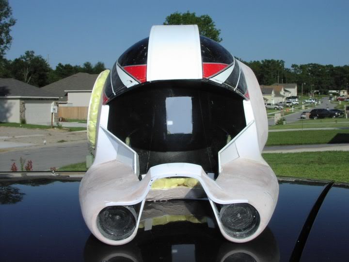

Here is the visor installed. After it was test fitted, i pulled it out and made it into a vacuum buck so that i can make the amber lens.
Here is the buck.

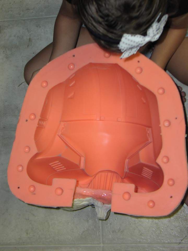

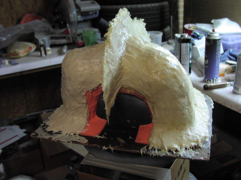

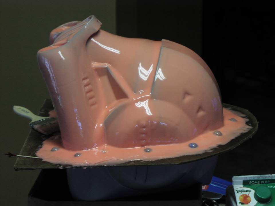

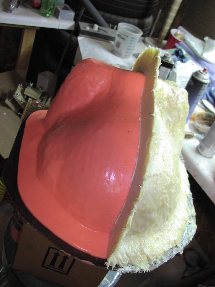

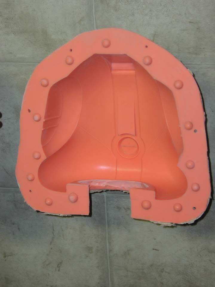

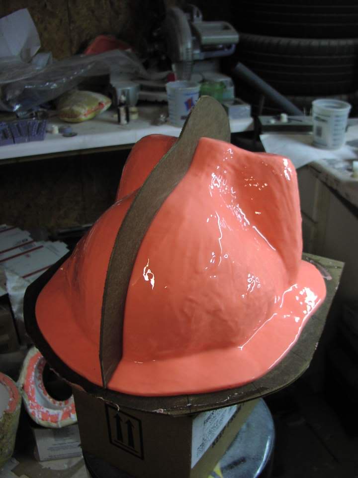

First coat of RTV.........
Separating wall for the mother mold..........
First of three parts to the mother mold.............
Both sides done...........
Now it'll get flipped over and the whole process will get done to the backside of the helmet.
Success!!!

Heres the vac buck for the amber lenses.
This project is by no means over. I need to make copies of the visor bucks, then have them thermoformed by a friend. Then its time for a nice paint job. stay tuned for more!

Can I ask you something? What was the crest originally made? In the 2nd, 3rd, 4th and 5th photo we can se it's a white and flexible material but... which is it?
Thanks and congratulations!
Thanks guys! Yeah, now to decide on a paint job.:facepalm
I can't believe it! O.O
Incredible man!!
Its plastic styrene. You can get it at most hobby stores. Its under the name "Evergreen".;)

that is stupid nice, evo!! i like the inset trim trick on top of the helmet. impressive ,most impressive.
