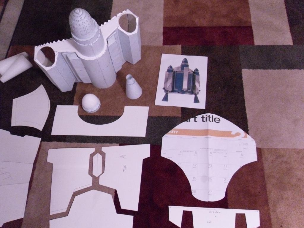

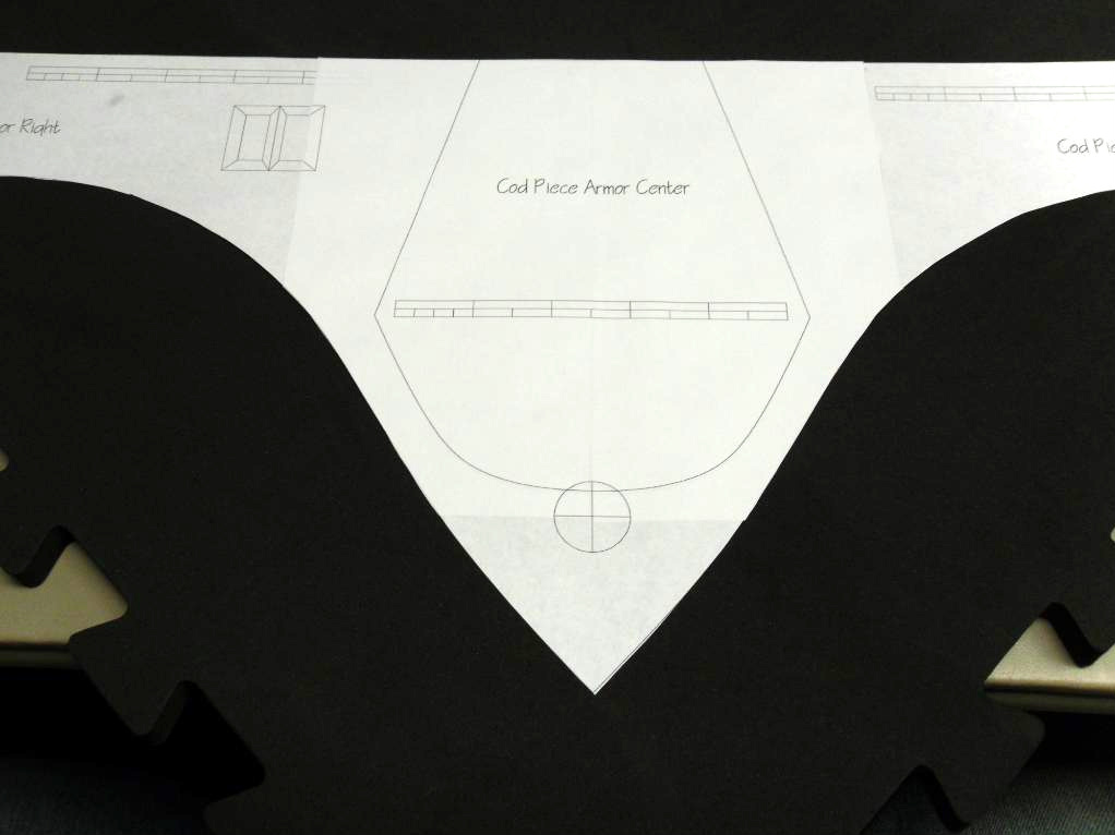

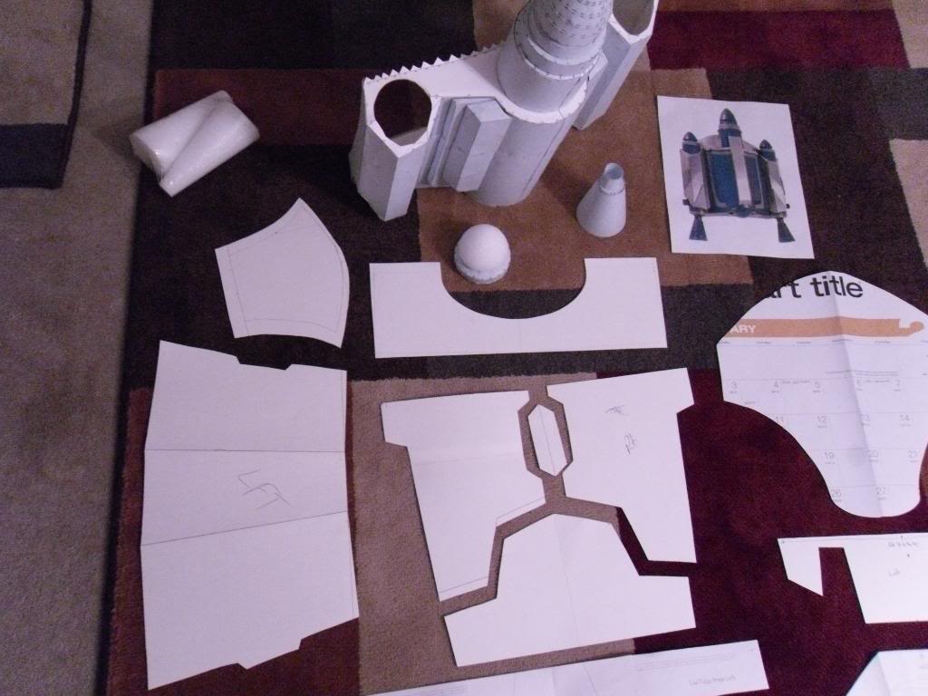

I printed off the WOF (I think every guy who builds a custom Mando is thankful for these), THANKS WOF. I printed off the plans and modified them as best I could (prior to the episode coming out) but I did pick up #115 SW Insider (pic reference) and after two weeks of messing around here is what I have so far.
My templates in paper.

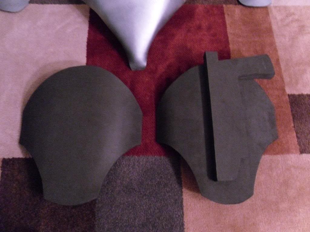

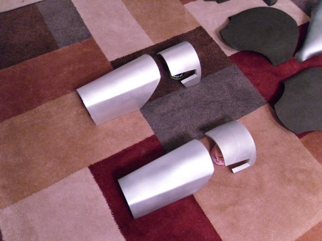

First foam piece, I actually only had one internet reference for this two weeks ago. I didn't follow this shape exactly, I actually made it bigger and then trimmed it down to fit.

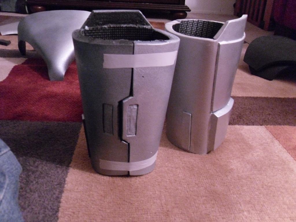

Thighs and gun in foam stage. I need to build the holster still.

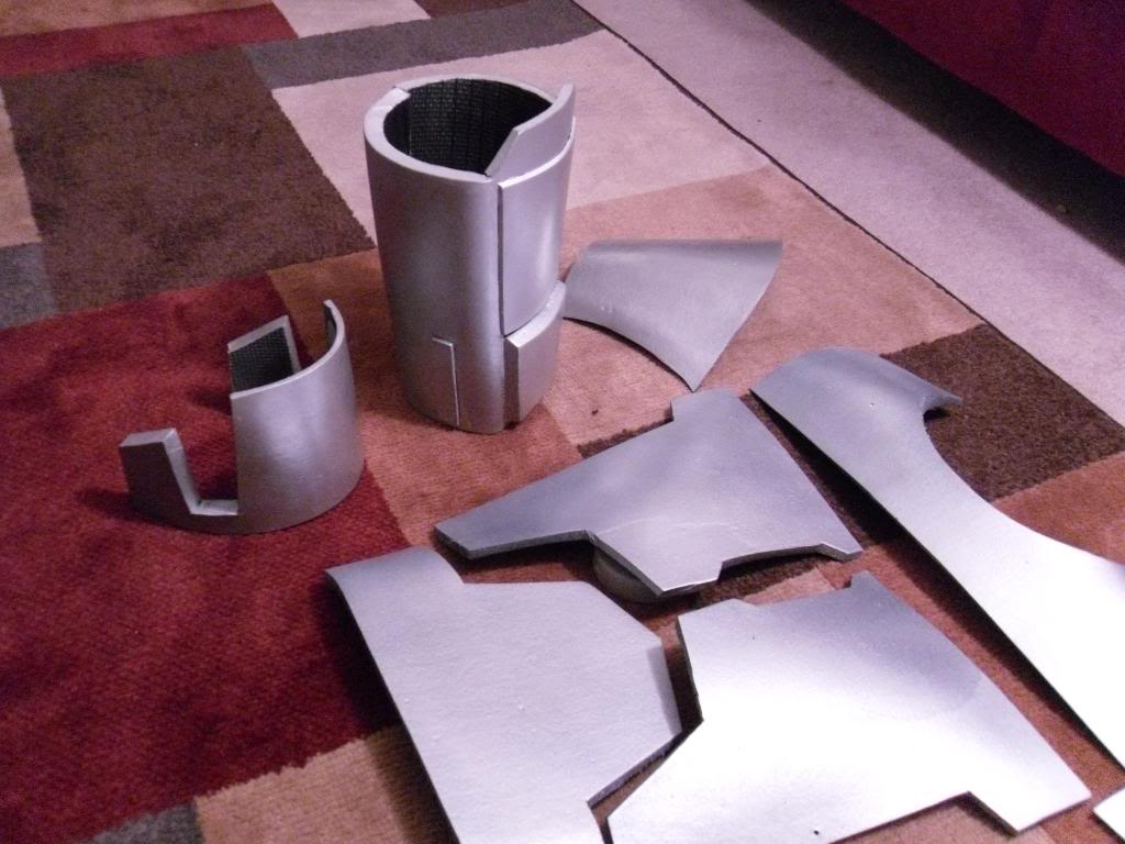

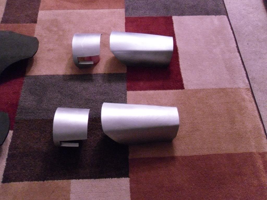

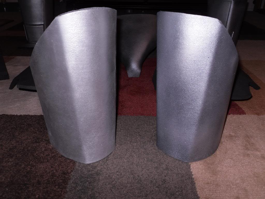

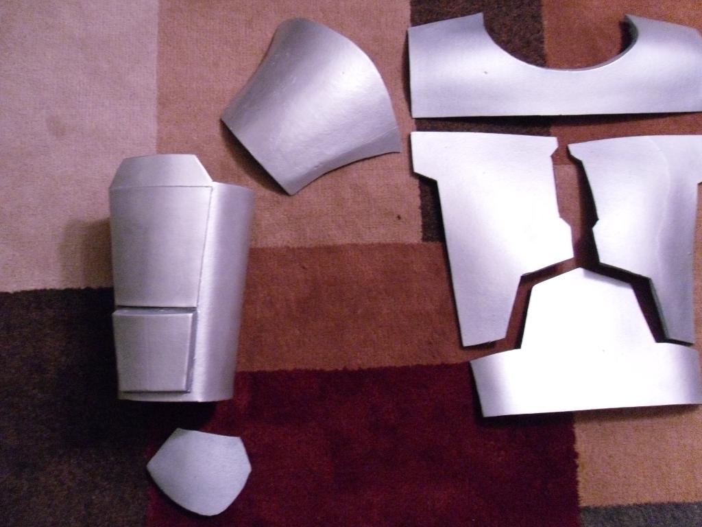

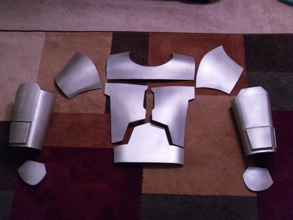

Painted, and then Rub and Buff the right shin, guantlet, and shoulder. Rub and Buff both knees, as well. All other parts only have been painted with Plasit Dip (black) from Home Depot and then with Silver Vinyl paint from Auto Zone. They have not been RNB'd yet.
Shin on the left and both knees are RNB'd, the shin on the right is not.
Gauntlet on left is not RNB, right one is.

None of these pieces in the next shots have been RNB'd yet.
More pics. I wouldn't even call this thread versions one, more like trial and error to see if I could cut foam, shape and paint it. So then I will try revamp all of the pieces once I finish and see about finding better stuff to coat with before Rub and Buffing the parts. If it ends up looking too cheesy, I might just scrap it.

Anyhhow, I cut out the pieces make sure you have multiple blades, other wise you just tear the foam. Then run a heat gun over it, it helps close the pores in the back side of the foam mat. Then plasti dip spray paint at Home Depot $5.97, Silver Vinyl spray paint at Auto Zone, $6.96 but this color is only available at one Auto Zone in the entire St Louis area, all the stores had all the colors but silver. only one with silver. The cool thing about this silver which I have never seen before, I could actually make out the flakes in the air when I sprayed it.
