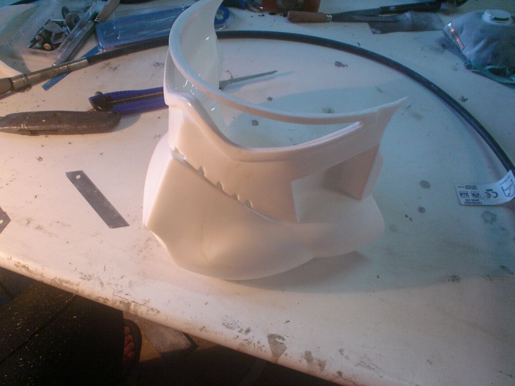

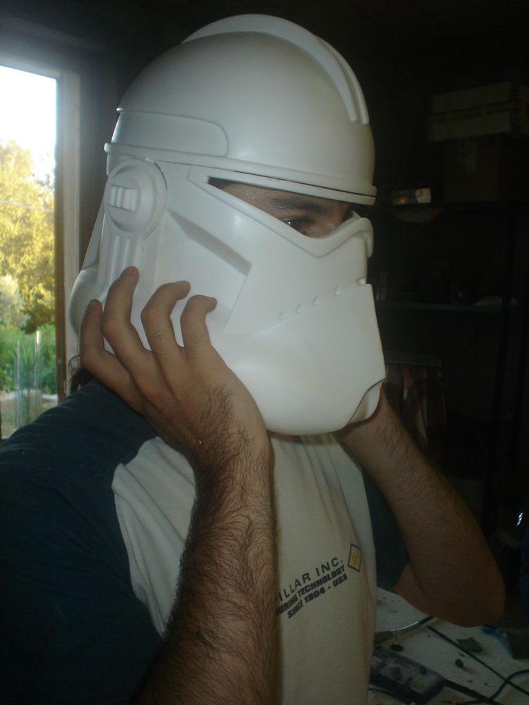

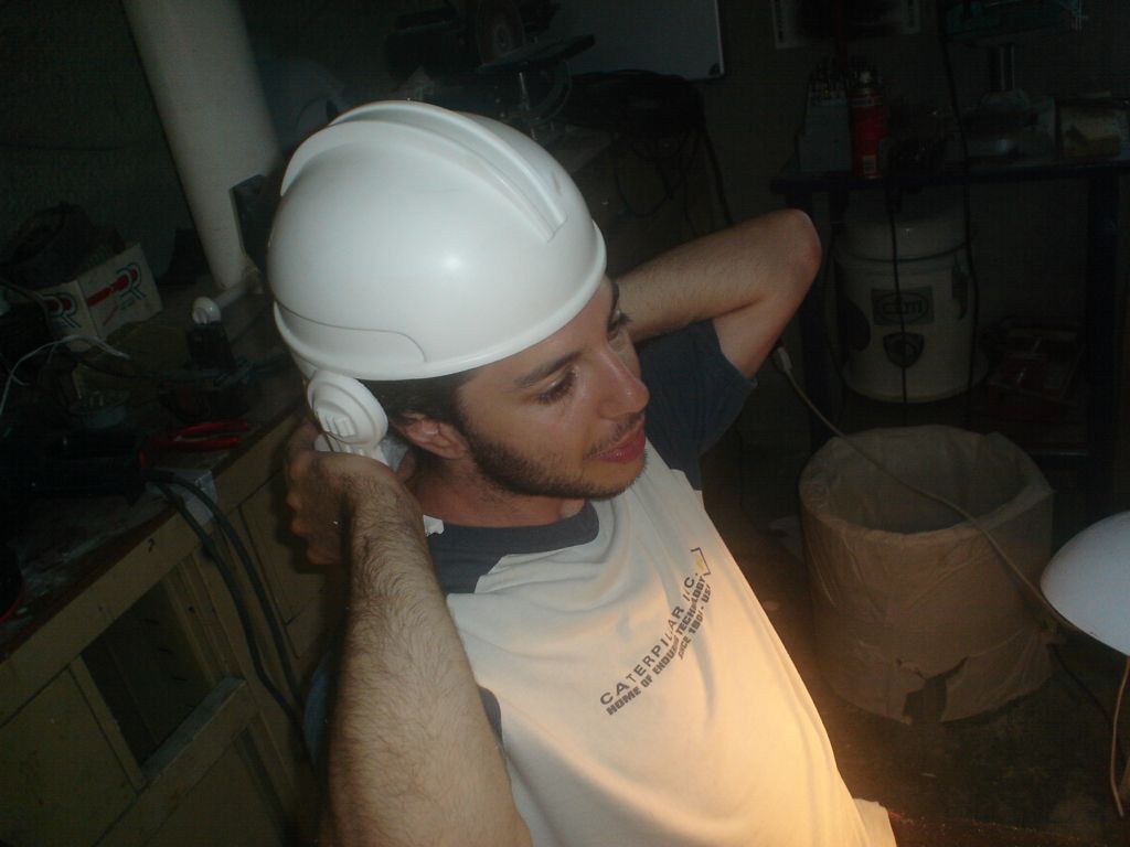

I want show you my crazy work on my OSCS armor!:lol:
I'm rebulding all the angles because i want a "super spiky armor"!
I'm using only liquid ABS (abs+acetone) for a better result.
Helmet (Always from OSCS)
Chest
Butt
Stomach plate
Forearm with pad
Legs
Well, there is still a looot of work to do:cry.....

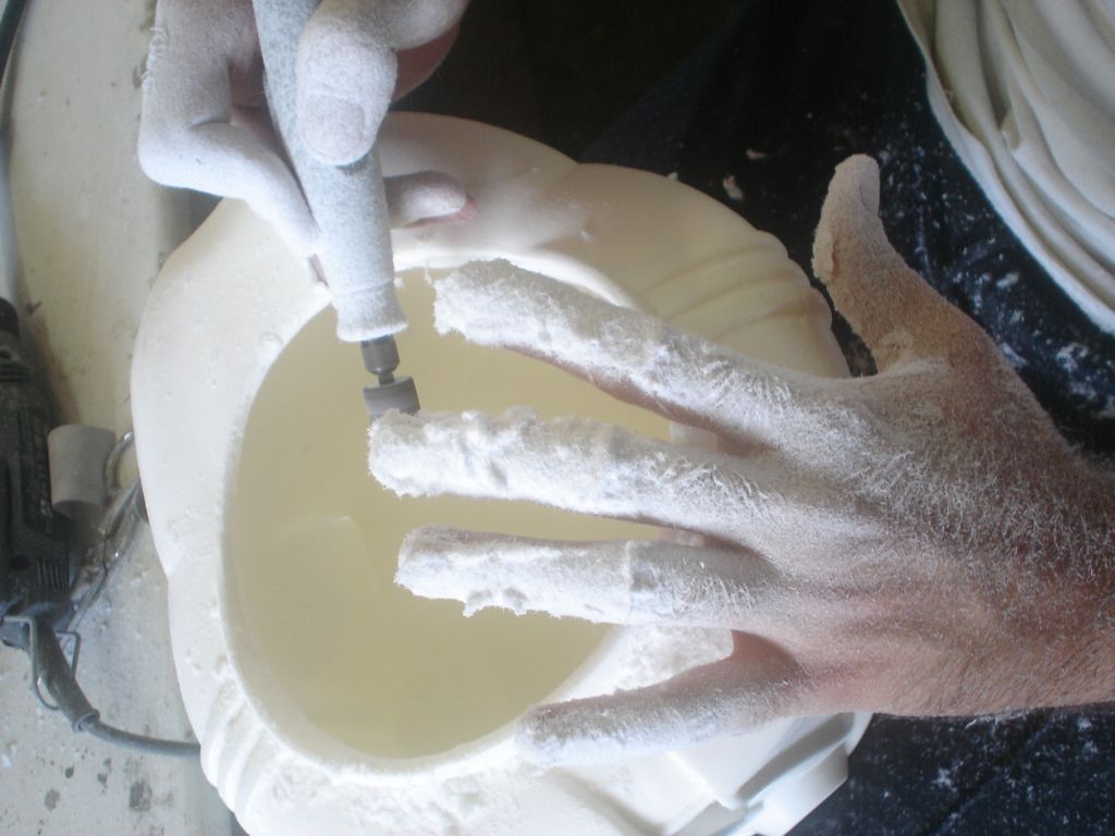

for the liquid abs, what kind of brand are you using??
I'm using the extra ABS of the untrimmed armor pieces dissolved with the Acetone. NO Bondo, no filler, no epoxy resin, the same Abs of the armor!
IMO it's the best way to add material on the armor, it has the same strength and same flexibility because it's 100% compatible! It's like weld 2 iron pieces or glued them! Better the welding!;)
There is a negative side....you must wait 48 h before sand it.

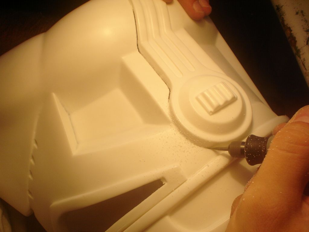

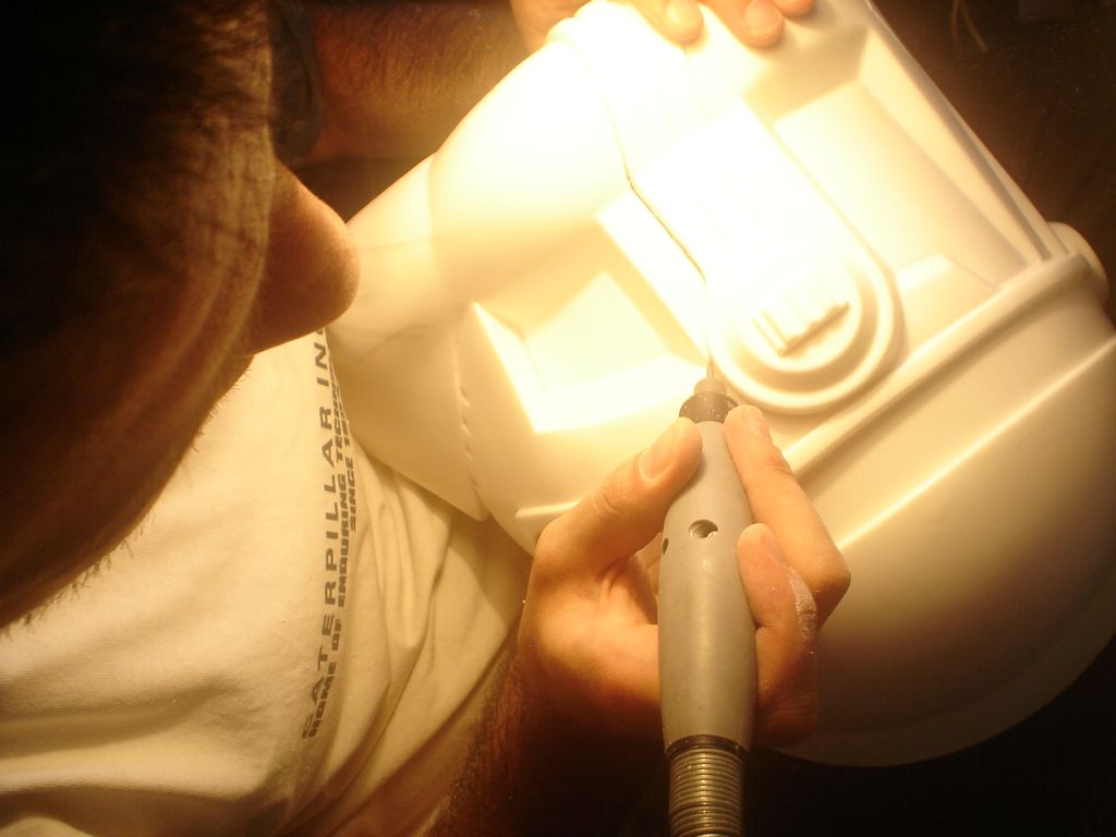

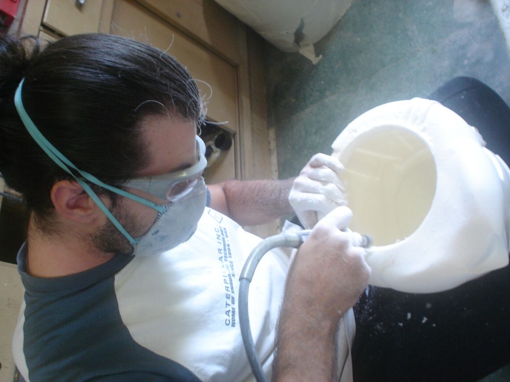

Heatshock said:
what bit did you use in your dremel for the face plate cut off?
this one:thumbsup:
http://www.dremel.com/en-us/AttachmentsAndAccessories/Pages/AttachmentsDetail.aspx?pid=105

I love what I see! I just got the NEYO from tk 1389 too. I'm sculpting my own armor. Although I like the armor you have I agree that it is somewhat
rounded (possibly because the thickness of the ABS doesn't allow it to be as pointy as you want it).
What drill bit did you use to cut the face off? I know TK 1389 suggested a number 15 exacto knife...but I saw you with your dremel and thought it would be easier that way.
