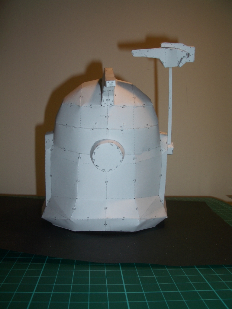

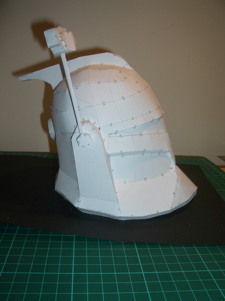

Build Finished... and Apologies to Trooper937
Alrighty You'll find attached some photos of my 70% build of the Rex/SW:TCW pepakura bucket designed by dung0beetle.
Firstly...Nice! A pretty easy build that comes together well and captures the look of the TCW helmet very nicely. You'll see that the back of the helmet needs a little detail, but I'd be pretty happy using this a starting point for a full scale build. The only tricky part is the rangefinder it needs some very precise cutting, scoring and folding. Mine looks a bit rough if you look closely at the photos but that was me rushing not the fault of the pattern, It'll build up nicely with a bit of care. One more thing, while I've used paper for this build, I'd make the stalk for the RF out of something other than paper if I was going to wear the helmet at all mine has already drooped a little between taking the photos and typing this!
And I owe Trooper937 a bit of an apology I think I mis-understood his last post to be a comment in my direction when he was probably sending it dung0beetle's way.
You see the helmet is very undersize at its current default scale of 30cm. The 30cm height of the pattern includes the Rangefinder and this throws things off a quite a bit. The last photo is a comparision of the 70% scale dung0beetle's Rex Helmet to my previous build of Skupilikson's AOTC at 50% scale... not a lot of difference in size. My guess is that the Rex Bucket should be scaled to 34-36 cm height when you print it out if you want to be wearable.
