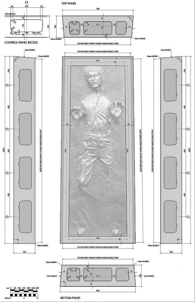

Here we go HIC builders. Lets get those blueprints and pics up to start, Ill put the blueprint up here shortly. I don't know where it came from ORIGINALLY. If anyones got a problem with it, Ill remove it.
Don't know if these specs have any relation to the studio prop....just getting rolling in my research too
but if we help each other out.....It'll be easier for all of us.

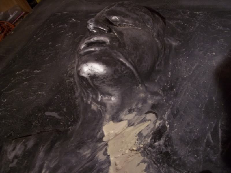

Here is a quick comparison:
The red dots should mark a detail which is present on BOTH pieces. The green dots should illustrate spots which are more pronounced on the cast then on the screenused prop (and vice versa).

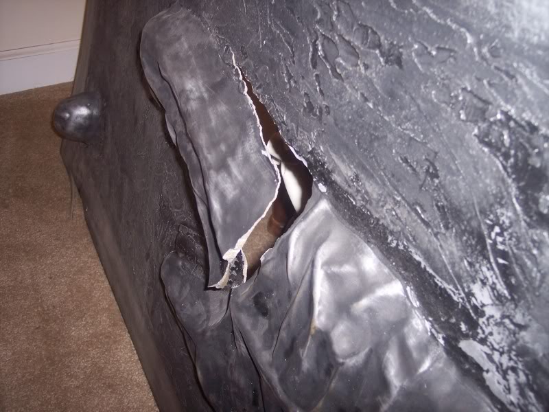

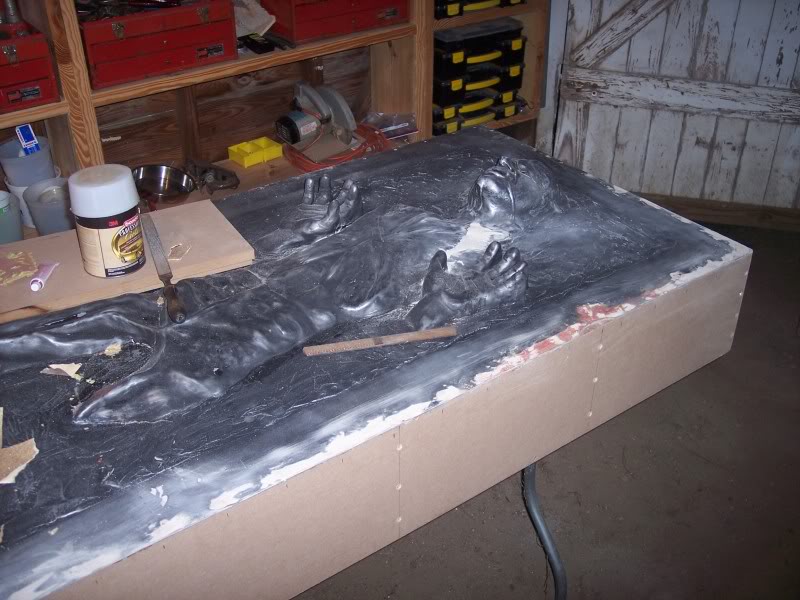

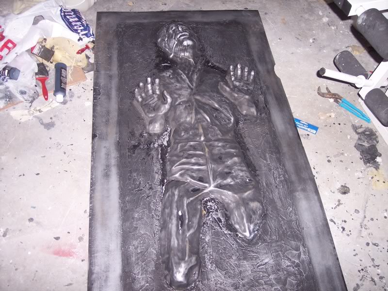

I'm building a rectangular one at the moment. Started out with a VERY broken HIC cast that I picked up in May or June.
made out of MDF and lots of bondo. I fixed all the cracks and filled in all the screw holes. It's further along now than in the pictures I have posted. I'm currently putting some KILZ on the sides so seal them and will hopefully have the whole thing primed by the end of the week!

SMALL greebs). Im going with the angular sides like the ones
on the "King blueprint" I put up on the first post.
