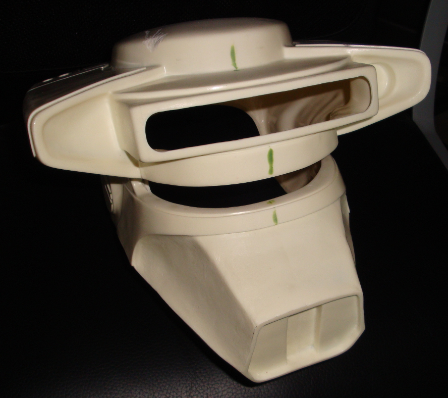

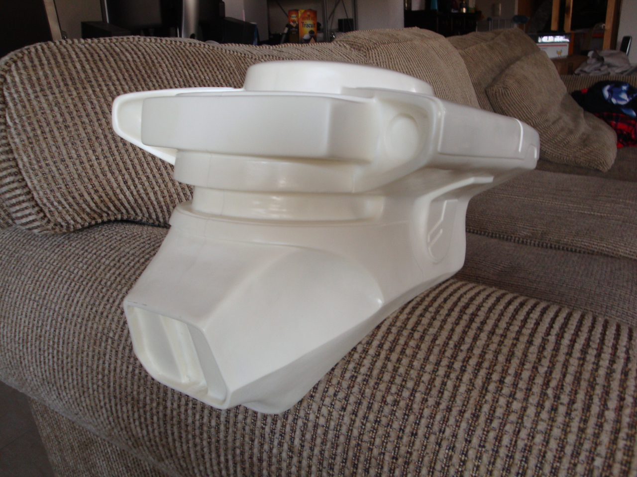

Got some updated pics of the bucket. :D
Cut out the visor and upper display area and filled in some of the mold-lines. I also tried to replicate the battle damage seen on the actual prop, its not the best but I think I gave it a decent try.
Let me know what you think and any tips would be welcomed!

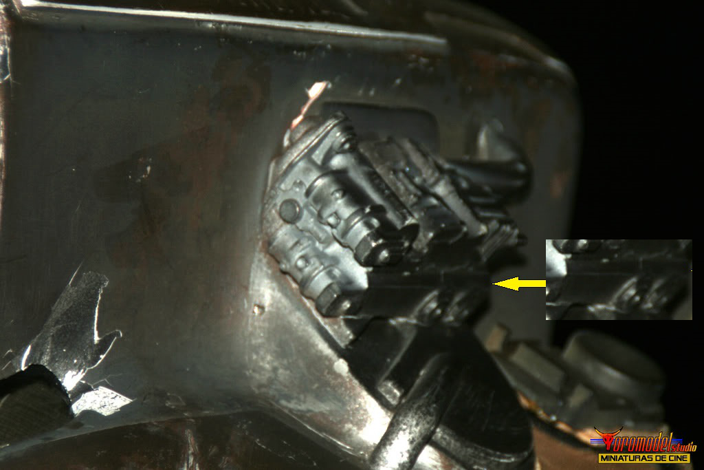

So Im not even sure where to start with this question so I hope that those of you that are good at hunting down bits can help me.

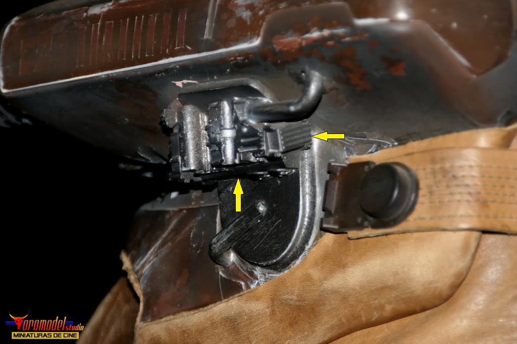

I am hoping that someone knows what these two greeblies are on the (right?) side ear, the side under the stalk/rangefinder
Im just wanting to put together as close to cannon as I can muster :D

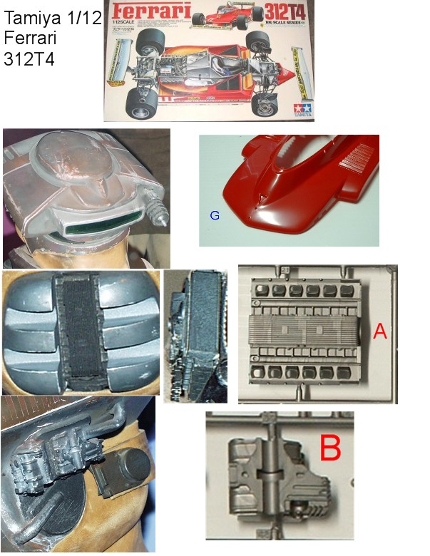

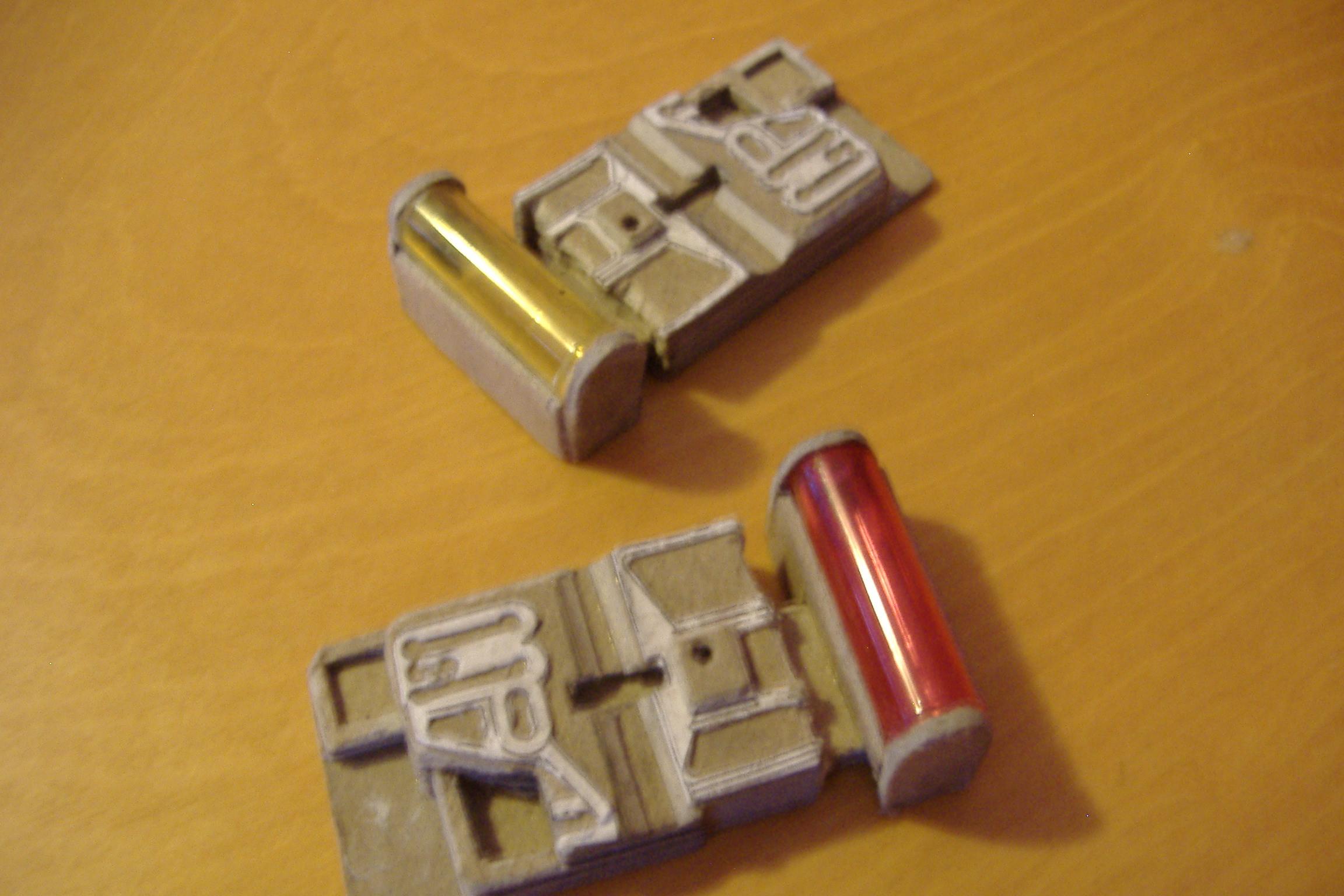

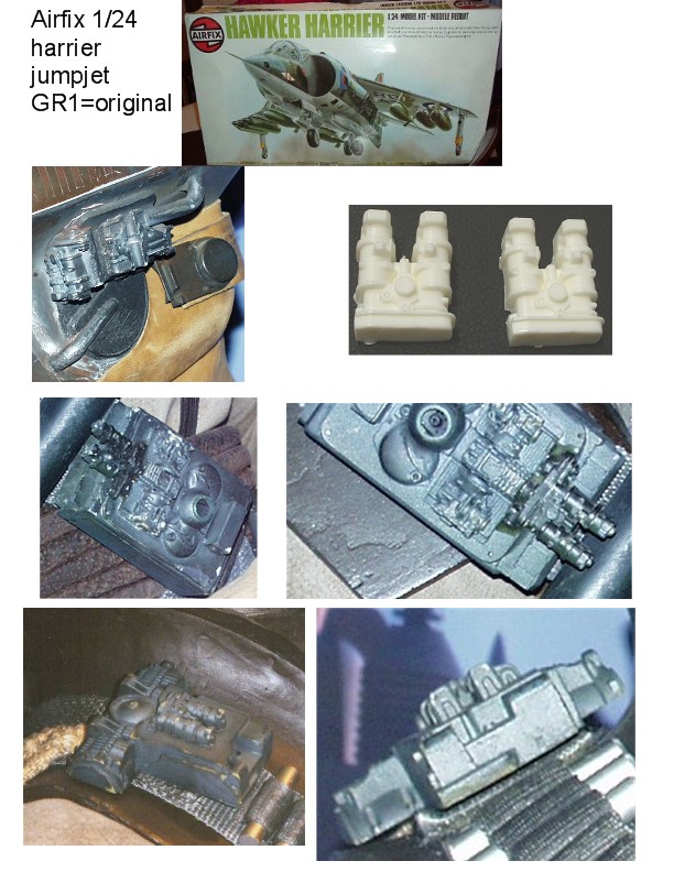

I know that the larger piece is a model piece from the Tamiya 1/12 Ferrari 321T4 model kit. The little tube piece is also from the same model kit. I am surprised that these pieces didn't come with your helmet kit. I made mine from scratch using reference photos.
Here are some photos with the model references for a few of the pieces.
I have all those above pieces you showed.

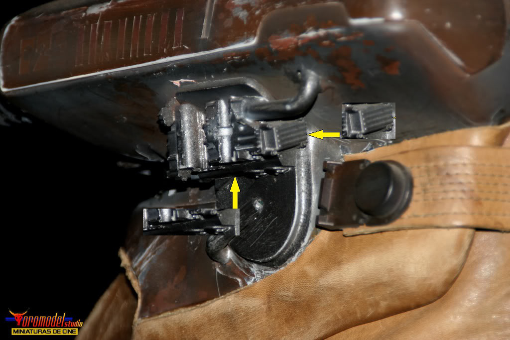

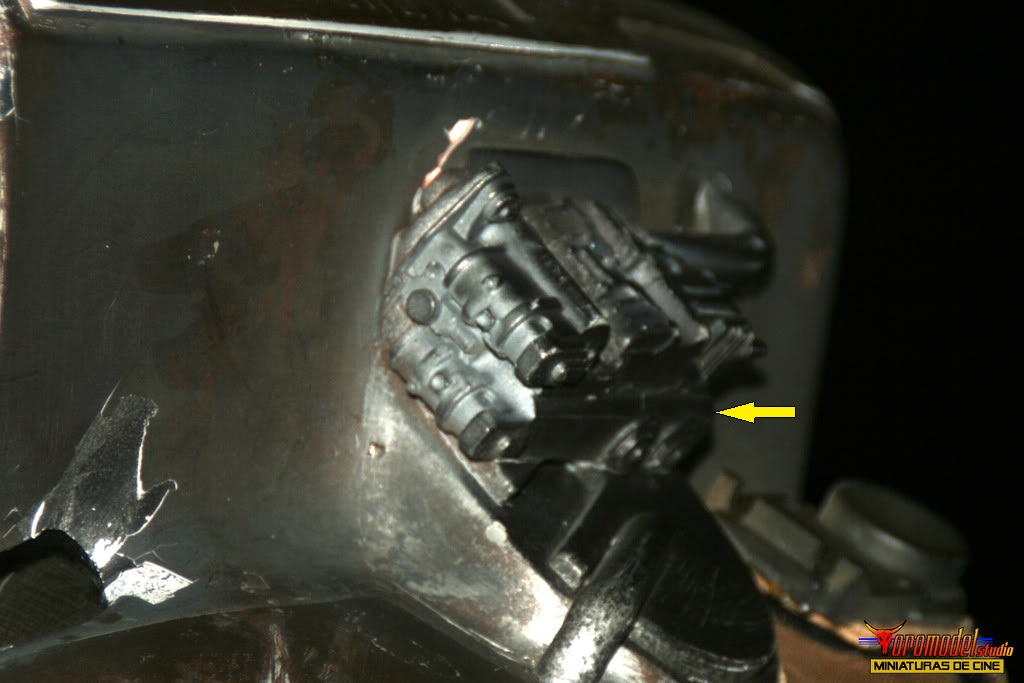

What I am talking about appears to be only below the right ear greeblie. The left one seems to sit more flush with the helmet but the right one, the Harrier and Ferrari engine part, appears to sit ontop of something with two protrusions and a beveled edge. The rear piece looks like some sort of engine cover, maybe from the same Ferrari kit but Im not sure because I cant find any images of the plastic tree's.

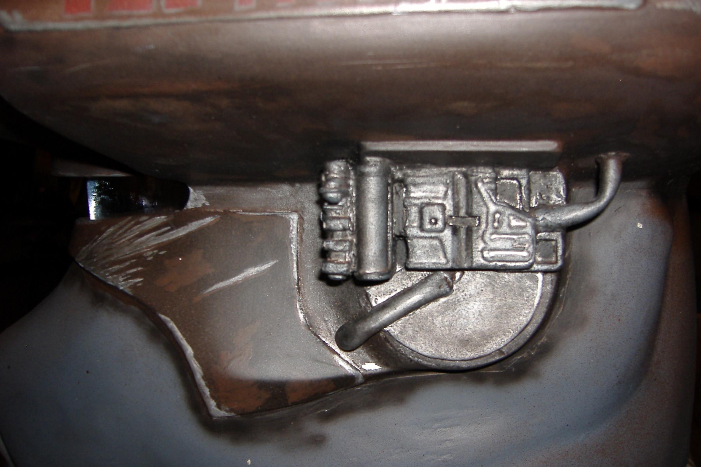

The unknown bottom greeblie

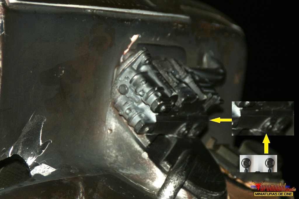

Different angle with the rear unknown greeblie
Ok so I looked through images I found for the Ferrari kit, the Airfix Harrier and the Churchill croc tank and I could not identify the mystery parts. Maybe they came from a different kit, not even sure where to begin looking.
Sorry about that missed on where your arrows were going. In all of my research I wasn't able to find where those parts had been identified. At one point I stumble onto a website that had pictures of the model kit trees, but I don't remember what site I found those on. I will have to dig through my bookmarks to see if I had save them & I will let you know.

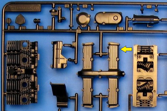

So! With some luck I found one of the pieces. Took me a while to find it! :D
Im sure most of you recognize the Tamiya Yamaha Midnight Special kit which is used in a lot of SW props.

Still have no clue where that bottom piece is from.....geh this is aggravating!
Good find, bet your eyes got crossed looking through all those model kits. I spent a long time doing that myself but realized I wasn't getting anything done.
Yea its tough, I started going through all the known kits that were bashed for other costumes, figured they would use the same kits over and over. Though that bottom piece still eludes me. It looks like maybe a bottom to some wheeled or tracked vehicle due to the two round protrusions.....hard to say, it may be something that has to be fabricated by hand vs finding a kit piece that was used for it.

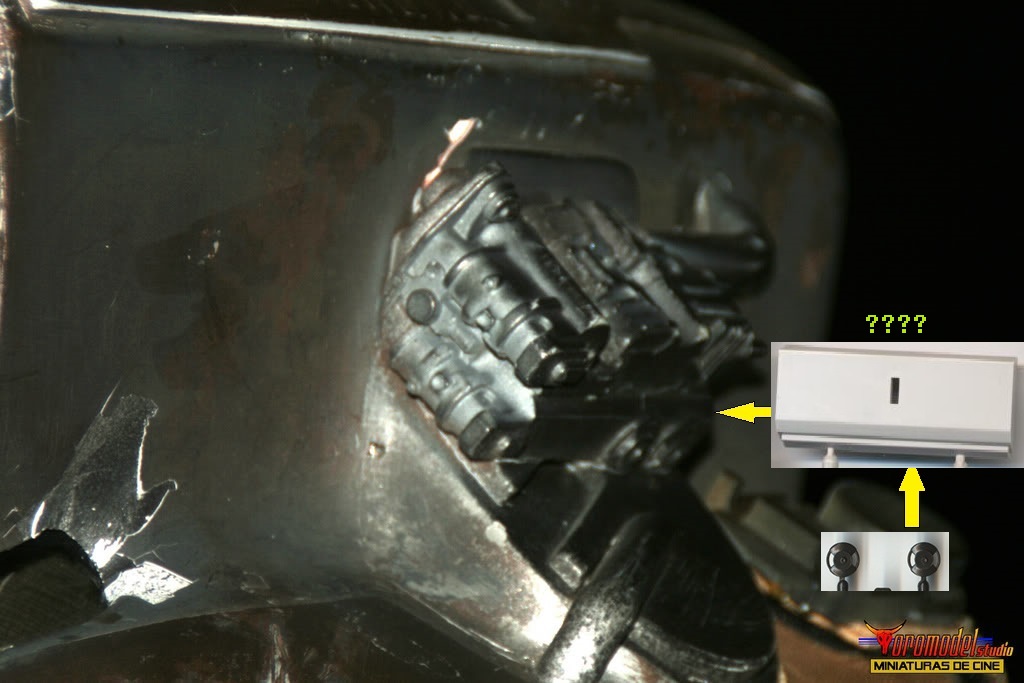

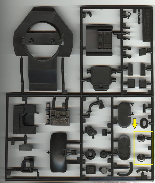

So, sorta found more but it seems that the last piece was pieced together. Didnt find the angled box everything is sitting on but the two disc looking objects I found.
1/35 Tamiya Flakpanzer Gepard
boushh-works-flakpanzer-part2-jpg-71795d1380441806
boushh-works-right-greeblie-part-2-jpg-71796d1380441807
I hope this helps.....now gotta find someone with this part :facepalm

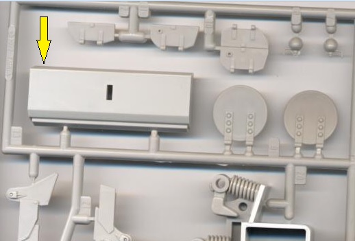

So I think I found the last part but hoping someone here might have the kit and can tell me its dimensions or take more shots of the piece.
From the Tamiya 1/35 Churchill Crocodile
boushh-works-box-greeblie-jpg-71896d1380730116
The raised edge would be hidden(facing up). It looks pretty close but its hard to tell with just this picture.
What do you all think?

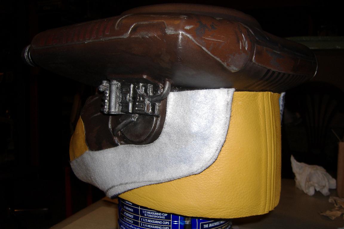

Only running into a bit of snag and Im hoping to find some answers here. Before I start painting I know I want to make a template for the leather pieces that cover the snout. Im having a hard time finding a good way of making a template, the top part I was successful, the bottom half....Im running into snags. Ive been trying to use painters tape (since it wont leave residue) and laying it down to cover the bottom half and trimming off the excess. However, when I try to pull it off it all falls apart no matter how I try to crisscross the tape. I was hoping to get some ideas on how to make a good template for the leather so when it comes time to gluing it to the bucket, it goes as smoothly as possible. So Im hoping to measure twice, cut once.....but getting there is proving problematic for me.
Any suggestions?

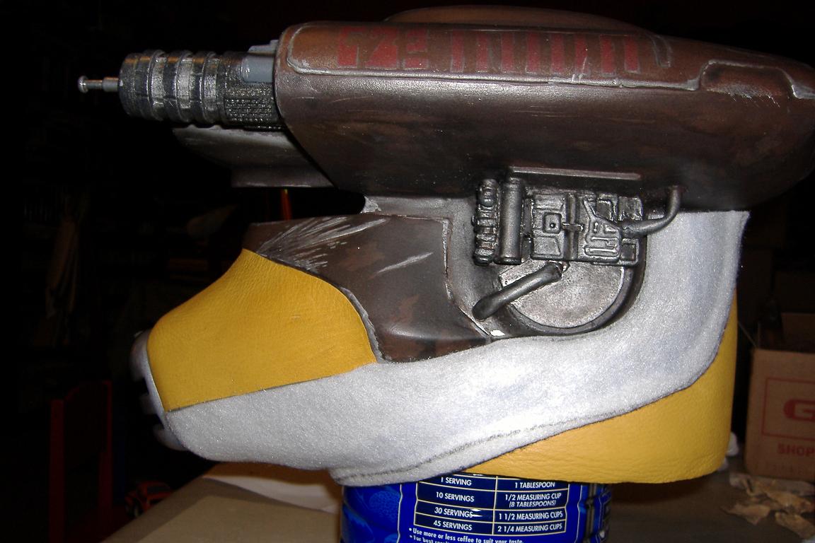

Go to a hobby store & pick up some craft felt. I made up paper templates to get things roughed in then cut pieces out of felt & slowly began fitting till I got what I wanted. It is a painstaking process. Using the felt it had enough flex which allowed to go over the contours & was close to the thickness of the leather. When I got the felt pieces how I wanted I put them on the leather & traced around them & carefully cut the leather with scissors. Didn't have to do any extra cutting with the leather. Here are a couple of photos of the lower portion in felt just taped to the helmet. The back & nose piece were completed. I used a deer skin which was easy to work with.
