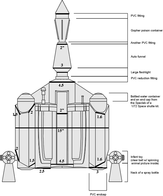

My 12-year old son is going be be Boba Fett for Halloween this year. He already has a store-bought costume, but asked if we could make the pack together. I found this graphic/measurement (not realizing it came from this site)
and using reference pics on the web (both props/replicas and original images) we started work.
